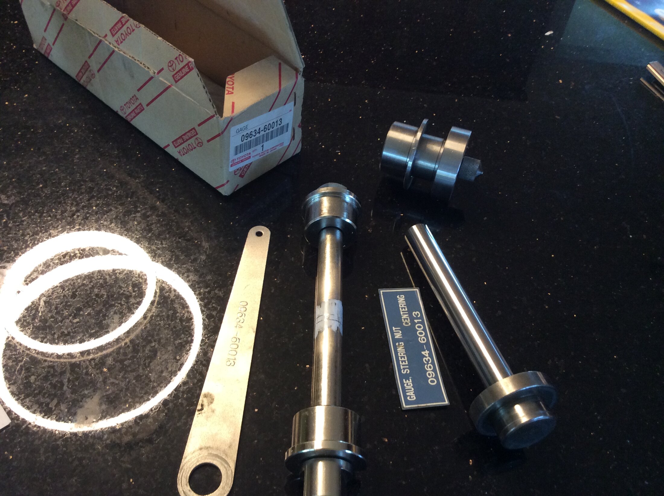

I have the 09634-60013 set and the additional larger sleeve OD is 40mm. Does anyone have an ID measurement or spec for a 70 series axle?
It depends on the year. The 7x used the 44 - 33 - 8 (mm) seal to 1990 and then the 50 - 35 - 9.5 seal afterwards.
Kurt, so a 44mm OD sleeve up to 1990 and a 55mm for 1990 and up, used slipped over the tool scribe base holder? The scribe holder is above the seal installer in the picture with the 40mm sleeve on the scribe holder.

Kurt, so a 44mm OD sleeve up to 1990 and a 55mm for 1990 and up, used slipped over the tool scribe base holder? The scribe holder is above the seal installer in the picture with the 40mm sleeve on the scribe holder.View attachment 3804420
I'm not sure what you're asking. The seal OD/ID/width are listed in my previous post. We use the 60014 variant SST with a sleeve that I believe our tech made for the 50 - 35 - 9.5 seals (90310-35010)
The 50mm sleeve your tech had made is used with the tool set to compensate for the larger diameter ID of the 1990 and up 70 series, right?
Correct. He's out this week or I would ask.
