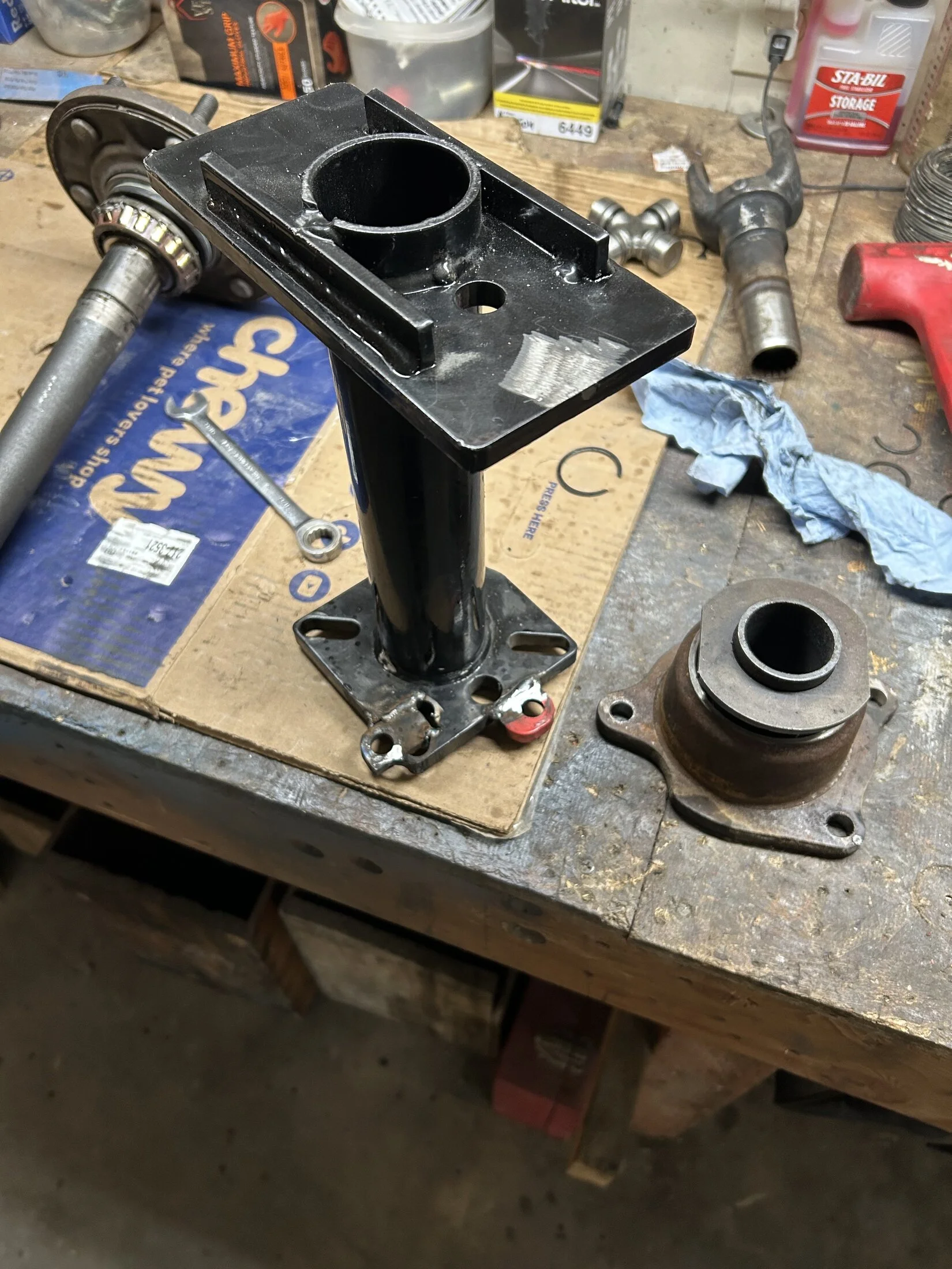

The universal fit, multi purpose all in one Toyota bearing tool bib not have the correct hole pattern to fit my backing plate. I found an adaptor plate on Amazon for just $79 but didn't want to wait a week or pay another $79 bucks so I broke out the welder and grinder and made my own.
Kind of Frankensteiny but it did the job. Luckily I only had to do one axle. The bolt pattern is reversed on the other axle and would required more cutting on welding. The $79 adaptor plate flips over to work with either axle. There are lots of u tube vids showing how it done.

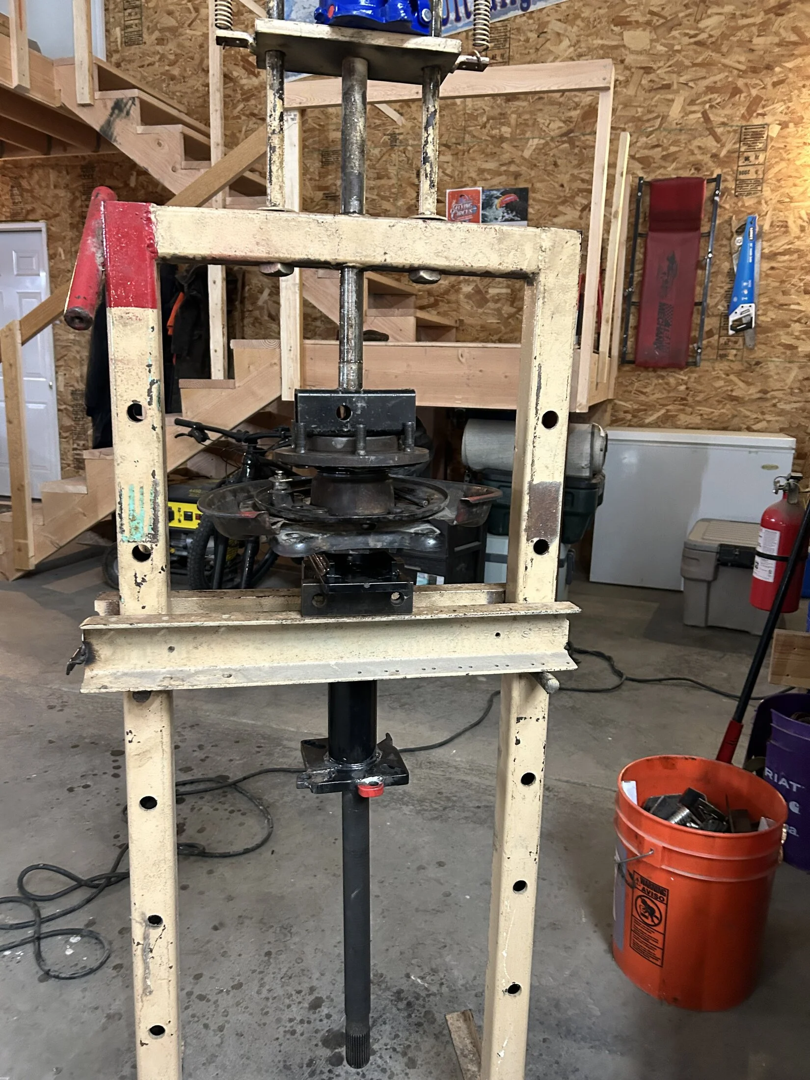

Also had to mod my press. The bars were to close together for bearing jig. I also had to buy a bigger bottle jack. The 6 ton wouldnt budge the bearing.

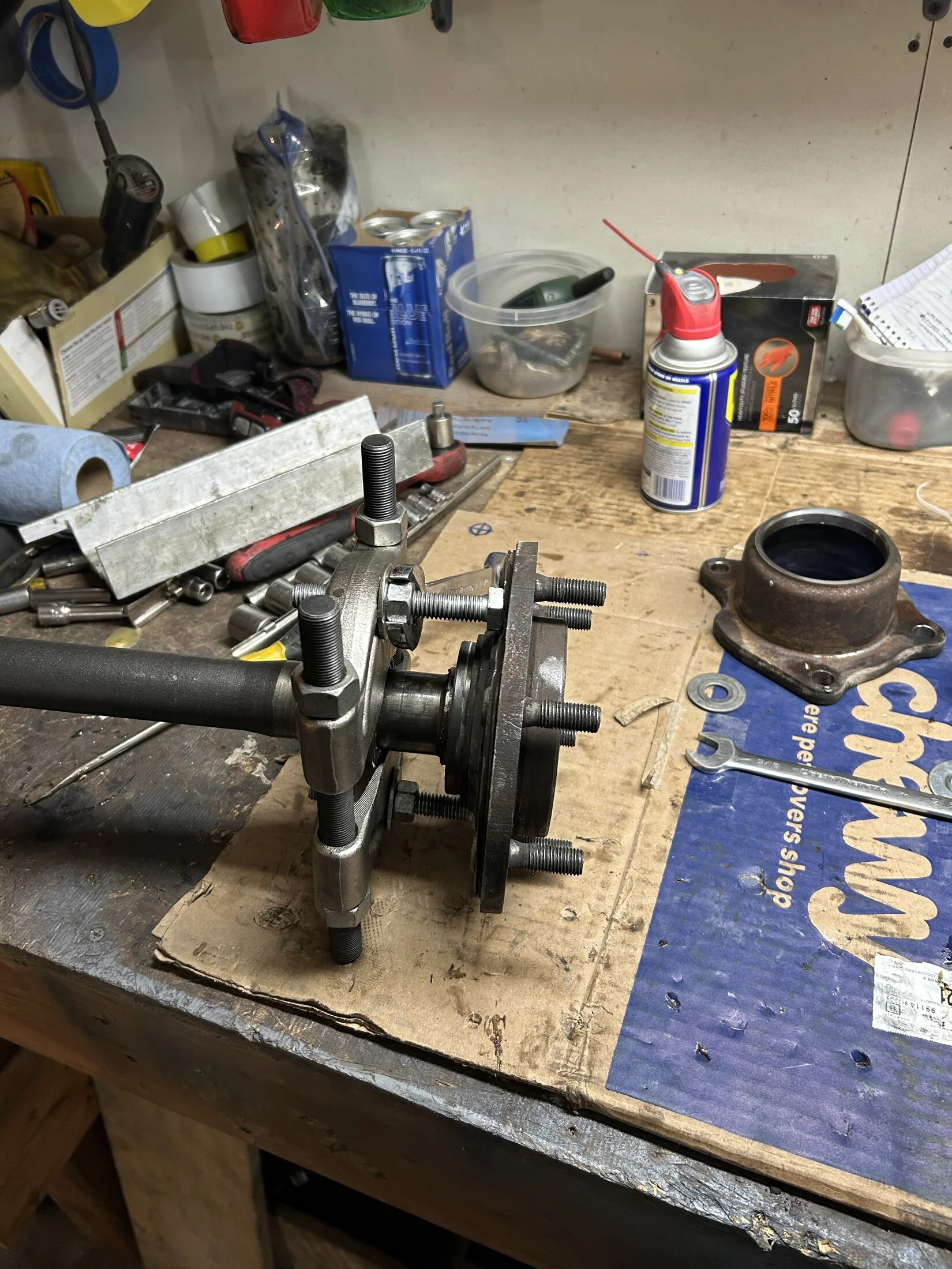

And of course the bearing came off in 2 peaces. I hade to jig up a second puller for the inner bearing race.
