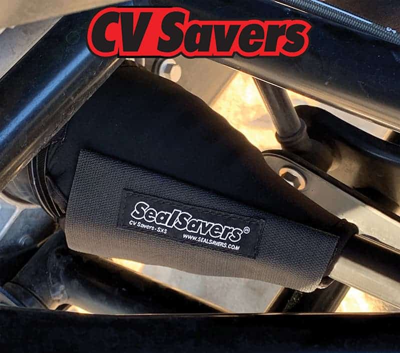

Has anybody seen or tried these to protect the CV boot? Thanks.
In my experience, they have caused more harm than good when placed on lifted trucks.
On a lifted truck, the boot gets tight at the bottom, and stretched on the top. Not a big deal, they can handles hundreds of thousands miles like this. When the bellow (that’s what a boot is technically called) now has to deal with a wrap around it, that can possible get caught between the rings of the bellow, can cause more friction. Which leads to tears.
If the CV was strait on, like in the factory height, yeah, they work great. But when they have to flex as much as a factory boot does when lifted. I don’t think it’s a good idea.
That’s me though. There is one report on here of a CV boot getting hit by a stick and tearing. Would it have saved that boot? Probably. Have I seen boots get torn by those protectors and not doing anything off road? Yep

I’m no CV boot expert, but I think I’d leave well enough alone too.
I’m still on my original 2008 CV boots (knock on wood),, and despite scraping just about *everything else* under my truck...my boots are still perfect.
Good enough for me.
Thanks for the colour on CV ‘boots’ that’s really useful.
I was trawling 200-series threads to look for common failure modes but it is hard to know frequency. I read that one boot-failure thread mentioned!
Icon trailing arms come up twice but obv a tiny percentage for the number installed and the miles driven.

I’d add that even with a boot tear on a trail you can probably make it back to civilization just fine. Yes if you tear the boot you’ll leak out grease and might even end up destroying the CV. So what. A replacement Toyota CV is what $700? If you don’t destroy the CV it’s maybe $350 to have the CV rebooted at the dealer.
I’m more paranoid about breaking a CV on a trail than a boot tear.
