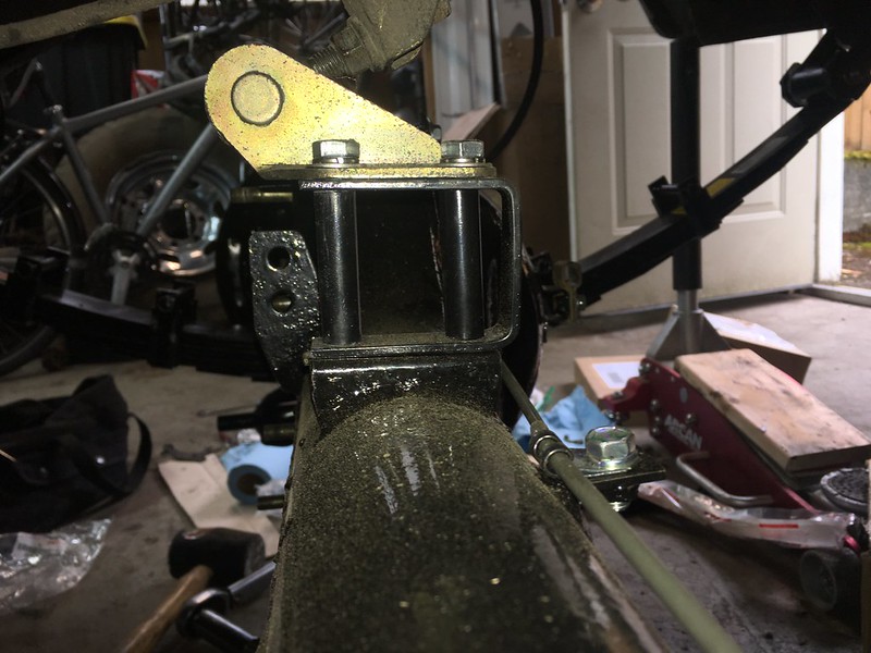

I made a spacer with longer bolts and a block of UHMW I had laying around. Sorry for poor picture, raining today. Hope this helps.

When I looked at how it was set up on the factory springs, at normal unloaded ride height the rod simply flexed when the suspension was compressed, as the valve was already closed. Only when the suspension was unloaded (as under hard braking) did the valve begin to open. Call it mechanical ABS.. There is a procedure in the FSM for proper adjustment but seeing as how mine was working fine before I simply put it back where it was pre-lift.

Yep, make a spacer. Best bet is to make a spacer that is equal to amount of lift you achieved over original stock height. I believe the usual with OME is about 2 1/2-3 inches lift over stock height.
