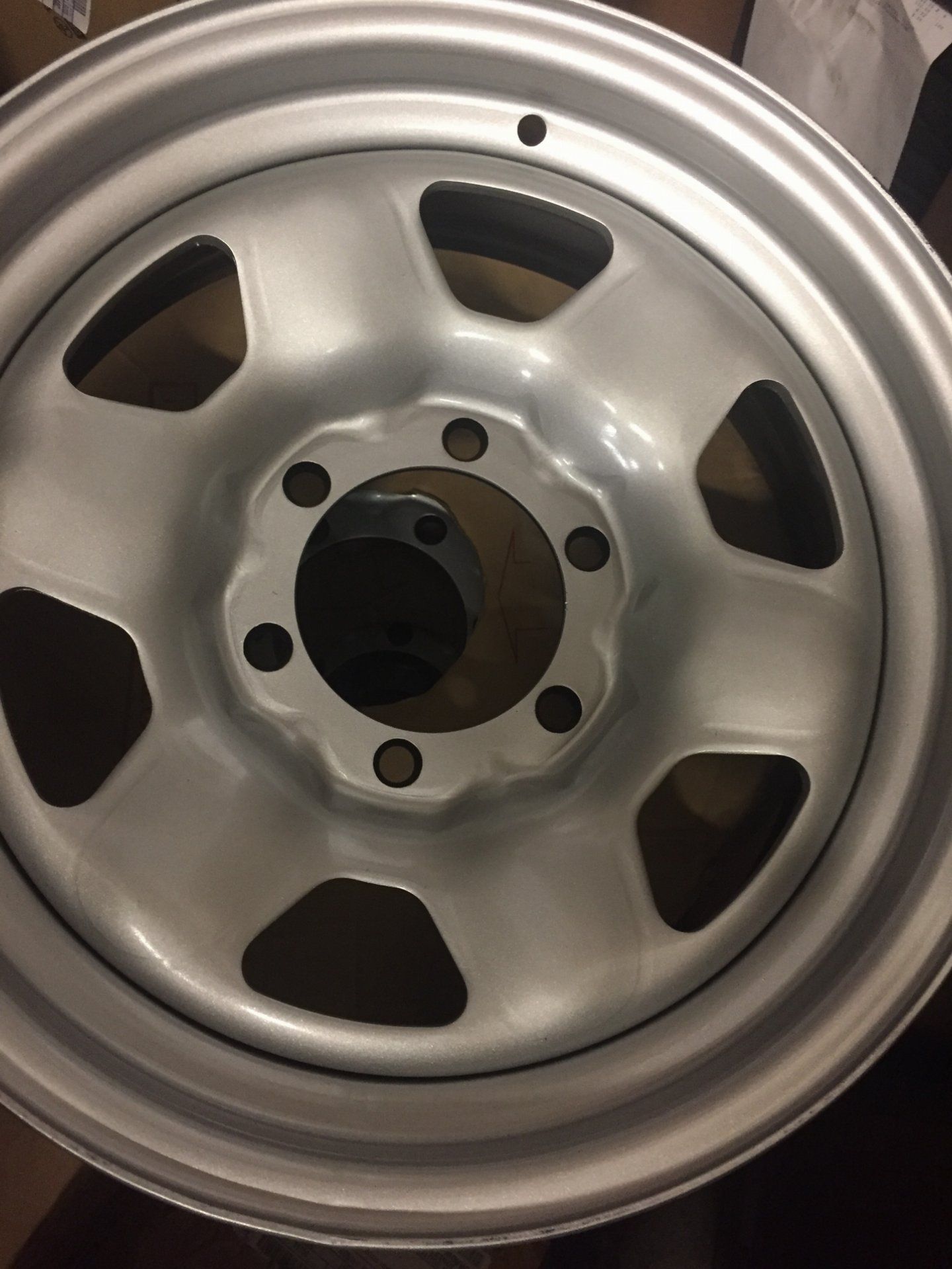

For anyone interested, I recently found out a buddy of mine does wheel manufacturing for Raceline and also does all of the steel wheel stamping and welding. Plan is to swing down next Monday and test fit their 15" blanks to see what fits straight off the die.
Apparently for the circle cut out style steel wheels, the stamping was modified to remove the inside lip as this caused rubbing on the caliper on tacomas so they were able to easily remedy. Once I test fit and find out what fits straight on to our trucks with stock brakes, I can list up the part number.
I'm hoping I can find a D-cut out shaped steel wheel to fit straight on to prevent any grinding of caliper/wheel.
