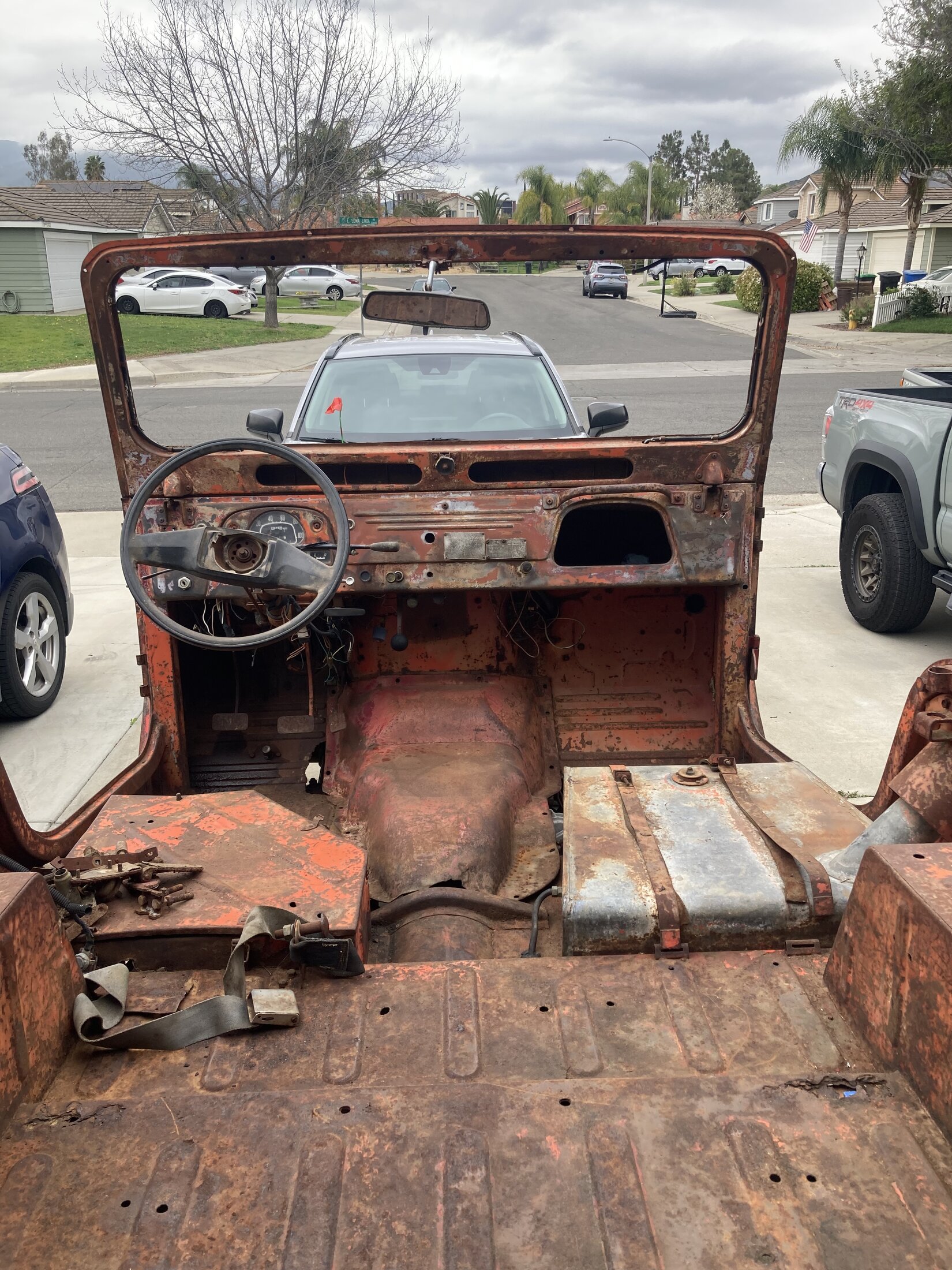

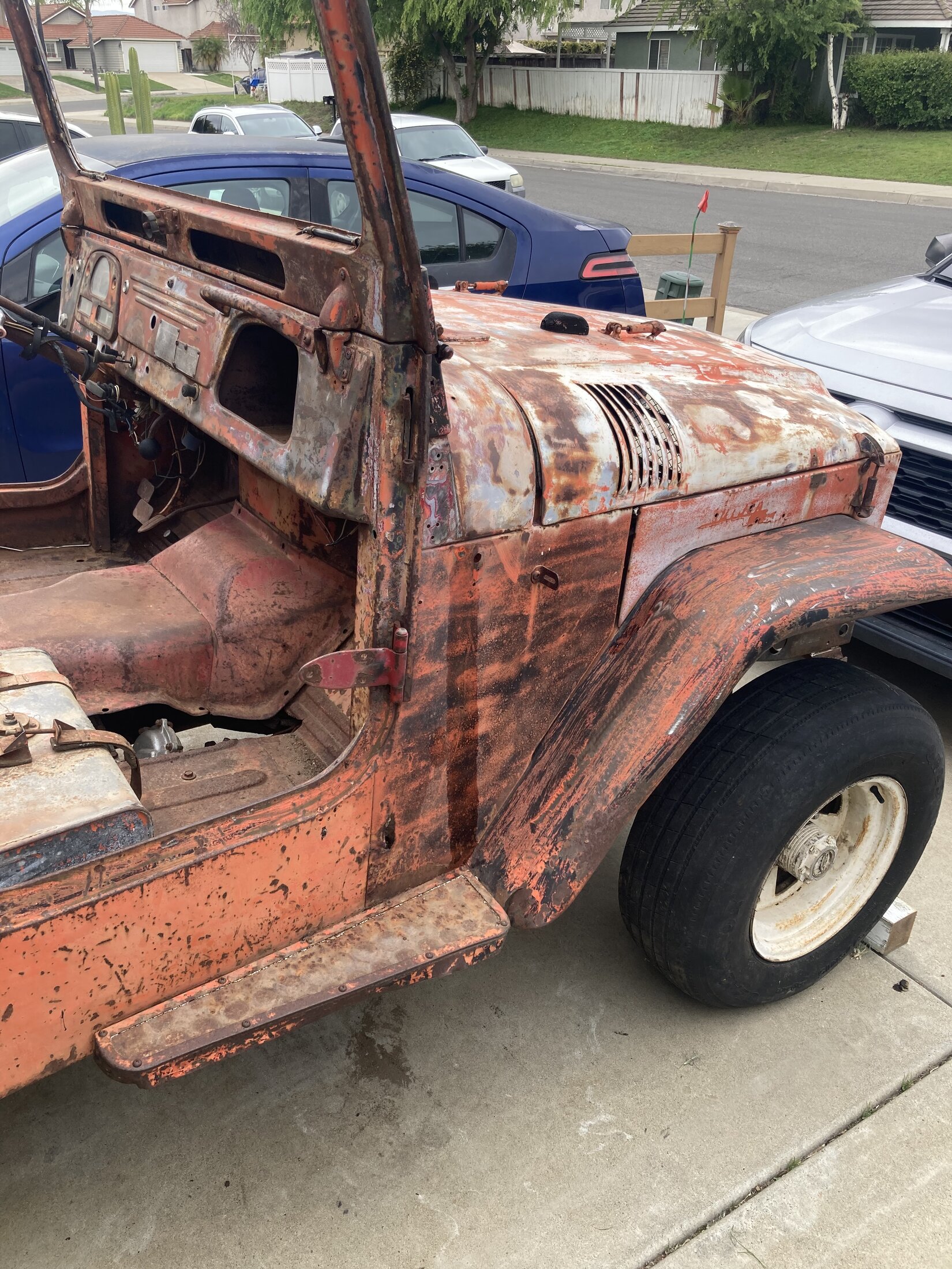

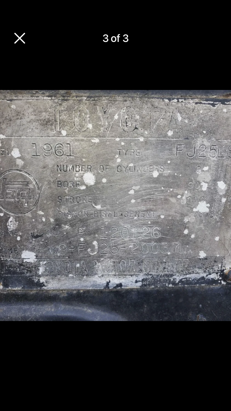

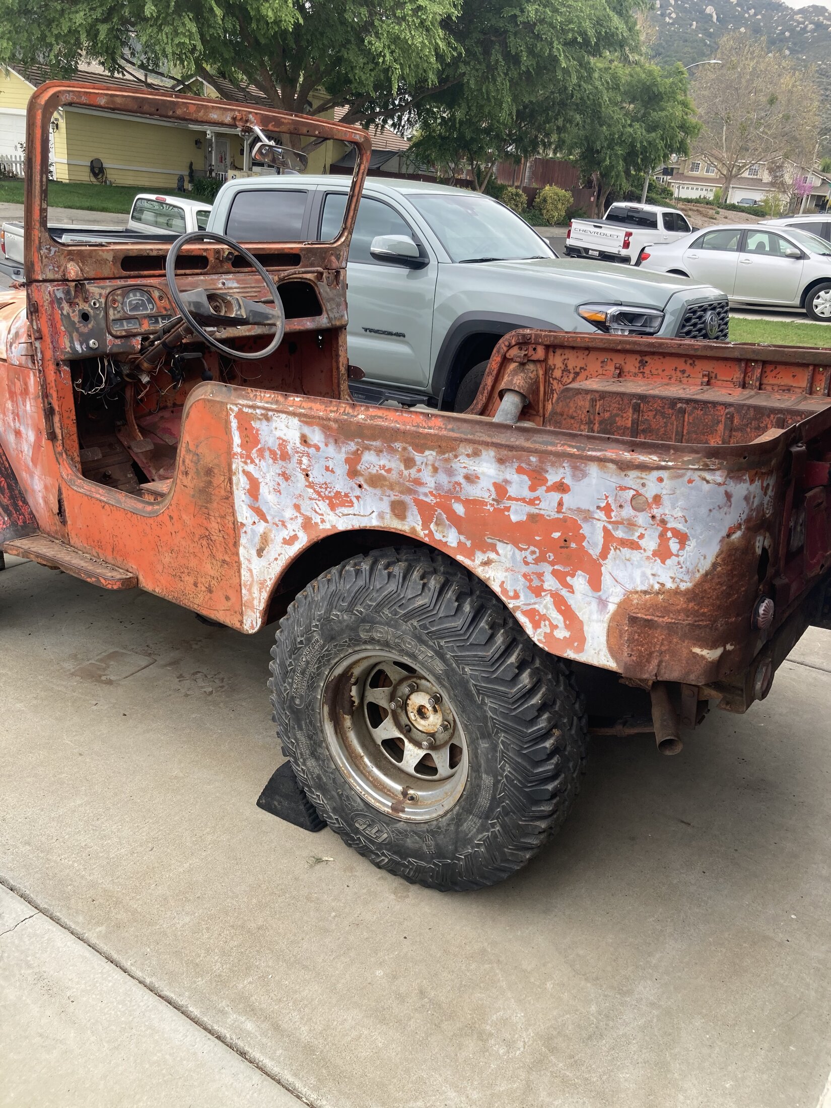

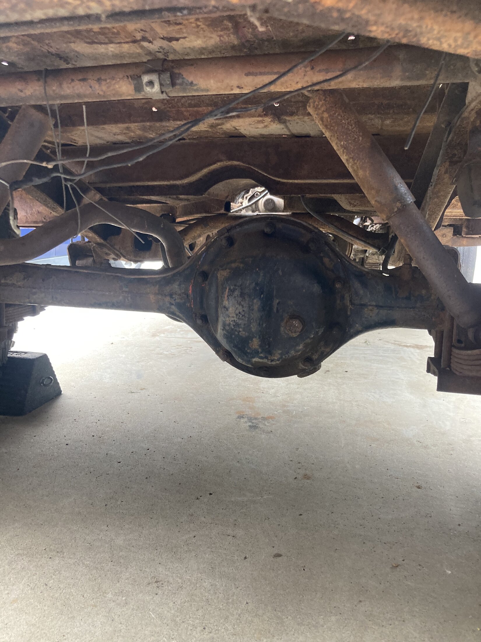

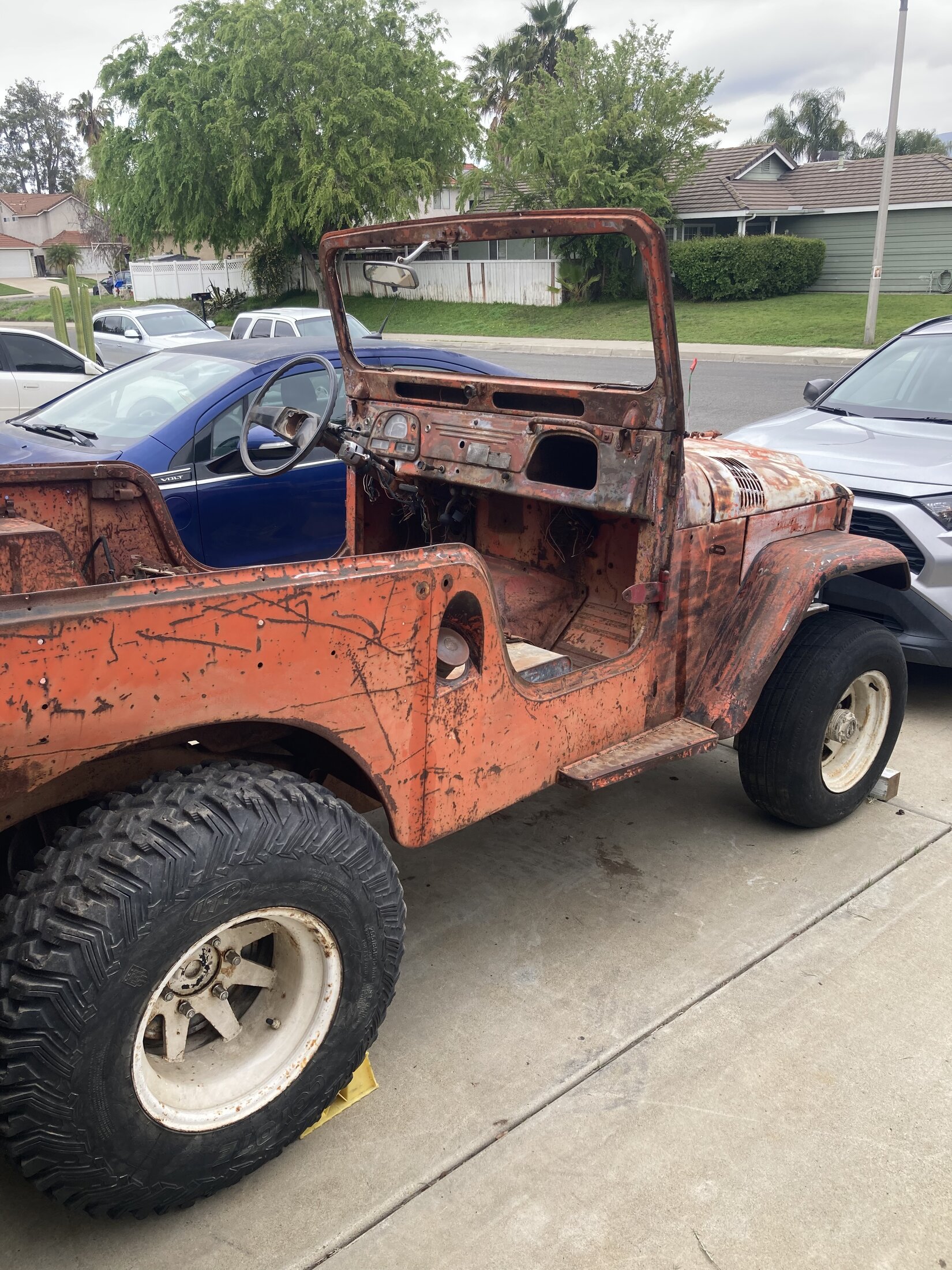

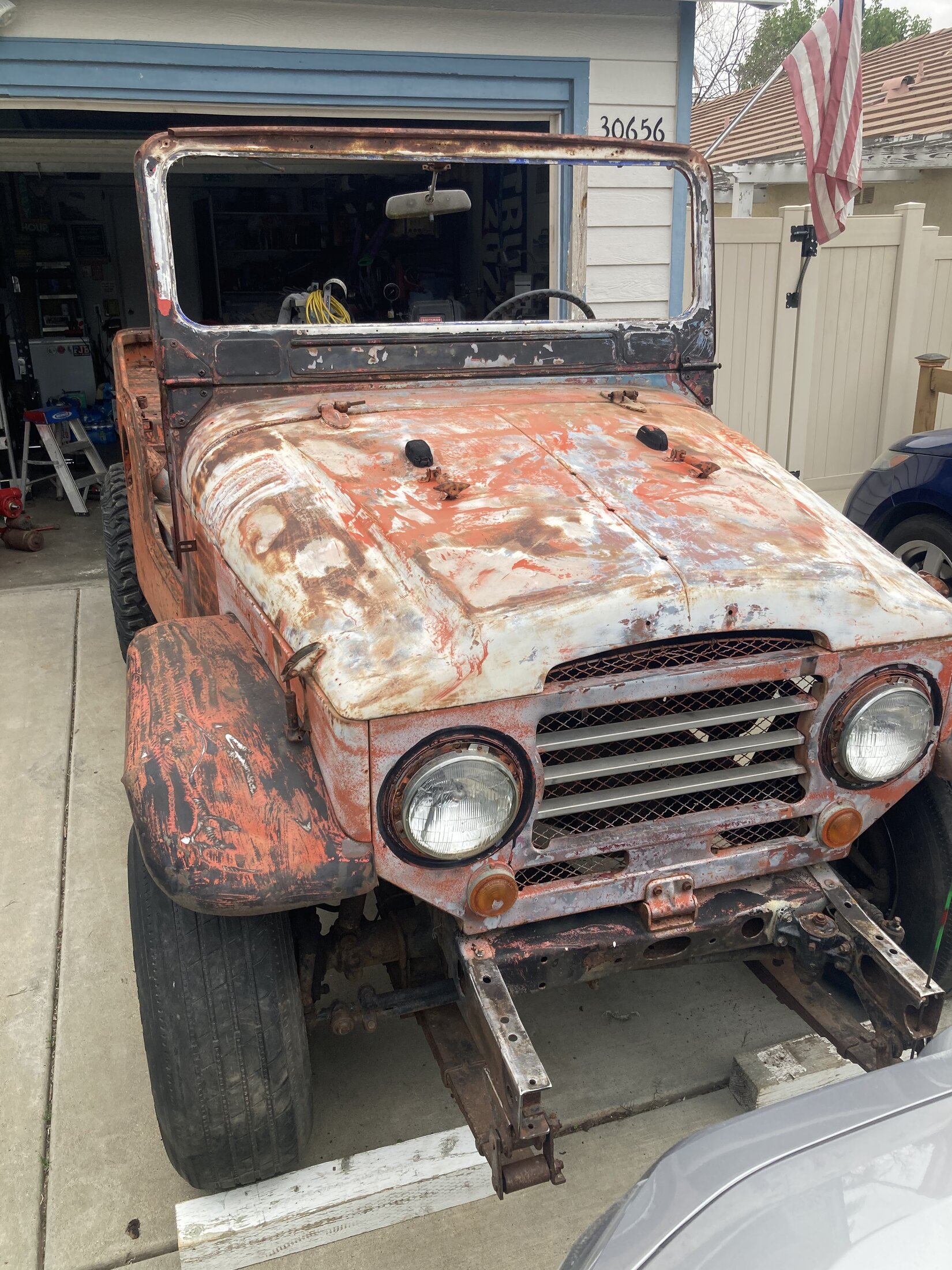

Heres some pictures. Very rough. I have some of the smaller parts in a box. The are more pics but it only allowed 5 files on my reply

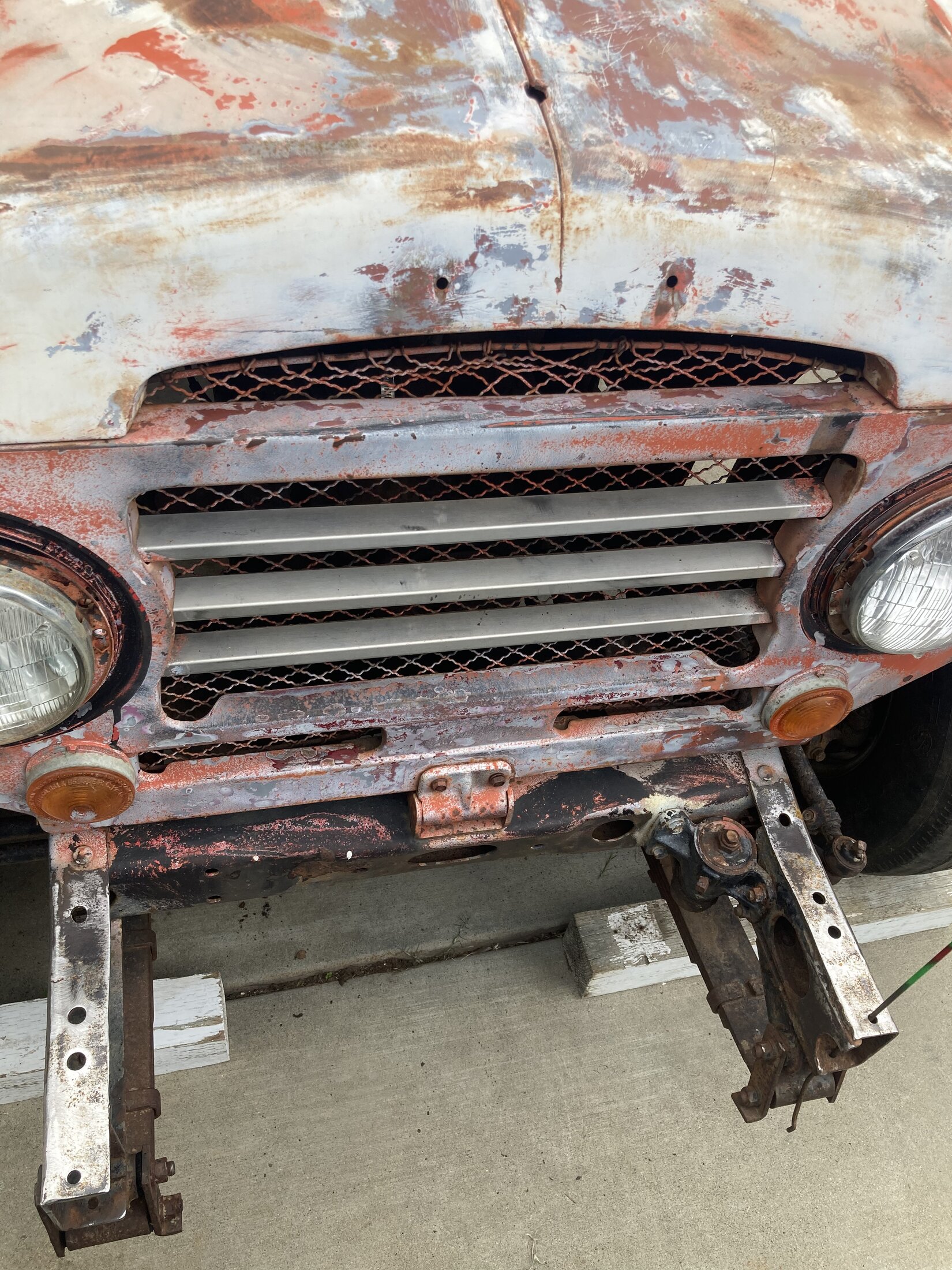

Yeah, looks like early FJ25 b-type body on an early 69 + frame, home made grill bars and FJ25 gas tank.
Fj40 parts added, 4hi/4low lever under the dash, three on the tree tranny cover, 3 speed transmission with column shifter , one hard top door hinge, parking brake, newer gages put in older cluster bezel.
Awesome! Thanks for the pics! I see a couple rare parts still left (I think that is the large gas cap?). This one proceeds anything I have so I don’t know for sure.

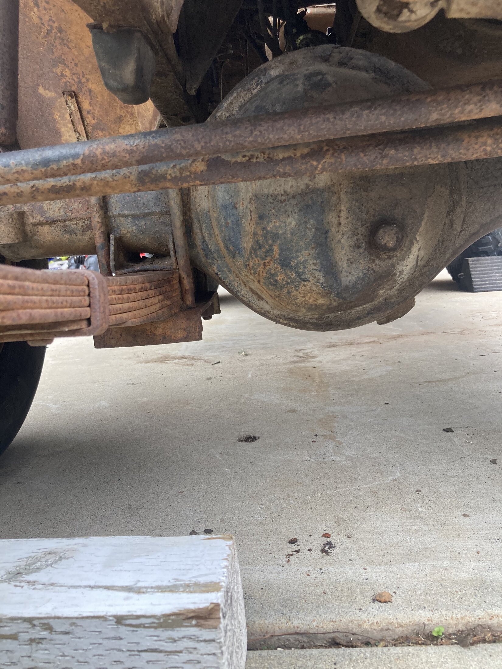

Does it still have the centered rear diff?
I thought the early trucks were a full tailgate and not split. But again one of the experts here will know for sure and correct me if I’m wrong.

Sweet ride! That thing would be absolutely rad as a cruiser if you just saved the patina look and did a drivetrain upgrade. I'm in the area and have a few 40s if you need to put your eyes on complete trucks or get some ideas.
I’d be pumped with that body. Agree with EWheeler id save the patina it tells a story. Lots of decisions to make as far as what you want to do with it. Seen a lot worse of start for a complete restoration also. But if your going for a beater to have fun cruising around agree with @nuclearlemon sell off the hard to find parts to the guys in here doing full restores replace with 40 parts and drive it. (Gas tank, gauge cluster, dash plates. Or shoot see if anyone has a 40 in close to same condition to do a trade with. What’s under the hood? Anymore hard to find parts.

25 gurus is the mesh behind the grill correct for 25s if so at what point did it change to the expanded metal style. My early 45s are the expanded metal style without the Toyota emblem. In center since both are landcruiser embossed bezels
