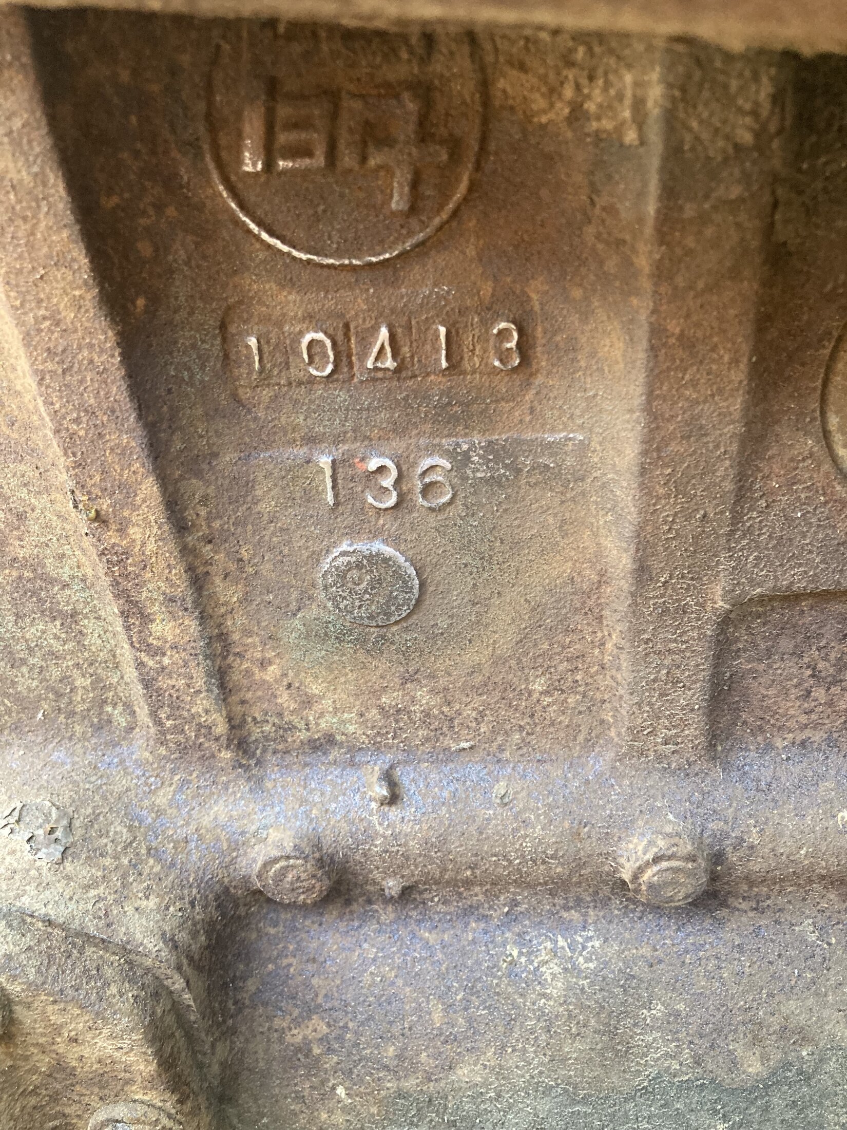

Maybe one of you can tell me the engine year? Ill attach a photo of the id.
Post a pict of the driver’s side of the motor under the manifold toward the front. There should be a Teq symbol with some numbers underneath that that are the block casting date stamp.

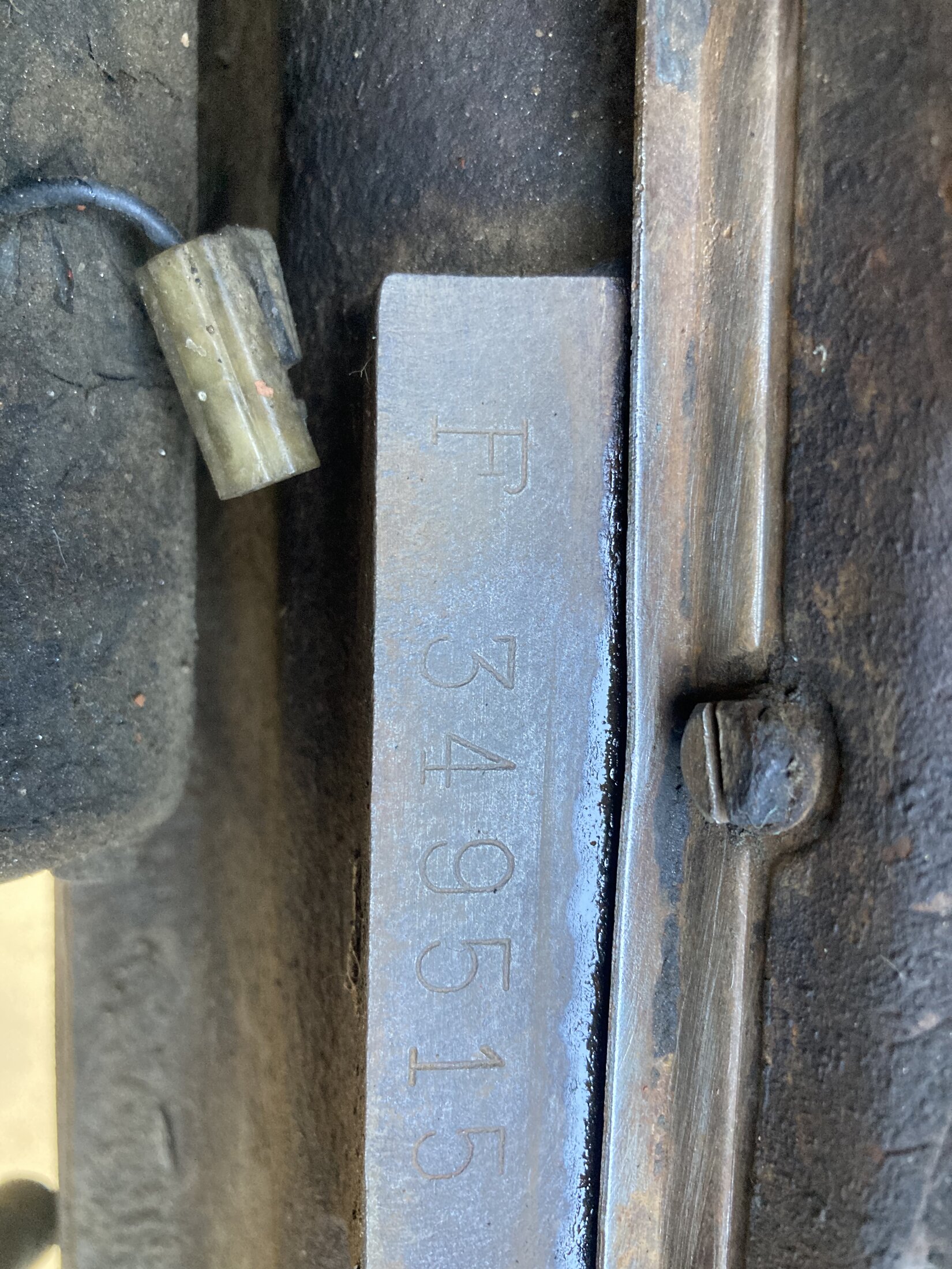

That makes sense. I believe the engine belongs to that frame then. When i had the numbers ran to make sure it was clear i was told frame number was april of 71. I wonder what the story was? Maybe someone liked the 25 body and thats what they had? Or maybe a lazy engine or running gear swap so to speak where they just threw the body onto a different chassis because they thought it was faster or easier. Who knows. The orig frame might be out there somewhere😕
April 13, 1971. Not sure but maybe the 136th casting on that date.

What’s the info on the VIN plate on the passenger side of the firewall? I can’t see the detail from the pic. Or is that just the shadow of where it once was?
