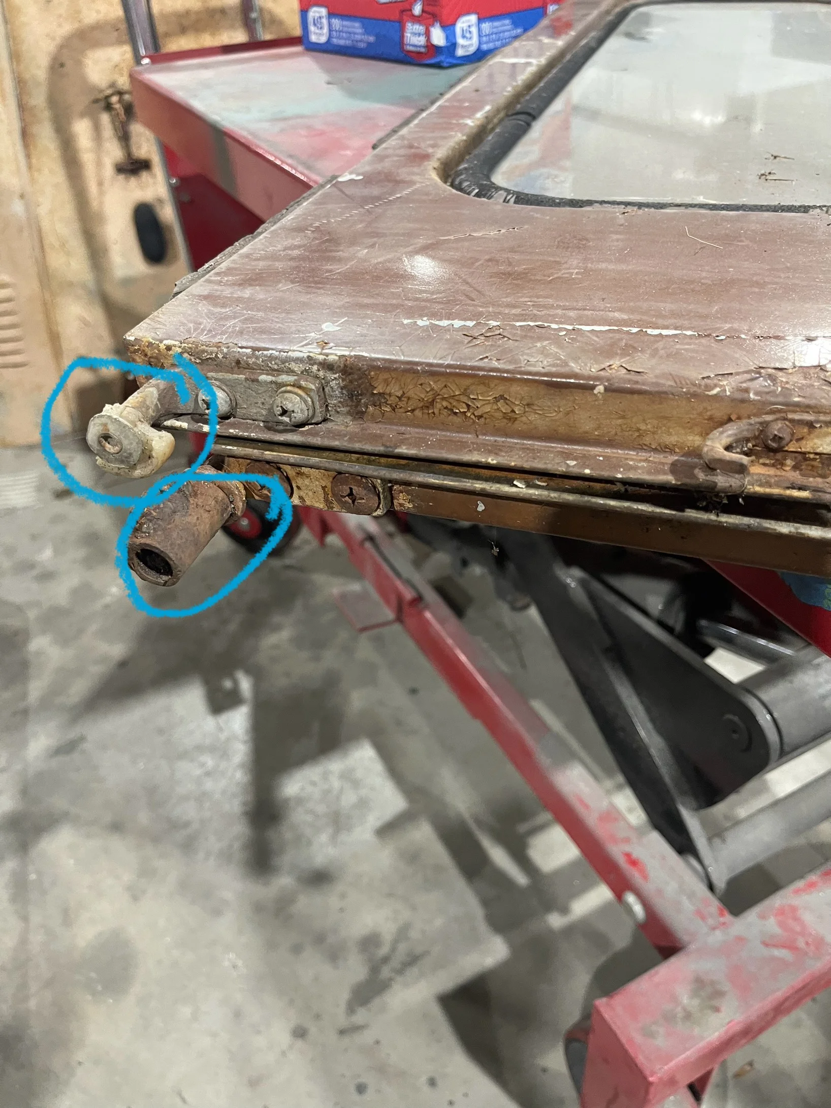

Anyone know a place to get the plastic wheel and the two (comma shaped?, if I remember correctly) pieces that go on each side. The one I’m working on they are broken.
Also what’s the best place people have found for the seals?

Haven't found a replacement for the white wheel yet, the hinge pin could be fixed maybe?
Window seals can be found at SOR or look around for a universal one.
Door seals, Bi-fold Door Horizontal Weatherstrip for '62 to '64 Land Cruiser FJ40 - https://www.cityracerllc.com/products/bi-fold-door-horizontal-weatherstrip-for-62-to-64-land-cruiser-fj40
I used this in place of the plastic wheel (that’s a crap place for a plastic or nylon wheel, not one of Toyota’s best designs). Drilled and tapped shaft for a threaded screw with brass washer to hold it in place.
Ball Bearing, Light Duty, Open, for 1/4" Shaft Diameter and 7/8" Housing ID

Hey, did you ever find those parts? I just got one with the bifold door and the entire bottom piece is missing. Did you by any chance find them or could you send the measurements so I can try to make a pair?

The plastic bearings I ended up ordering the metal ones from the link above. I have not found the comma shaped pieces from anyone yet.
