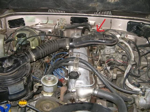

where exactly? got a zoomed out pic?
Look straight down over your engine, all the way to the rear, you'll see the plastic cap (or if lost, see the picture in the first post).

I'll put it in there. I havne't looked at my engine bay yet to see where the thing is, but will someone snap a zommed out pic of it for postarity?
Its about right where the red arrow is. Near the very back. Its not really on the drivers side or passenger side, kinda right in the middle. You can see it best from the passenger side, but get to it best on the drivers side.
Hope this helps.

this one doesnt it was just a picture to show the location haha:doh:
