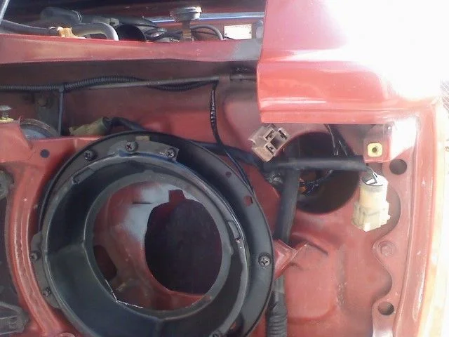

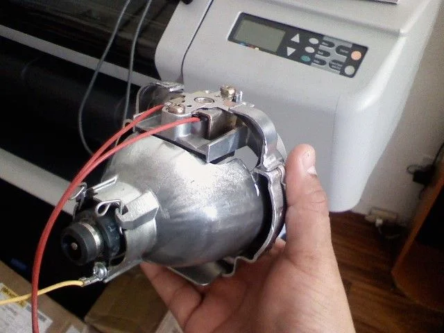

I got tired of the sealed beam look... "so 80's". Anyways... I bit the bullet and went with the bi-xenon retro... Don't want no rice rocket bling! Want the real thing. started with a bixenon from an acura... and ordered them ebay cheapo h4 headlinghts (should have paid more for the DOT approved ones... less police ussues...LOL) grabbed the dremel got too it.

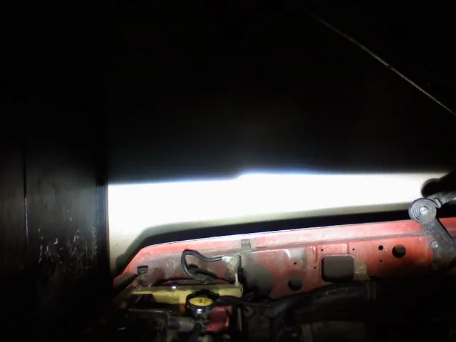

Old 03-25-08, 12:30 AM   #2 (permalink)
250+ Club
GAS-A-LOT!'s Avatar
Join Date: Oct 2006
Location: LOS ANGELES
Posts: 914
I was even able to give it that rainbow flicker that comes from them expensive cars.... not all of them have the color... these are white and had to be modded

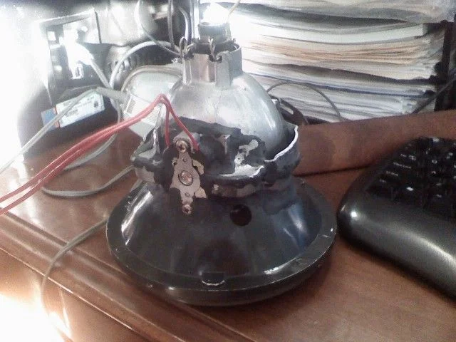

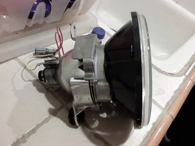

this is the progress so far.

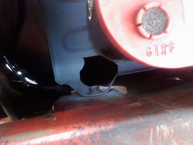

These are the issues that I need help on. I'm looking for something to seal both the housing with the projector. It needs to resist heat. I can easily use epoxy or JB weld. But there are gaps over 1/4" wide on the projector housing that I need sealing. I have limited room behind the headlight housing. Need some suggestions. oh AND all the trim on both sides have been removed...

Red High temp? Good up to 600 degrees. But they look great!!!

I can hold one with my bare hands for about 15min... as it warms up a bit. then I could only hold from the trim.... I'm guessing no more than a halogen.... Mostly all of the oem housings that hold the projectors are acrilic/pvc/plastic? and dont have any issues. I'm thinking no more than 140F? when we bake the oem housing to soften the seal, I was told to be careful not to over bake because the reflector housing in the projector will get bubbles. And the cheapo ebay h4 lights were overbaked w/out any issues... I guess I can use JB weld even for the big cracks?

red hight temp? thats the name of the sealeant?

Old 03-25-08, 07:20 PM   #8 (permalink)
250+ Club
GAS-A-LOT!'s Avatar
Join Date: Oct 2006
Posts: 914

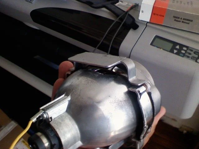

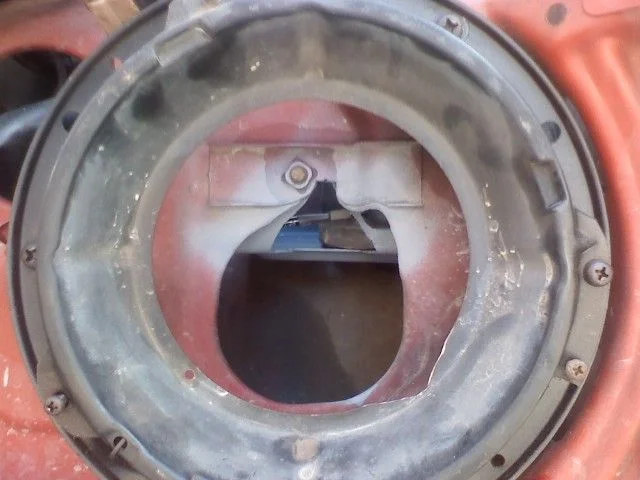

looks like it needs about an 1/8 or a 1/4 more for a fit... with aiming though.... I will have to cut. looks like it will just miss the battery tray. Would it mess up the strength of the nut that holds the battery tray?
__________________
HELO?....is this thing on?
1991 fj80 's but I drive it, suspension air bags, roof rack, trailer 8pin connection, 7 pin mod, hood spacers & stolen radio. 1985 fj60 (DD)HID-xenon retrofit projectors, tailgate storage, rear seat shoulder belts, 62 rear sway bar, & roof rack. 1987 4runner, seat bracket spacers(4crawler.com), driver side battery, HID-xenon retrofit projectors, & modified/upgraded intake, rancho shocks.
WWW.RONSERRANO.COM
GAS-A-LOT! is offline   Reply With Quote

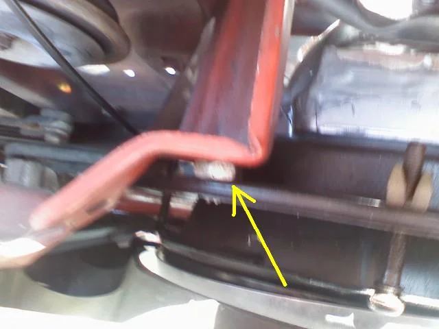

Battery tray nut should be fine, cut away!

thanks for the push boots.... Ive cut to were I cant cut no more...

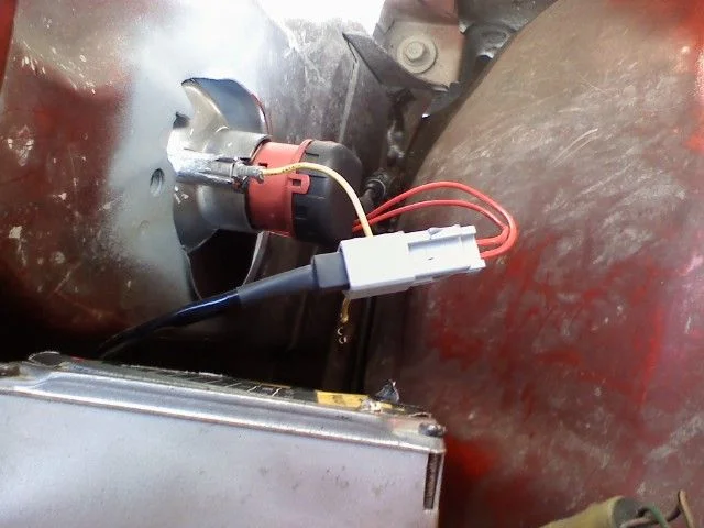

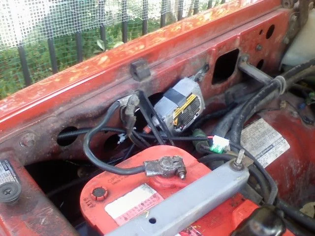

Tapage.... YES!!! IT will be a killer improvement. I finally made it... I was able to put 3 nuts at each screw as spacers..about 1/8" I think. That was able to give me a little wiggle room. I will see how level it is tonight.

Please let us know how much charge it place on the alternator ...

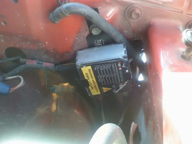

TAPAGE....35 watts.... I does pull like 25 kilovolts? for like a milisec.. You want it to come from the battery because the oem wiring is not enough even for oem lights.... They are good enough for a relay'ed harness though.
Here is the kit I used.eBay Motors: HID XENON CONVERSION KIT H1/H3/H4/H7/H9/H10/9005/9007++ (item 190209286981 end time Mar-27-08 18:32:52 PDT)
I bought this cheapo kit about 1.5 years ago. Mainly for the ballast($100). It's cheaper now... Don't bother with any waranty, most if not all will close shop and return under new name within a year or two. I got some D2S adapters from Retrofitsource.com ($15?). Phillips D2S bulbs $40.... I think they cost more now, you want 2 go with original bulbs due to better rep & reliability. Originally, I used relays to pull juice directly from the battery. But I was able to score a bixenon specific harness for 35 bucks! It works great! & I'm able to keep the high/low function.
I ended up using alot of epoxy 500F resistant. I'm waiting for it 2 cure and.... OH YES! their will be light! on the driver only for now....

This is how it looks so far.... All epoxied out!!!!!

K guys... I finally finished cutting/priming the battery tray....
Now all I need is to finish up the 2nd light and wire the high beam thingy and were good to go.... I will get pics tomorrow...

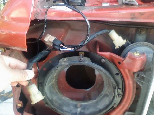

All I need is to finish epoxy'ing the 2nd light(started but will finish later...got company). I will finish off with jb weld around the seams were the epoxy meets the light.
Here are some pics. If you got any questions on the pics, let me know... left, right, cuts @ battery tray, And ballasts.

I'm DONE!!!
First pic is showing the spacers used to pull the headlight fwd.
2nd is showing the high beam connection
3rd is the final Product!!!!! I will try to get pics tonight.. I will be @ church! That way I can level the beams and get an output pic.
