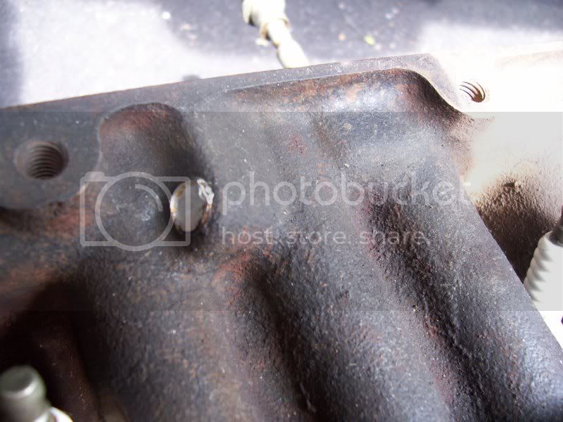

AFAIK this is only on the 81 and newer 2F & 3F heads, I was looking on an older head and it appears as if Toyota did something different on them like it's welded or epoxied, I have never done anything to these heads or seen one leak

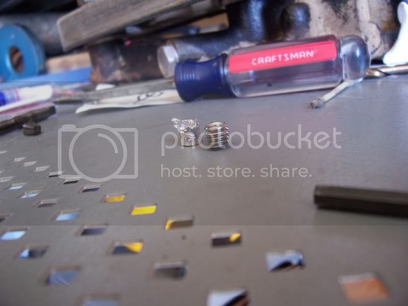

Does anyone recall what the factory plug is made of? The one in my head looks like it may have been messed with before?

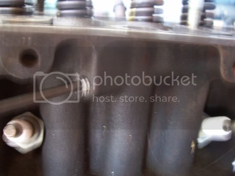

You were right, it was factory. Got it out, halfway through the tapping job the tap broke off flush. brutal.
:doh::doh:
What size tap? was it a tapered tap? Plenty of oil? Cheap tap?
I use a tapered tap, Snap On, plenty of oil, done at least 10 with the same tap with no issues....:doh::doh::doh:

I used a high quality that was handed down from generations before me and moderate oil. I think the problem may have lay in the fact that I used a 1/4" bit rather than a .257" simply because I couldn't find one. I though the bit may have been .007 out of spec and would compensate. The first half of the hole length wise is wider than the latter half, this is where the tap broke. The 1/4" bit did not even engage in the first half. I was able to successfully remove the tap without damaging the thread and install a slightly shorter plug than I expected.
