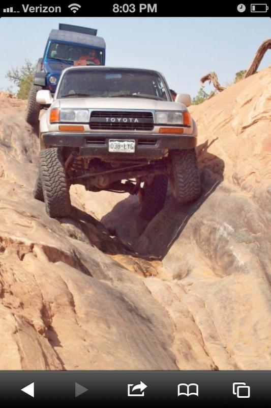

Speaking of flex, anybody know the details of this 80? Never seen it before. This thing can flex nasty!
Hmmmm. With no reverse lights I figured the video was reversed. People at the end aren't walking backwards though.
Nah it's not reversed. Here's another version going forward
