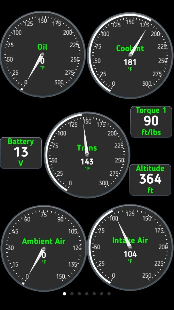

Ultragauge Blue Install and results- This week I did a few things- one of which was installing the new Ultragauge Blue. This is the new Bluetoooth version of the well accepted wired Ultragauge. I understand it has only been out about 6 months. One of the great features is that you can download Manufacture specific gauges not availible on the wired version- most notably Transmission Temperature!
Does the oil temp gauge actually work? I have the PID for Trans temp working in EngineLink and TorquePro with a $15 ELM327 OBD2 Wifi scanner, but so far I haven't been able to get the oil temps
No oil temp. I realized after trying. That is for diesels I think only. No codes for Toyota and I don't think it is logged anywhere. Same with ambient temp.
D'oh. Thanks. You got me excited there for a moment.

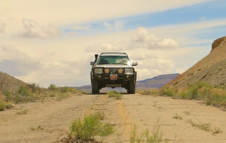

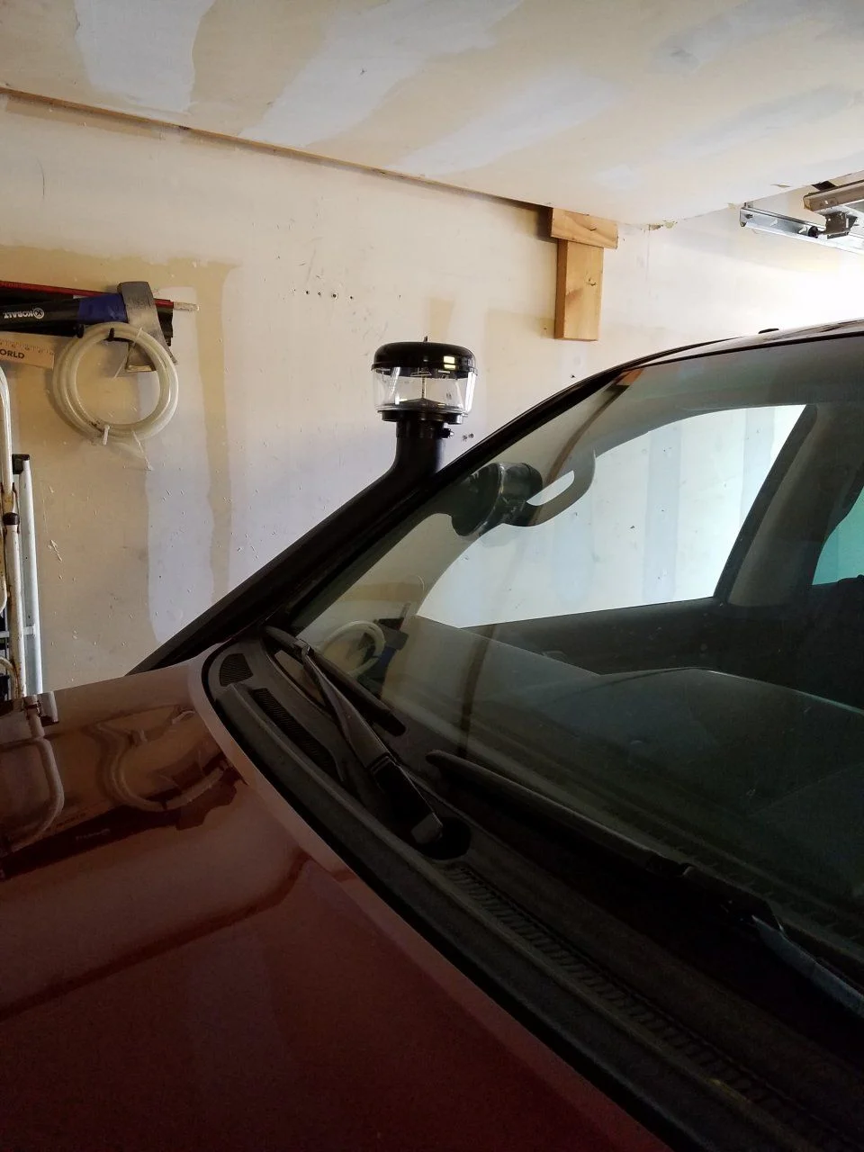

Added a pre cleaner to the snorkel.

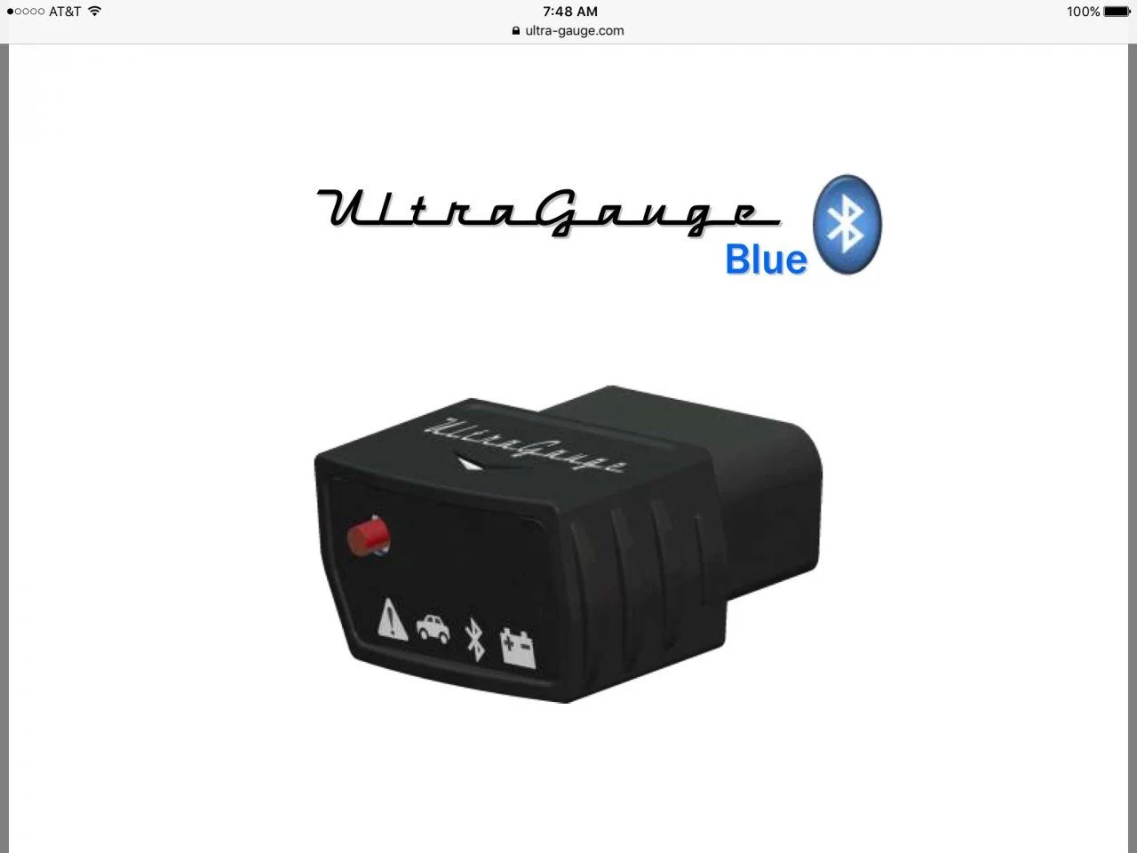

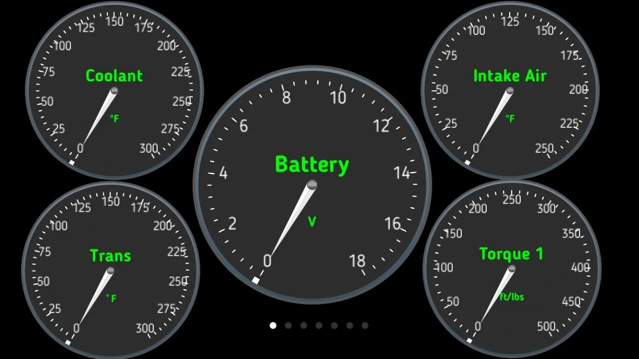

You must order direct from the factory and it comes rather quickly- but the instructions need to be downloaded from the web site. It is pretty intuitive- got it working without instructions. This thing is very cool in that you can customize any gauge, group them how you want, even set alarms and have the screen scan from one page to another. All the features of the other Ultragauge and more.
It is basically what I I really wanted as I don't have to mount to my dash or steering column- just use my phone on my existing Ram mount. Since I used my iPad for Navigation while over landing- my phone becomes the Ultragauge screen.
Did I mention you can download other people's screens and upload yours too their cloud to share with your friends?
In my book, the Ultragauge Blue is Ultra-cool.
What kind of transmission temps do you see? Whats your climate?
I just got it so not sure. I'm in Houston. Will know more next week when it I'll be 90 and I will be the Lone Star Jamboree in East Texas doing trails.

Is that a 7.5" or a 10" pre-cleaner? I had a 7.5" or maybe 7" on my 100 and it didn't like it - I switched to the 10" and it worked a lot better.
Pretty cool to see what you actually get caught up in the pre-cleaner.
Added a pre cleaner to the snorkel.View attachment 1253743

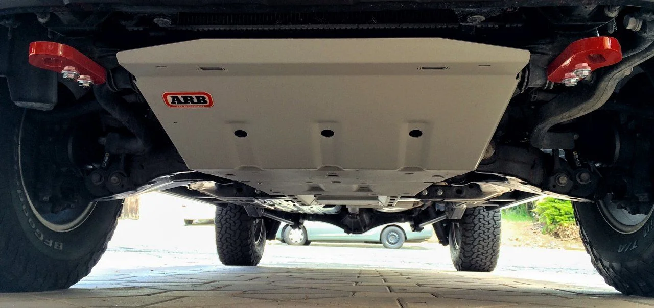

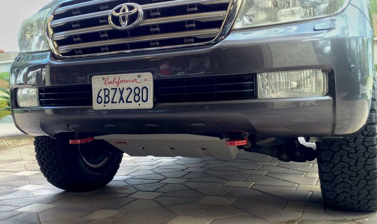

For an OCD guy, one sided recovery point replacement would never do...
Plus, two will let me use a bridle with equal force at both points.
Now I just need to scrape up these shiny-new skids between them... ;)
Anyway, my brain is symmetrically happy now that the 2nd point arrived:
For an OCD guy like me... One side would never do...
Plus, it will let me use a bridle with equal force at both points for recovery.
With my ARB rear bumper the factory row hook will not fit back on the rear support. The holes are centered on the factory bracket and a part of the bumper support is in the way. Looking at these, I think I could use one as the hole is off- centered. Pretty sure the bolts are the same size diameter.
Did it come with the longer bolts @Markuson ? I have used the rear row receiver with a large Clovis to get recovered in the past with no issues. But this this would be a safer point.
Yes. It came with two longer bolts & two washers. You torque it to 88 ft. pounds. It's like plate armor...2cm thick single piece.
I noticed that the standard-design (but larger than the 200) Tundra recovery points some here have upgraded to cost even more than these ARBs. These are about $85 each, which seems high to me, but the Tundra units are about $115 each on Amazon. Can't imagine anything stronger than this.

Fwiw, the 7" is under-rated for the 5.7L airflow needs, 10" is the recommended fitment for 4+L
Snorkel pre-cleaner:
I'm thinking that maybe this pre-cleaner snorkel-topper might fair well in a car wash compared to the standard scoop.
Maybe it's rounded edges wouldn't grab the spinning brushes like the mouth of the standard unit would. Hmmm... Might have to try it when I add a snorkel, as it is incredibly convenient to drive through my car wash an unlimited number of times on a monthly plan. It means you can get dirty any time you like...and with just an extra five minutes on the way home, it's clean as a whistle again.
What do you think?
