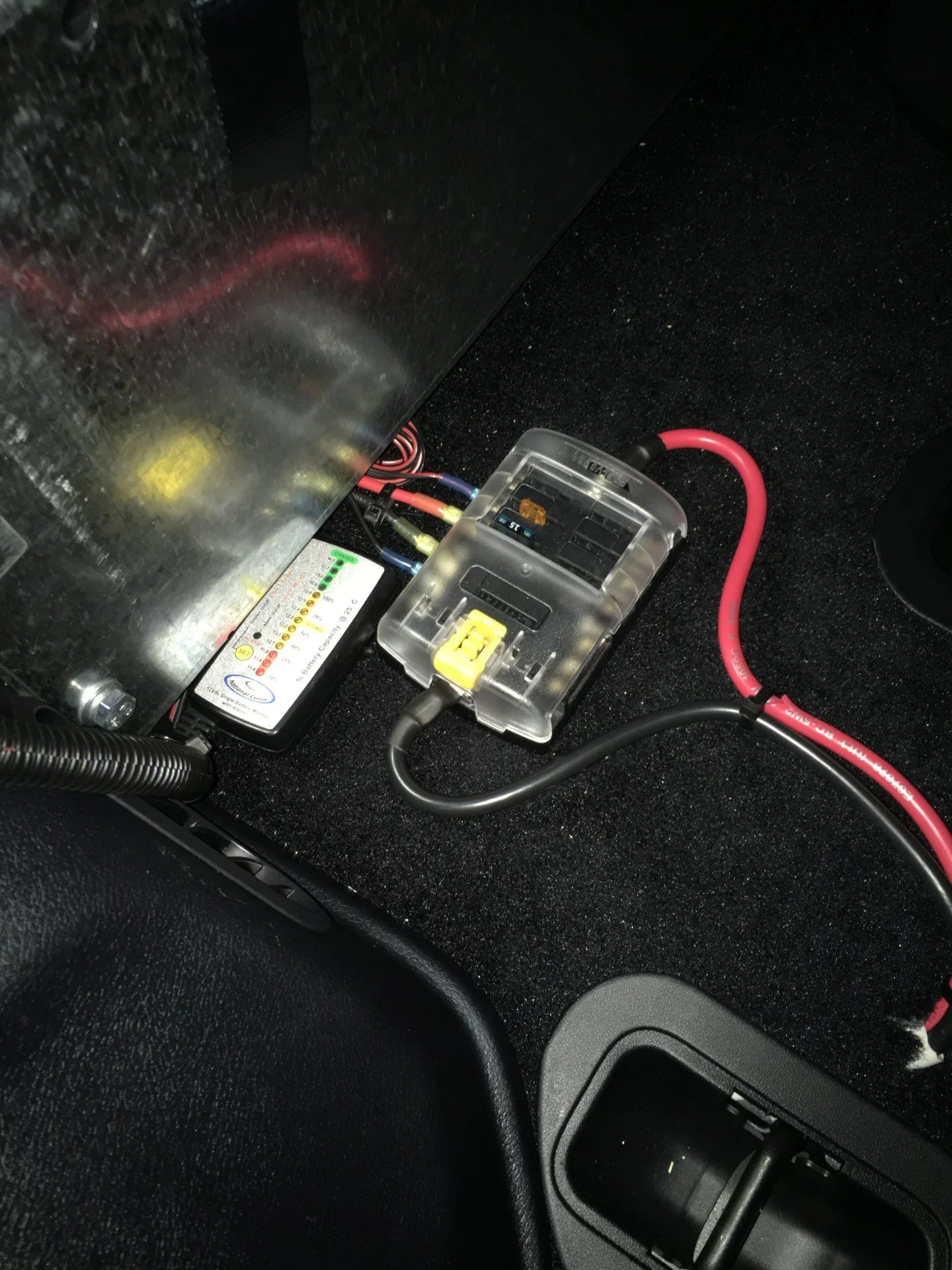

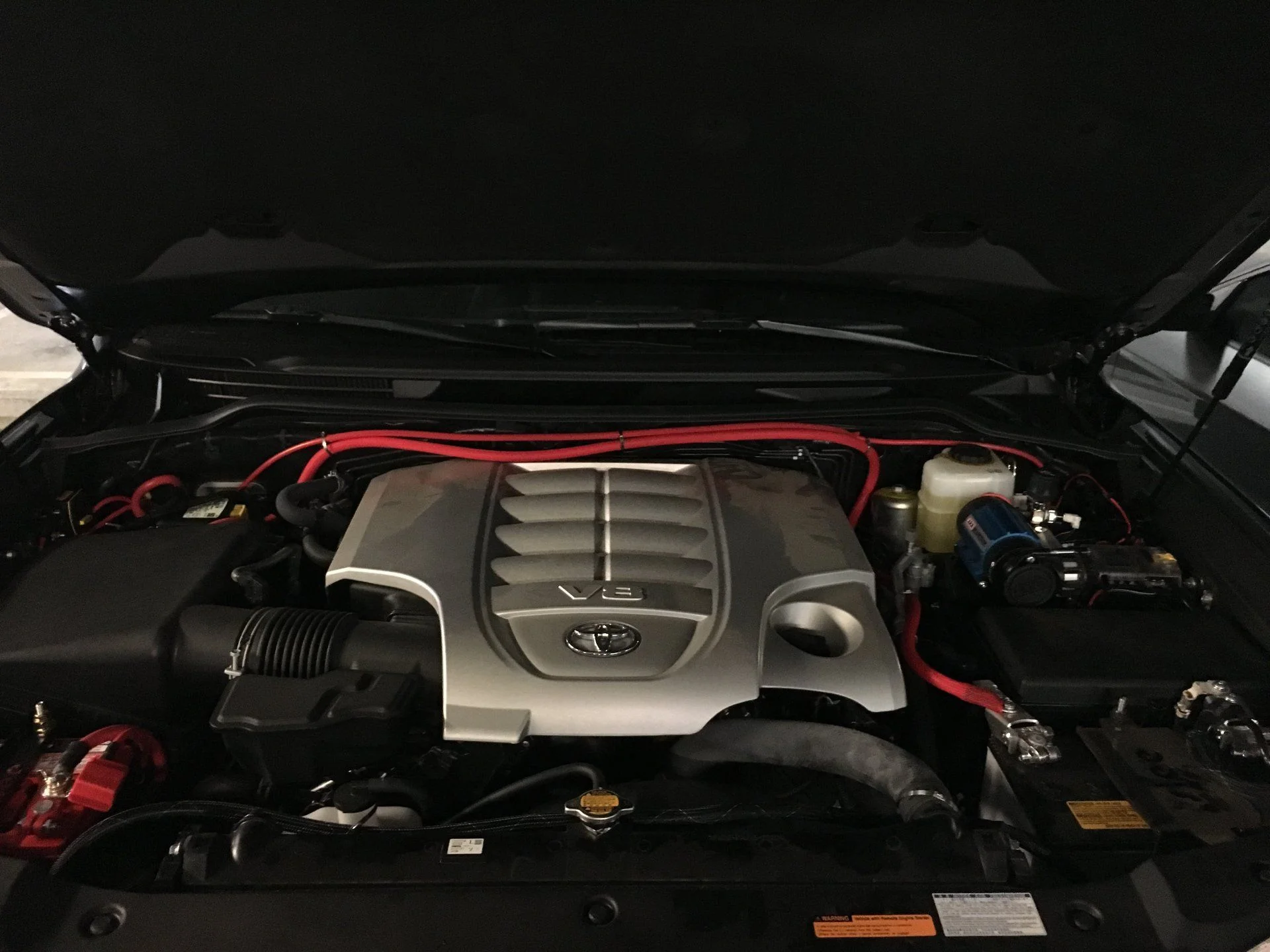

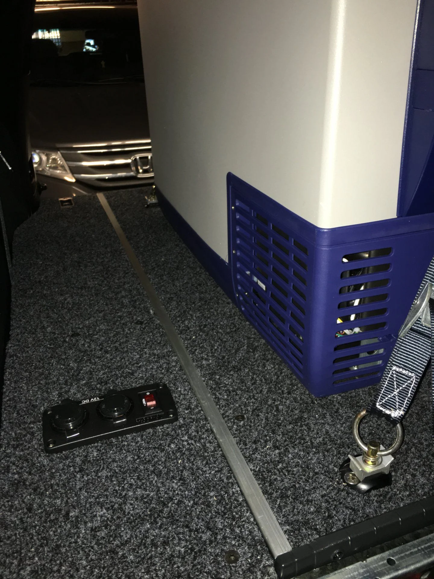

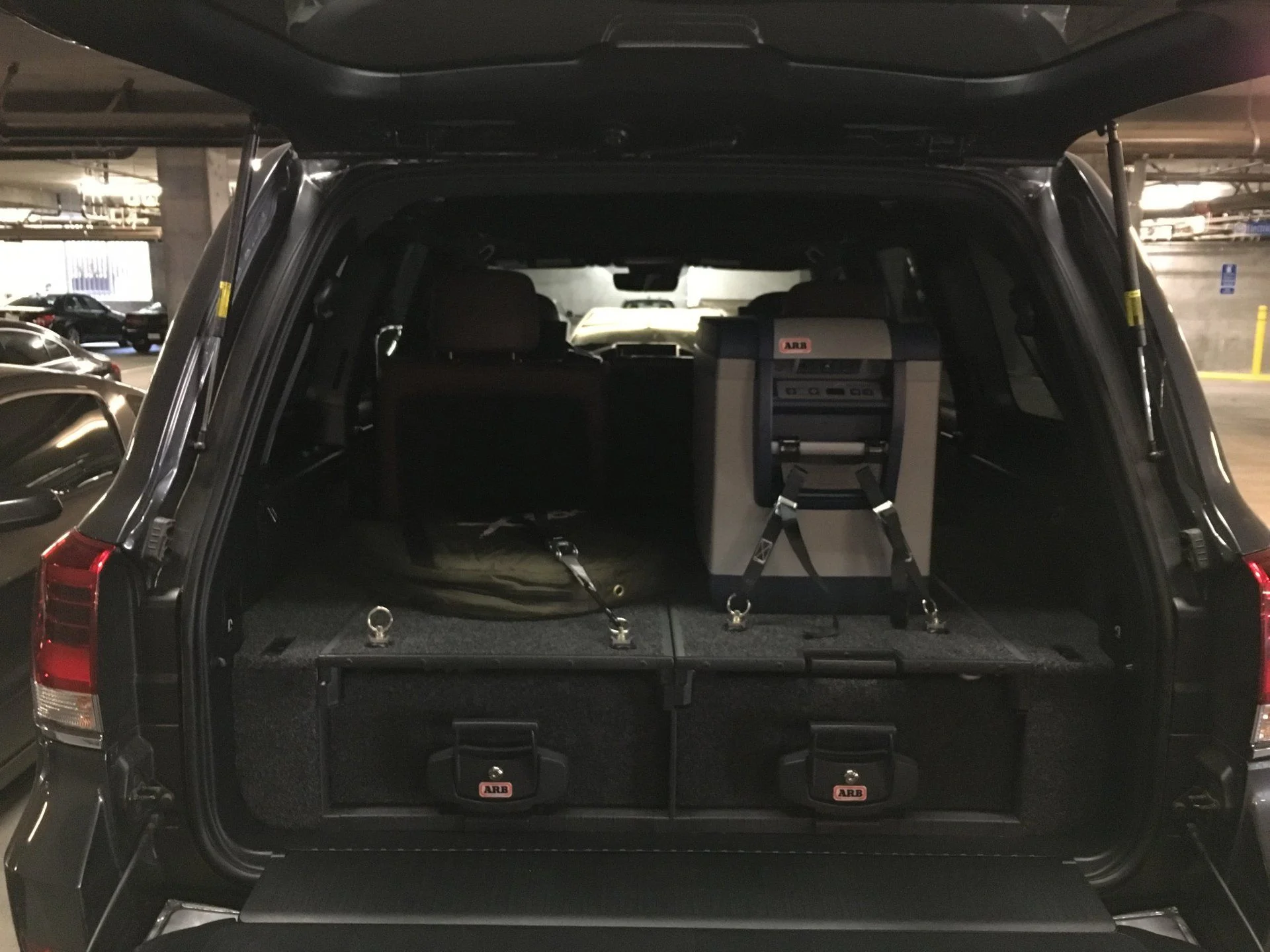

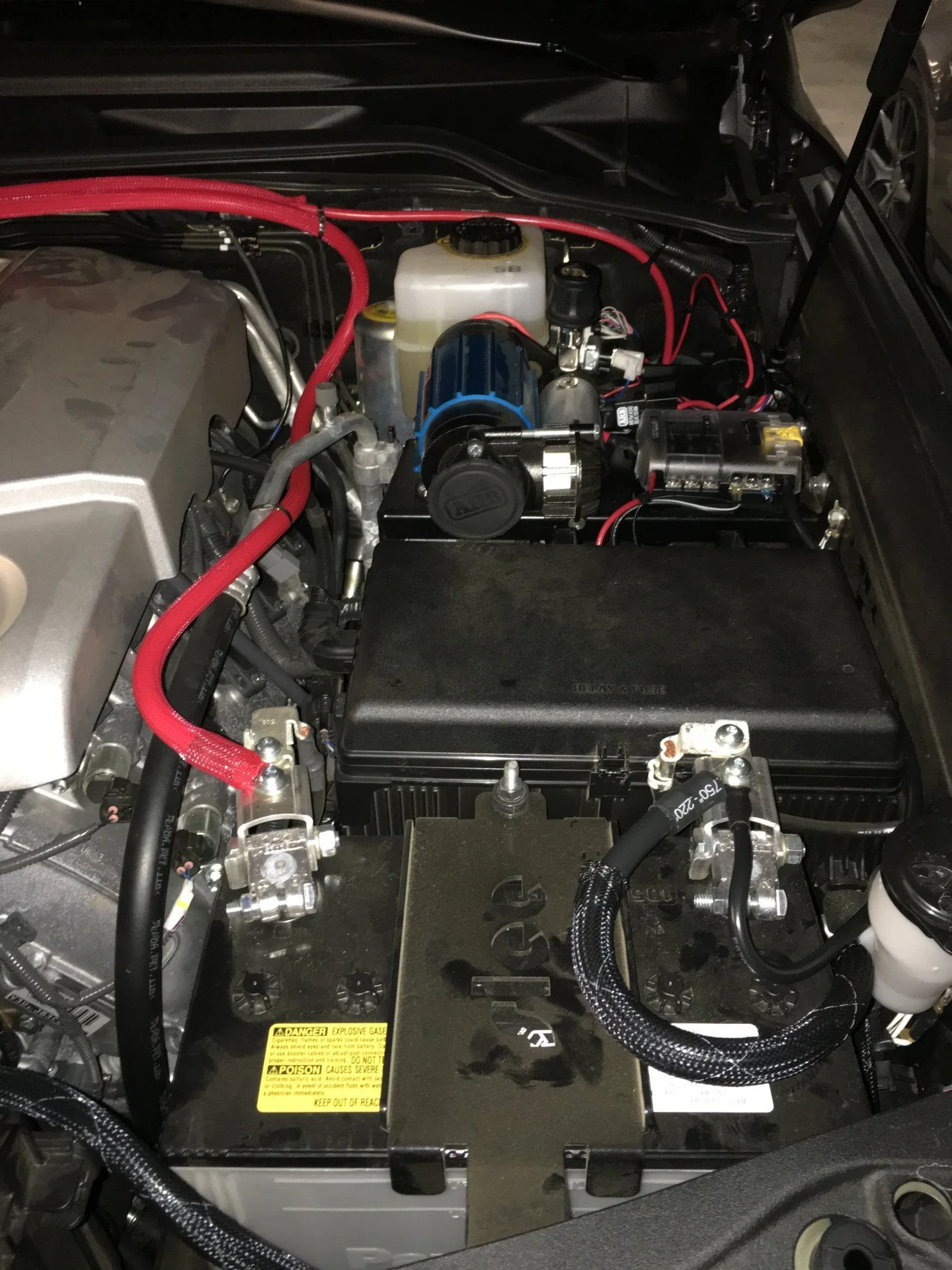

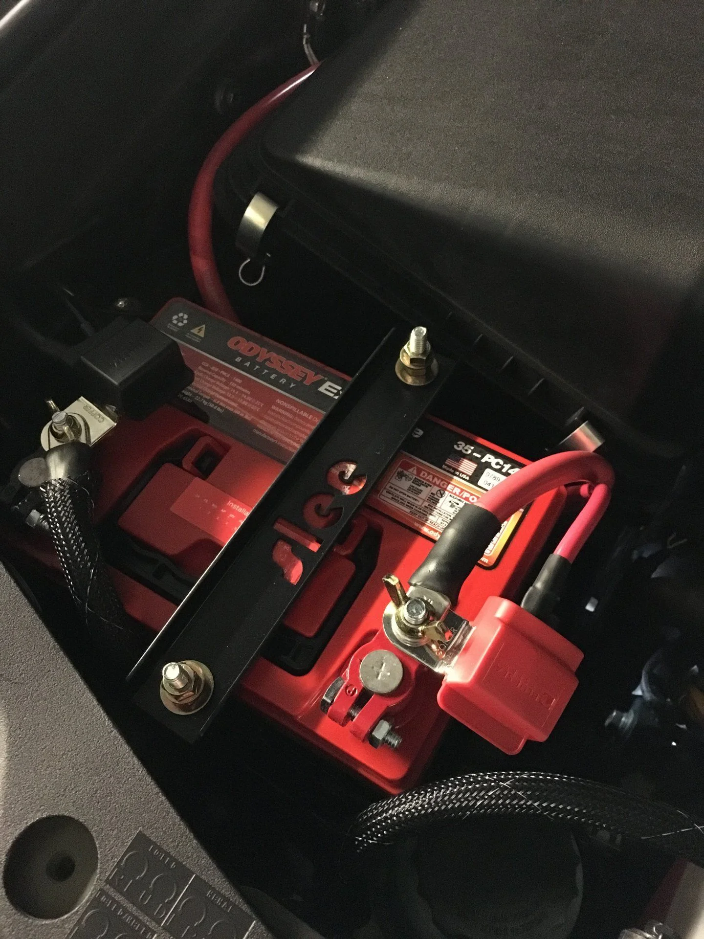

I installed a dual battery system system today on my '16. I decided on using Blue Sea's 7622 ACR to manage the isolation. There are fuse blocks in the engine compartment, under the second row seat, and in the cargo area.
The primary reason I went with a dual battery is for powering a new ARB refrigerator and air compressor and I'm hoping to supplement the system with solar for longer trips.
  • Slee Primary Battery Tray
  • Slee Secondary Battery Tray
  • Odyssey PC1400 Group 35 Battery
  • Blue Sea 7622 ACR
  • Blue Sea Fuse Blocks
  • Blue Sea Circuit Breakers
  • Blue Sea ANL Fuse Blocks
  • National Luna Battery Monitor (just for secondary)
  • 1/0 Marine Battery Cable
  • Assorted crimp connectors, cable lugs, heat shrink, wires, etc.
  • Hydraulic Crimpers, Ratcheting Wire Cutter
Overall, the process went pretty smoothly though it took all day to make all the cables, mount the components, install, and test.
