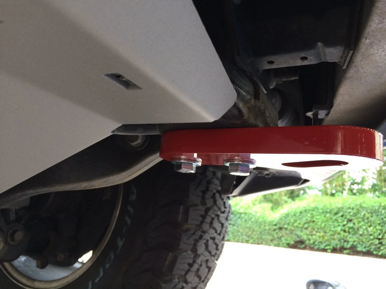

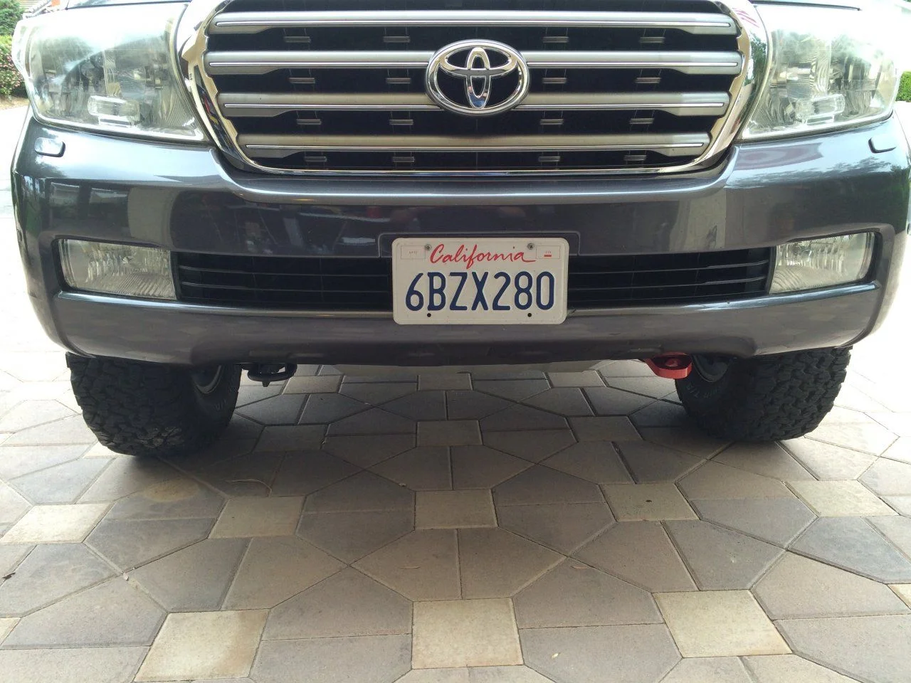

Replaced first recovery point with ARB unit. Flush and STOUT... (Thanks Kurt from @cruiseroutfit)

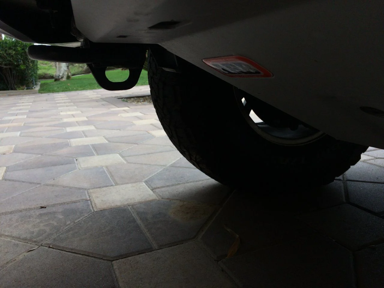

Compare side view for clearance:
Stock:
ARB:
Compare left stock to right:
I supposed you could just remove the lower point piece on the stock unit (two pieces), but the main stock ring has welds holding it together, where the ARB is literally just a single hunk of steel.
Not cheap, at $85+ per side, but wow.
--Makes the stock point seem rather convoluted and "weldy."
Don't think I'd dare do a heavy snatch from these:
Ordering a second for the right side...
