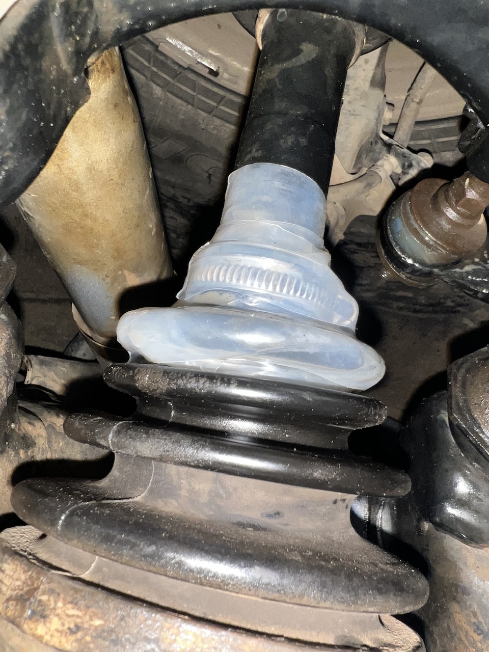

Replaced alternator and tried to patch a split cv boot with silicone tape. It split 1/3 of the way around right behind the clamp. That silicone tape sticks to itself with a vengeance, so we’ll see. So far it’s held together about 350 highway miles, but I’m going to grab a cv axle spare in SLC - I have my doubts it’ll hold for a week in the San Juans. I thought about grabbing new boots from Cruiser Outfitters, but I think knocking the end off the shaft without a vice would be challenging.
you can borrow a jaw puller from a part store to pull off the bearing carrier with ease:

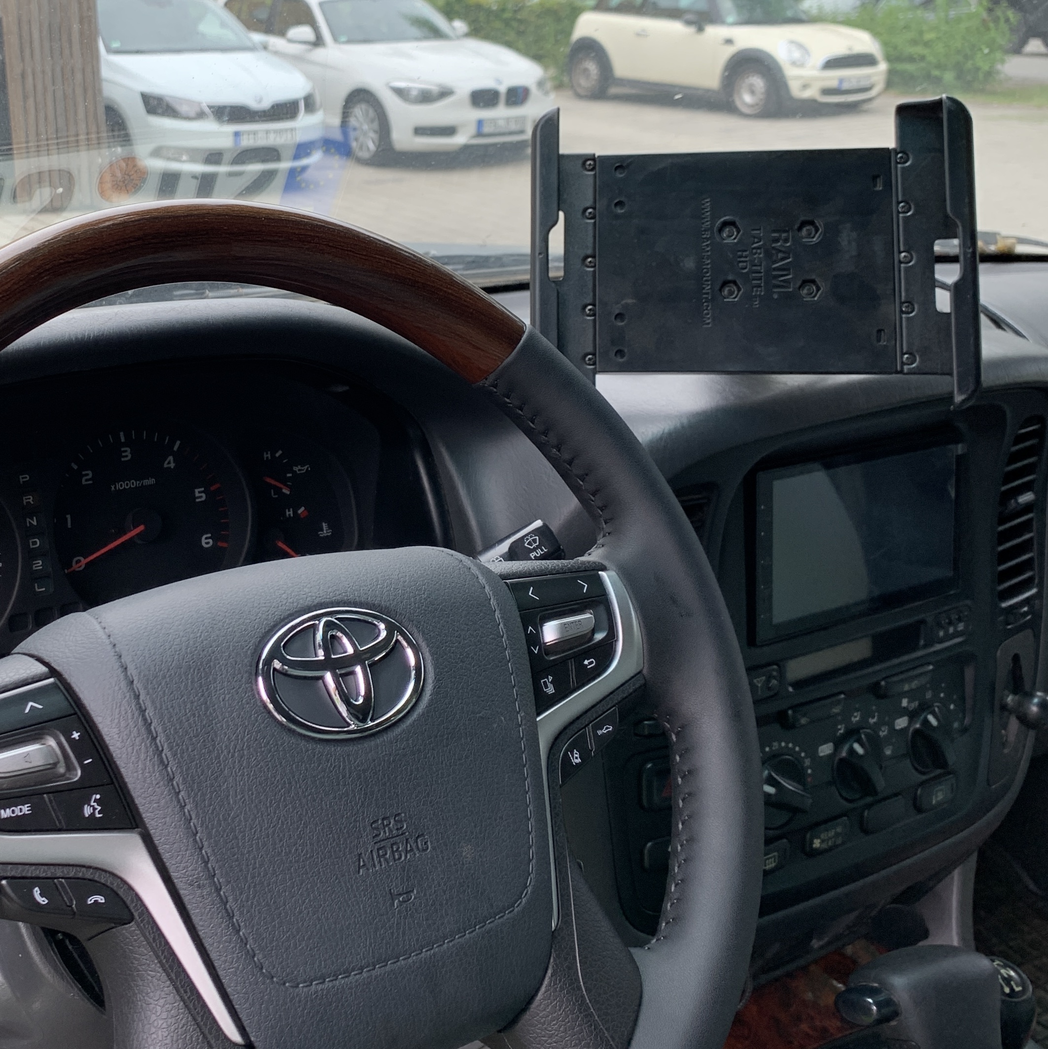

I finally finished the install of the steering wheel. Finally steering wheel controls for the after market radio. I love the new look.
In case you are wondering, you will only need a 6 Pin clock spring to make it work.

If you've got a little time to burn in SLC, you're welcome to a garage here in the downtown area. It's just a home garage, nothing special. But I did the SAS here, so it should be adequate.

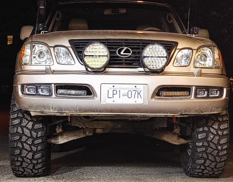

I may be the only 100 Series owner that doesn’t know the answer to this question, but what is the purpose of this bulb?
I may be the only 100 Series owner that doesn’t know the answer to this question, but what is the purpose of this bulb?View attachment 3683811
Decoration, basically. I replaced mine with amber bulbs which is a better look in my opinion. Let me see if I can find a pic.
Rebooted my cv axle this morning in @saucebox garage. The mud community comes through again! Thanks, Don, for the space and extra set of hands.
If you turn your headlight switch one click they will illuminate. They’re just an “extra DRL”. I’m not really sure what purpose they serve.
Perhaps both bulbs are bad, which seems unlikely, but no combination of switch movement will illuminate either side. All of the other lights work normally.
