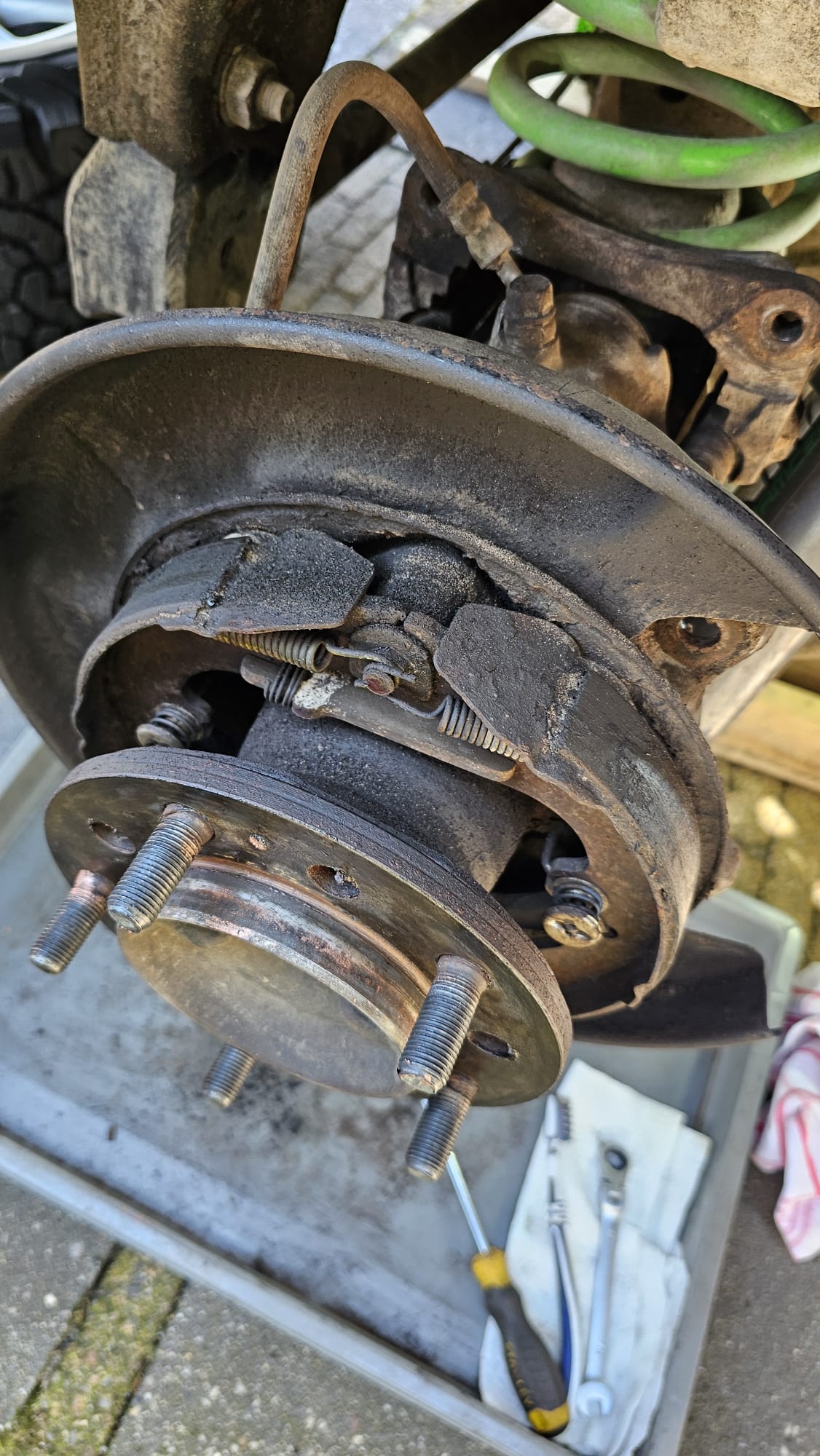

I finished my rear brake job - complete renew of brake hoses, union bolts, hardware, fitting kit, shims, pads, calipers, rotors. Happy with that work. But, when i opened up the rr it was oily, wetish in there and smelled of diff oil... im pretty sure its no brakefluid:
So hit me with the bad news pls - whats your diagnosis? Is it just brake drum deflector, gasket, oil seal? Or is it wise to do the bearings o-rings and seals - perhaps even the entire side shaft replacement - at this stage? I'm guessing its never been serviced in the vehicle's history.
The only parts of the shaft to worry about are the part you can see (totally fine), the splined section (likely completely fine), and the section that the bearing rides on. Super duper unlikely you need a shaft replacement.
Similar story for me last year, farmed it out to my local indie for about $700 (both sides). Expensive, but not something I wanted to fool with. I don't know which of the three things (bearing, o-rings, or axle seals) was causing the diff oil leak. At 250k, any of them could have gone.

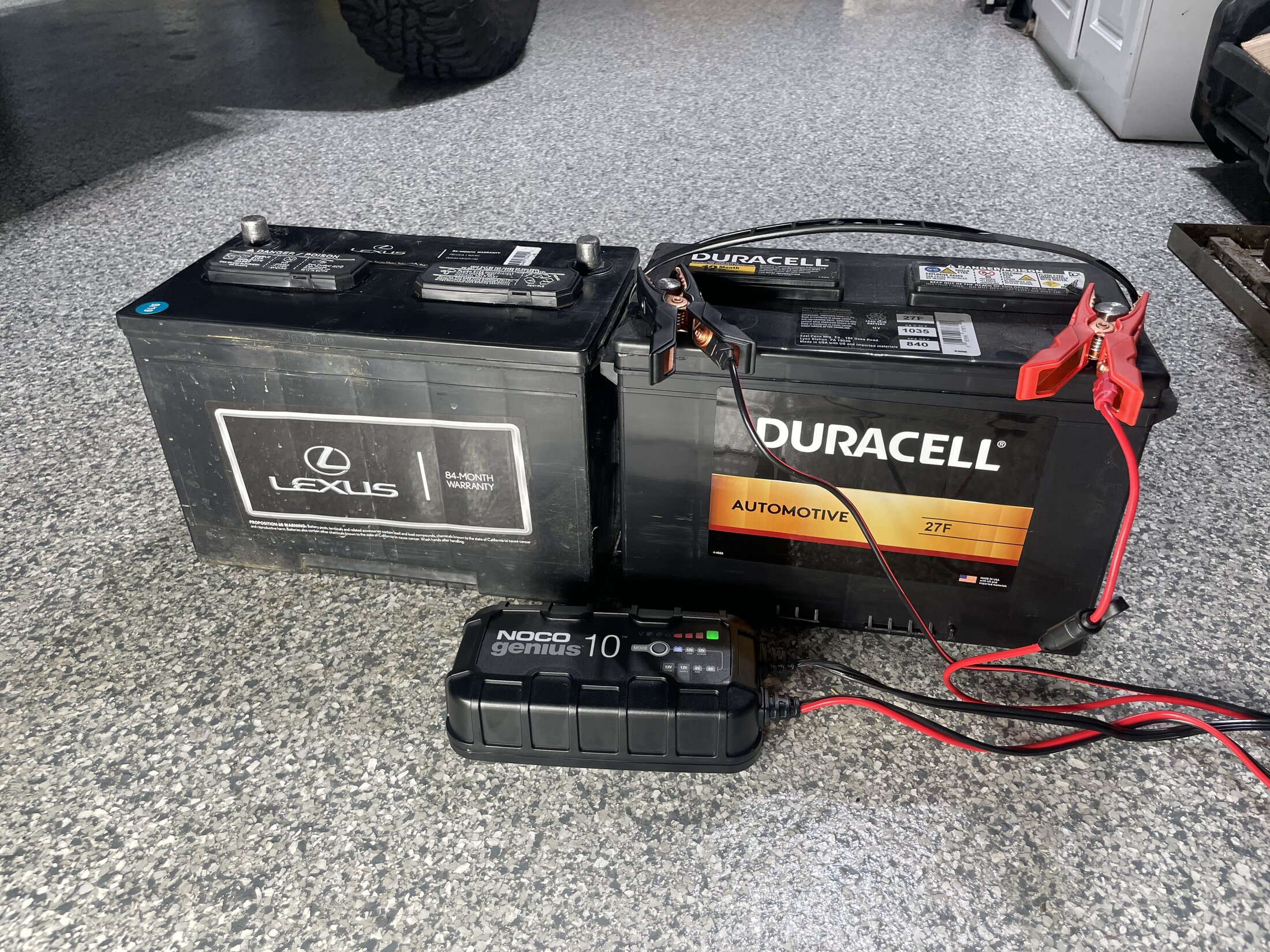

  • New 27F battery
