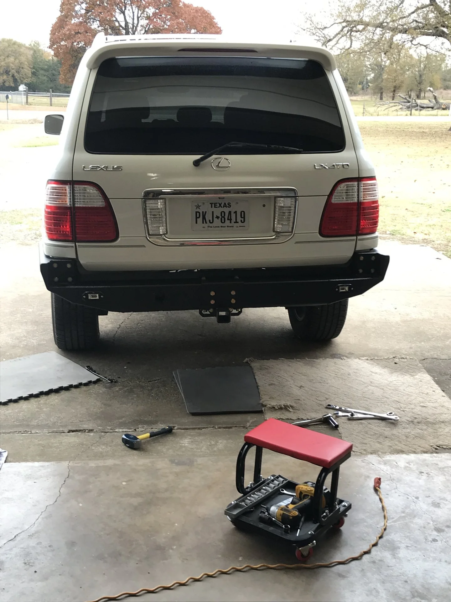

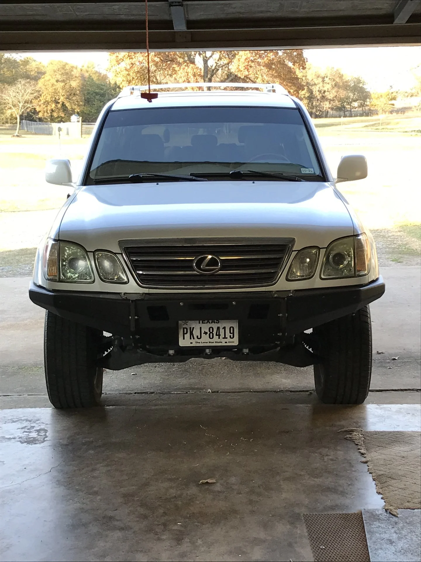

Installed the new bumpers! Gah, do I ever need wheels and tires now.. I've got some OEM pieces for sale if anyone needs them.

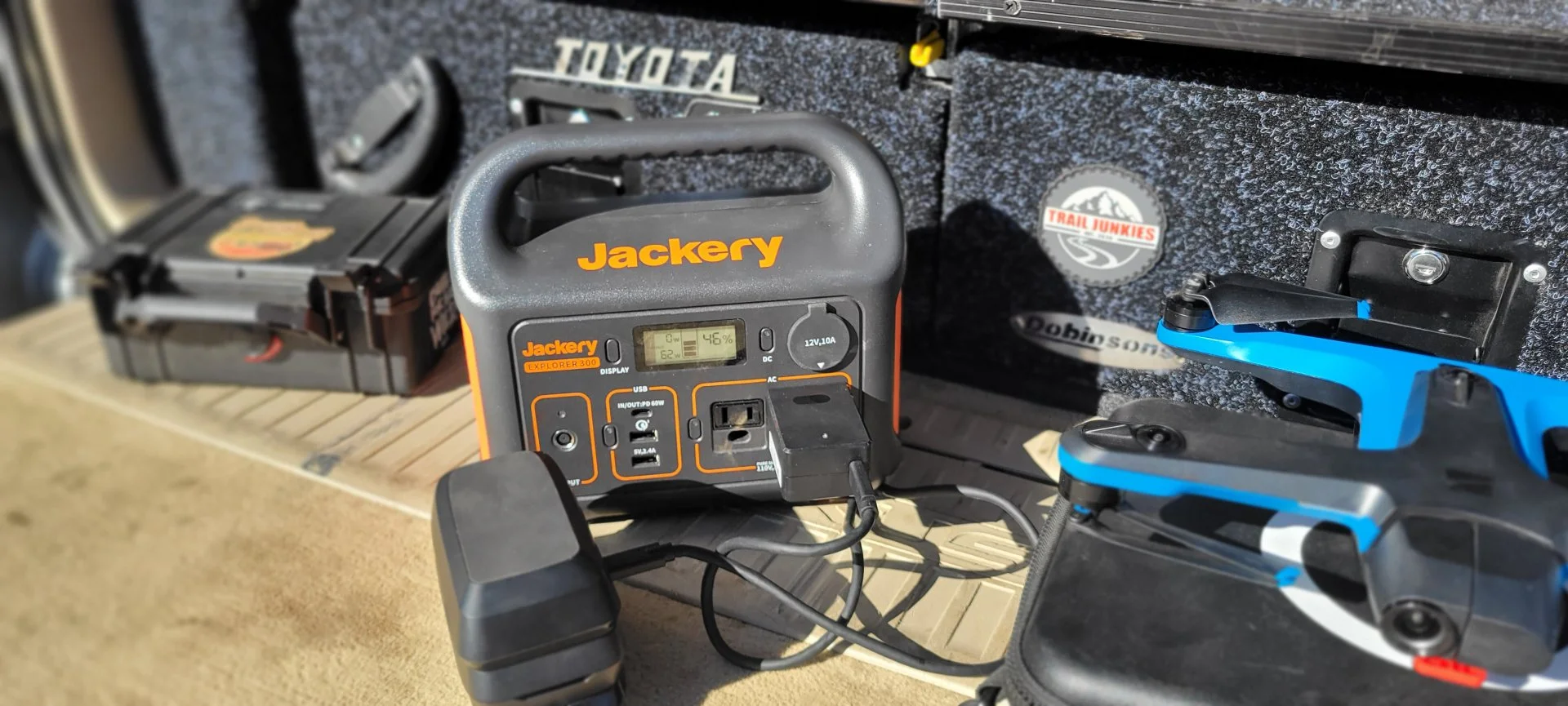

Jackery explorer 300 Solar Saga 100 panel getting 94watts.
Skydio2
Love this set up.

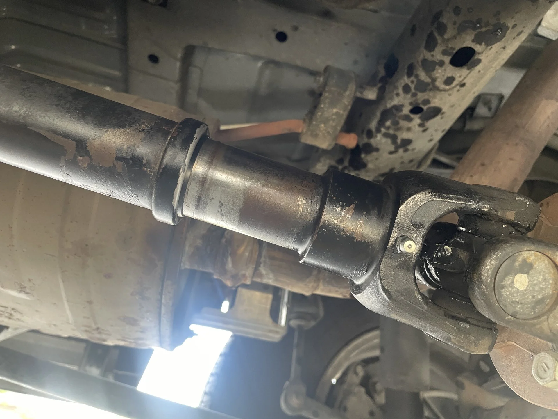

Greased the driveshaft with NGLI2 Lithium Moly.

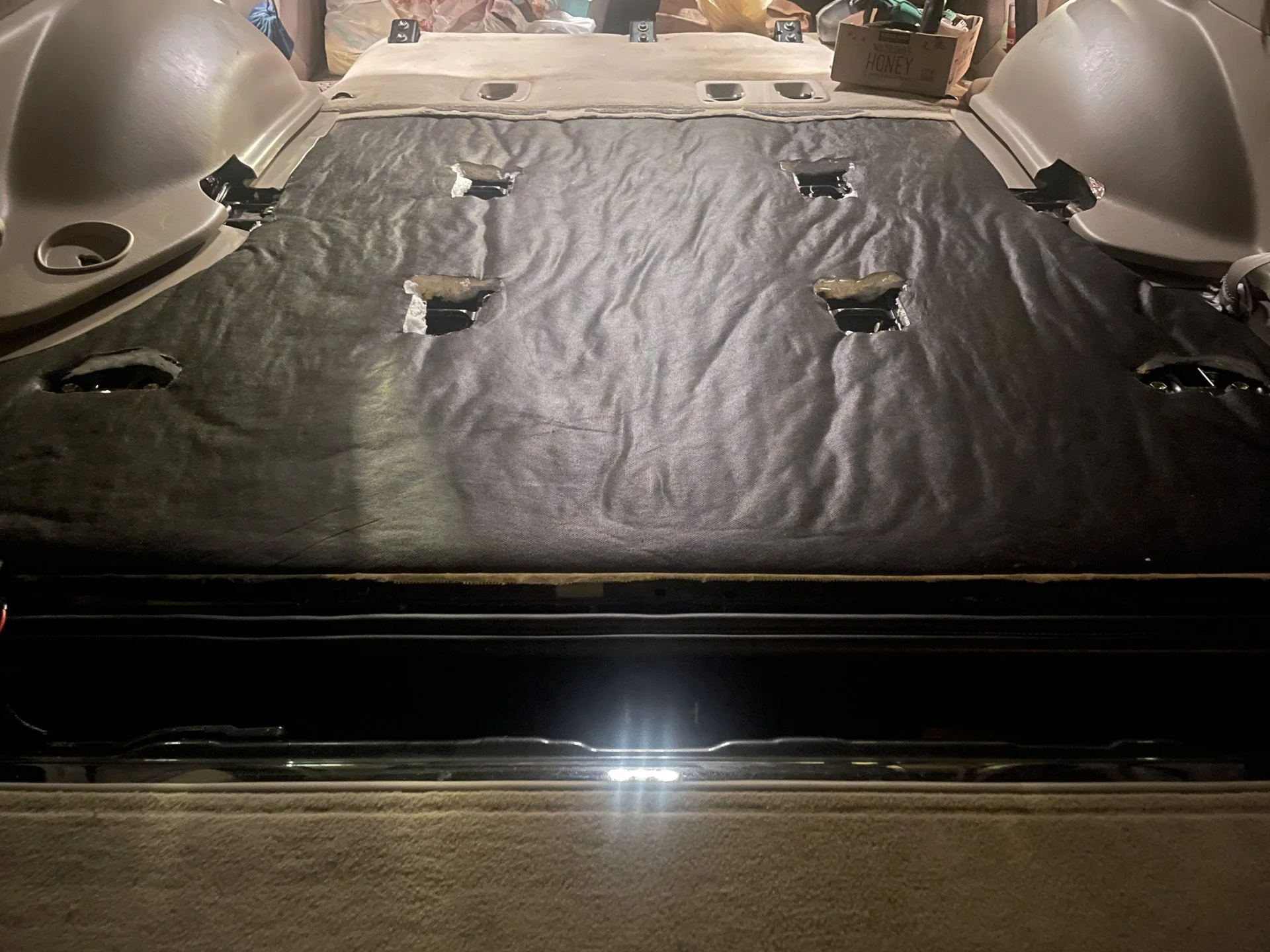

Installed 3M thinsulate for sound proofing and thermal insulation on wheel wells and second row to rear.
Resonix CLD tiles on wheel wells and 3M EDM1029 “CLD” on the rear. Complete sound deadening completed.

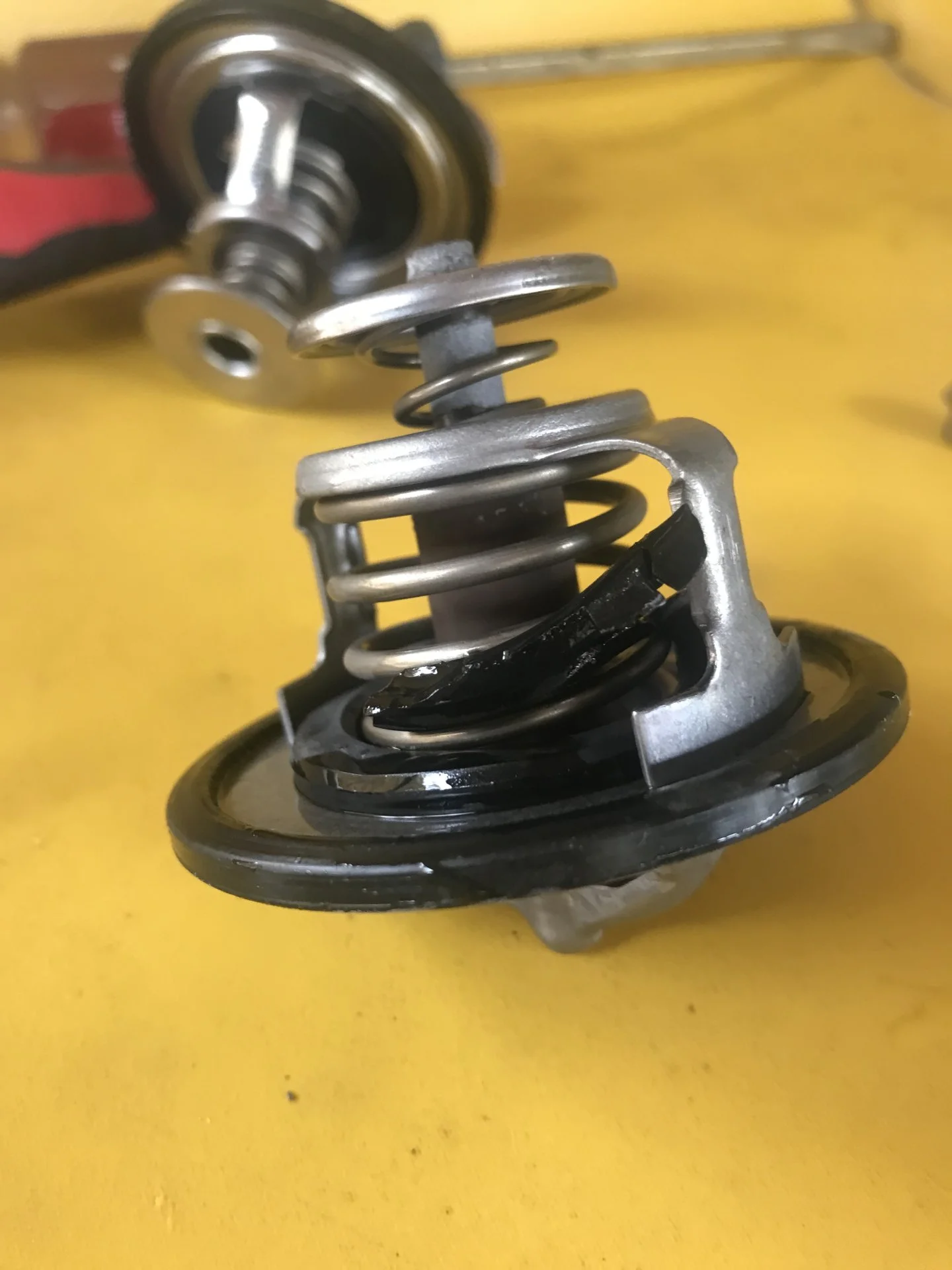

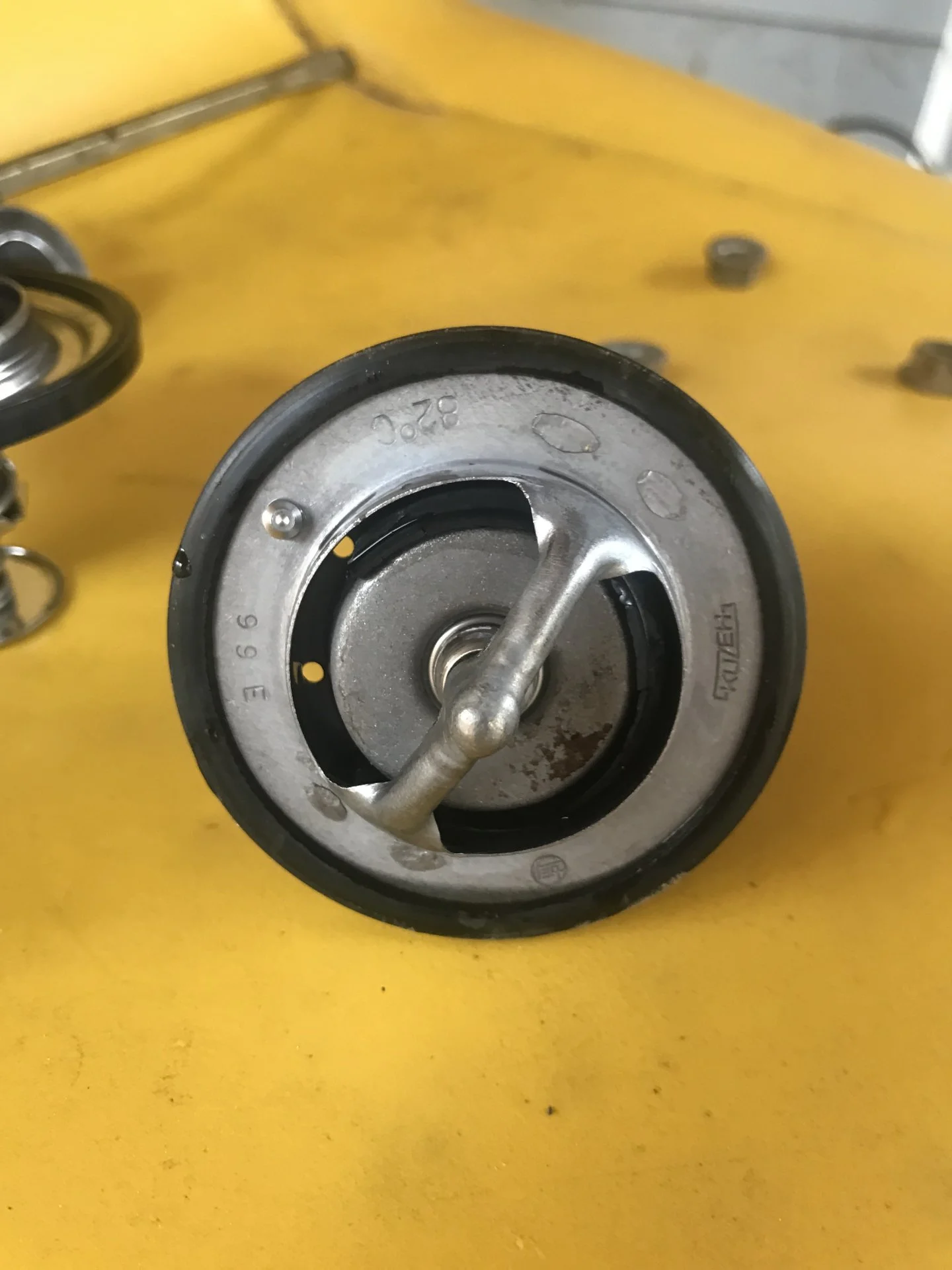

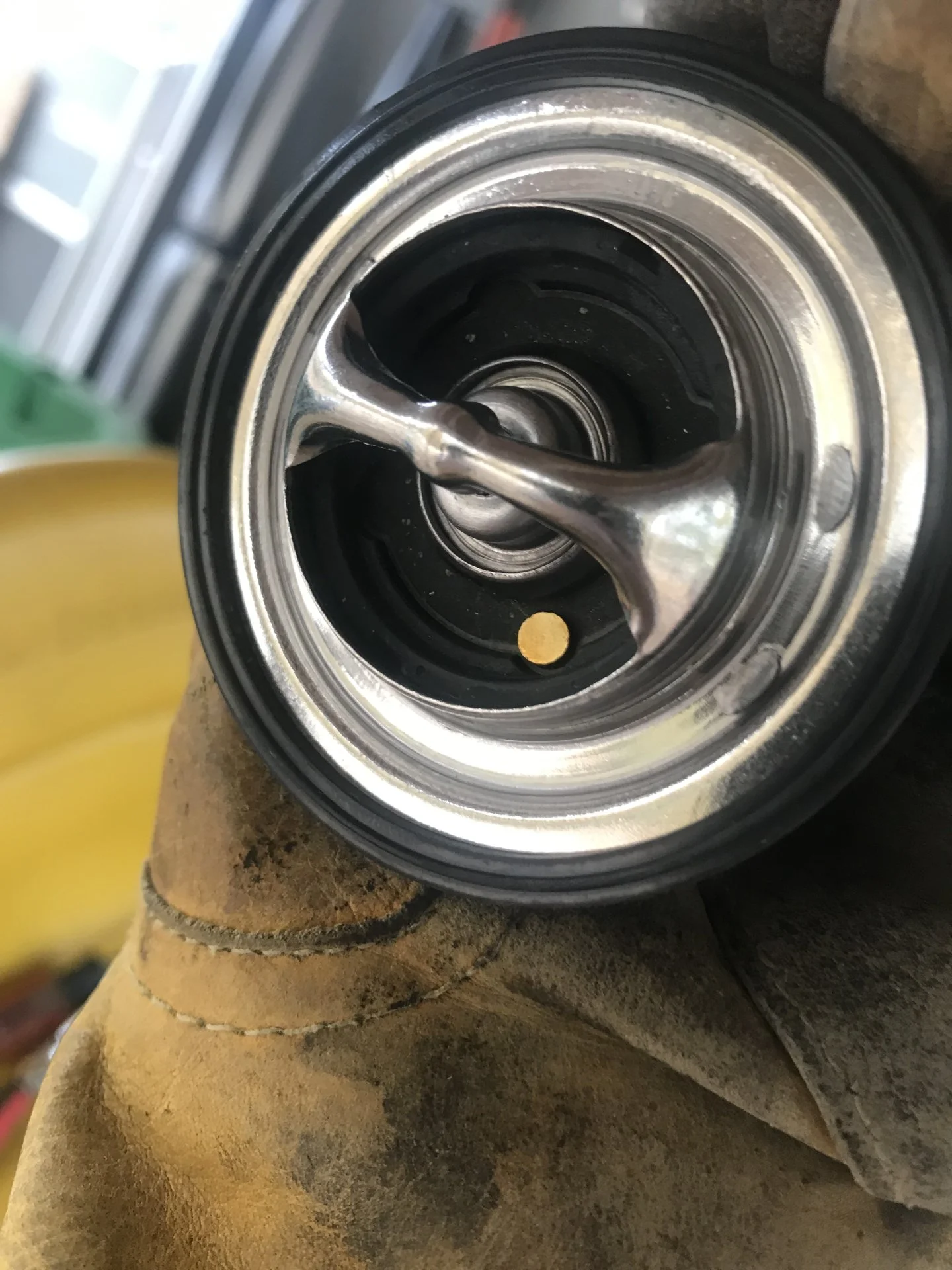

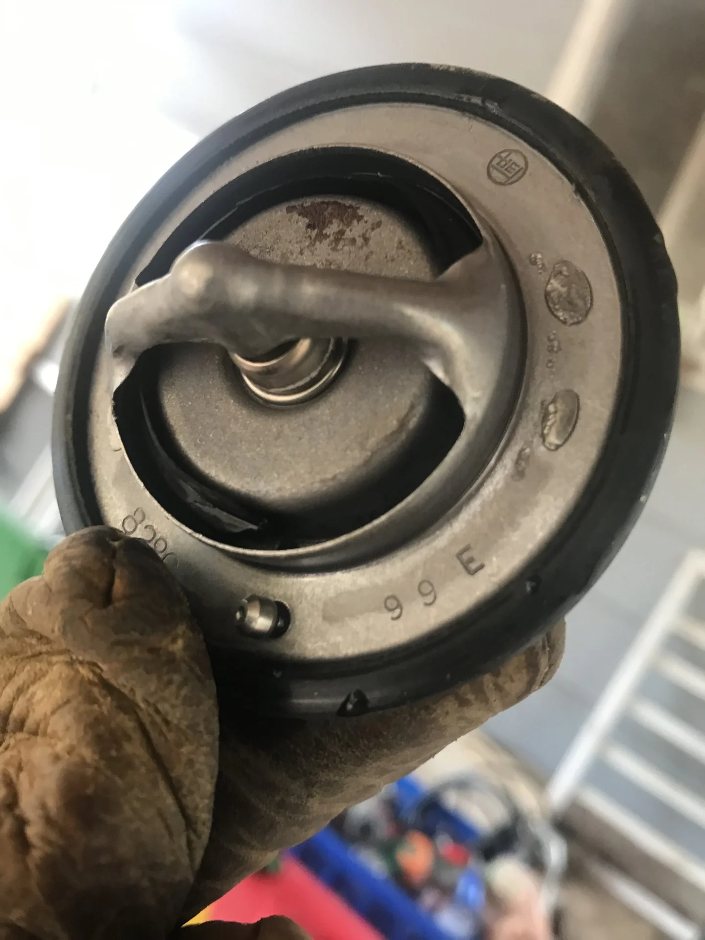

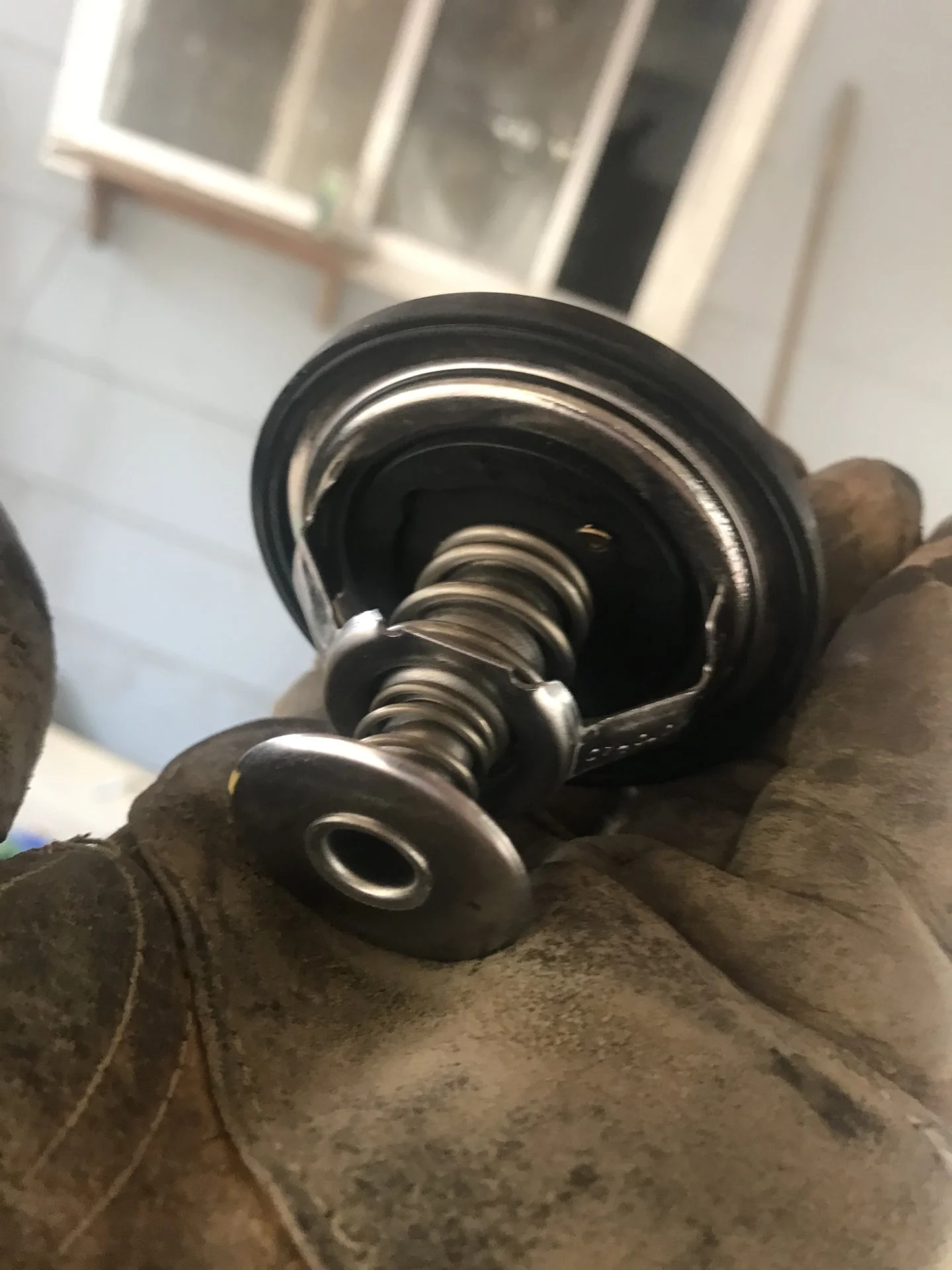

Truck was beginning to run a little hot.
Replaced the (I'm guessing) original thermostat and then topped off with coolant. No longer running hot but temp gauge sits a hair above center. Radiator is probably next to go. Anyone done an aluminum with twin fans?
old
new

If you can get your hands on an OEM radiator go that route. These trucks are regularly abused in 110°+ desert heat overseas. The OEM cooling system is more than adequate to handle any climate in the USA. Do a thorough cleaning and flush of the entire system

I haven't tried an aluminum radiator, but I have tried twin fans. It didn't work out great for me in AZ, but perhaps I need bigger fans and a new radiator.
This past summer, my LX was doing fine when I was driving, but if I got in a drive-thru line at a fast-food restaurant the temperatures would skyrocket until the AC shut off and the temps would then stabilize. That's not great when it's 115 degrees outside. I made a custom fan shroud and installed electric fans, but I had a different problem. The truck did just fine idling at a fast-food restaurant with the AC on, but it would run hot when driving. I switched back to the original fan, and I've decided to start eating healthier. If not for my health, for the health of my LX. I suspect that I could use a new radiator and/or a good flush.
Sound like you need a new fan clutch, not that I'm trying to enable your drive through habit.
Thanks for the input. Is there a good way to test the fan clutch to confirm if it's not fully engaging before throwing parts at it?
If you didn't hear your fan get a lot louder before it got hot enough to shut down your a/c, then it isn't working. It's simply a mechanical device that uses a viscous fluid. I think if you search the forum you'll find ways to test it.
It does get louder, but only when the RPM raises above an idle. As soon as it starts driving slowly, the temps come down. That's what made me think the clutch was good, but maybe it's just on its way out.
