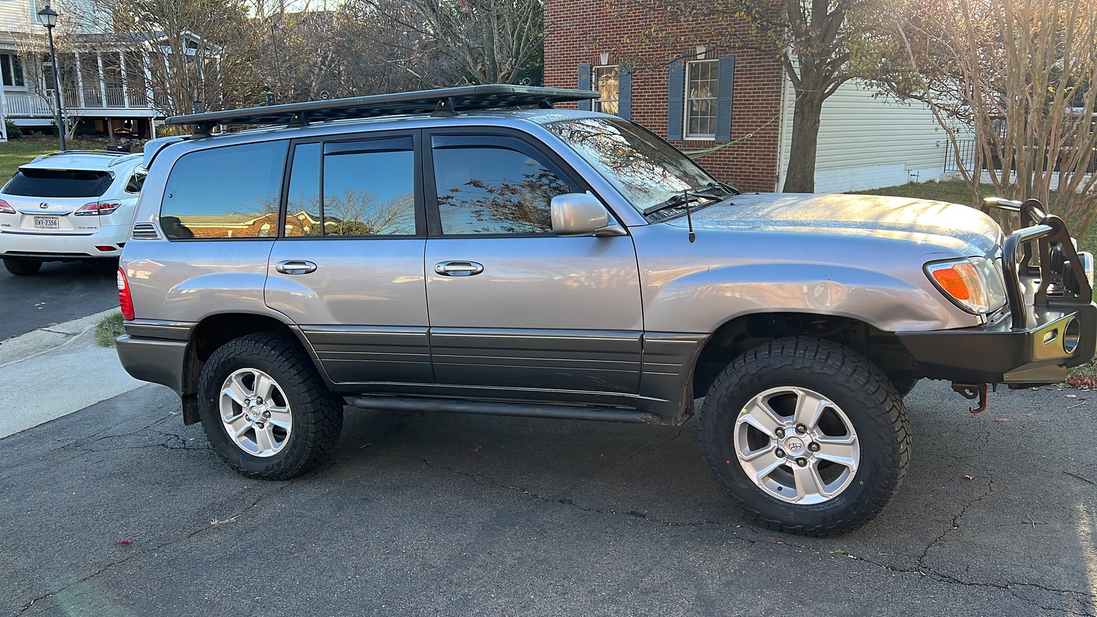

LC came out of paint today, now I can start installing the upgrades.
Looks like the DC Power alternator has shat the bed again :skull:
Spoke with DC Power guys this afternoon. Let me first say they are very honest and easy to work with and never BS around. They explained that this is not unexpected! The peak voltage their 270A alternators are set to is 15.33A (see the spec sheet below). Since my truck sits outside in very cold temps (it was 19 F yesterday) and sometimes sit for more than a day without being driven, the batteries run a little low and the alternator churns out peak power. It is expected to go down to 14.2V to 14.8V range after the batteries (I have 2 of them) are topped off and and under the hood temps have climbed up a little.
To test that theory I drove for about 10 miles and noticed the reading to go down to 14.7V. At this point I think I will try it out like for a while and see if the volts stay below 15V on warm up - if they do, I will leave good enough alone.
