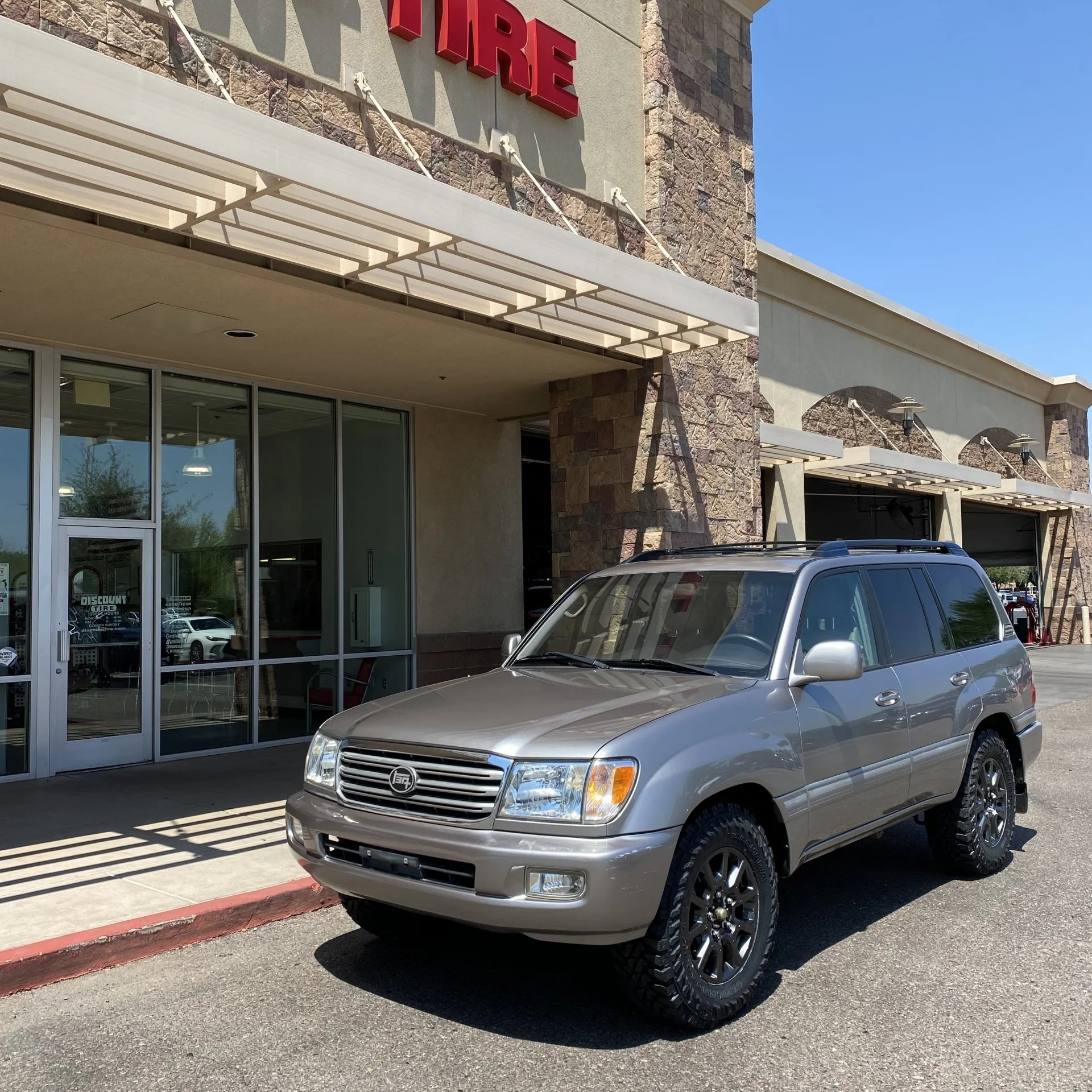

^^^ah i hate you, my fav color on a 100, looks real clean bro. Tires look kinda pushed in though, any plans for some spacers to bring them out a bit? I ran Bora spacers for years without issues, they don't vibrate and survived a few offroading trips.
Definitely will consider it. Never used spacers on any vehicle I’ve owned, but can see the pros here.

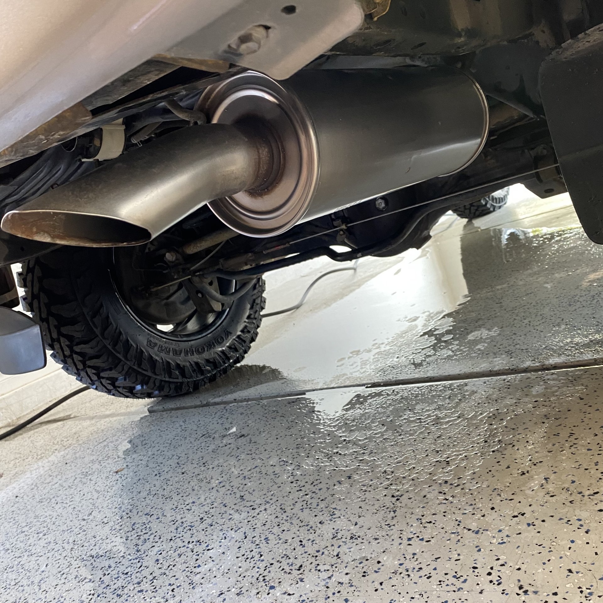

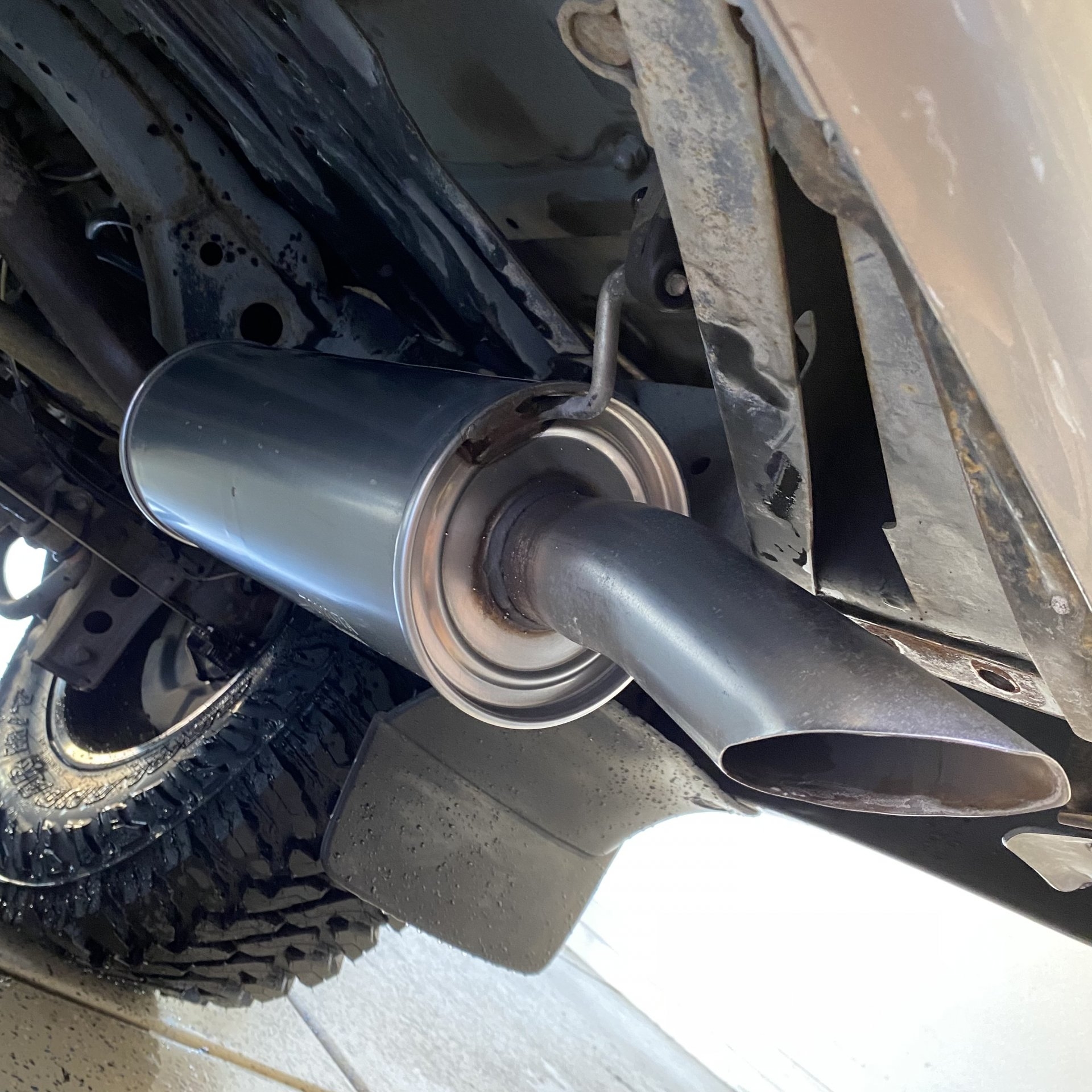

Looks awesome! What was your process?

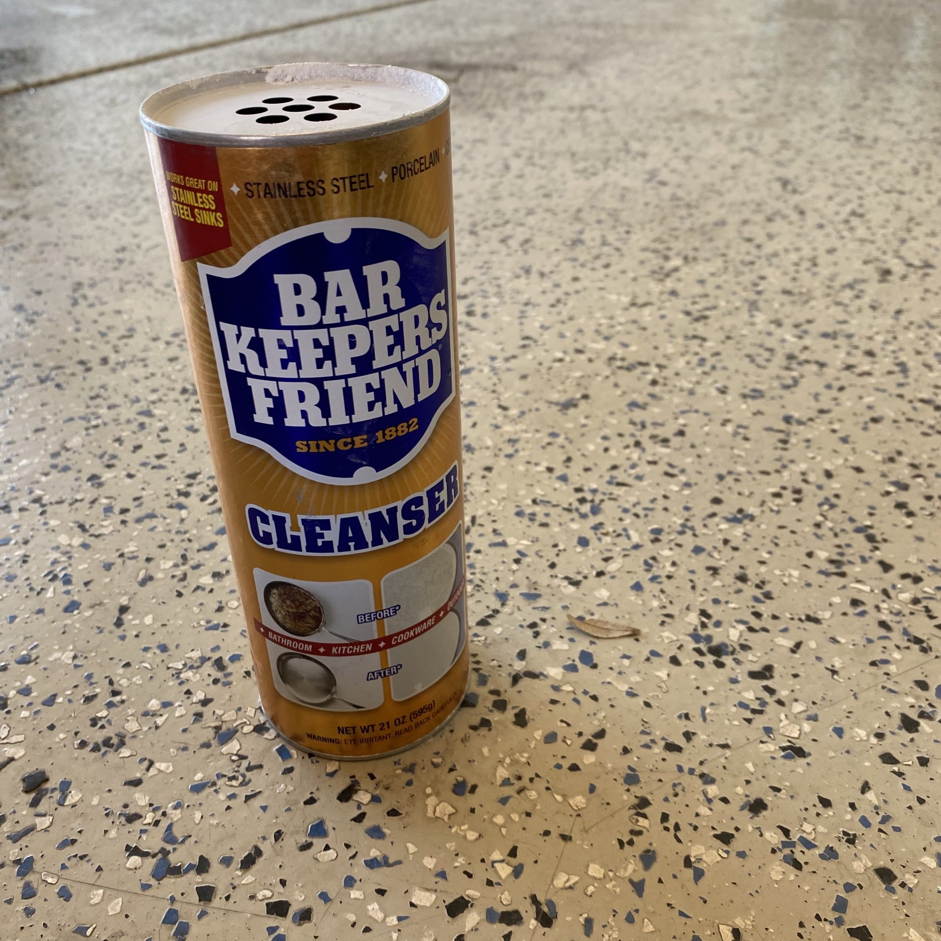

Thank you. I just used a Scotch-Brite Non-Scratch Scrub Sponge, Bar Keepers Friend (BKF), and a bucket of water. BKF is a chalky white powder (similar to baking soda). You want to get a decent amount of BKF on a semi-damp sponge (I used the harsher, scrubby side of the sponge) and just rub out the grease and surface rust with several passes. Keeping it semi wet helps, but you'll quickly learn you want more powder than water. On the other hand, you'll know when you don't have enough water. I probably spent about 20 minutes total bringing the tailpipe back to like-new appearance before I rinsed it while also wiping off the BKF residue (otherwise some of it stays behind). Then I dried it off and marveled at the transformation!
Note: it's not meant to be used on painted surfaces. I've always used it on our kitchen sink and pots and pans :D and one day decided to try to clean up a Honda exhaust tailpipe and presto!, I found a new tool for my automotive tool kit.
