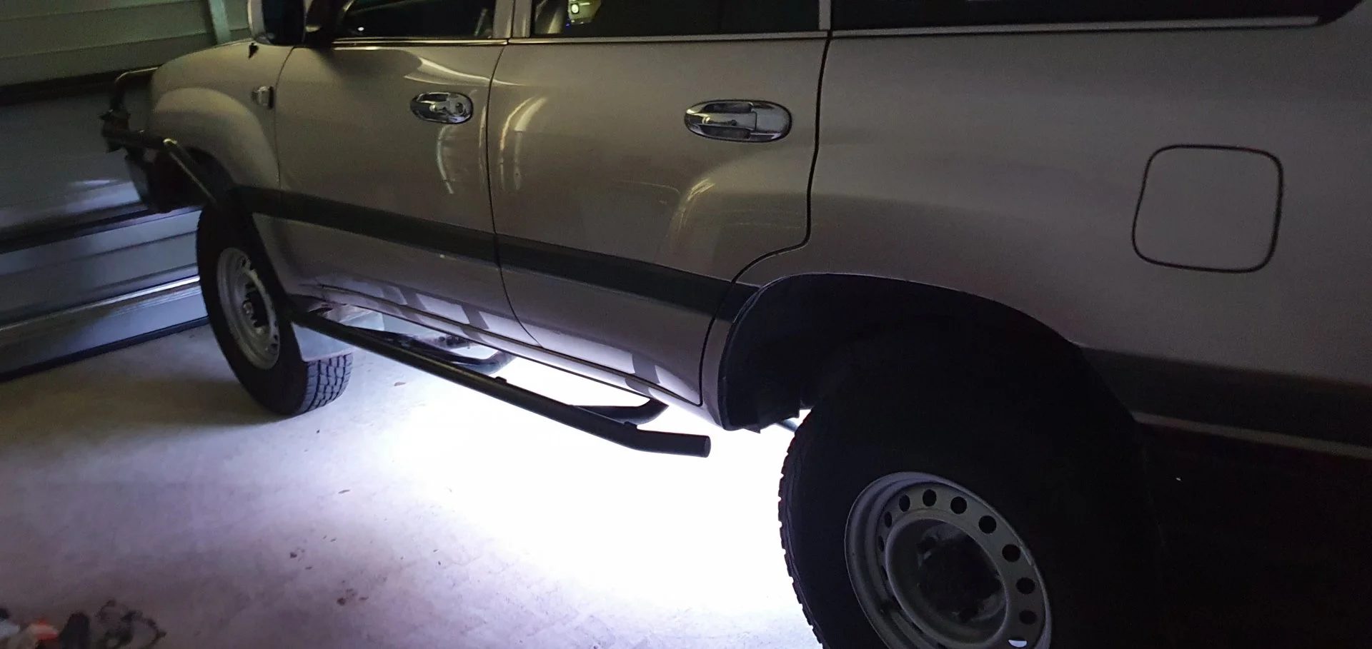

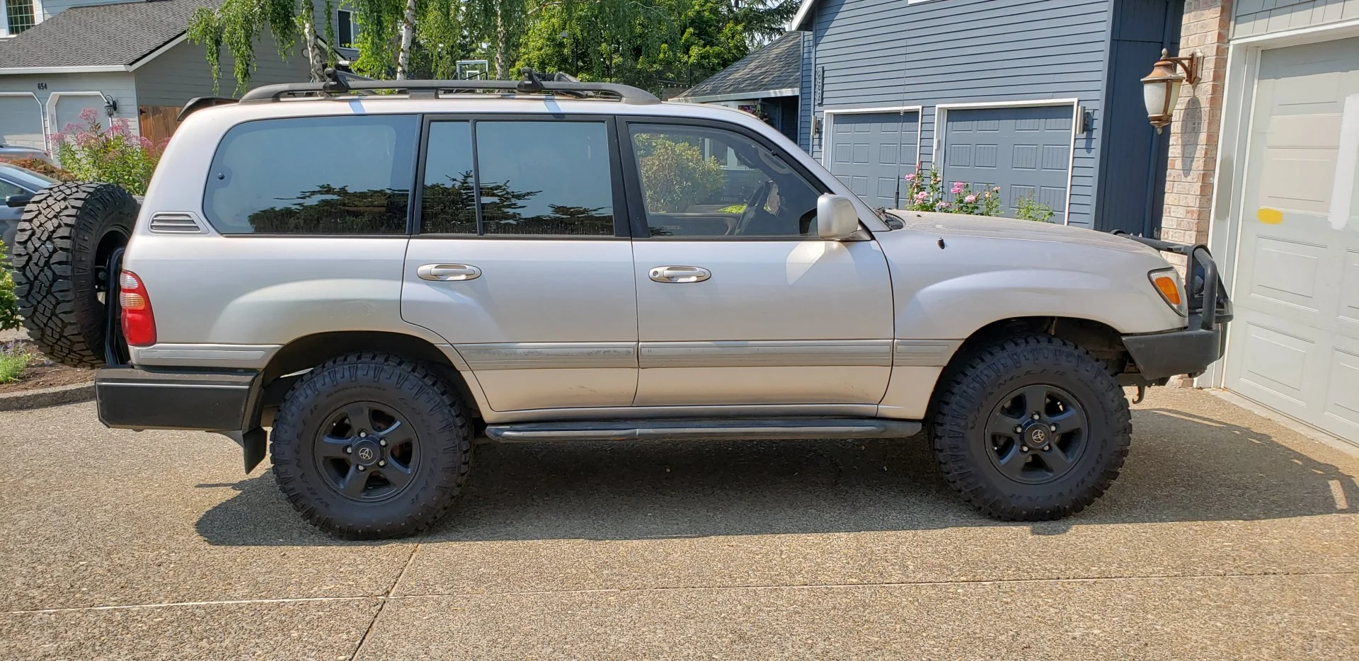

Getting ready for a paint job. Stock colors with Raptor Liner on the bumpers and sliders (and maybe on the side moldings and below). More pix when done.
What size are your tires? Looking forward to seeing it after paint.

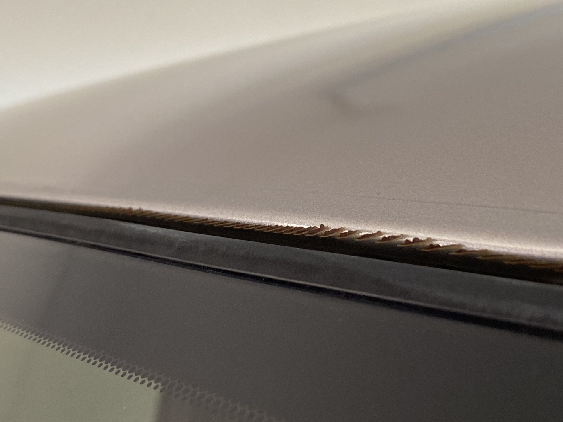

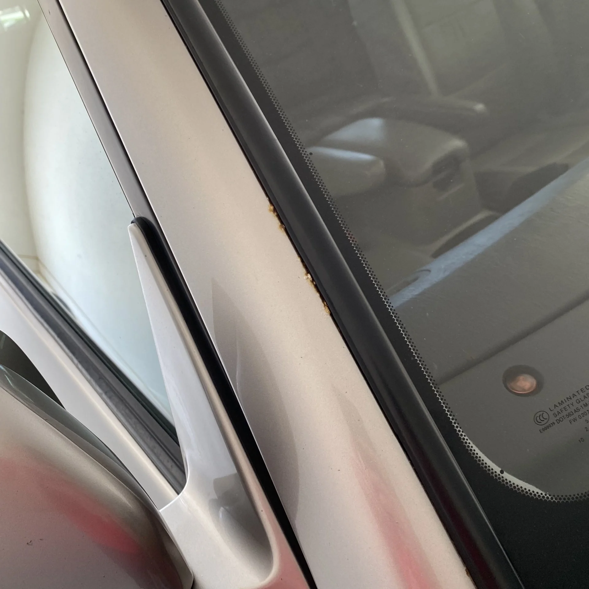

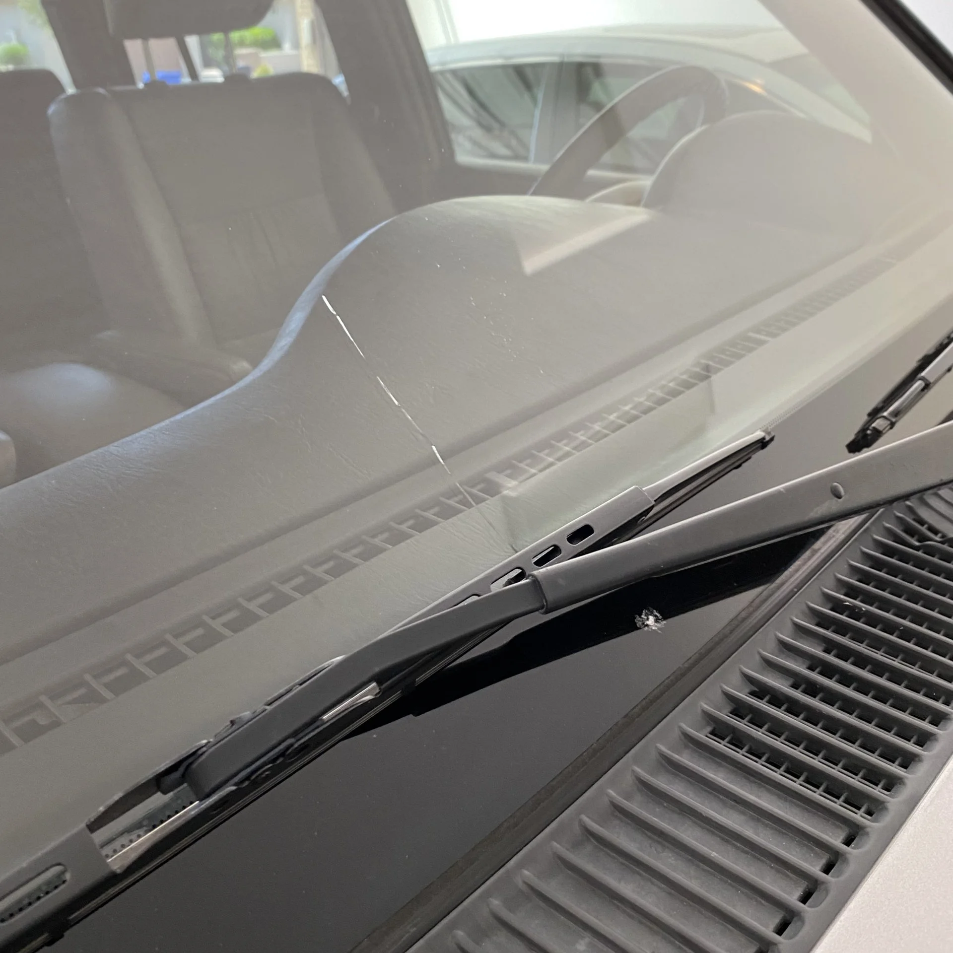

Was scheduled to get a new OEM TOYOTA windshield this morning (surprisingly my insurance company approved the $1K cost for genuine TOYOTA and I have no out of pocket on glass), but understandably, Safelite wants the rust addressed first. So I got some estimates and scheduled the work to be done.
After the windshield is professionally removed by Safelite, the collision shop is going to sand down the rust around all four corners of the opening, treat it with POR-15, and then prime, paint, and blend it. I also asked them to paint the rock-chipped grille winglets. $535 is what it’ll cost me. Sure, I probably could’ve gotten it cheaper at some hole-in-the-wall shop, but good work isn’t cheap and cheap work isn’t good.
What look like grind marks are apparently some jack hole’s carelessness with a knife edge to remove the moulding and treat the rust prior. I have the receipt from the previous owner and he didn’t spend very much to address the rust then. It shows.

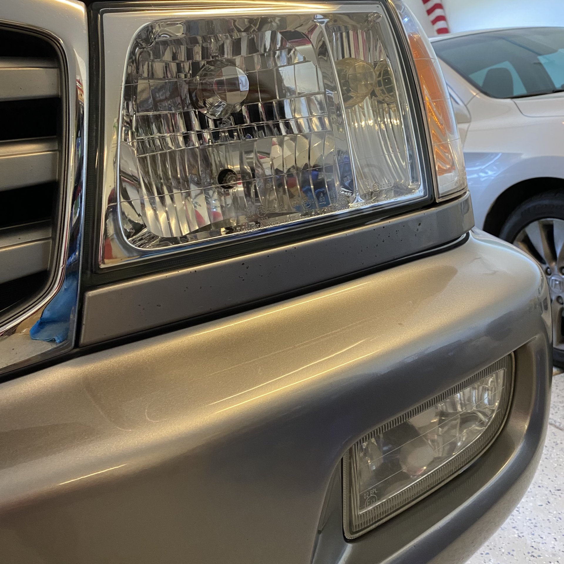

Rock chipped winglets.

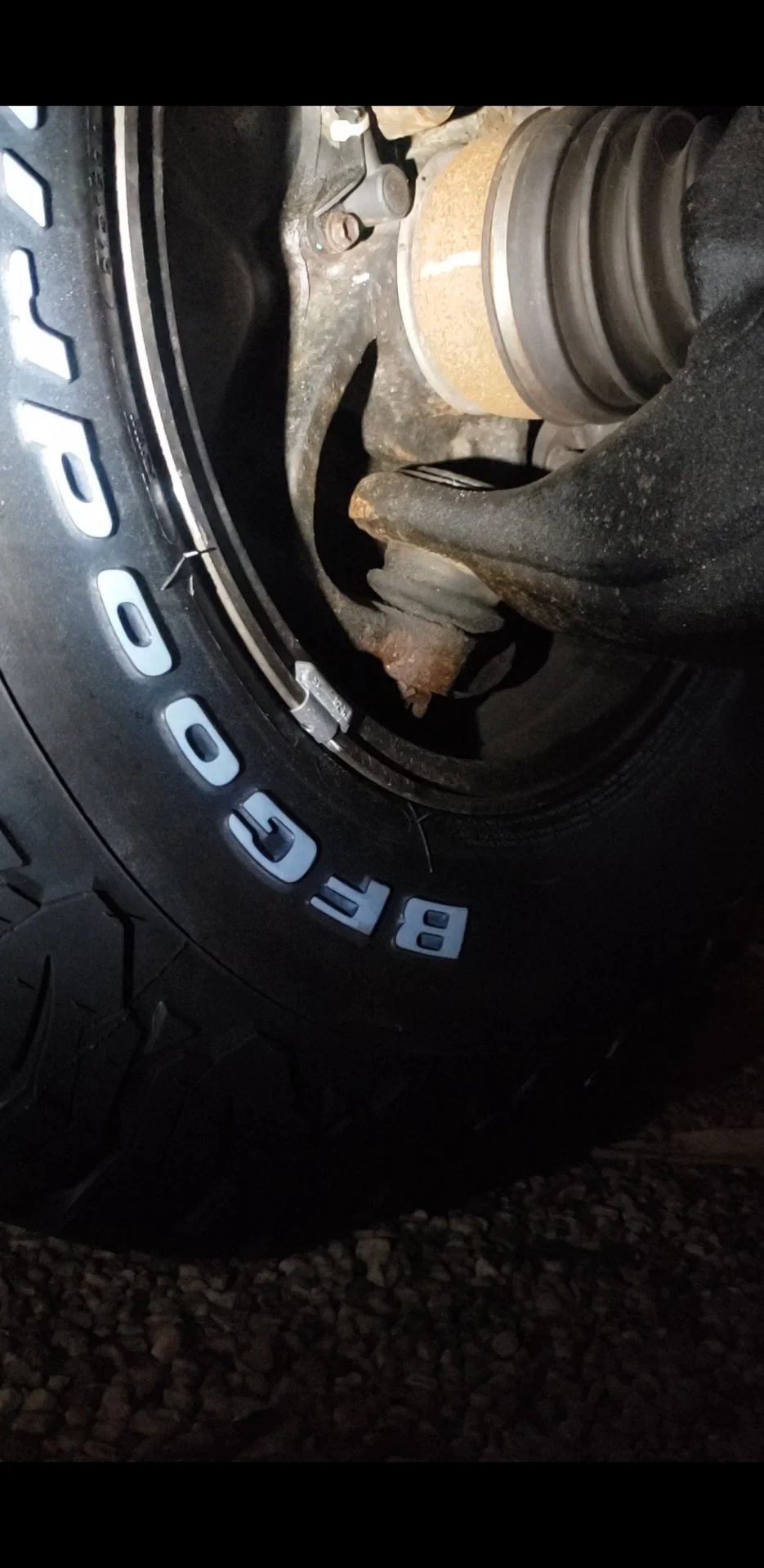

Finally fixed my Drive/Reverse clunk.
After cross country trips, I bit the bullet and replaced the aftermarket CVs with OEM Toyota axles. At the same time I had the front wheel bearings replaced and the front diff support bracket replaced (using OEM part with the integrated bushing). I wish I could say I did these repairs all myself. $2300 parts and labor for a Land Cruiser specialist to replace the CVs with OEM, new bearings and new diff support. It was not an easy pill to swallow, but I believe their labor charges were fair and I sleep well knowing it was done the right way. With one CV boot torn flinging grease, and the other boot heavily cracked plus a vibration around 70 mph that was not tire related - it was time. With the repairs above, all of these issues are gone. Hoping this is the last set of CVs this truck will need, and I will rebuild if needed from here on out!
PS - previously, using advice from others on this forum, I drew a chalk line on my CVs and pointed a camera at them while I sat parked, engine running and shifted through DNR. You could see and hear the CV move and clunk within the drive flange. That is how I knew the source of the clunk on this rig - plus a friendly point in the right direction from Ryan at OTRAMM.

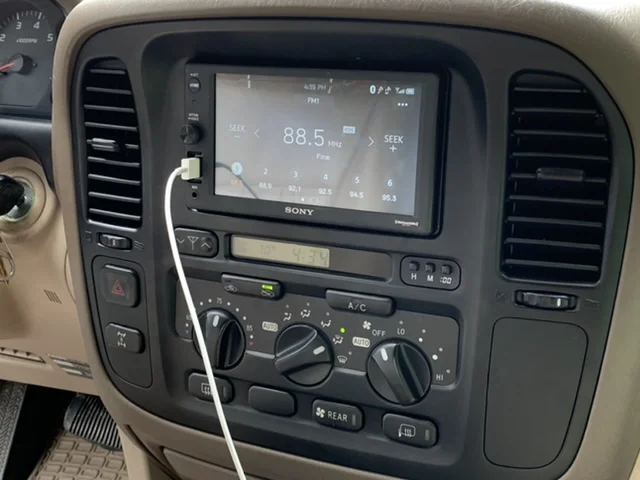

Replaced 21 year old tech with some new. Biggest PITA was the splice into the parking brake switch. Once I pulled the front seat, it went much more smoothly. Swapped the OG front door speakers with a pair of Kickers, and honestly, the old ones were right there with the new ones.
The new HU definitely puts out more sound than the old, even with the old speakers.
The new HU definitely puts out more sound than the old, even with the old speakers. View attachment 2752850
Your manual climate control knobs make me jealous
