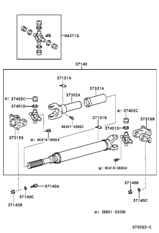

Here’s the first diagram I found when I googled “land cruiser u-joint.” I didn’t even check year since these are how ours look. The u joint zerks come out from the very center of the u joint and then bend so you can get a grease gun on them.
View attachment 2558086It’s possible someone replaced yours with “no-maintenance” ones, if that’s even something made....
This is perfect! I think the angle on them threw me off. Thank you so much!!!

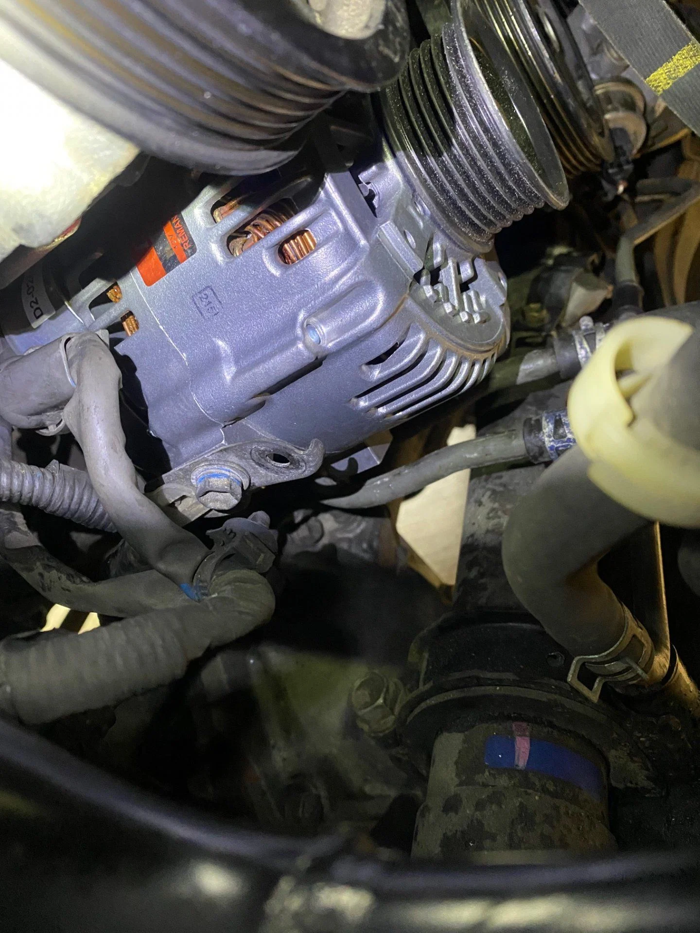

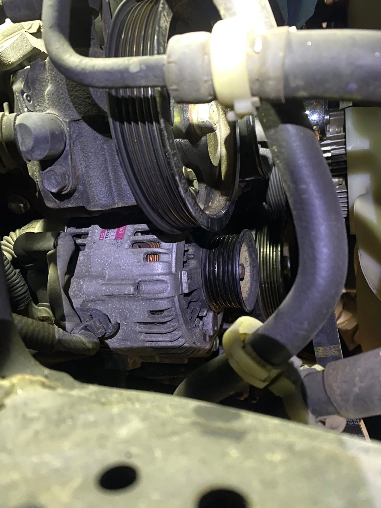

Had to R&R my alternator after my voltmeter started to bounce at stop lights and act erratic when I accelerated. Checked all of my grounds and battery connections, then tested it and, it failed. Not as bad as I expected it to be considering where it is located. I ended up taking it out the top vs the bottom like some other members have done. I'll be happy to do a write up on how I did it with my lessons learned if anyone is interested.

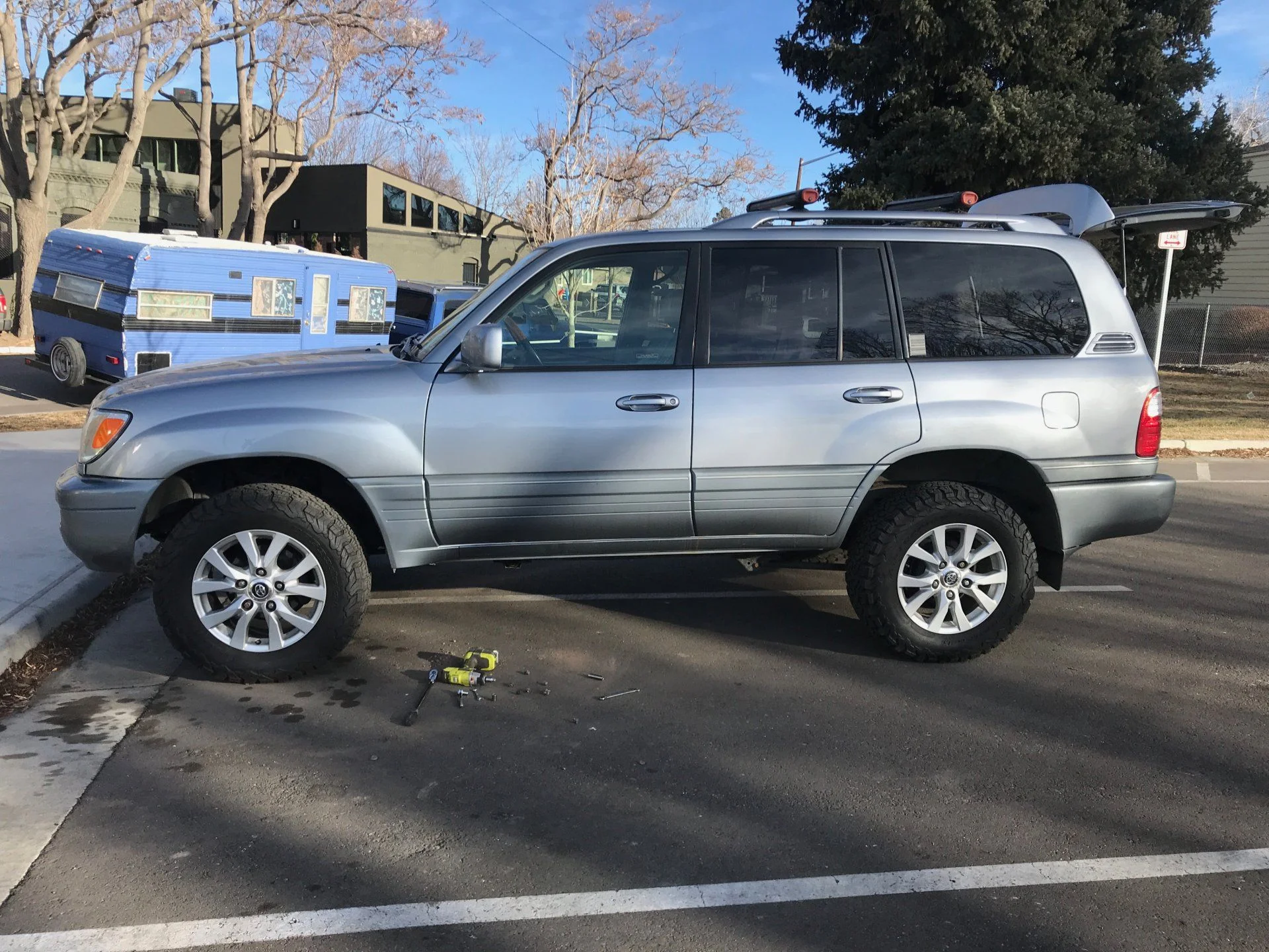

Then on a whim I decided, since it isn't snowing in Colorado this year, that I probably didn't need to be wearing through my Blizzaks on the warm, dry roads that we've had all season.

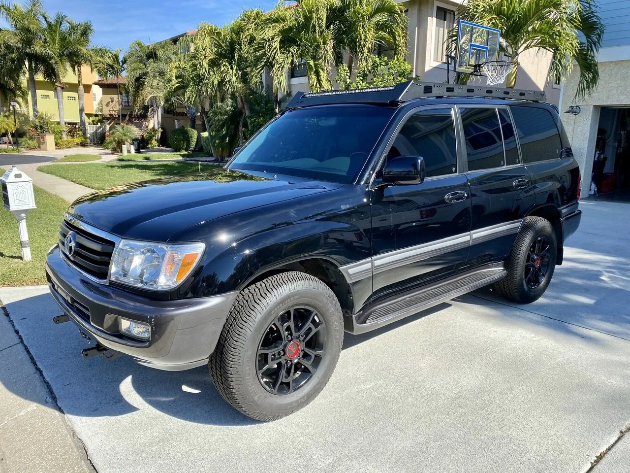

I had some 2016 LC wheels and 275/65/r18 KO2s that I had bought on Craigslist last fall, so I drove down to Slee, bought some Spidertrax spacers, and installed them later that day.
It looks much cleaner with good paint on the wheels, the original set was starting to bubble a bit.
After I installed the larger tires with the spacers, I noticed that the running boards looked a little odd so I pulled those off the following day.
I really like how much more truck-like it looks with the wider stance and the extra clearance in the middle.

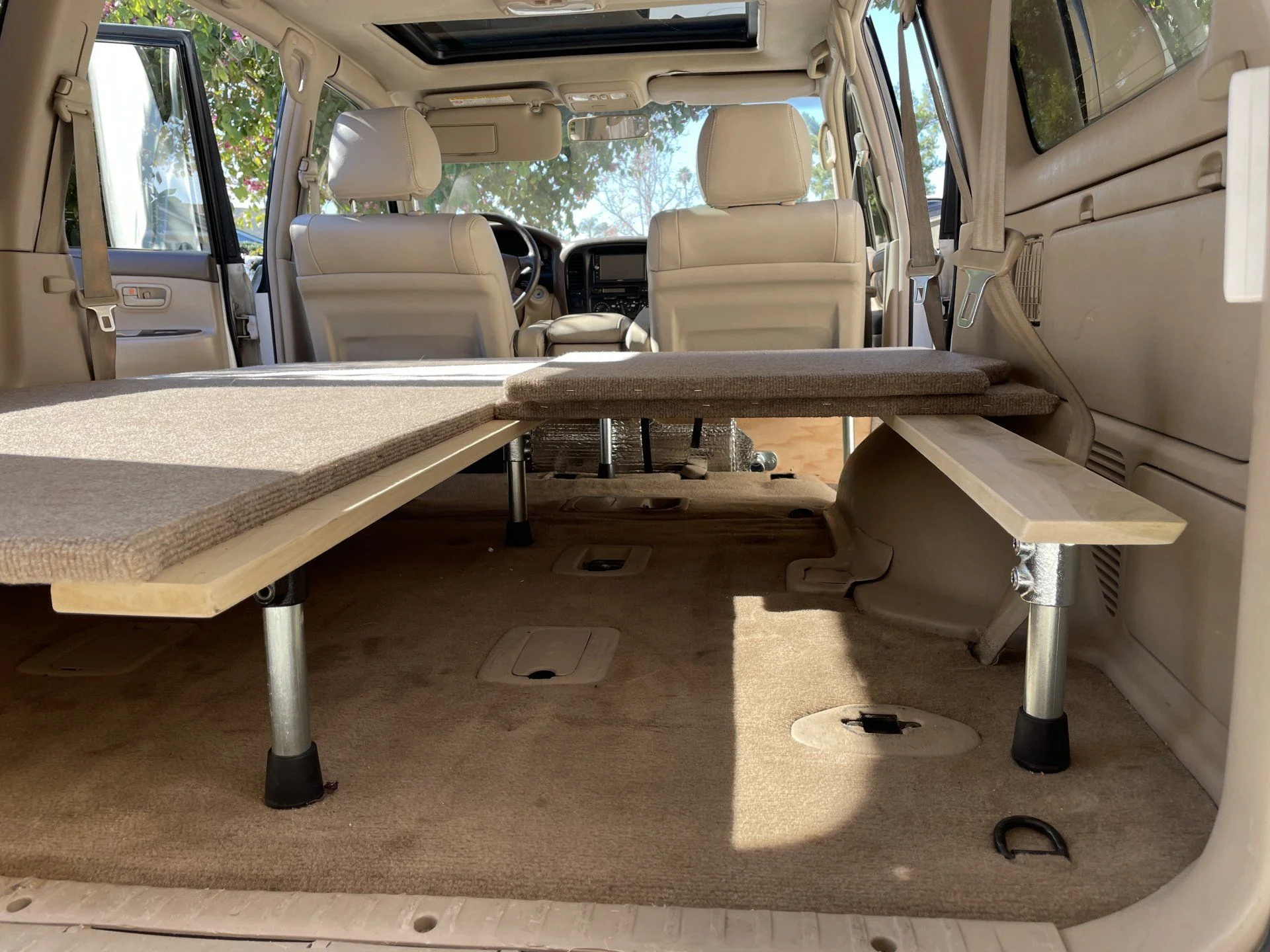

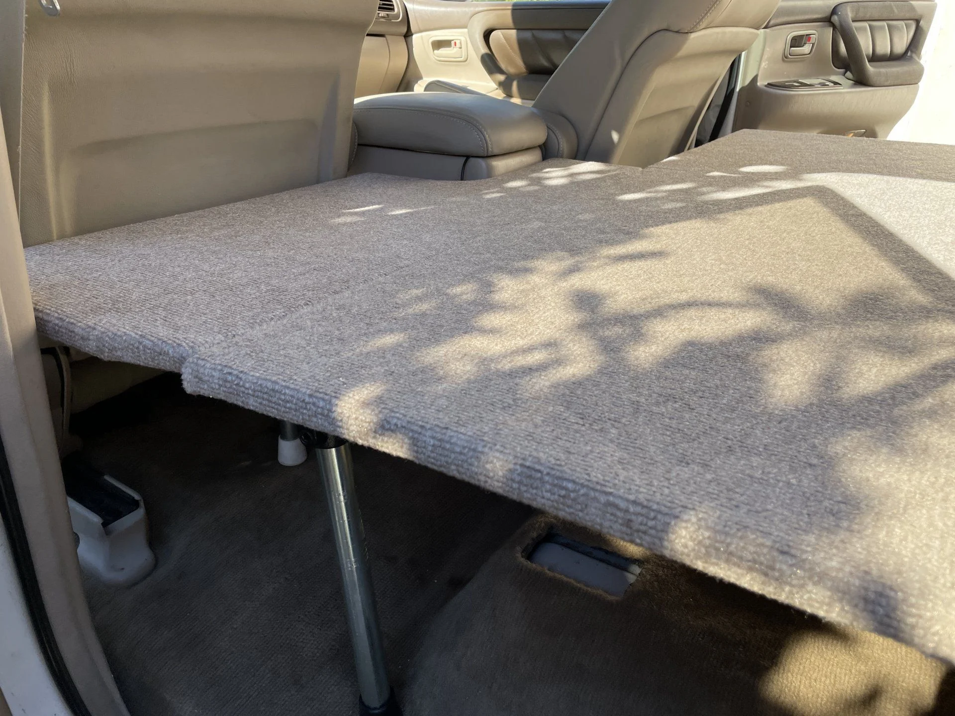

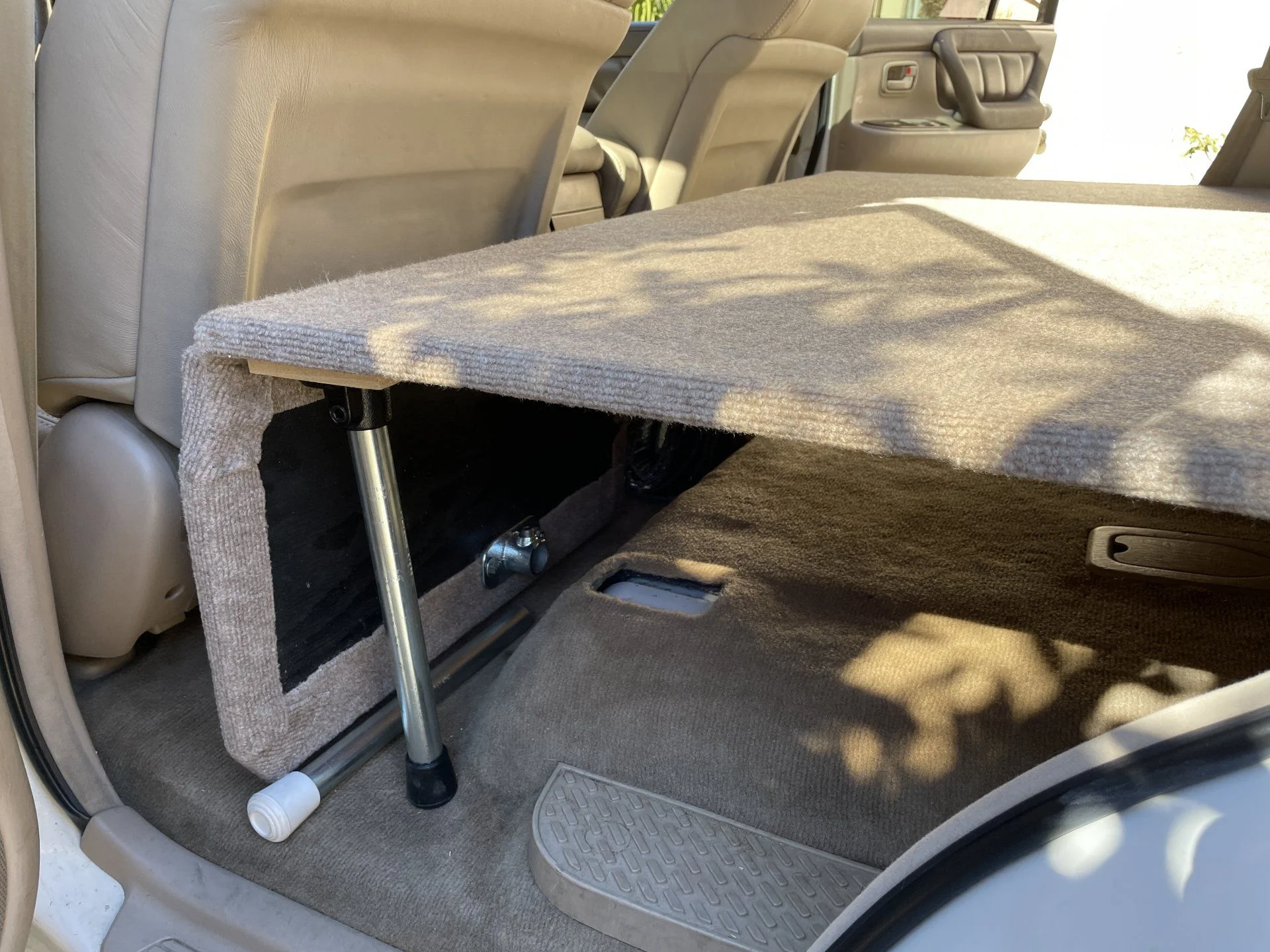

Finished my platform. Decided to keep it open underneath for my surfboards and use storage bins for organization when camping.
This cut out is for the Yeti and the whole right section comes out for solo trips.
The ends fold up when the seats are all the way forward.
I used these mounts from Lowes: Mounts and this pipe. I bough all the mounts in a 4 store radius so I had to buy a couple of the more expensive mounts with the two locking screws but they are not needed.
Cut the pipe to size with this pipe cutter from HF Pipe Cutter, it is pretty burley so I was able to put the pipe in a vice and cut it pretty easily. Used some wood shims in the leg ends to fine tune the height.

Could not find the u-joint ones....unless they are deep into the casing. Do you have a diagram? Thanks!
You just have to rotate the driveshafts to find them. The u-joints are definitely easier on a lift because you can spin the driveshafts by hand.
On the other hand, it makes sense to me to lube the slip yolks on the ground.

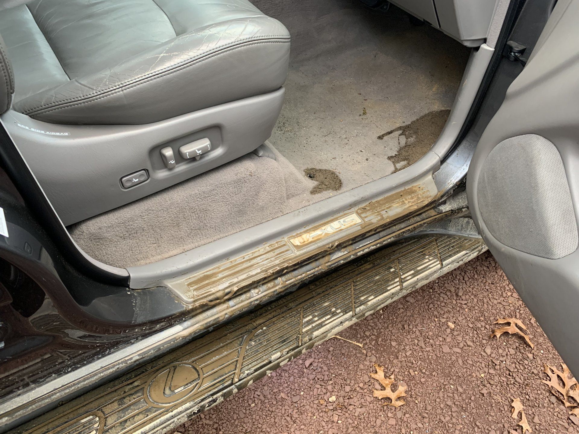

Found I mud puddle that I couldn't get through on my street tires. It backed out no problem but I got a little bit of water in the interior.
Not quite sure where it came in because the pattern on the carpet doesn't make much sense to me.
Does the small hole for the floor mat hold down have a path to the outside world? Or worse, is that just a path for water between the carpet and the metal to get to the top of the carpet.

There is a drain plug right underneath the carpet in both the drivers and passenger footwell. Pry up the plastic LEXUS door sill plate and lift the carpet up starting from that edge. It can be stiff so using a 2x4, pvc pipe, or something similar to act as a wedge is helpful. The drain hole is at the lowest point of the footwell, so I bet the stopping/accelerating motion is sloshing that water forward & backward making that pattern since both of those wet spots are right at the start of an incline in the footwell. Maybe idk

OH! Great information. Hopefully i'll be able to get out there tonight and do that. Thank you.
