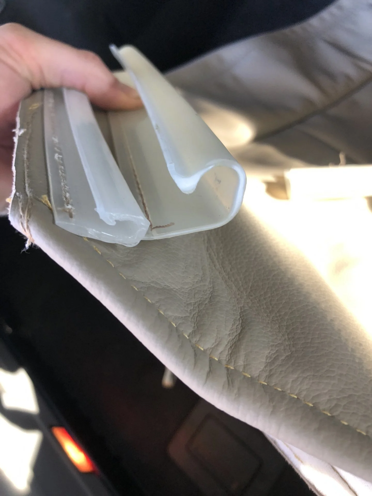

The car was in desperate need of a cleaning, luckily the early white LCs have no clear coat so with a little TLC from the DA polisher I was able to get the car shining like new. I also took out the back seats and did a deep cleaning on the carpets and interior. I was able to peal out the nasty faded fake wood trim and shocked to find perfect black plastic under it, I can't believe they didn't sell it like this. Seats were nasty so I ordered a set of Rides replacement leather covers. I was pretty happy overall with the quality, leather was really nice. Install was harder than the timing belt but I wasn't about the pay the $800+ quotes I was getting. If I was to do it over again I would uninstall the seats, remove the pans, strip the old leather and have an upholstery shop hog tie the new leathers to the pan and install myself. Also, some of the clips they provided didn't match the OEM so I had to have the old clips sewn on.

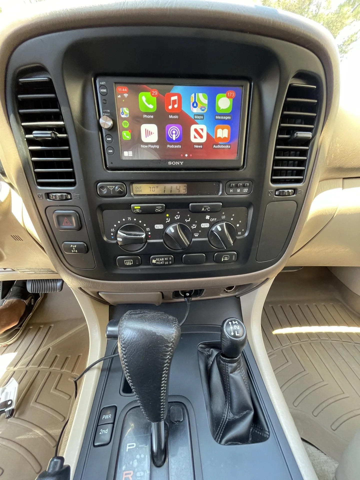

Sony XAV100 (a little out dated but a big fan of the volume knob)

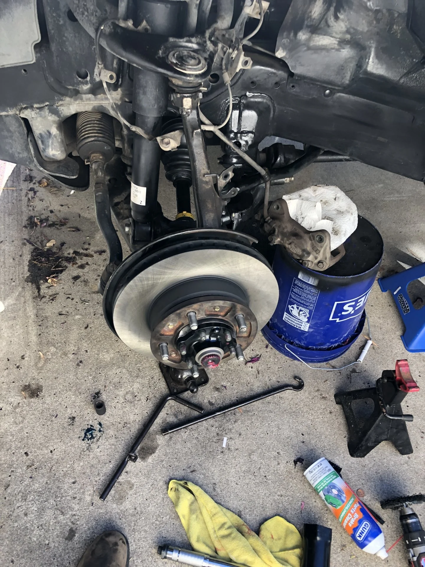

After the lift the CV's went pretty quickly. I pushed them a little too far on the trip to Denver and scored the bearings so rebooting wasn't an option.
245K
New OEM CVs
New Hub Flanges and Snap Rings
New Diff Seals
New Rotors
New Pads
Repacked bearings
Replaced all the other lil bits around the hub

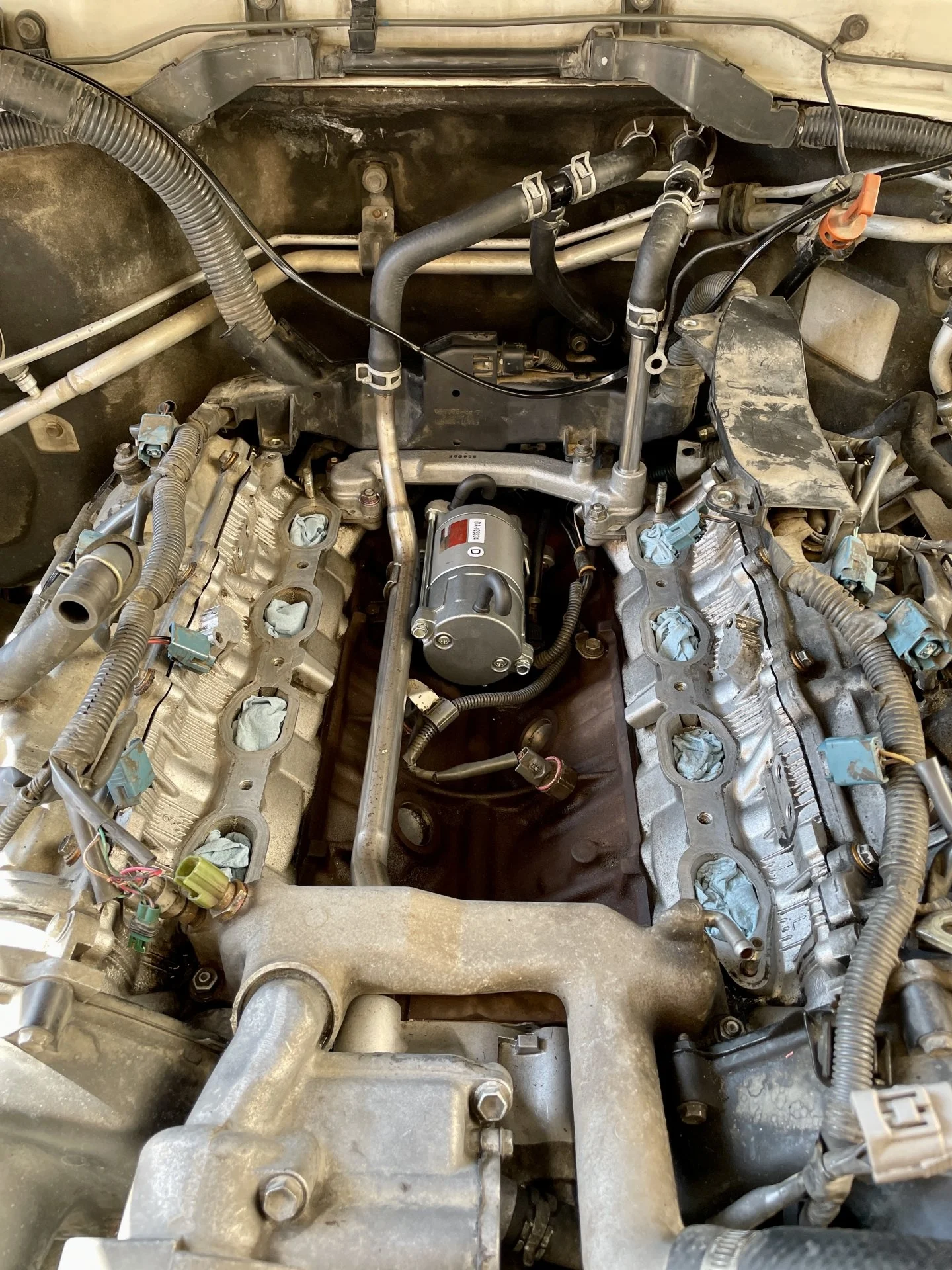

250k and it was time to get back on the maintenance. I noticed the rear bypass was leaking coolant where the upward pipe presses into it. This didn't seam very common but I did find some reports of it. Although someone mentioned it's possible to get this out without having to removing the manifold it almost seemed harder, plus I knew I would never get a proper torque. I'm glad I removed the manifold because right off the bat one of the manifold bolts wasn't even bolted in. I figured I would put a new OEM starter in since "I was in there" and OEM gaskets aren't cheap, I'm glad I did because once again cheap auto parts store brand starter. I'm sure when OP was trying reinstall the manifold they smashed it against the bypass pipe which lead to the leak. Also changed out the PVC valve, hoses, replaced fuel filter and cleaned up the motor.

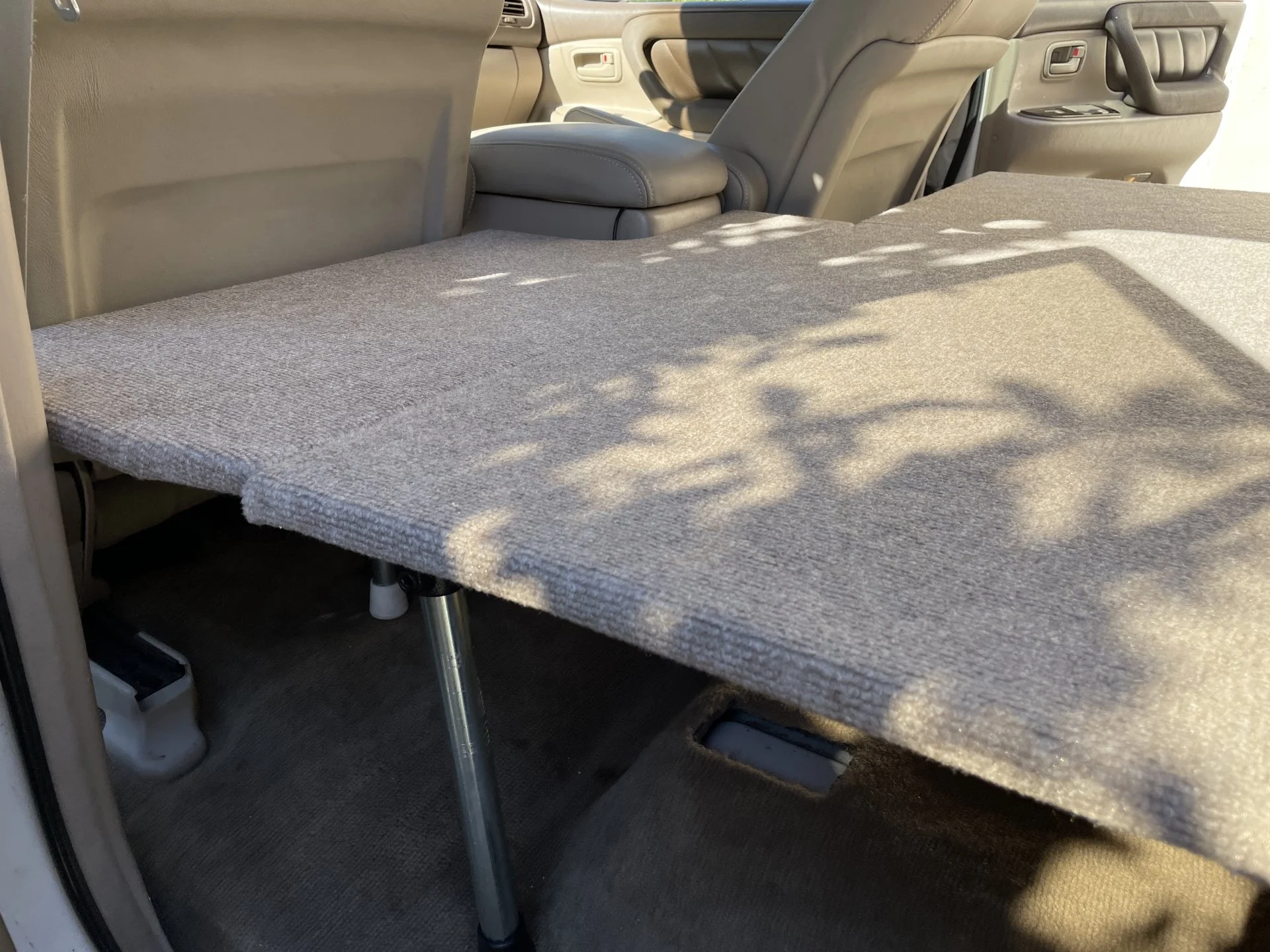

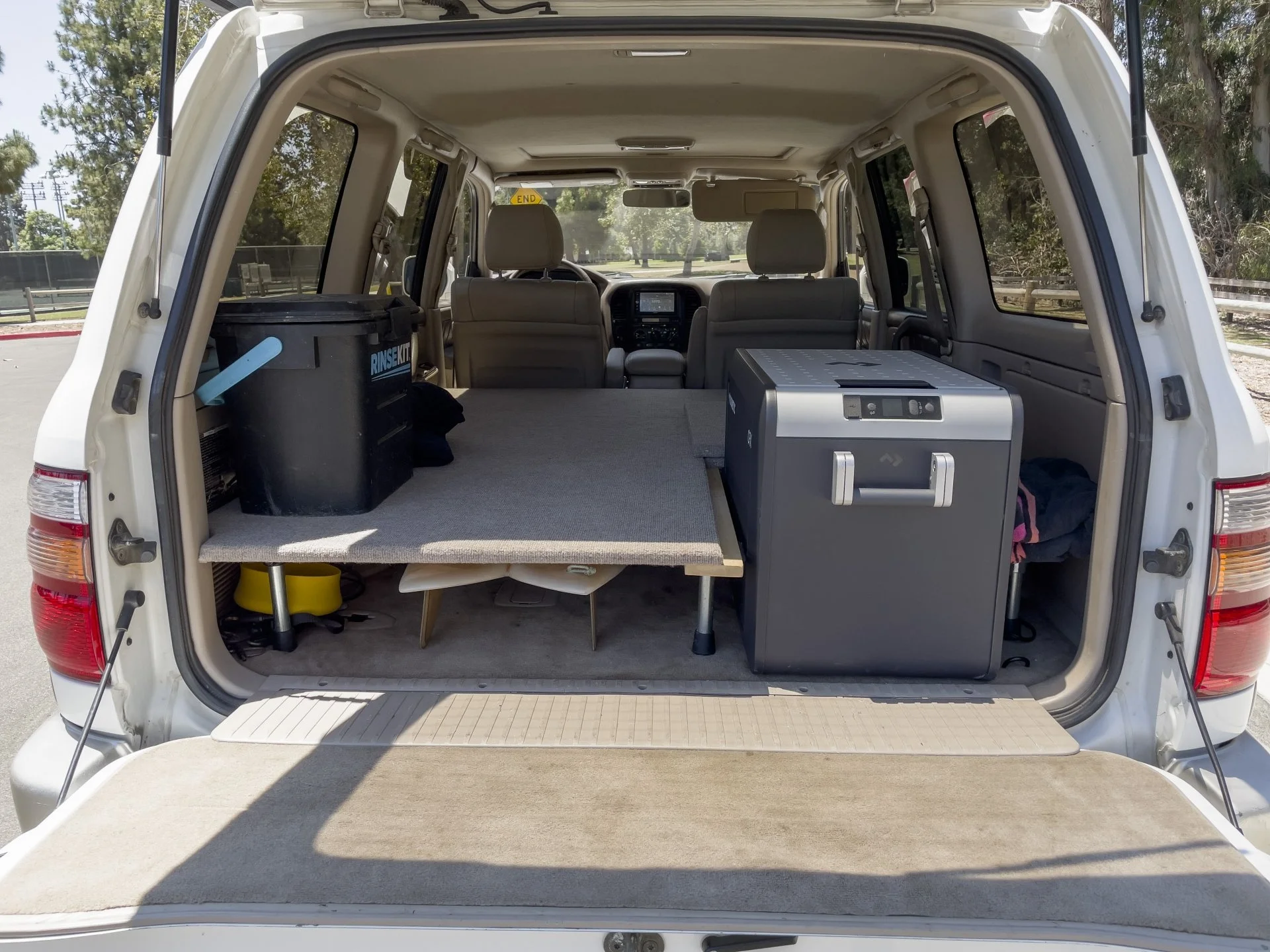

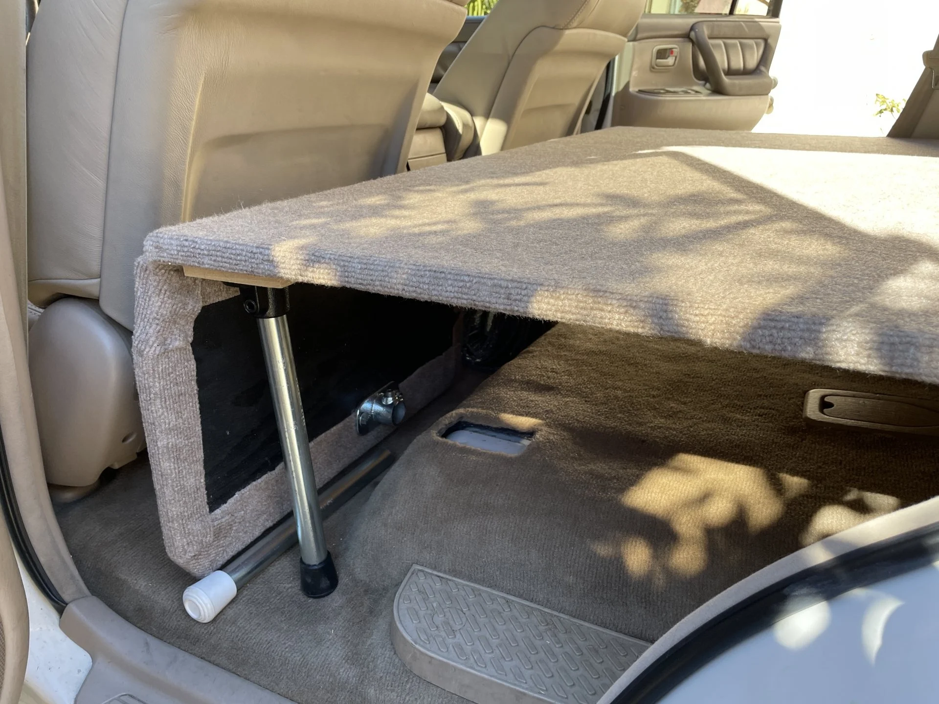

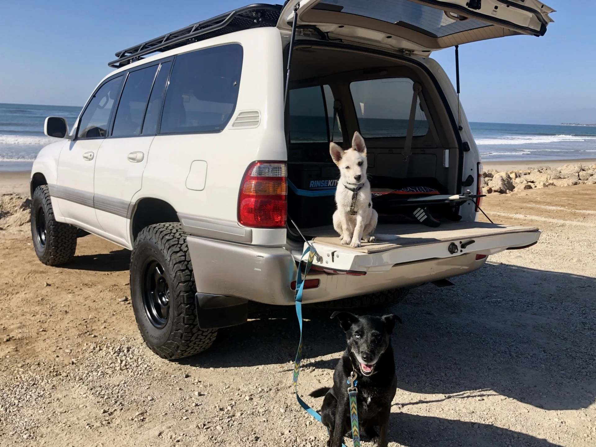

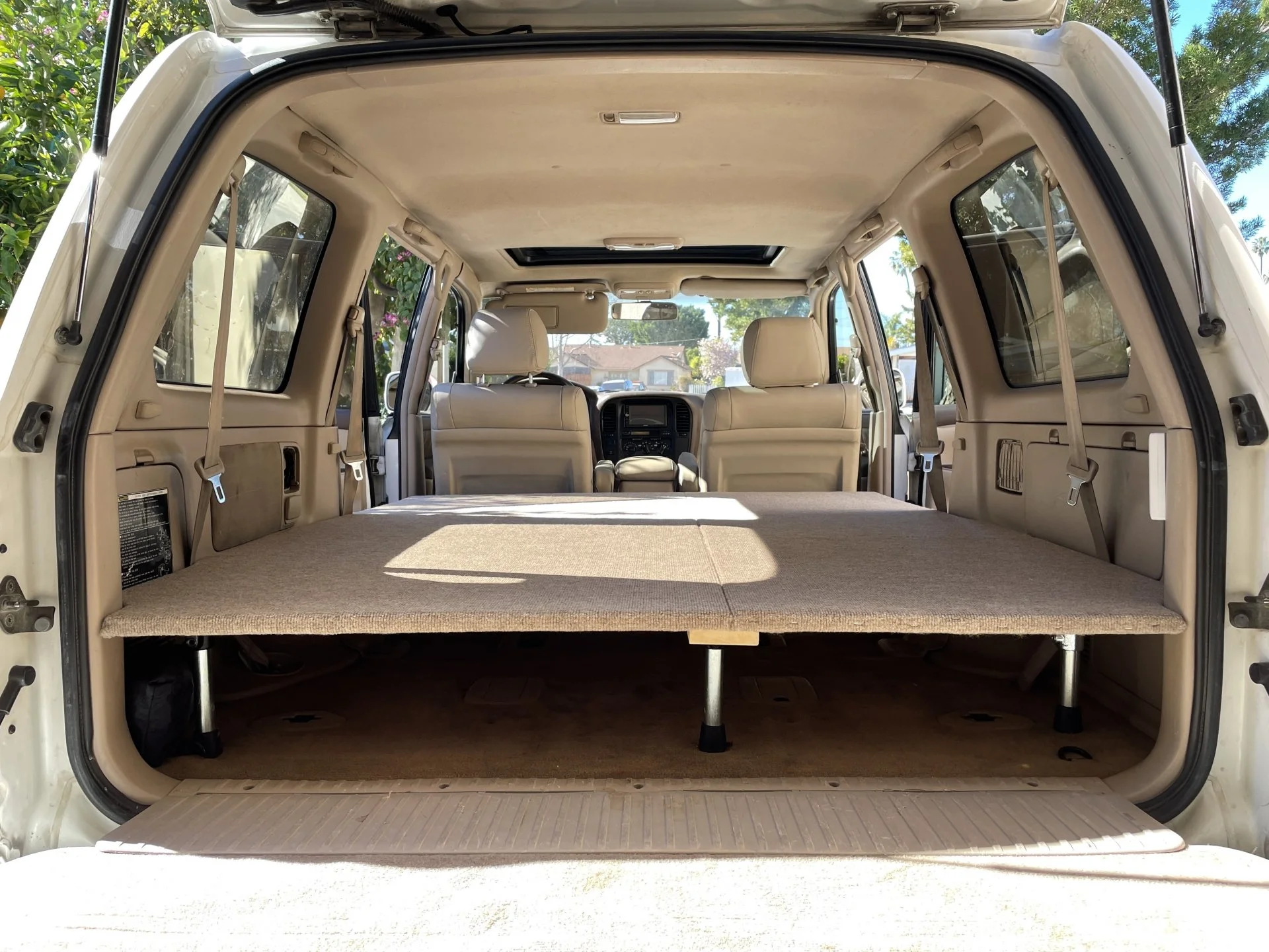

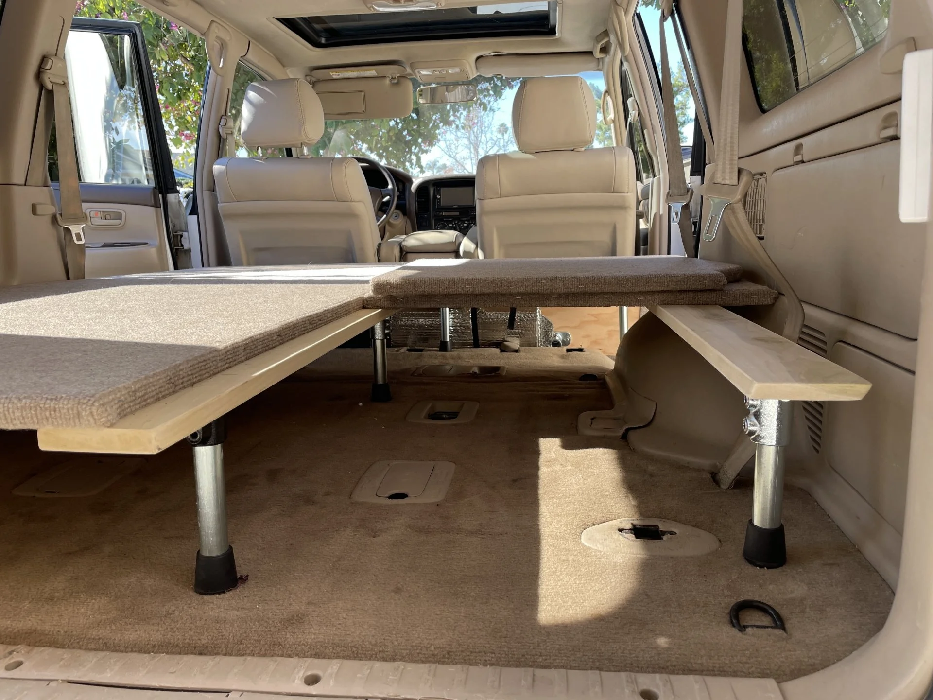

My next big project was creating a platform. I had the materials for a few months but really had a hard time deciding where to start. Finally the day before a camping trip I just pushed for 14 straight hours and figured it out as I went. My goal was to keep as much head room as possible for sitting up, I went with 8" which fit my surfboards underneath and a common size for storage crates. I went 60/40 so I could put in the rear jump seat if ever needed and made a cut out for my Yeti so it wouldn't block my view. I got the legs and mounting hardware from Lowes which I was inspired by from a YouTube video someone made building a 4runner platform. I also used some door hinges to create a swing up section for the dogs when the seats are all the way forward, this extends it from 6' to 8'
Yeti turned into a Dometic :cool:

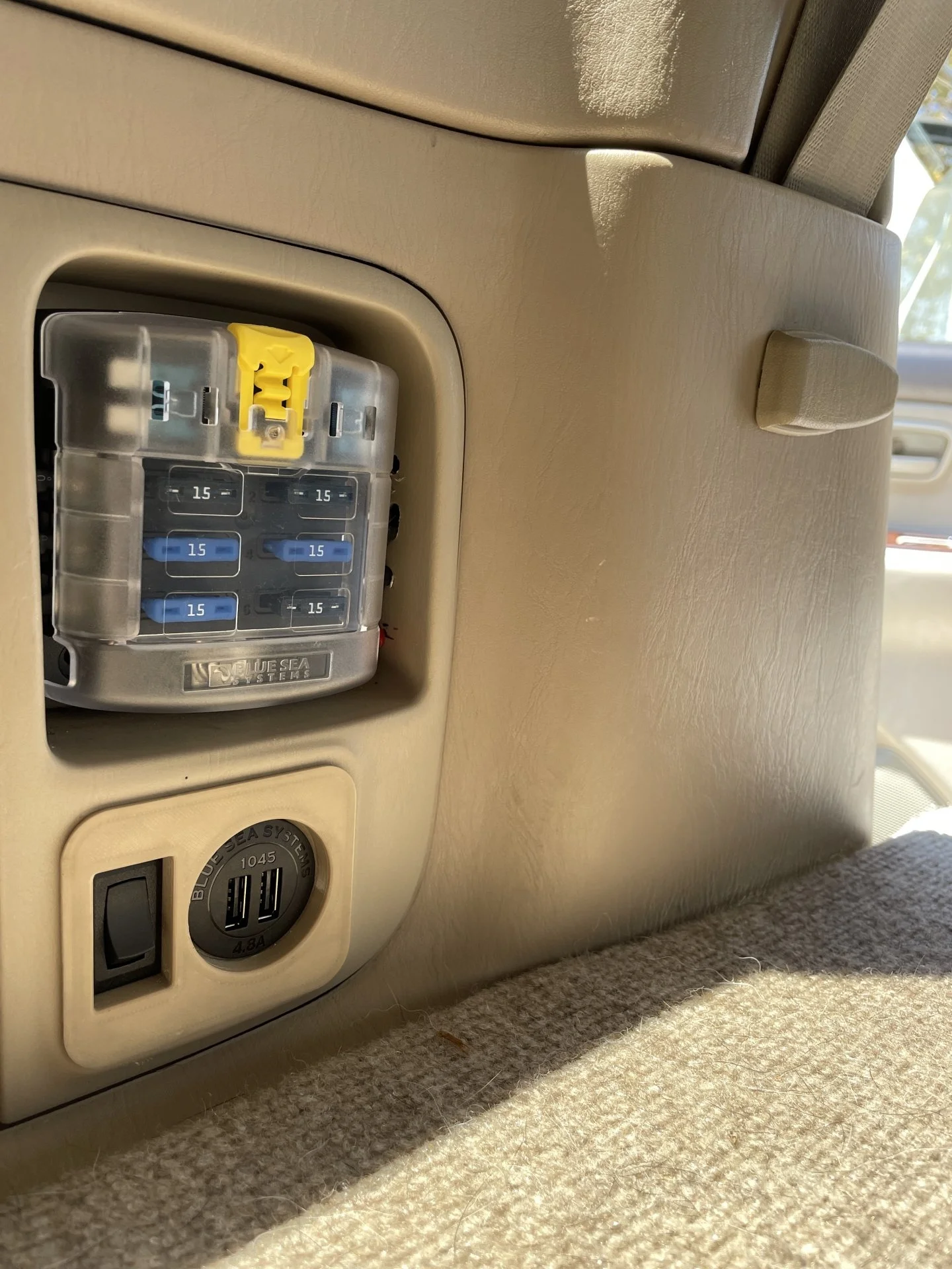

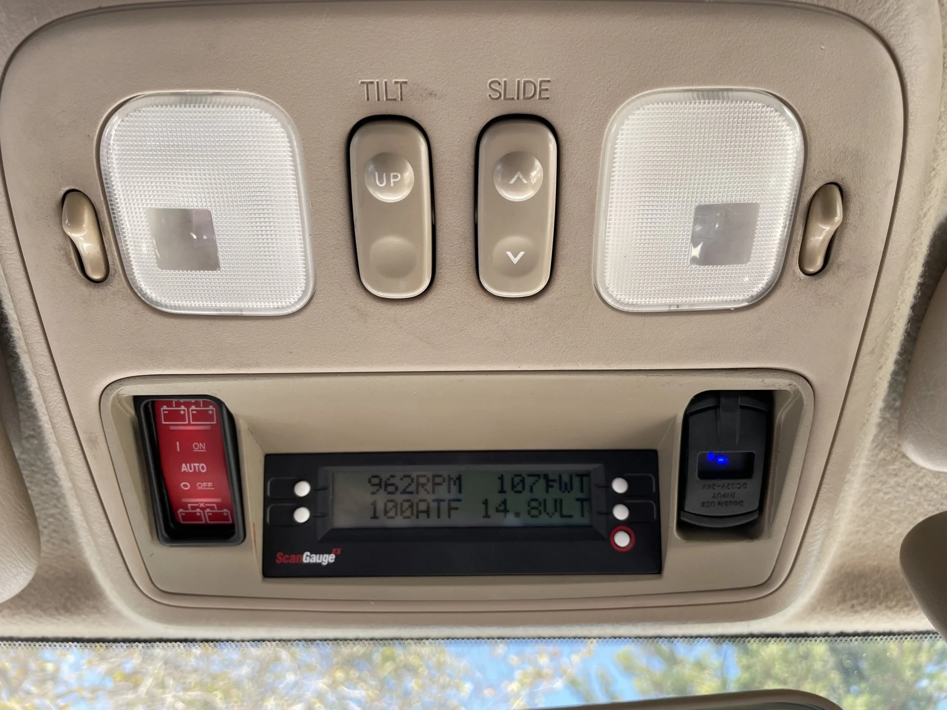

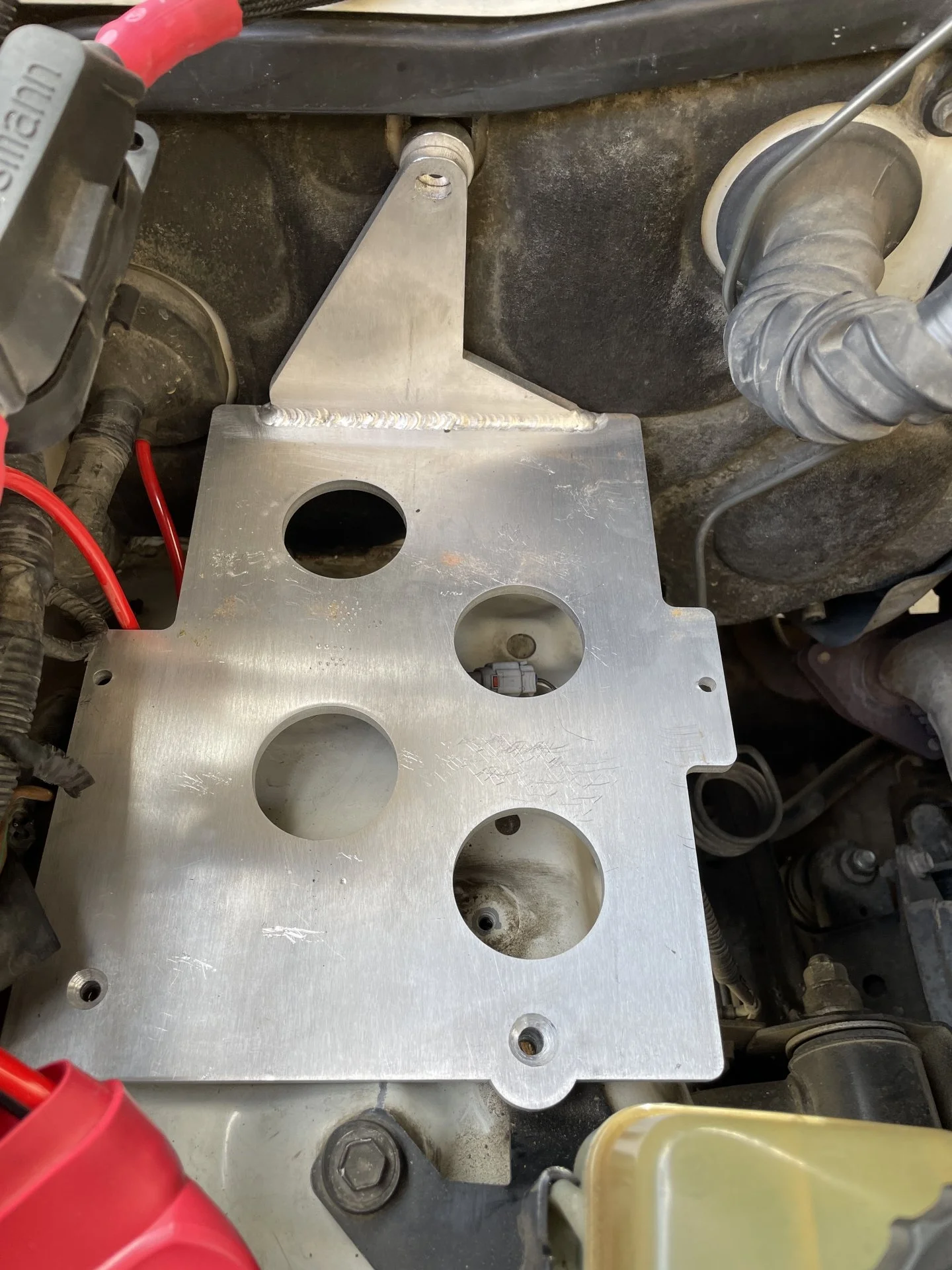

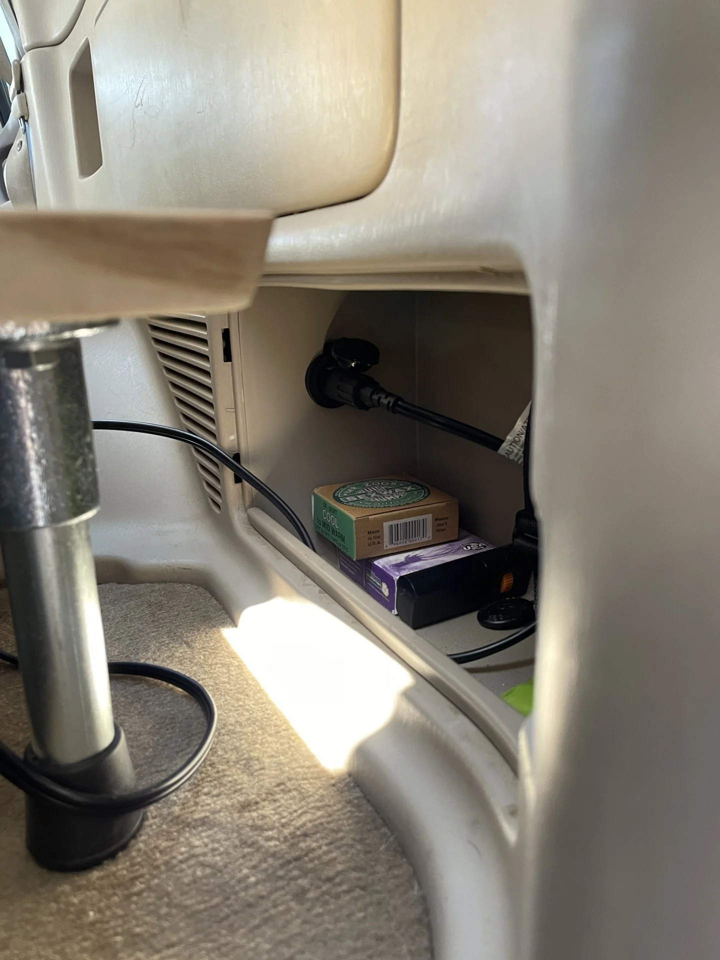

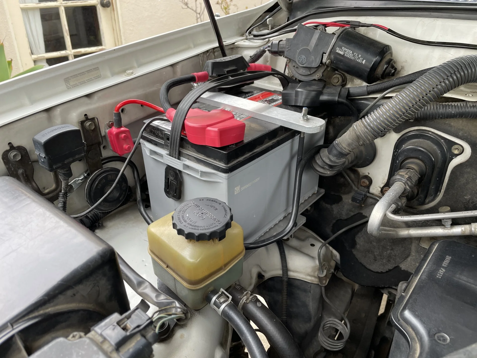

As you can see from the last post I caved and bought a Dometic during their Memorial Day sale. Rear socket wasn't doing the job so I decided it was time to go for the dual battery. I already have a viair 450p in front of my airbox so the Slee dual battery tray was over kill and I wanted a bigger battery. I had my buddy fabricate a tray that could fit a 34 upright or a 24 on it's side. I opted for the 34 since I'm using a cheaper auto store brand AGM and I've heard of issues from running them on the side, plus it was easier to work with. I pretty much copied @87warrior from his yearly update thread, he even provided me with his detailed wire digram that was a big help :cheers:
@BenCC scan gauge mount. House batteryvolt meter on the right, camera just didn't pick up the led.
Dometic Plug

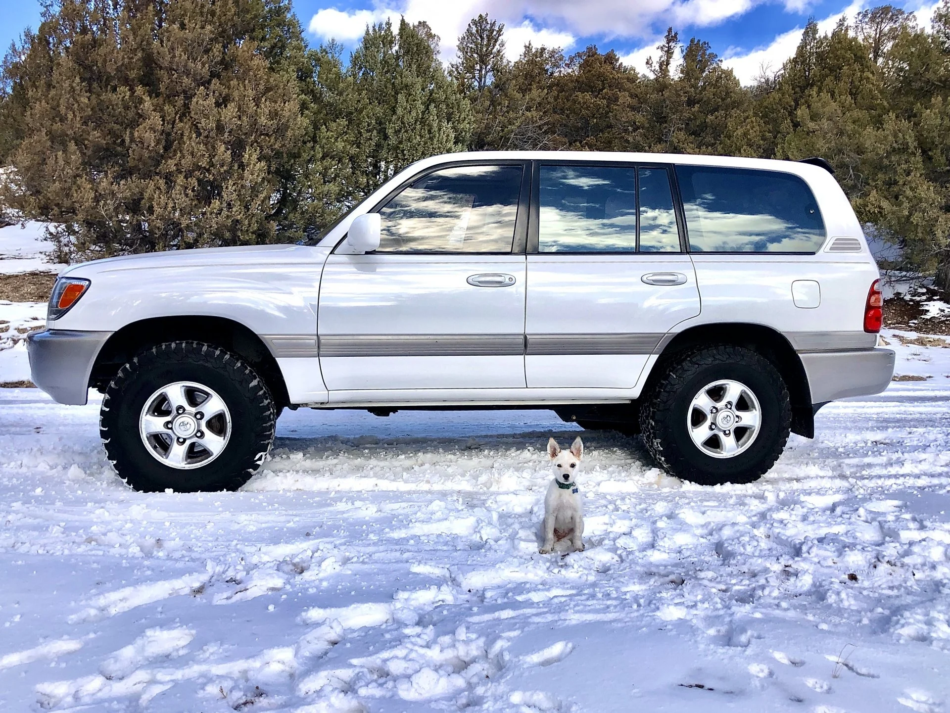

Here she sits 1 year later with 270k. I couldn't be happier with this truck, even though I wanted a lower milage LC I greatly under estimated how reliable these trucks are with high millage. Huge thanks to the MUD community, definitely the best car forum I've been apart of.
Dometic Plug
Any chance I could buy one of those battery trays?? Its exactly what i'm looking for
I’m sure he would do the tray. You probably need to find the hardware since it’s kind of a favor job. I used 1/4” all thread to make the post and counter sunk screws from the base.
I’ll reach out to see what he would do it for.
Awesome thank you!
