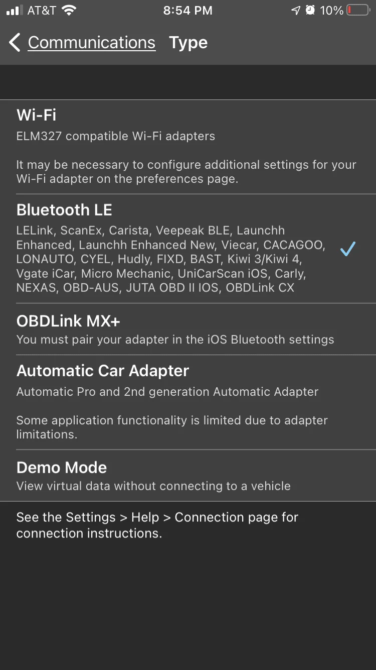

It was defaulted to Wi-Fi when I plugged it in so you have to go to:
“settings-preferences-communications-communications type” and change it in there.

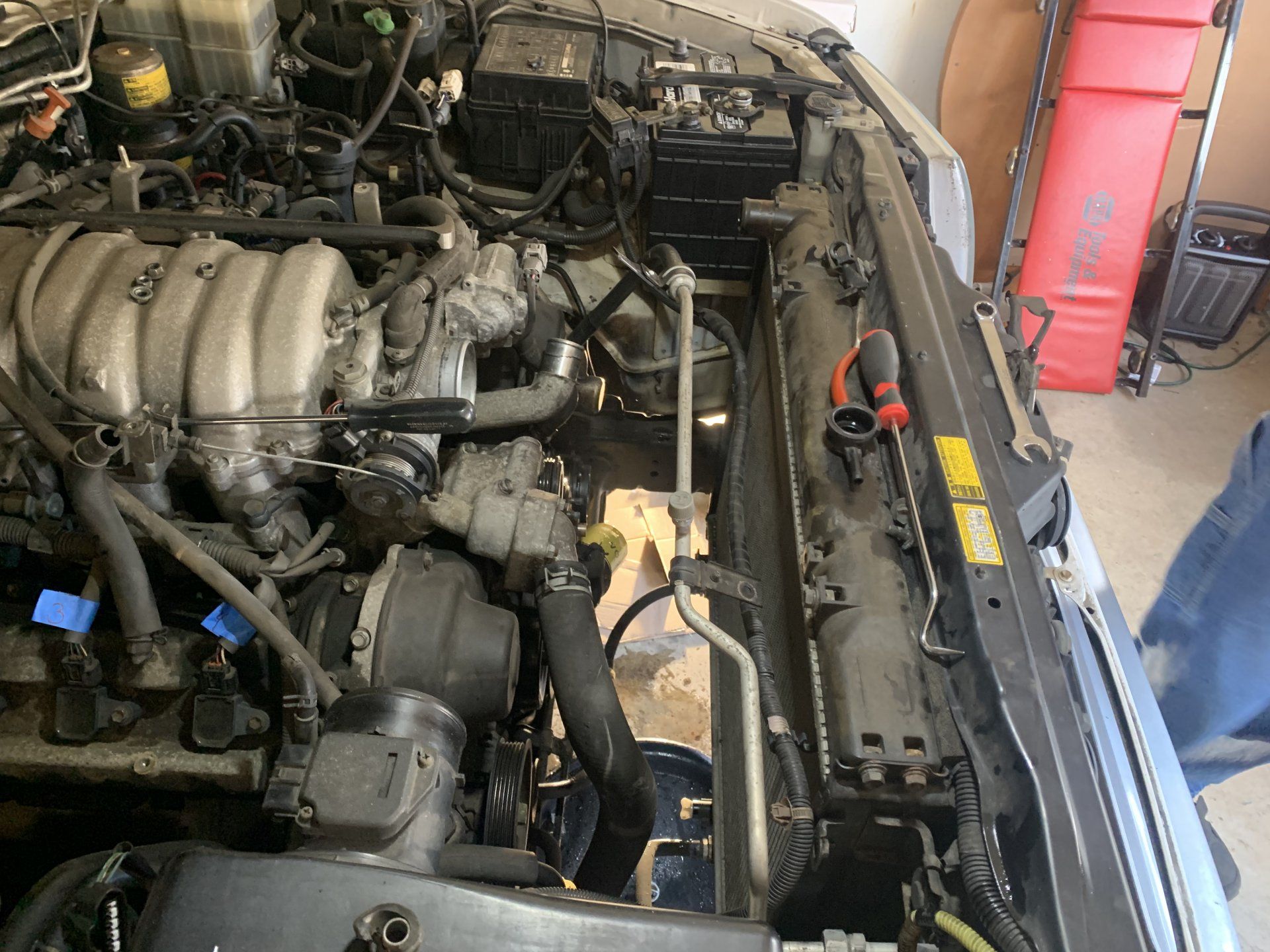

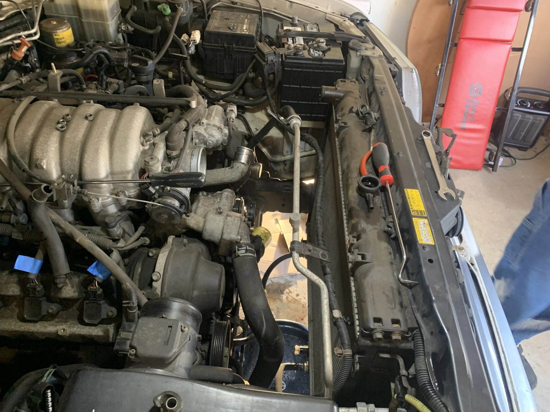

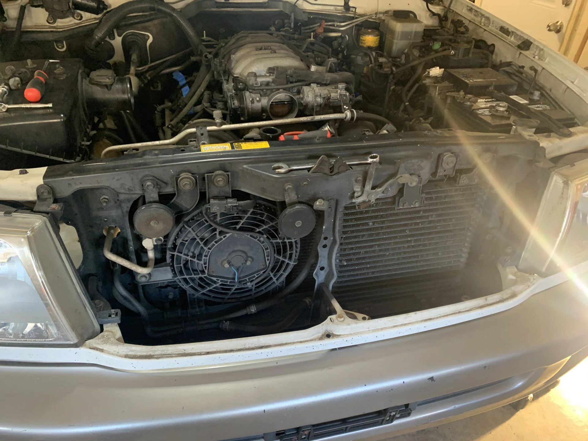

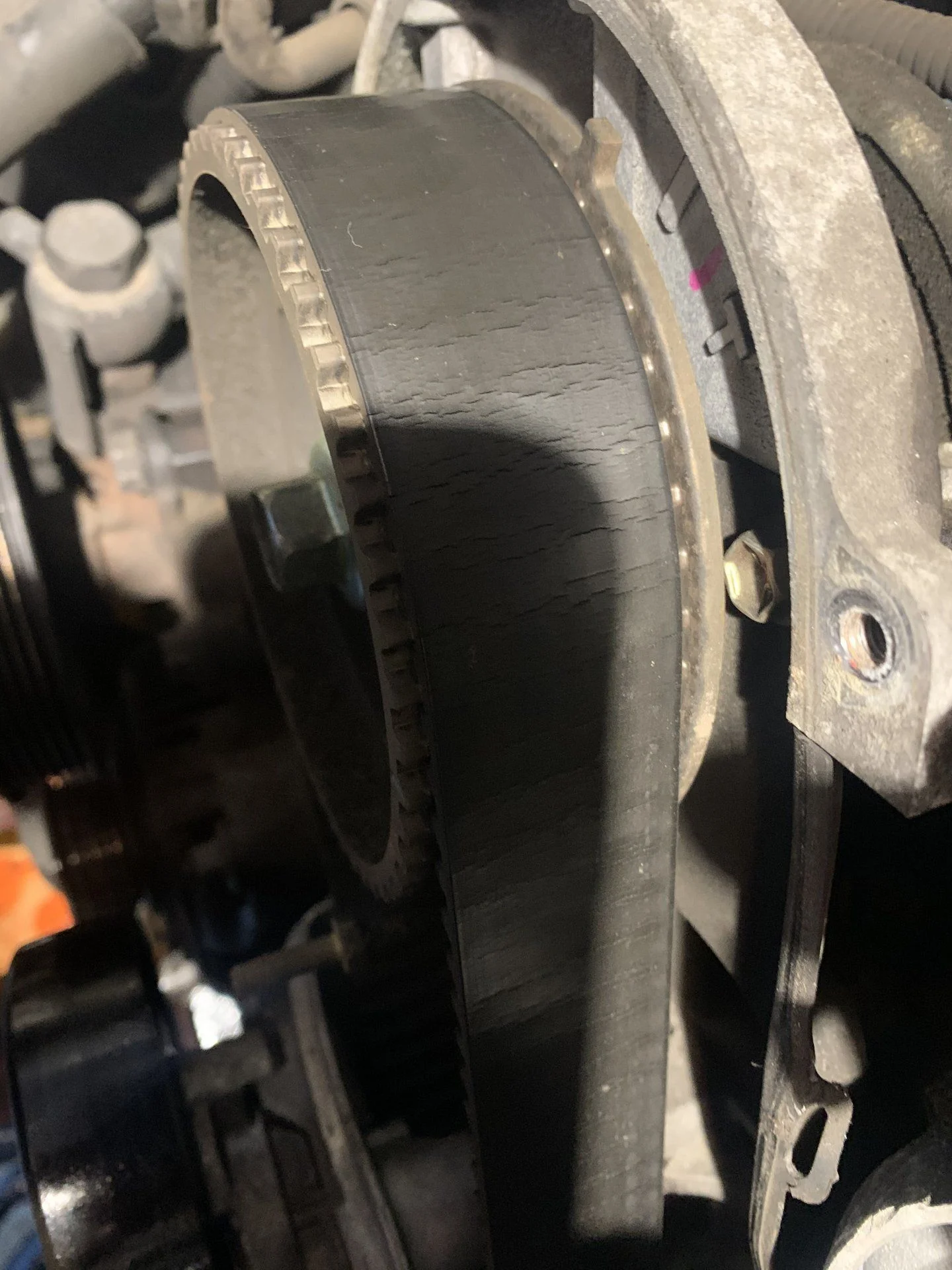

Jan. 1 I joined the club with my 99 LC with 230k. Only service records I got were a oil change about 1500 miles ago and rotors & breaks at the same time. Started the baseline project today though. On the list is all OEM, new radiator, radiator cap, upper and lower hoses, WP, Timing belt, fan, fan bracket assembly, drive belt, thermostat, tensioner, valve cover, gaskets, spark plugs, oil filter, Mobil 1 synthetic, Toyota red, heater tees, valve cover grommets, valve cover bolts, distributer gasket, camshaft crank seal, air filter. Good start, and so glad I’m doing this now. The TB is in terrifying shape. Hopefully going to get the rest done tomorrow.

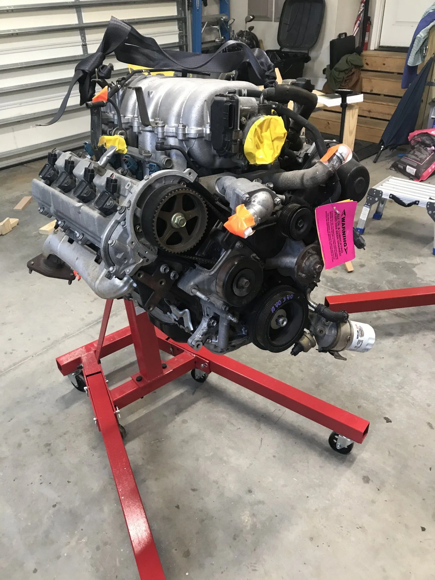

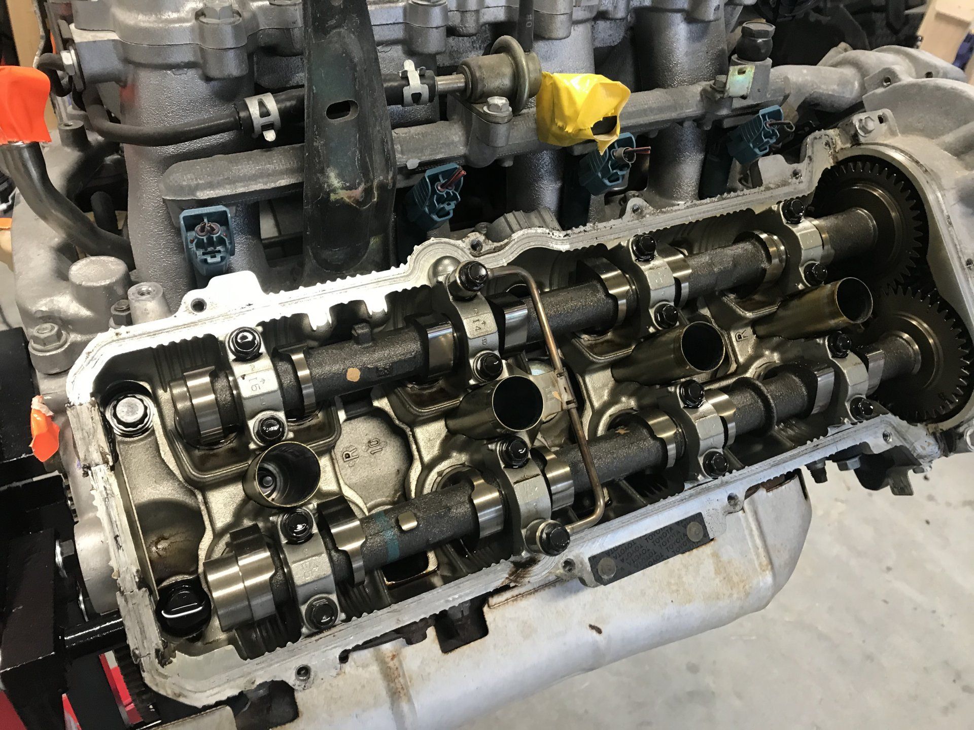

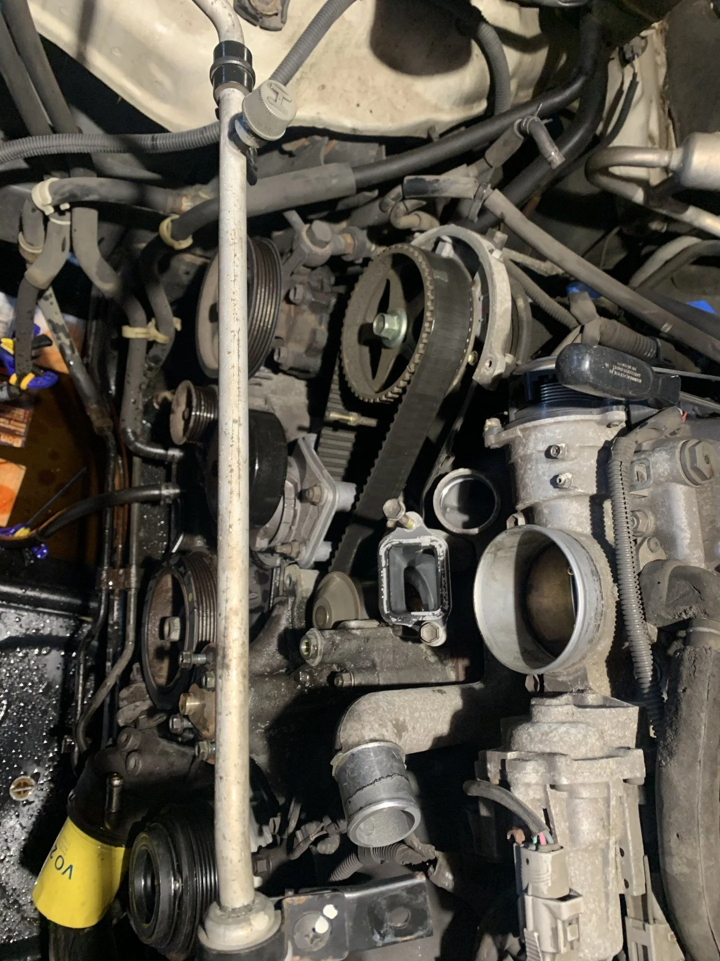

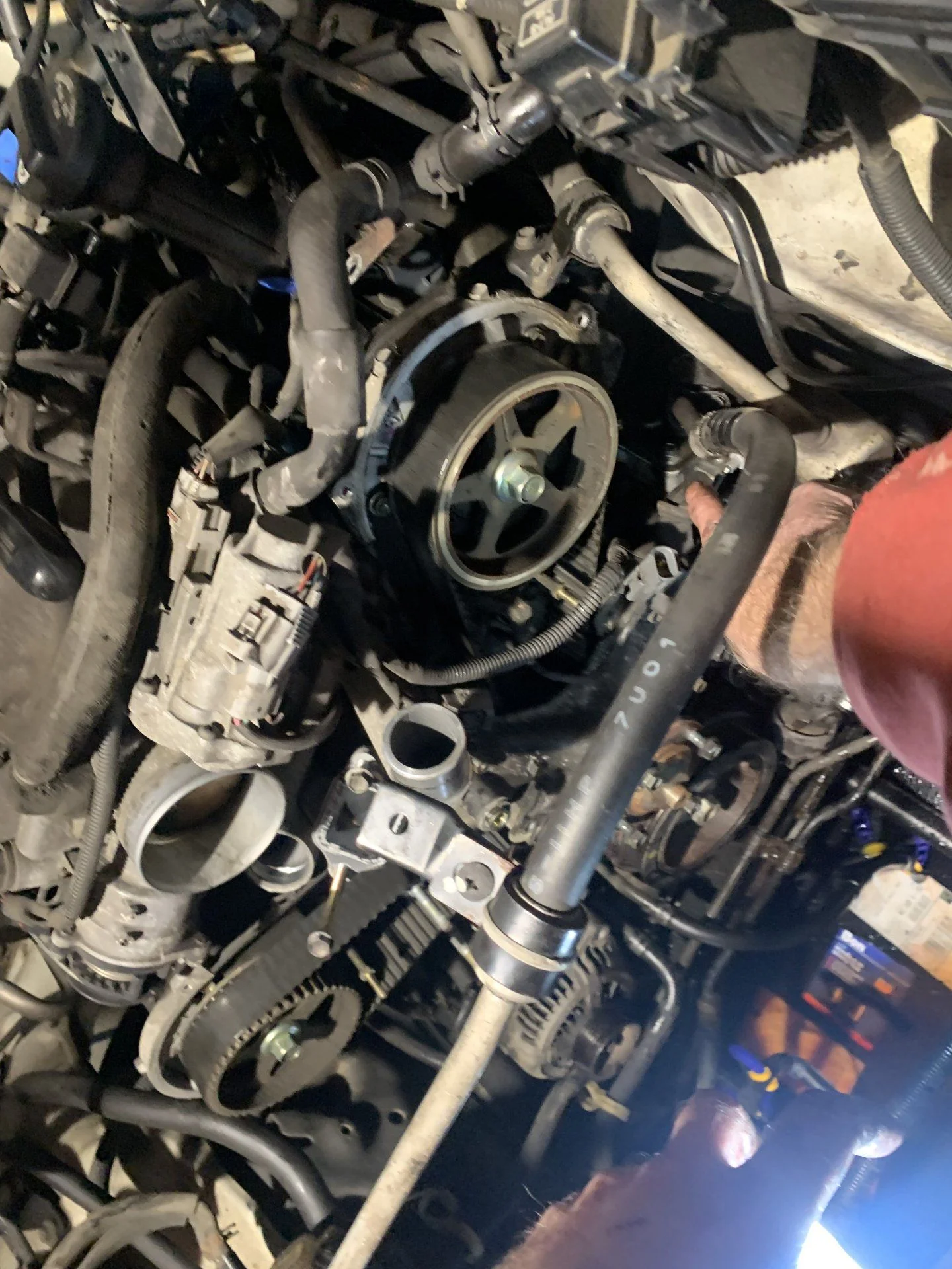

Prepping for an engine swap on a new friend’s Cruiser(blown head gasket, coolant leak). Valve cover gaskets, plug seals, starter and complete timing belt job with all the toppings before the install. So easy with the donor engine on a stand. 👍
Heck now's the time to put on some nice headers! That donor engine looks fresh. Did his heater T's go or did he just run too low on coolant?

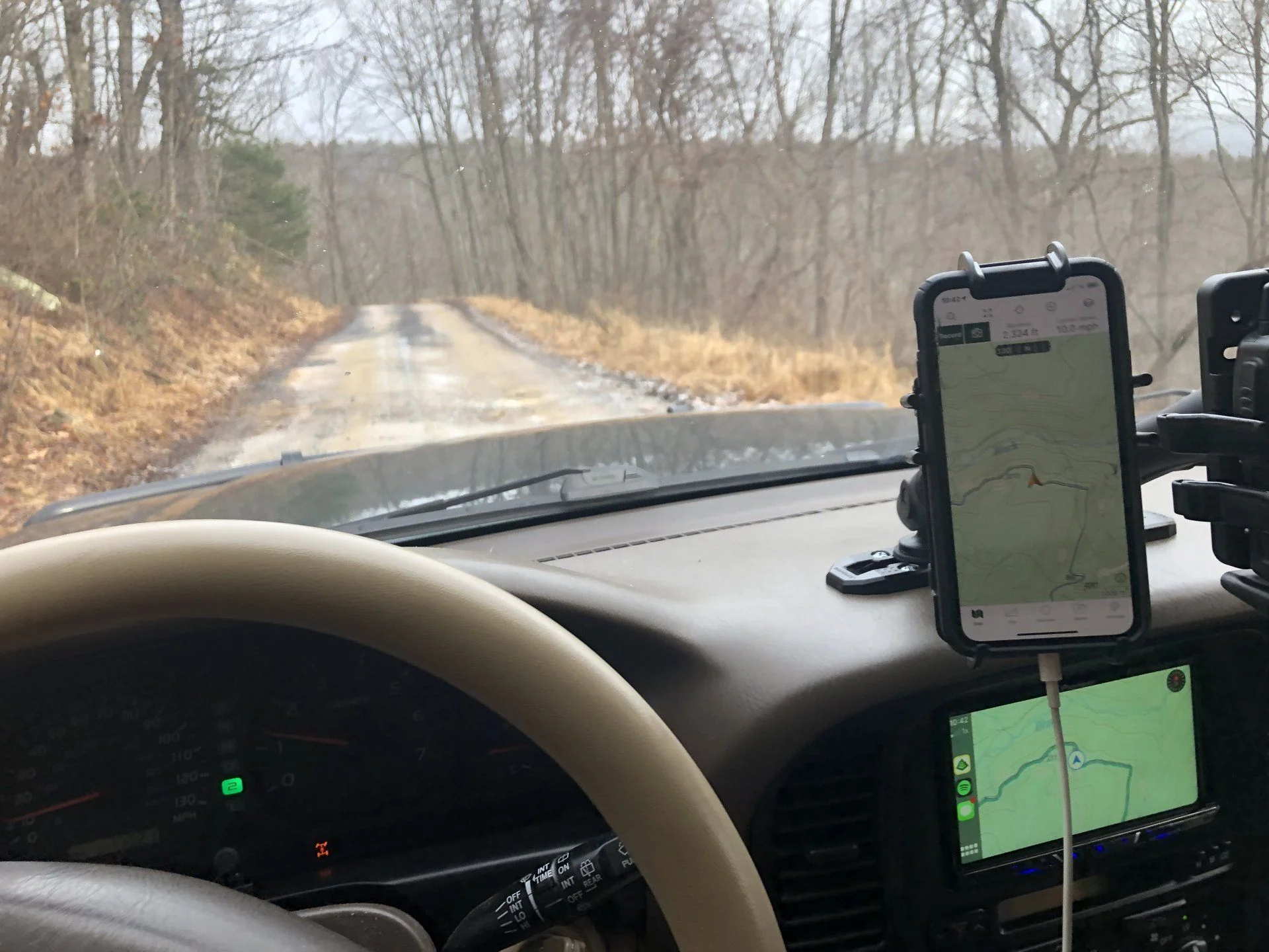

Getting two different map views at the same time has been awesome.
