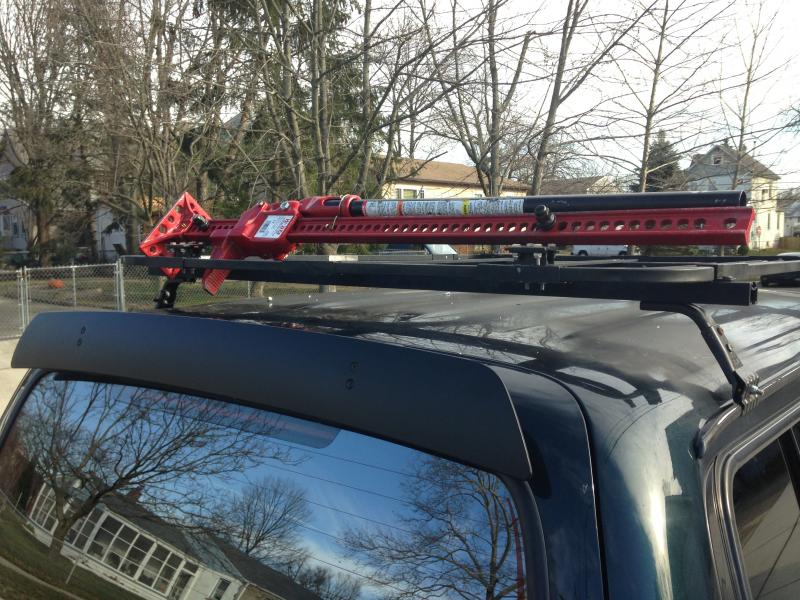

Mounted my HiLift on the roof rack. The Hella plastic light housing snapped off which made the opportunity for this weekend project. I used the Hella light brackets since they were no longer needed. Mounted it on an angle to make it easy to remove and inside the rack area for when i get LED light bar. Used spare lug studs and wheel nuts in the original bracket mounting hole for the light stem, fit like a glove! :cool:
