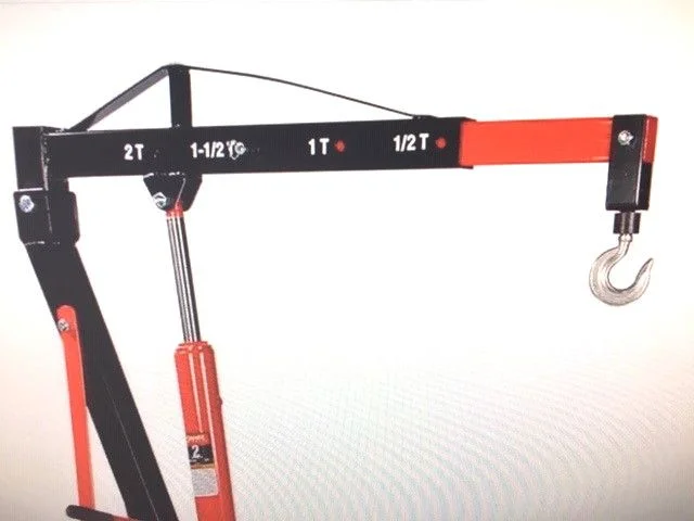

2 Ton MINIMUM. The 2 ton rating is figured at the shortest positioning of the arm. As you extend it...the rating goes down dramatically.

I've pulled complete drivetrains from 80's over a dozen times, including 1HDT+A442+HF2AV. I have a "2 ton" hoist similar to the one in post #10 and i always used it at 1/2 ton setting when im too lazy to remove the front bumper. Extending the arm all the way out gives it more lifting range, which allows you to put a load leveler there, and STILL have enough clearance to remove the drive train without removing the front bumper or the tires. It never felt sketchy to me at all.

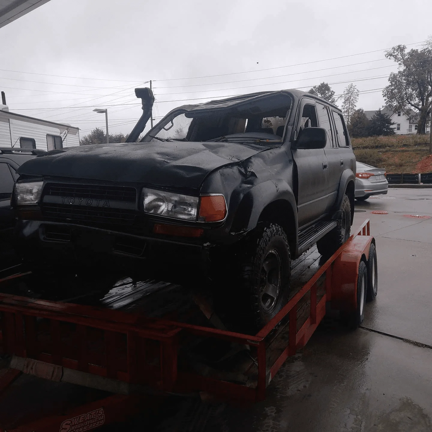

its currently in the truck so it looks like any other engine other than the painted valve cover. been out there all morning working on tearing the truck down. so much harder to pull an engine when you cant unbolt stuff :-/
pic of the truck so you know what i am working with.
