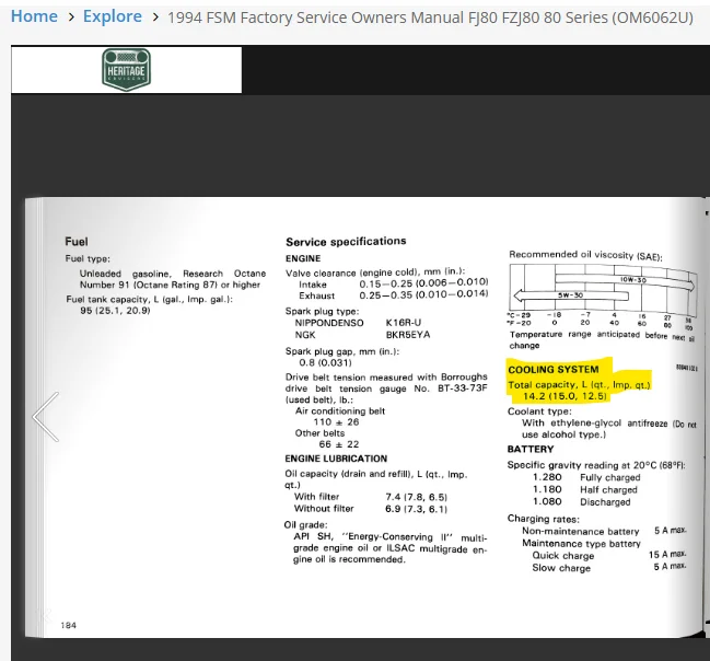

the FSM I have downloaded has this as the front cover:
14.7 litters/3.9 gallons. If you drain from the radiator, block drain on the drivers side of engine and open up the heater controls to hot. I use two full gallons of Toyota red non diluted and two gallons distilled done and done. Goof idea to flush out also till it’s running clear. Do you have FSM for your truck? It’s free to download I the resources section and will give you the exact fluid capacity.
this one in the resources section says 14.2L as well...

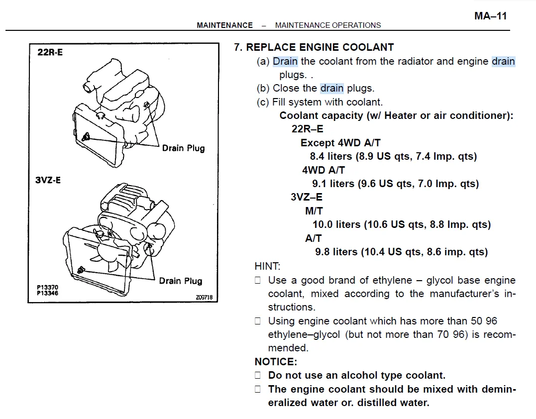

It's a hair over 14 litres. Ignore the manual with the 22RE etc listed, you won't find these in an 80.
