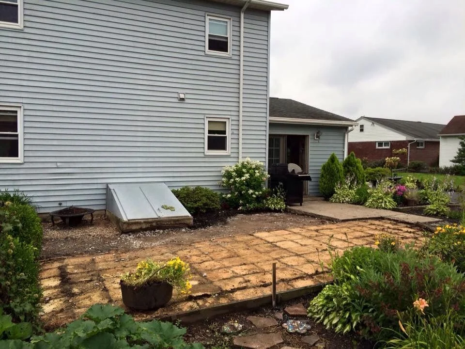

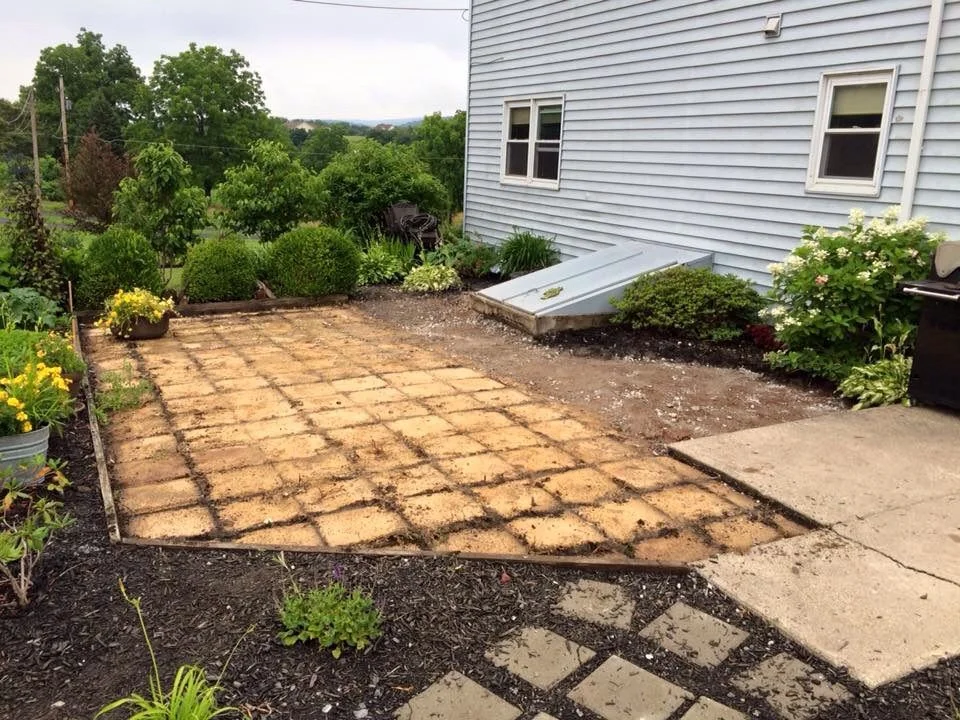

Backyard demolition has begun. We started today by demoing the concrete patio slabs (4", 6", and 12" thick all done with sledge hammers. Two more slabs to go tomorrow and then layout and base prep can begin. Once this one is done, we have a new lower section to go for a total of 800 square feet.
Here is what we started with.
End of Day 1.

Gary, we busted all of the poured slabs out by hand with sledge hammers, shovels, and pry bars. Looking back, a jackhammer or skid steer would have been really nice. The other part of the patio was 16"x16" pavers that we pulled up. Need to dig down now to get the base correct, PO installed the previous patio over clay and didn't grade it correctly. Some of the pockets of clay are so bad, our 2 year old was able to sink in.
Going to be installing at least 6" of sub-base and then 1" paver bedding. We have a three piece pattern Belgard paver going in then. This is our first time doing a patio like this, but figured we would give it a shot.
