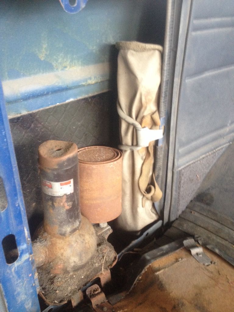

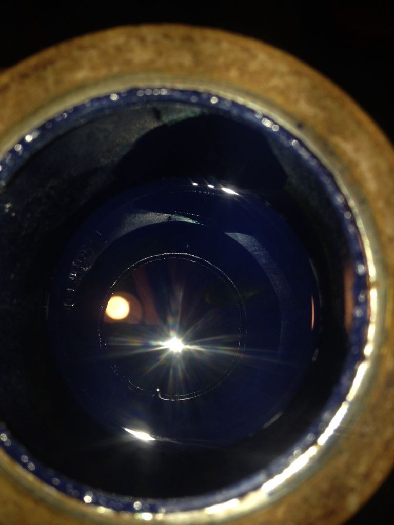

As I was tinkering on my 60 I opened the jack access panel and found a can of touch up paint. View attachment 1092103View attachment 1092104
Eric then inhaled deeply when he released the heretofore virginal 1980's factory paint awesomeness. This trip to Aladdin's cave ended up at the Beach!
I do wonder where I put the yellow outfit.
