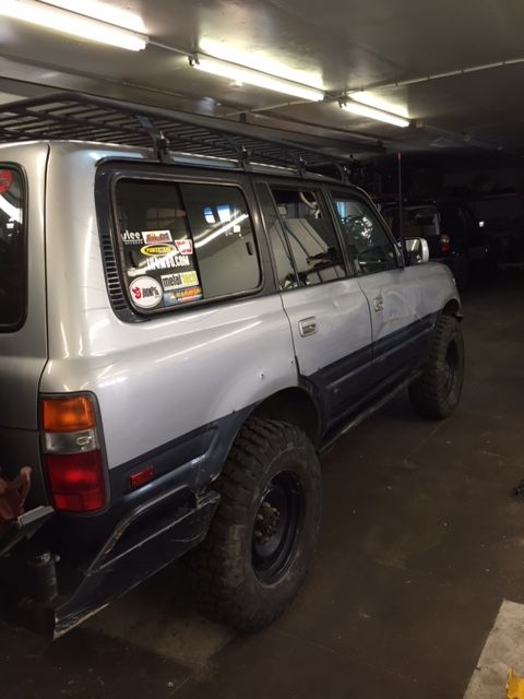

Finally lost a fender flare at the CMCC last weekend. As much as I love the look of the flares, mine were all trashed, so it was time for a deflare.
It took less than 30 minutes. I unbolted any of the remaining 10 mil bolts, grabbed the flares and just twisted/yanked them off o_O. Every one of them came off quite easily.
Grabbed a pair of vice grips, clamped onto the mounting studs that were still poking through the front fenders, and applied some tension as I unscrewed them, leaving the nuts to drop into the fender. There were a few stubborn ones that I had to grind off. I also had to drill out the rivets for the mounting brackets on the rear doors.
Now, I have to decide what I want to do next as far as the holes and paint scheme. Probably will reproduce the flare lines with matching color paint. Might just pop some painted plugs in the holes...who knows.
I'm actually bummed to be flareless, but I knew it was coming...I'll get over it :(

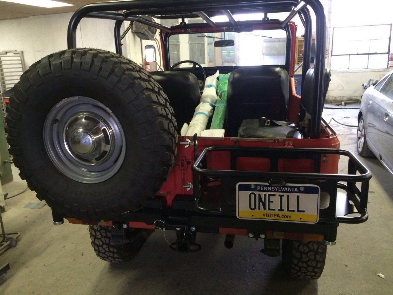

So added some new gear....4+Plus/LCWizard roll cage/roof rack and tire/cooler carrier. Can't recommend Dave Gore (lcwizard) enough. Great guy to work with, very reasonable and great product.
