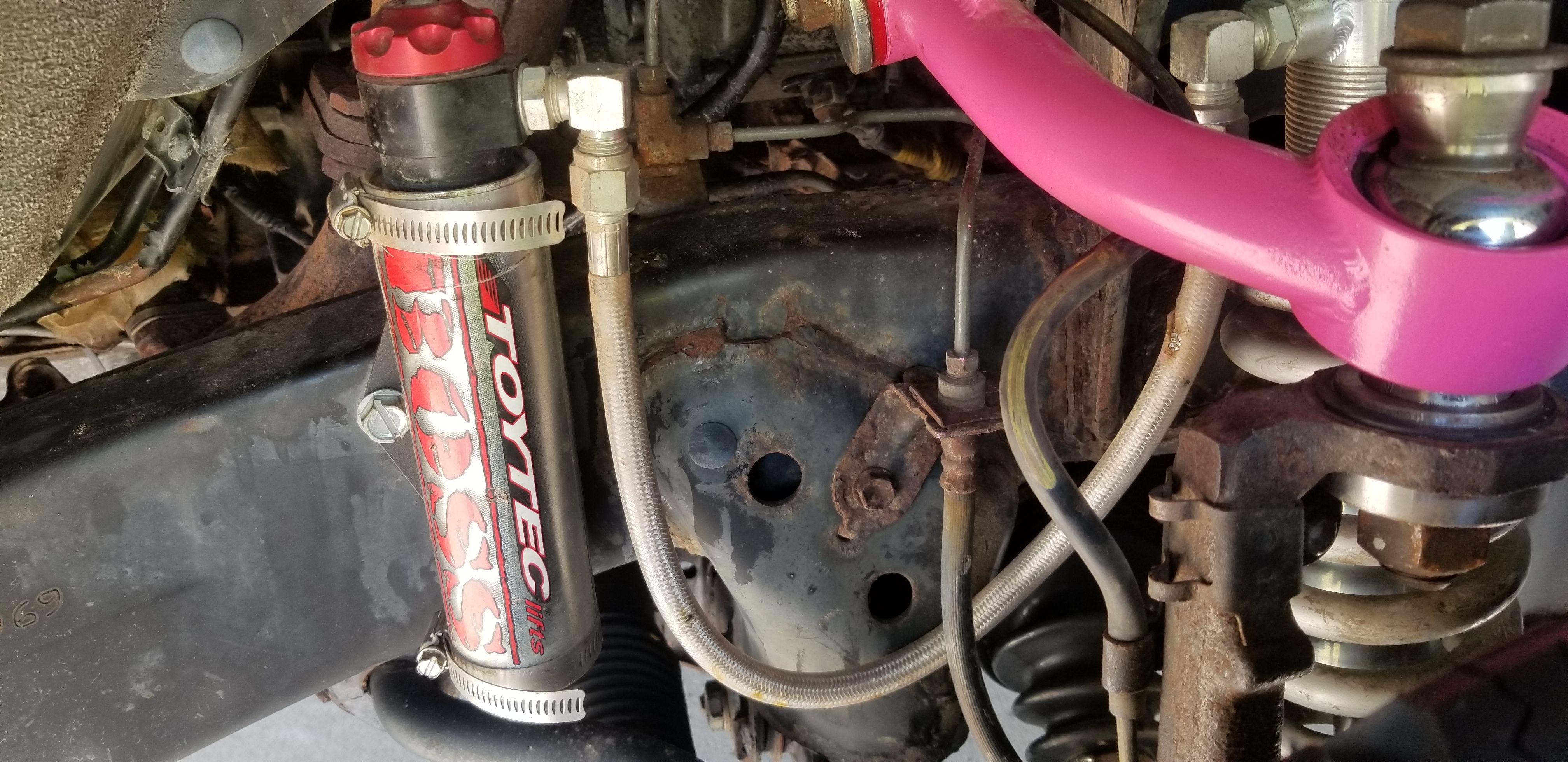

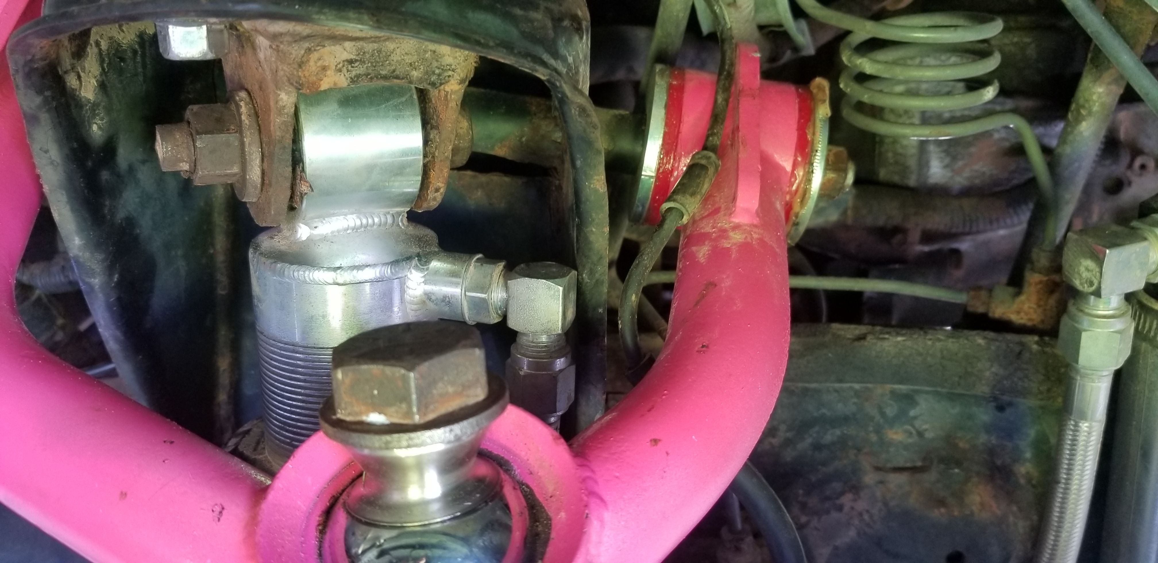

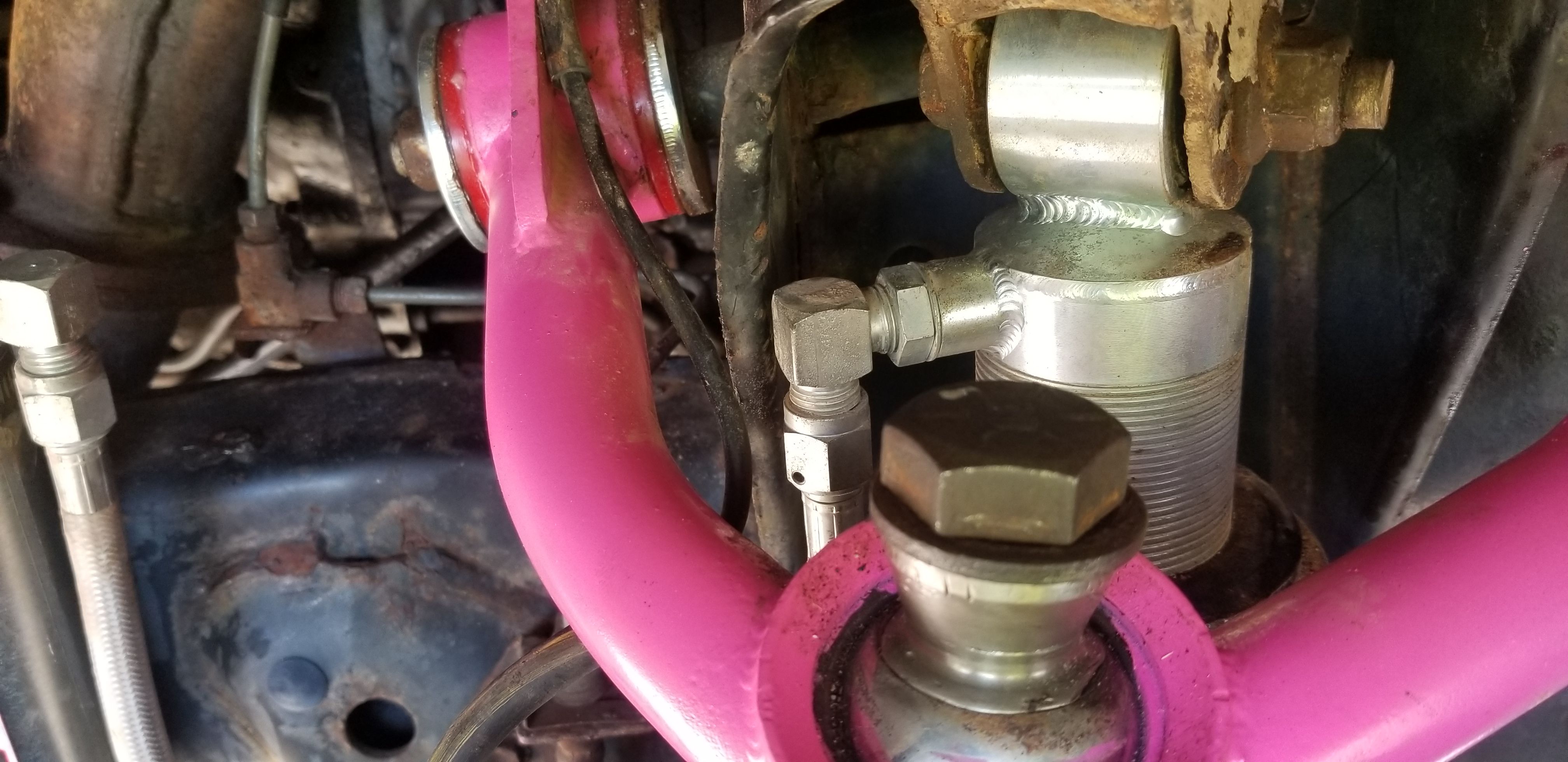

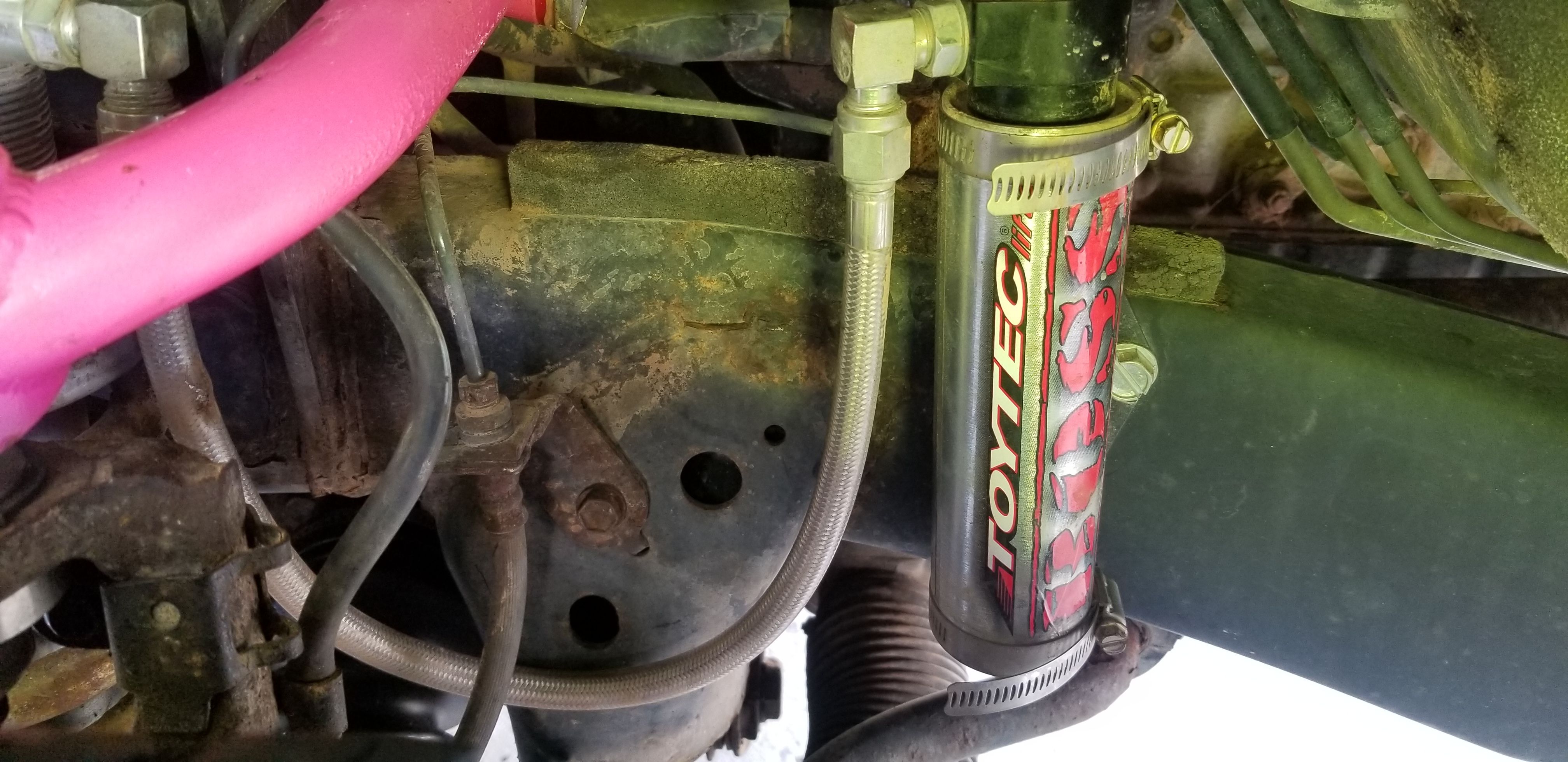

Been doing a few things here and there on then truck, one is clocking the shocks so the upper arms don't hit the line to the reservoir and running then line under the brake line so they will not rub through. I need to clearance the shock tower a little for full stuff occurrences but it should be fine. Only reason this is a problem is because I'm cheap and just ordered the shock bodies, if I had ordered the ToyTec upper mounting plates too I amsure they would be in the position I need not to interfere.

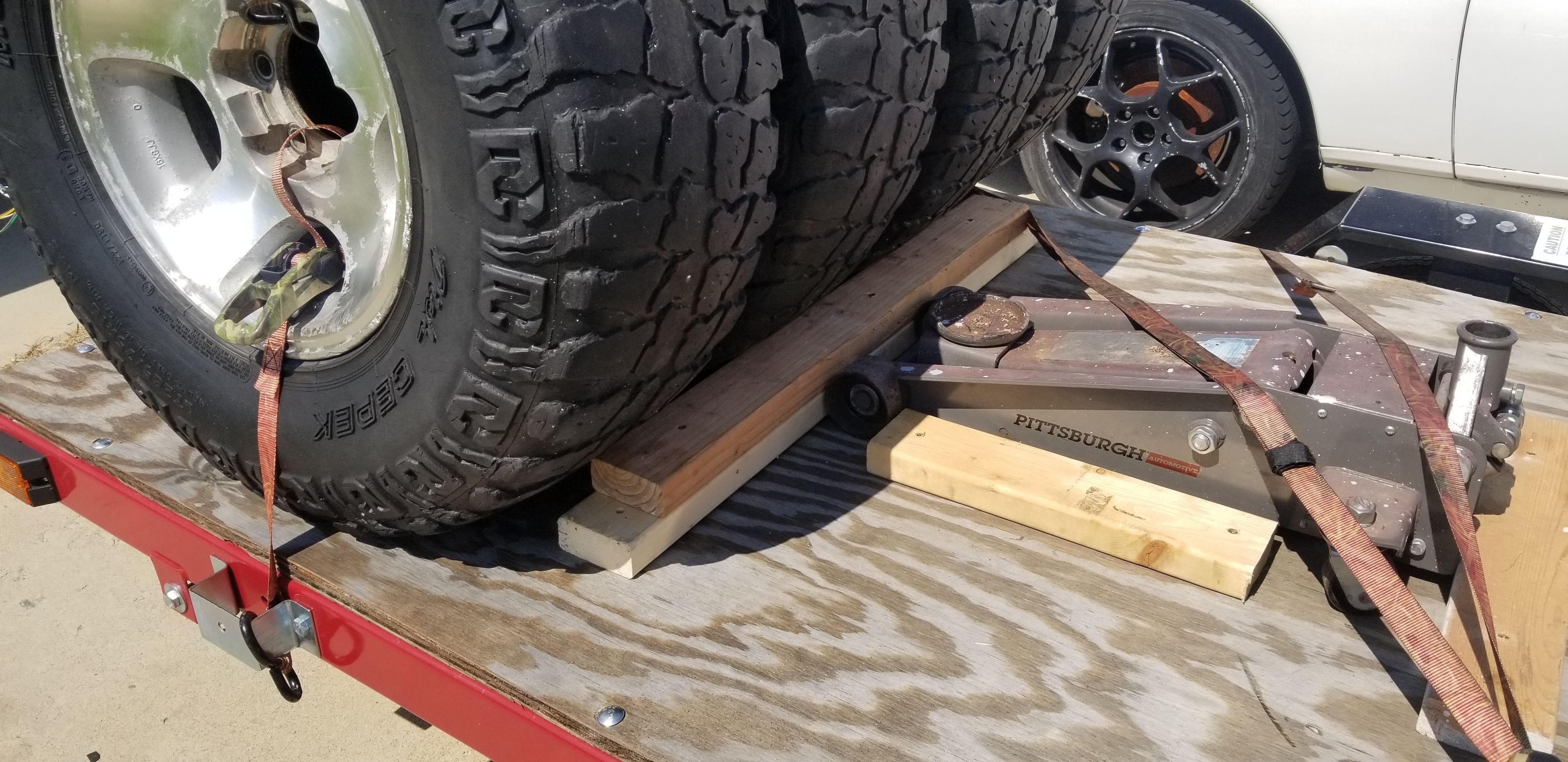

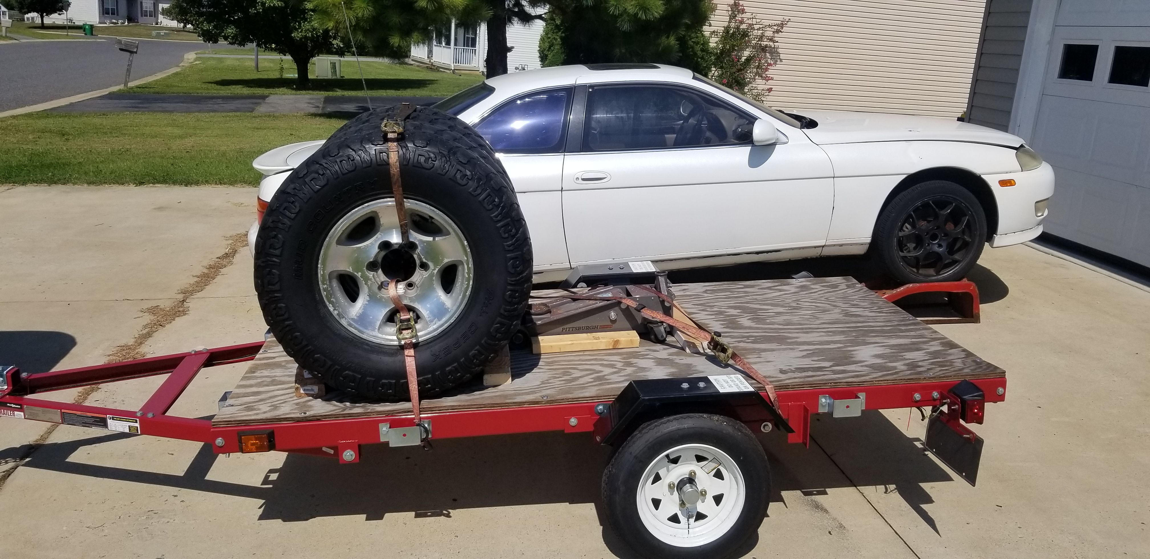

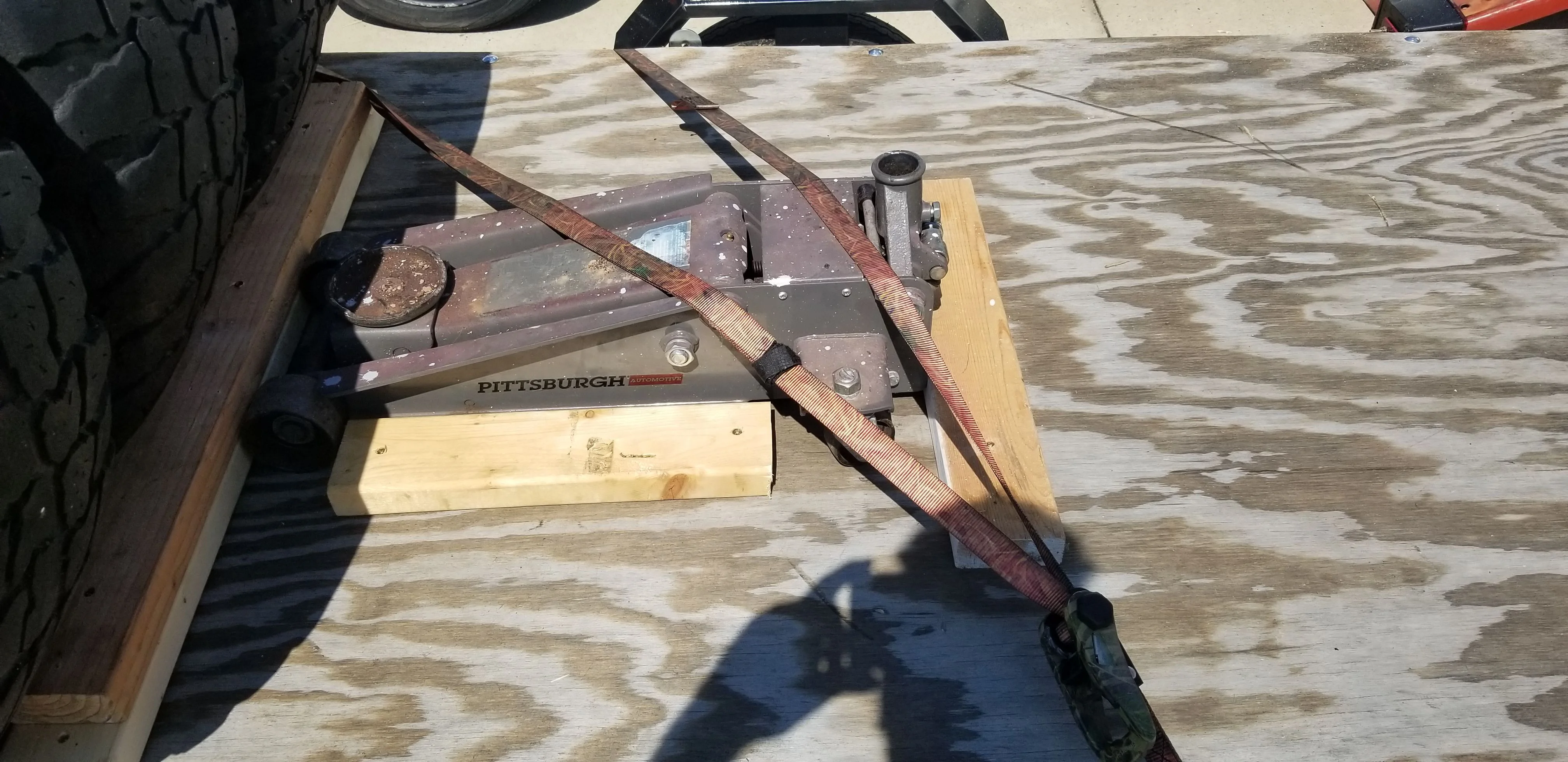

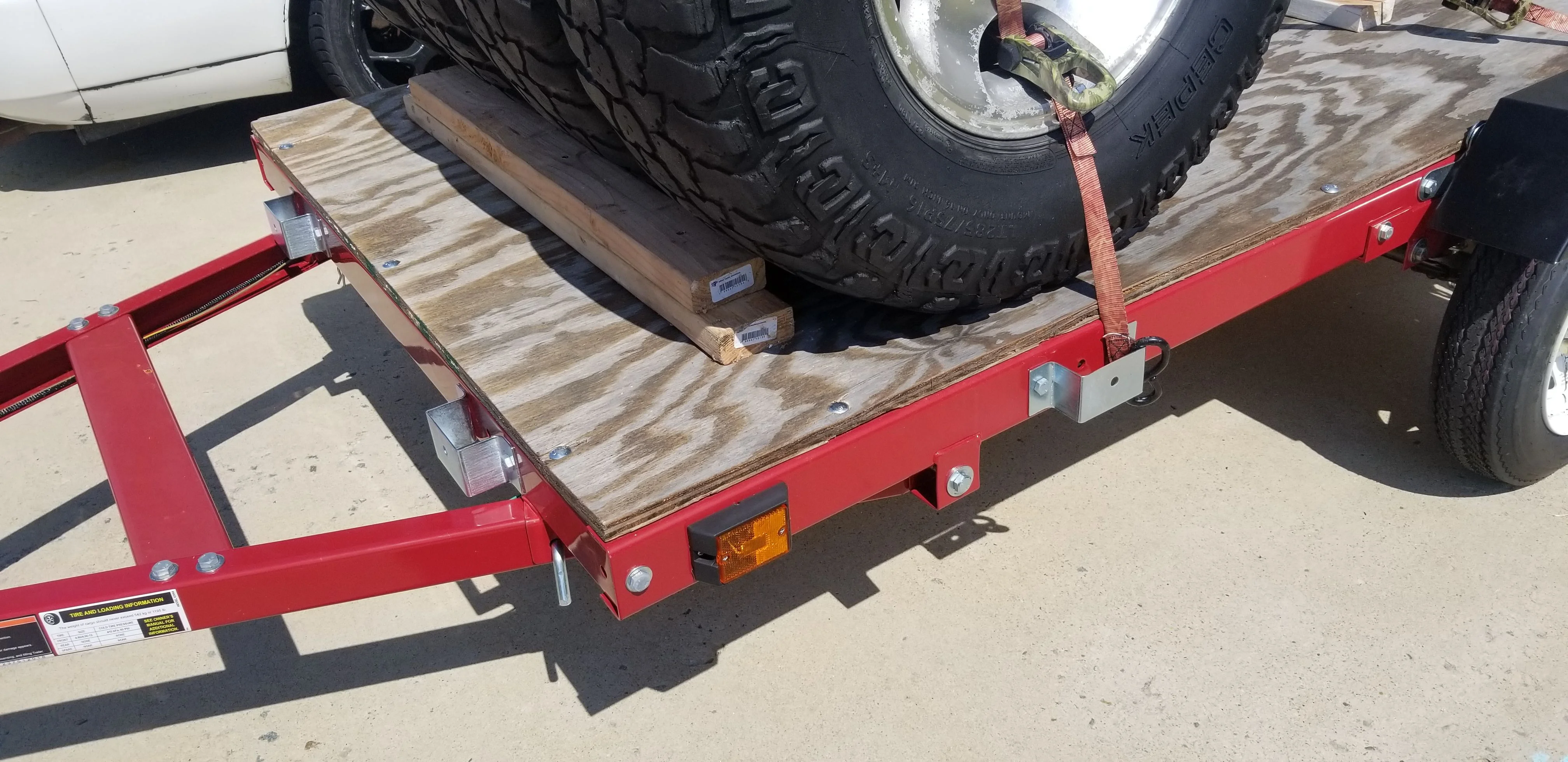

I did a little work to my trailer in prep for this weekend:
I'm still not clearanced for 35s and I don't want to run my nice new wheels on the trails, and since the old 33s are way out of balance and possibly have a shifted belt I can't drive on them, so you'll see me doing a quick pit stop session before we hit the trails. On a positive note, I won't have to air down and back up again, just have to use my electric impact.

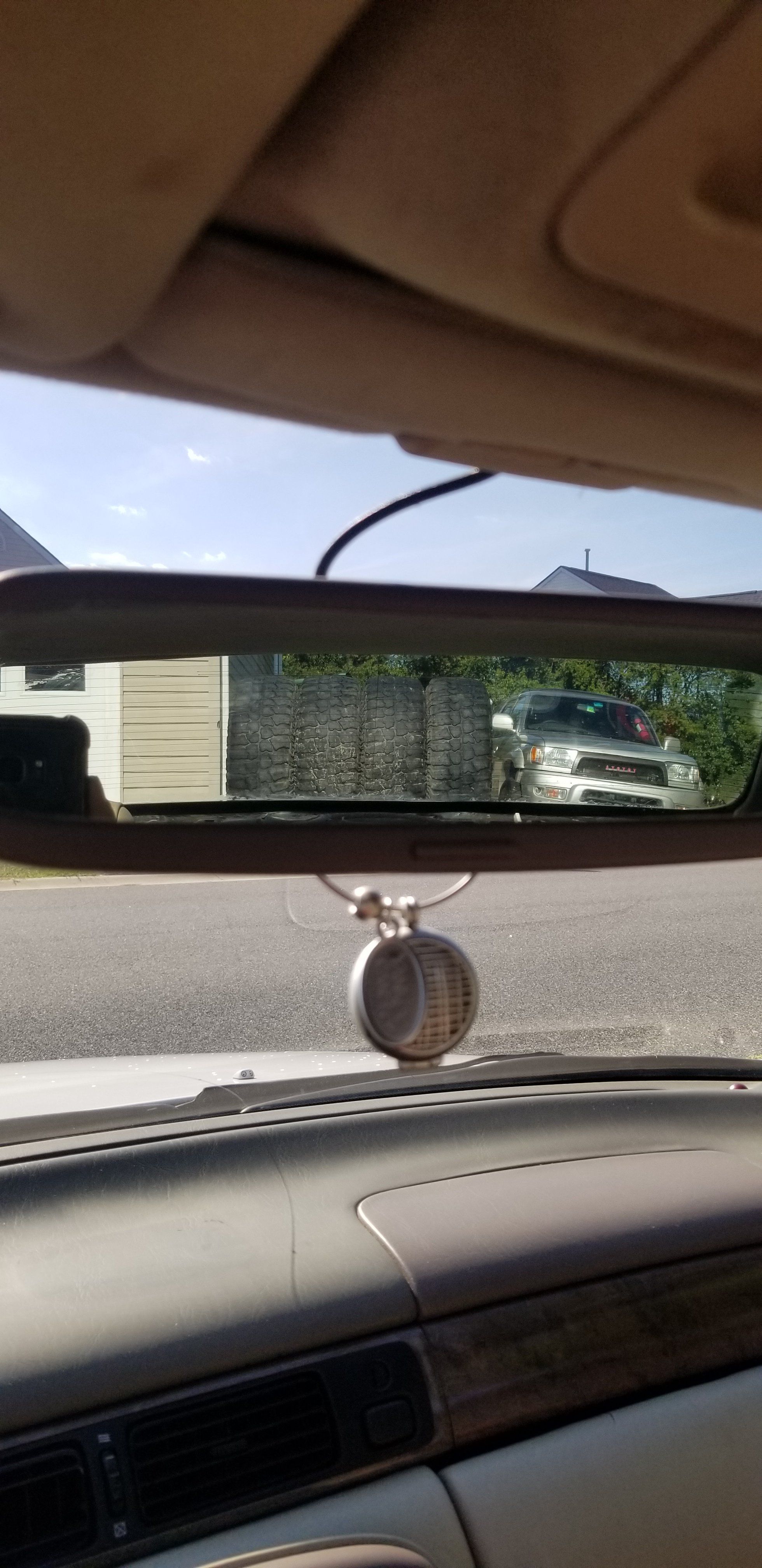

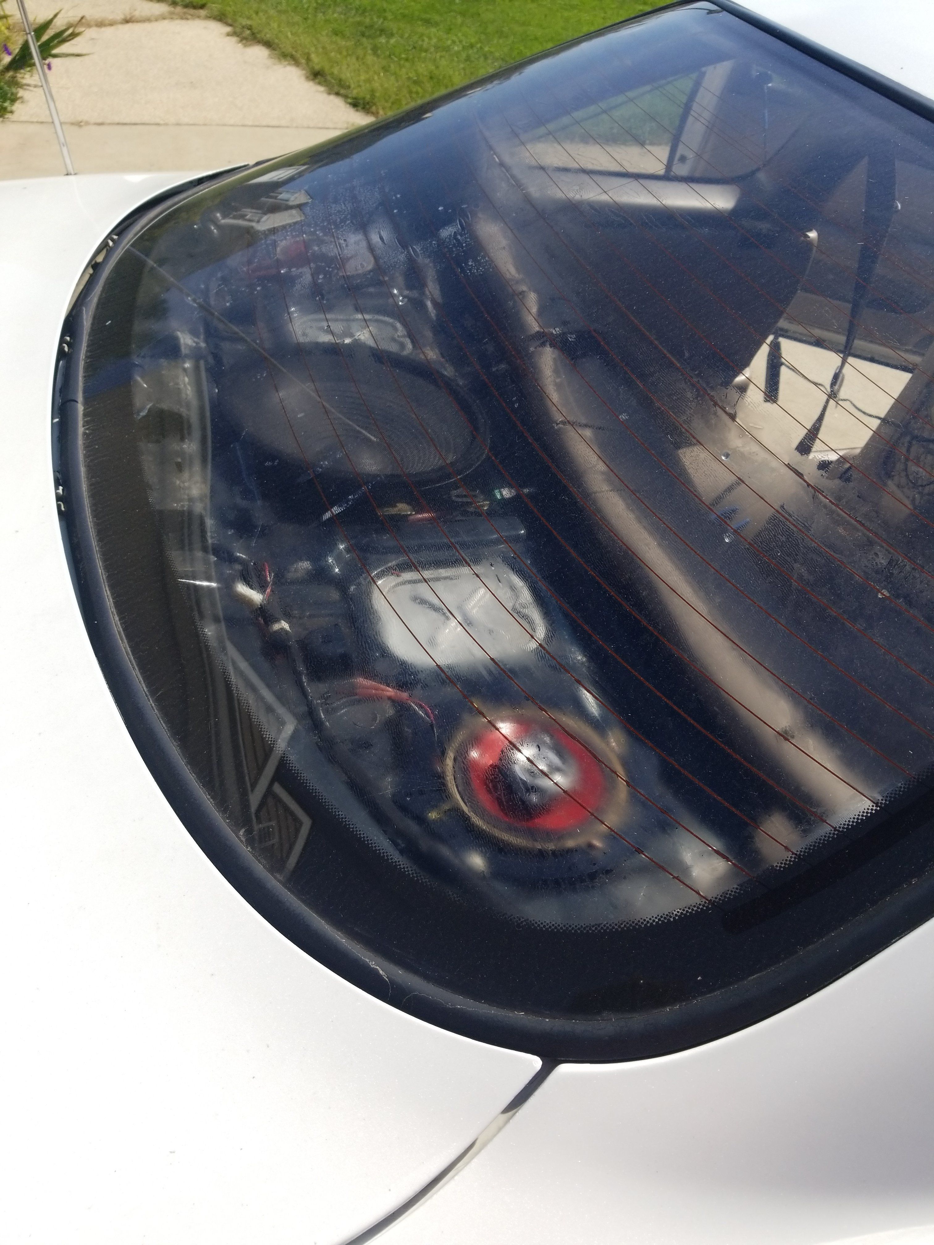

Finally one thing that's really pestered me is that I couldn't see out the back window. One of the previous owners put an awful purple-ish tint that's had bubbled and peeled. It was on all windows (except windshield) at one point, previous owner remove it from e everything but the back window and right side quarter. I got a little hand held steamer and went to town.
I'm pretty sure after removing it, its tiny from 93'. Lol it is awesome to see out the back again. It's the little things.
