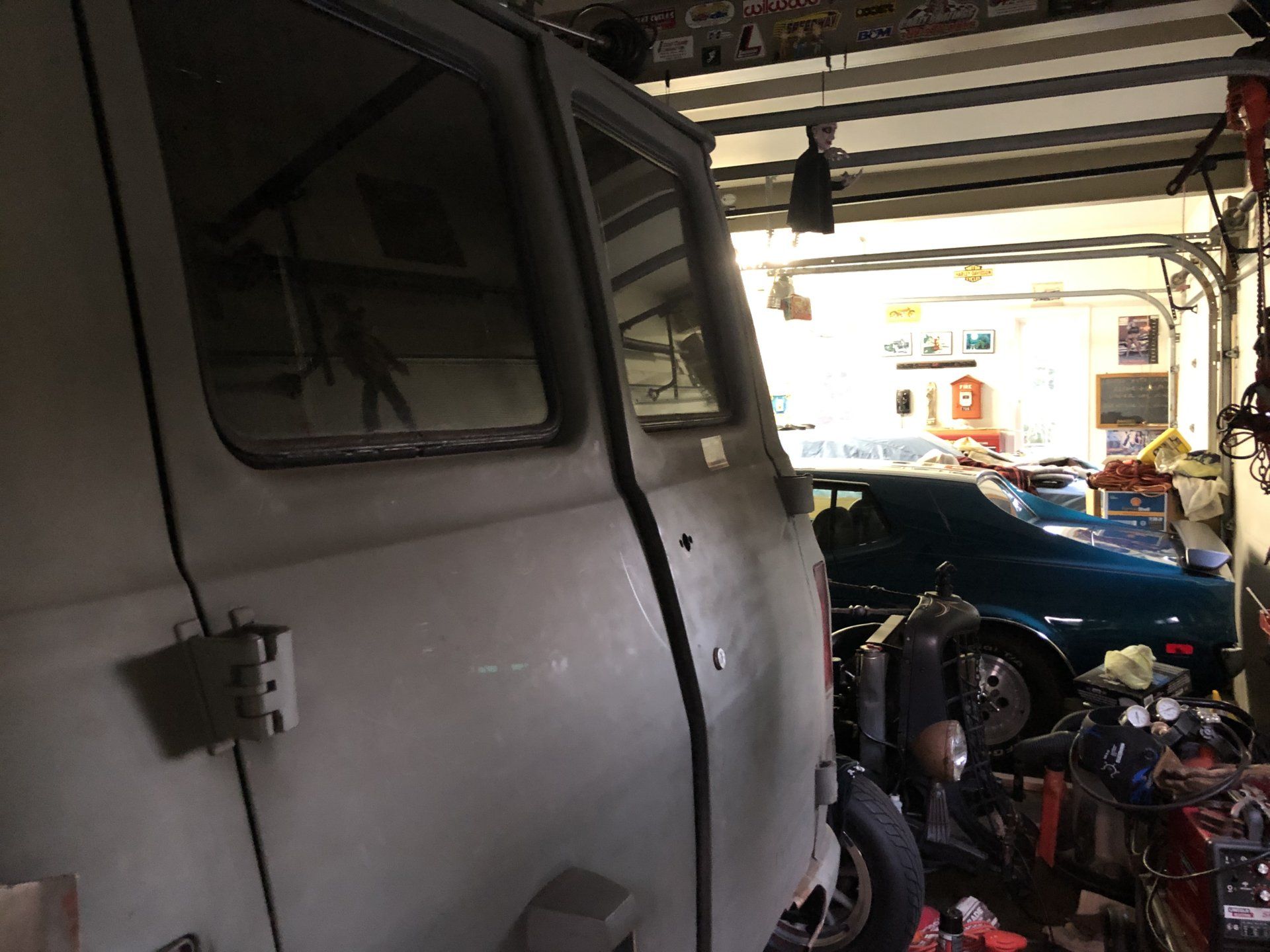

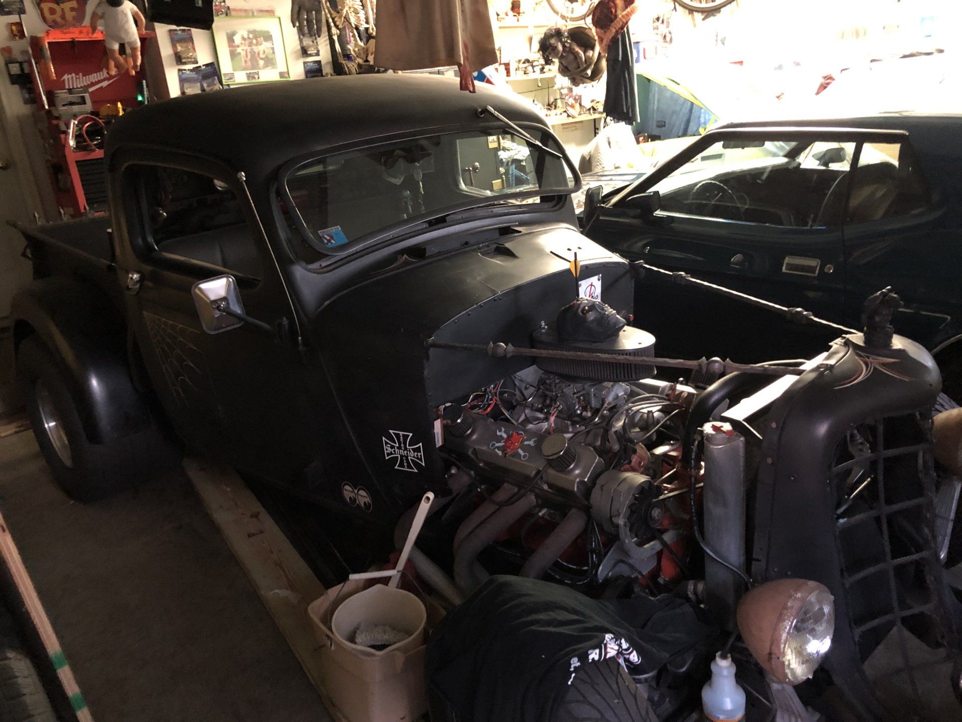

The FJ40 is always in good company at his place. We’ve been working a little on his road runner, but weirdly that blue ford van’s radiator exploded today - and vented steam right through the dog-house and onto my father in law. Got a nice burn on his back to show for it. It ruptured the seam between the tank and cores like a tin can and, since the engine and radiator sit between the two front seats, it actually pushed the doghouse up, and gassed the whole inside of the car - luckily he’d just parked it and shut it down (said it was running a little hot on the way home). I guess the heat-soak/temp spike at shutdown was the final straw. How it could build pressure to that degree without venting the cap or the overflow tank I have no idea. Happened a couple hours before I got there.
Some pictures from his stable:
Fixed the clutch spring (thanks @shmukster!)
Drove it to my father-in-laws for a family gathering.

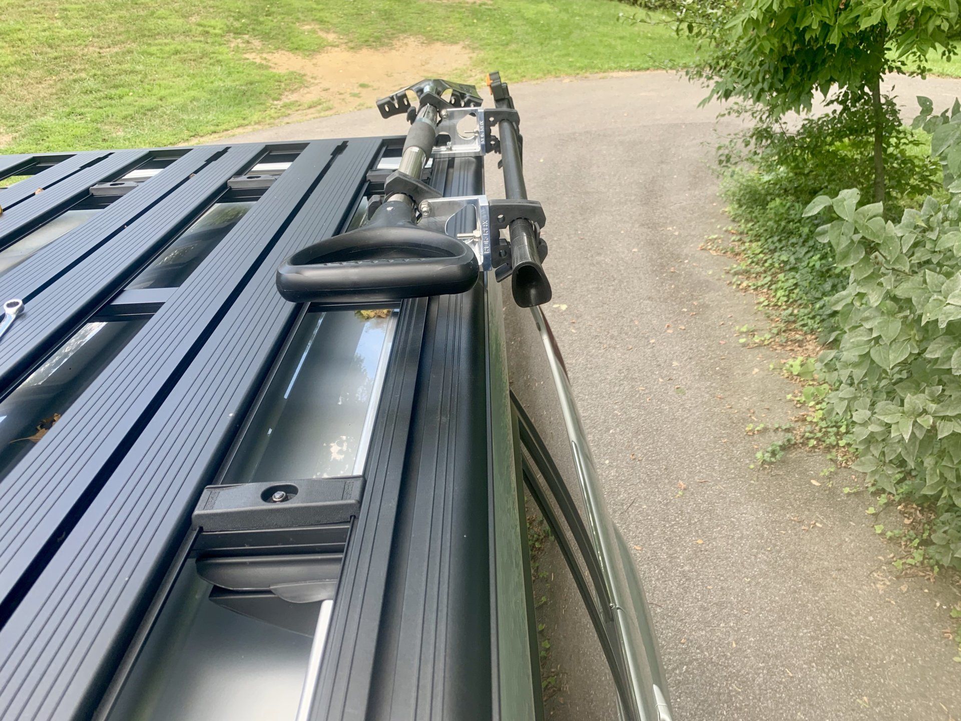

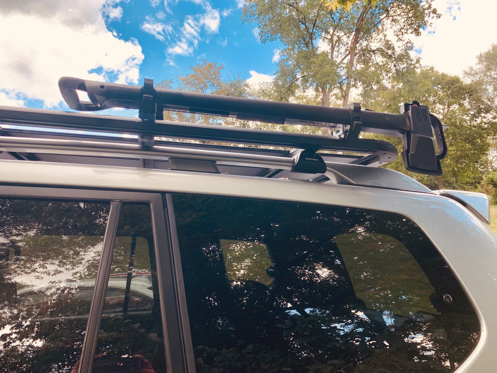

Not so much for the off-roading side of things but more for the amount of camping we’ve been doing. Rokmen was running an introductory special on these Rok-Rax which are pretty versatile. They can be used for an awning mount, block mount or tie-down/ strapping points as well. Another feature is an ax and shovel mount combo. I’ve been burying that stuff in the back on the vehicle every time we head out and it’s always a pain digging them out as they are the first tools needed. I put them on the bottom as I didn’t want them flying around and had no way to true way to secure them so this fits the bill and easy access!

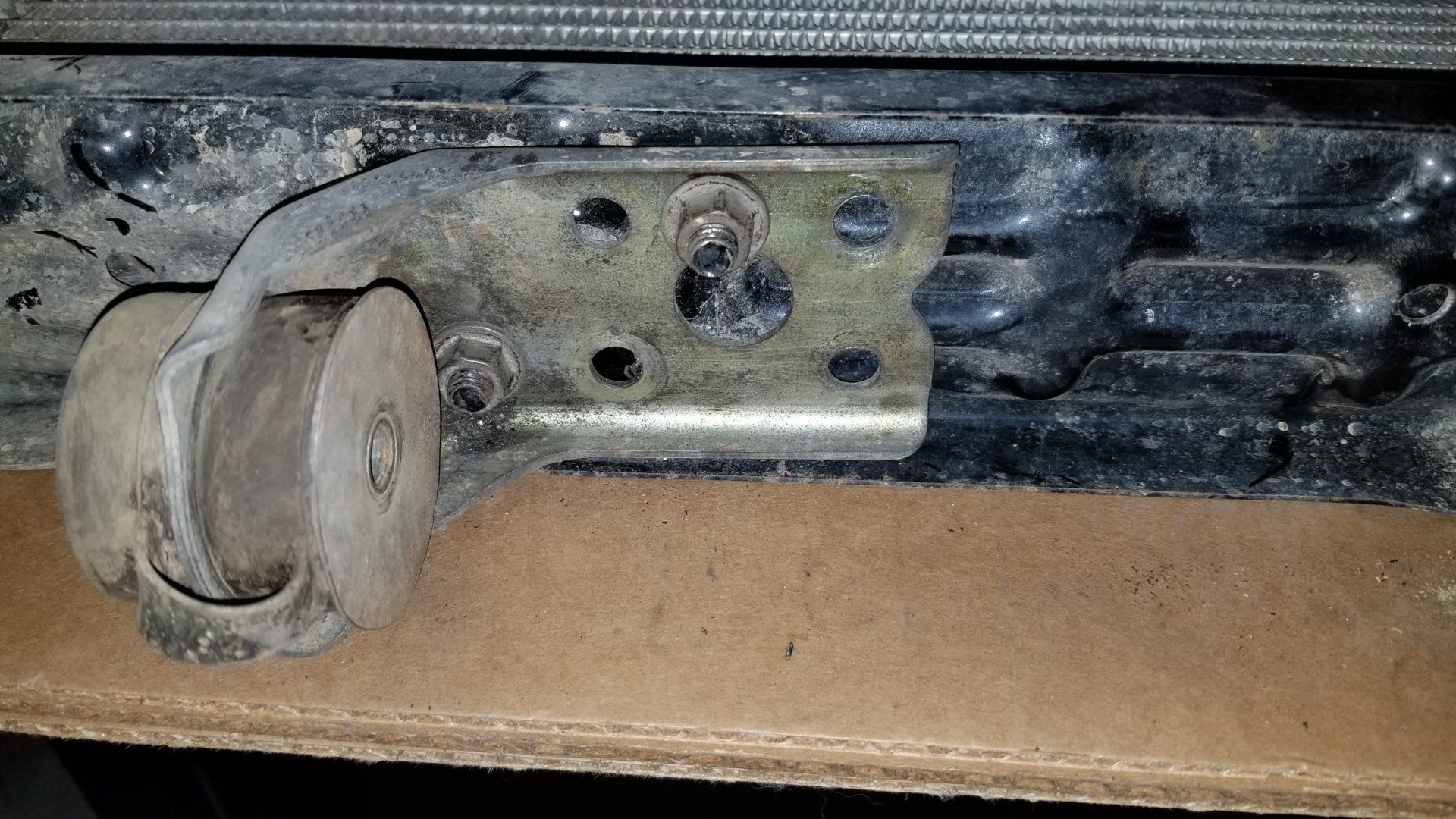

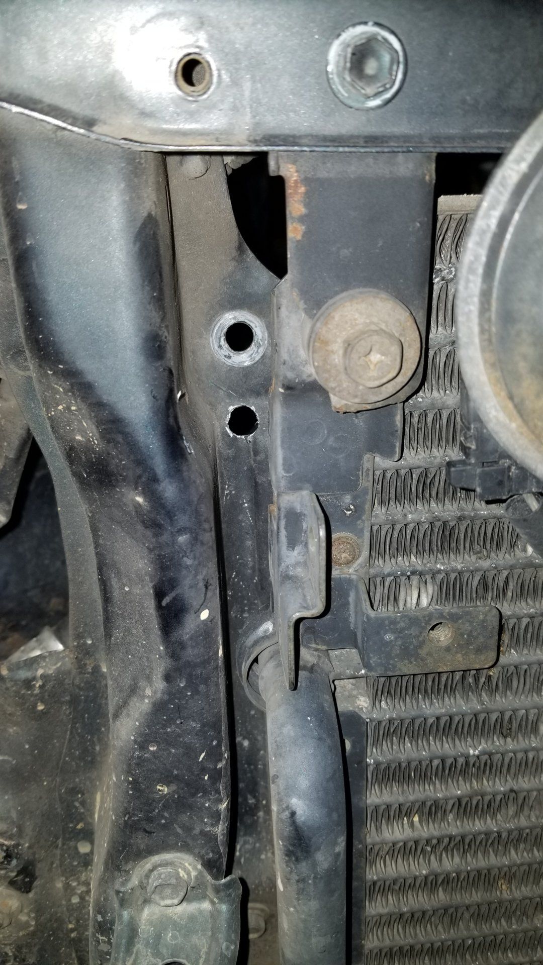

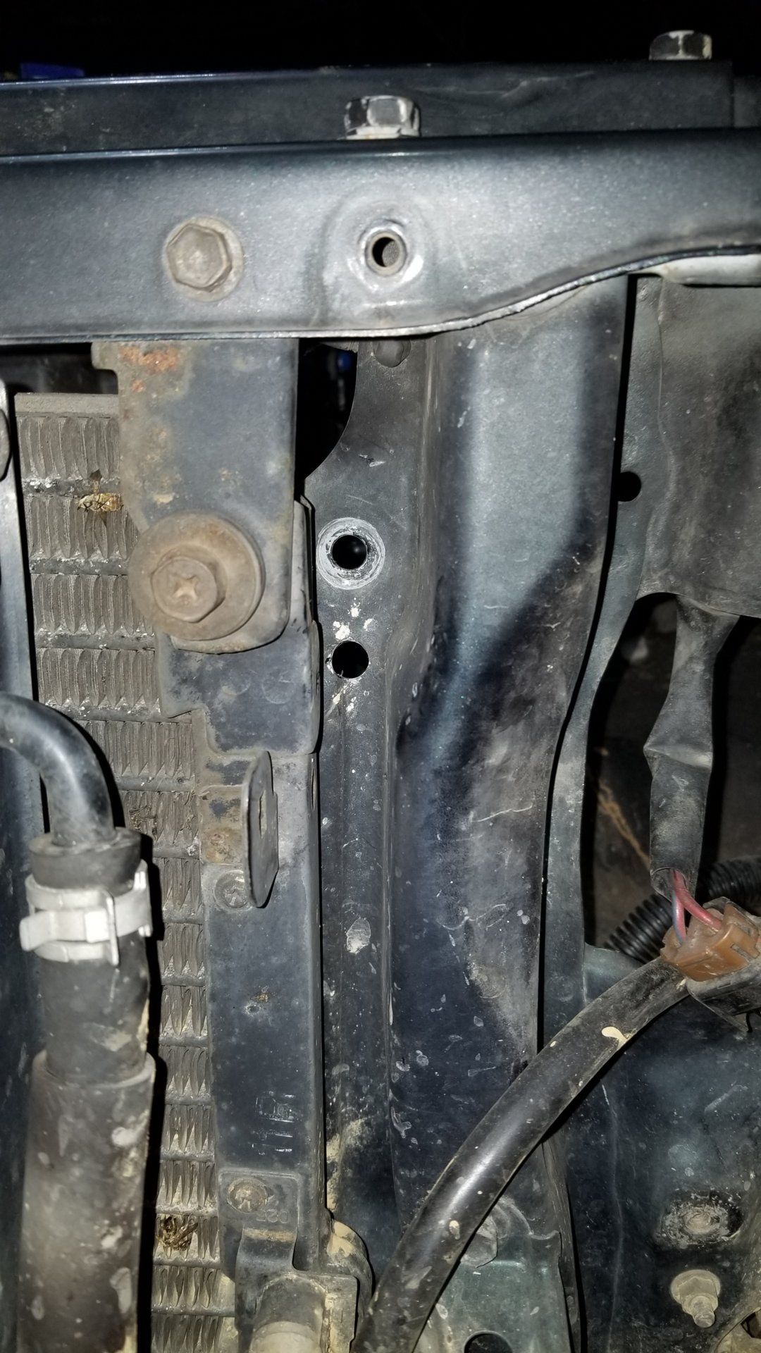

Had grandiose plans to cut and JB weld the radiator brackets to lower it 1" back to the stock height. I then remembered I have no fab skills and did the same method I have seen others do, drill lower holes in the brackets and drop it down.
Still deciding how I'm going to tackle the mounts in the front, but I drilled lower holes in the mounting piece just in case since I had the tools out.
So it was that easy?
