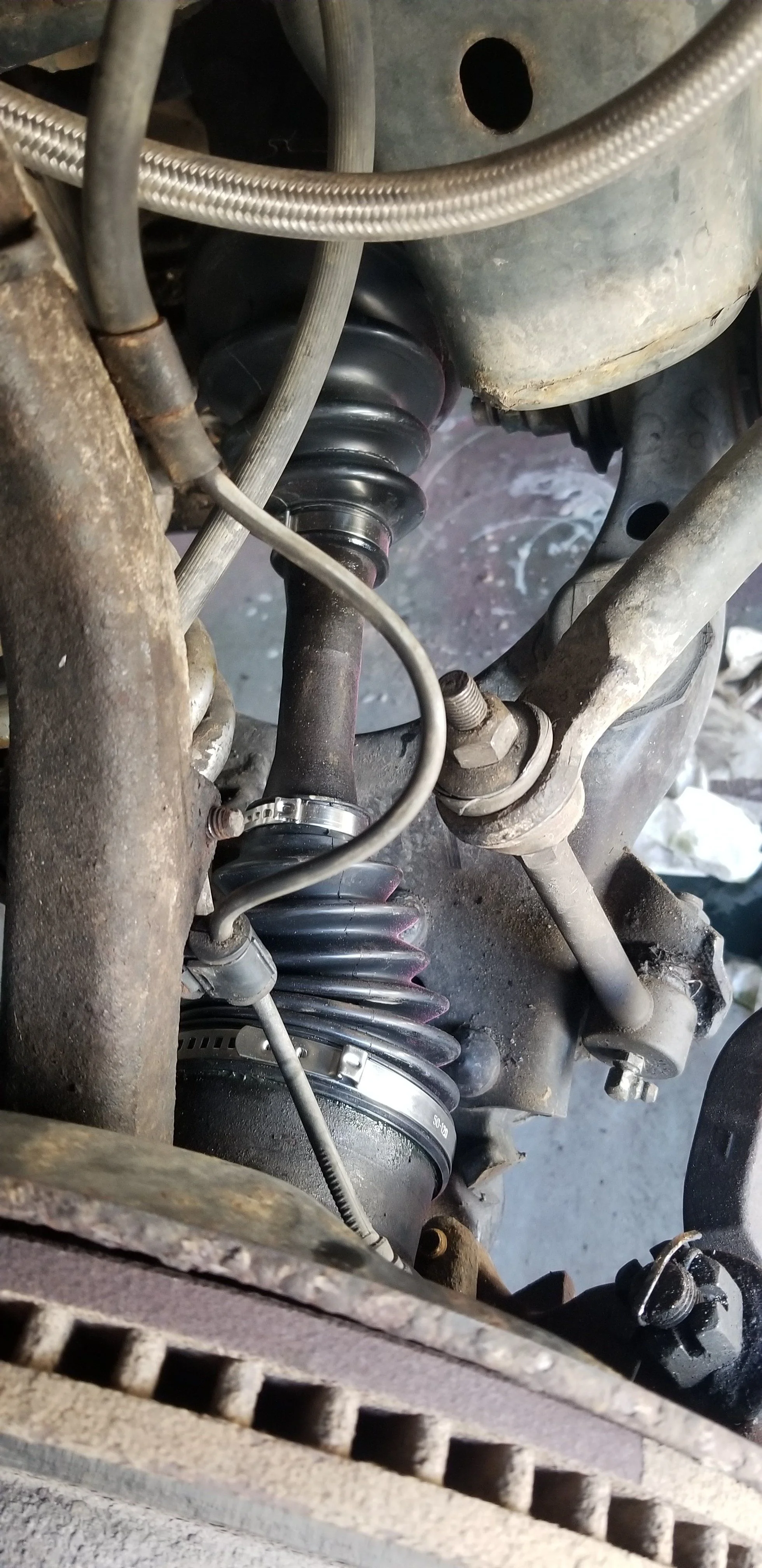

Worked on the truck a bit today. Installed the upper control arms and replaced the driver side axle since I was in there and the boot looked like it was ready to give:

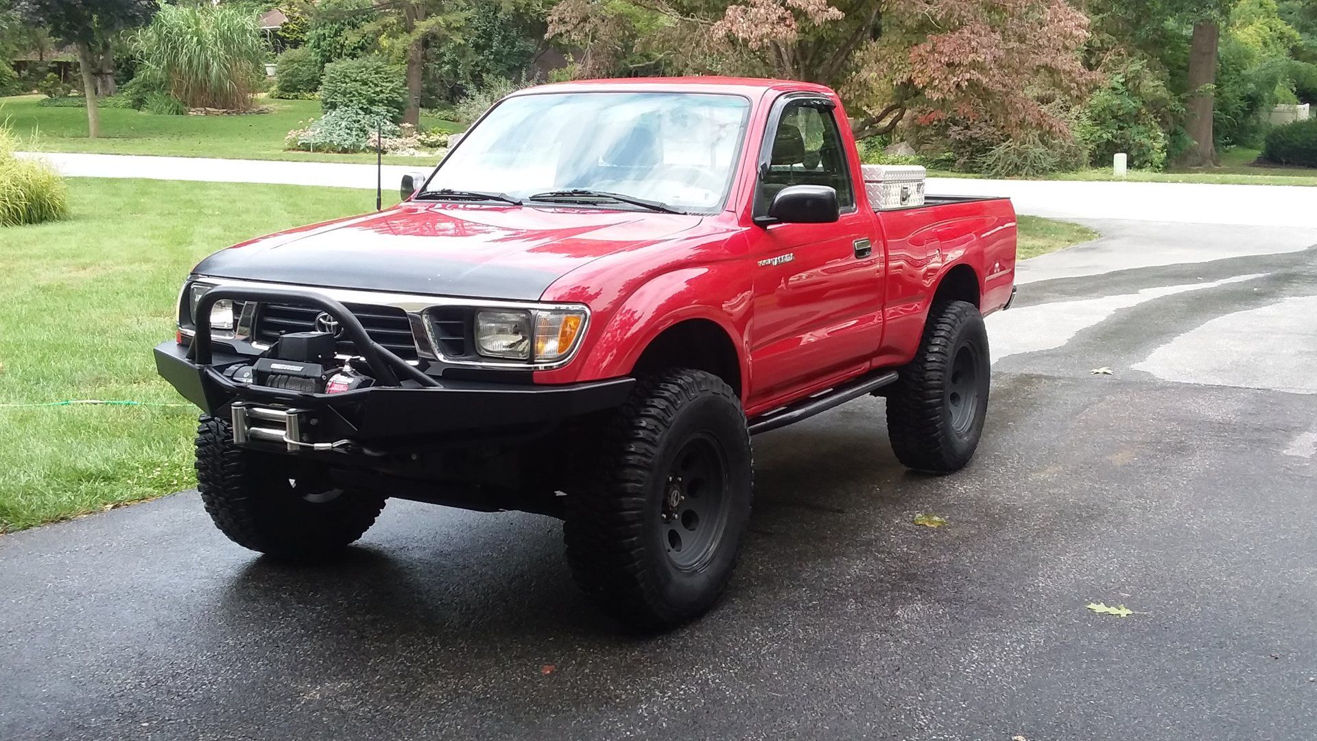

Went to help a friend spin and place a storage trailer on his property, got the winch all hooked up and ... click click click ... no spool in or out under power. Free spooled out super easy. I suppose I will jumper the winch to the terminals to see if it's the motor or the solenoid after looking it up on the internet, but disappointed such a name brand piece failed after only a year. Plus, removing the bumper and winch are probably 2 of the worst tasks to do on my truck. It took 2 guys and an 8lb maul to get the bumper on. :bang:
Only real win for the weekend was getting the pass door stopper piece installed so the door no longer flies wide open.
Check your power connections. Had one do this once and the ground wire was off - hidden down behind the battery.
If you don't already have a ground wire, start there.
@caz ... I just installed the new battery the other day. I will double check the connections and I think I saw a video about how to hotwire the motor to the battery to test if it is the solenoid or the motor. The Warn repair facility for the east coast (Hoak's 4WD Center) is a mile from my house, but if you aren't driving a Jeep they look at you like you have 3 heads.
@caz ... but if you aren't driving a Jeep they look at you like you have 3 heads.
