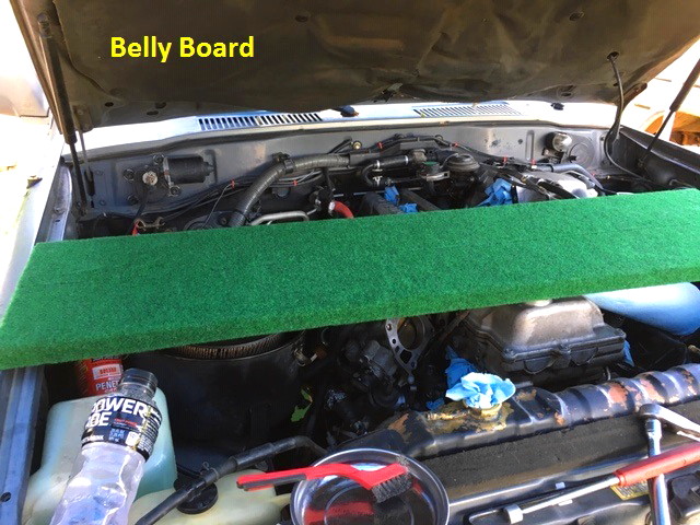

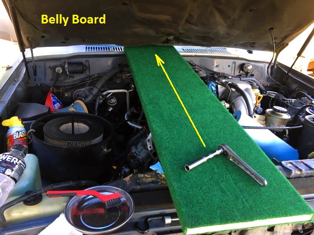

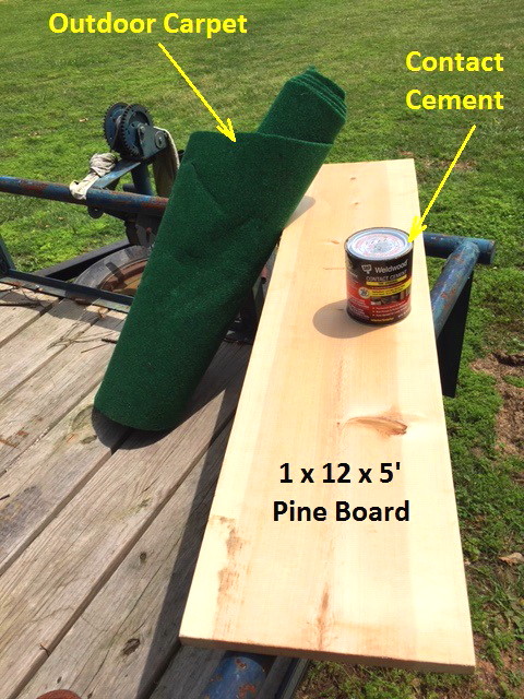

Step Stool and 'Belly Board' worked fine for me when replacing my Head Gasket.
Easy to move/orient, cost little to make, no storage considerations afterward.

the topside creeper idea looks great, as it gives a place to support your weight. it is on the pricier side, and then where to store it.

at 6'2" with a 2" lift and 285's i still find it a challenge to work around the heater valve without it. it helped me with the power steering pump job too. the only problem this introduces is where to support my weight when standing on it. i discovered this the hard way when my forearm snapped the plastic nipple off the "gas valve" on the intake manifold. i need to rig up something like @80t0ylc and @flintknapper describe. a safe place to lean AND store tools.
I have done it like this some years ago. Good idea with the carpet covering.
