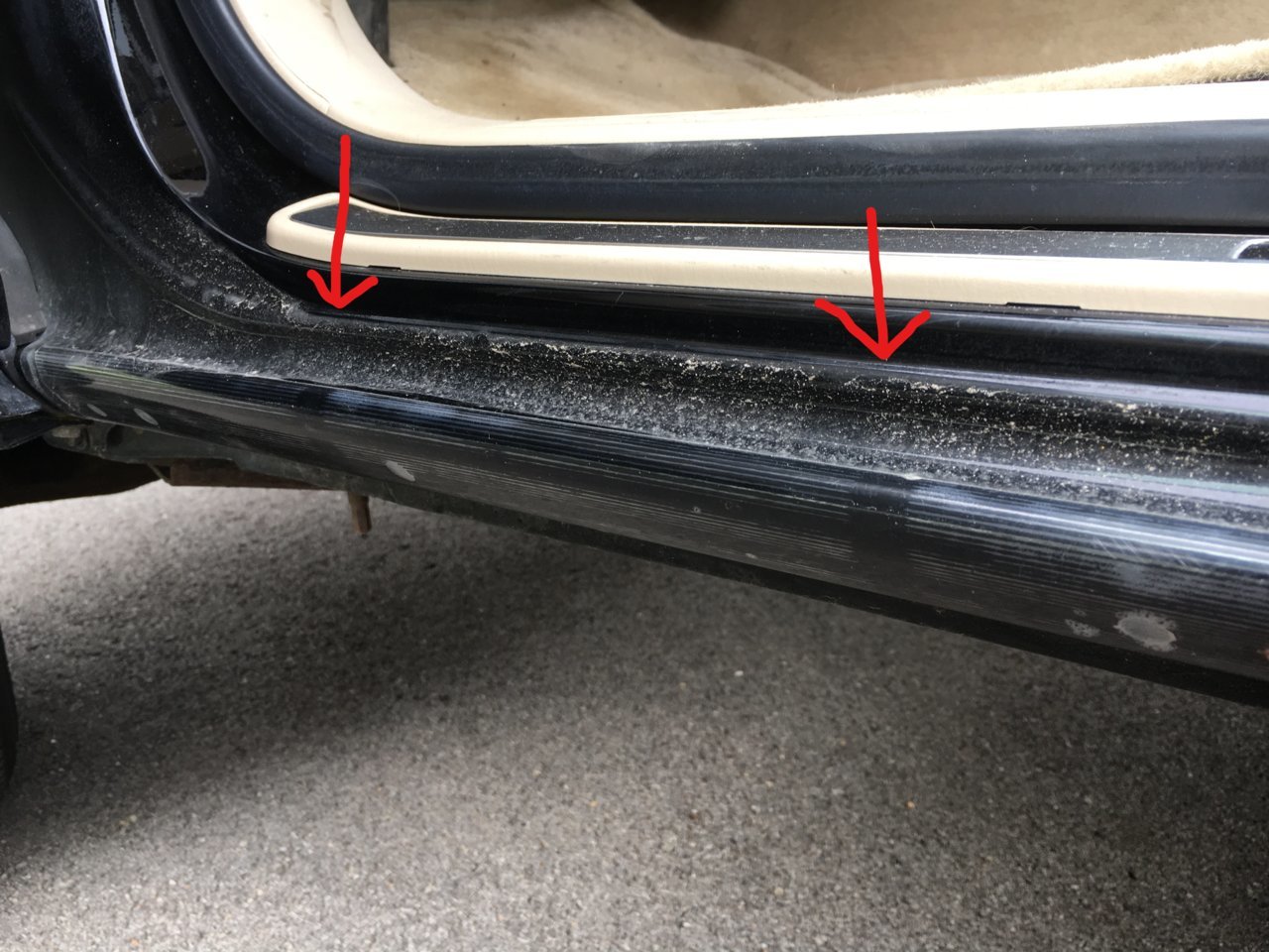

Here's a good shot of the tape covering the holes. I wiped the dirt off the tape so you could see it better. I left the dirt on the paint above so you can see where the weatherstripping creates the seal. Notice the clean paint next to the splashed up dirt/dust (red arrows). In the winter, that was white from road salt salt.
full

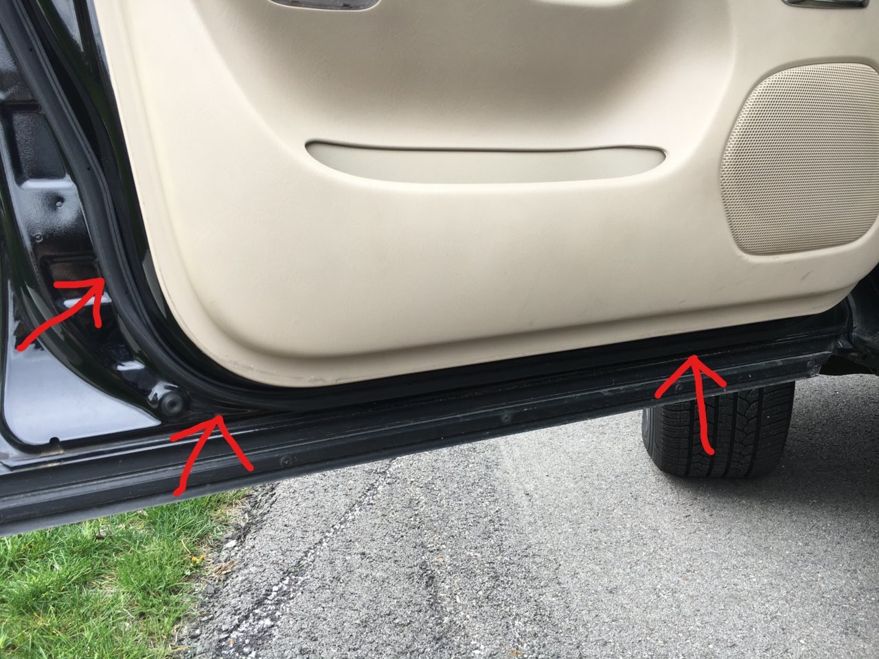

Here is a shot of the weatherstripping on the door (red arrows). Also, notice the plastic trim on the bottom that can be removed with a screw driver. That is the piece that would sit flush against the running boards.
full

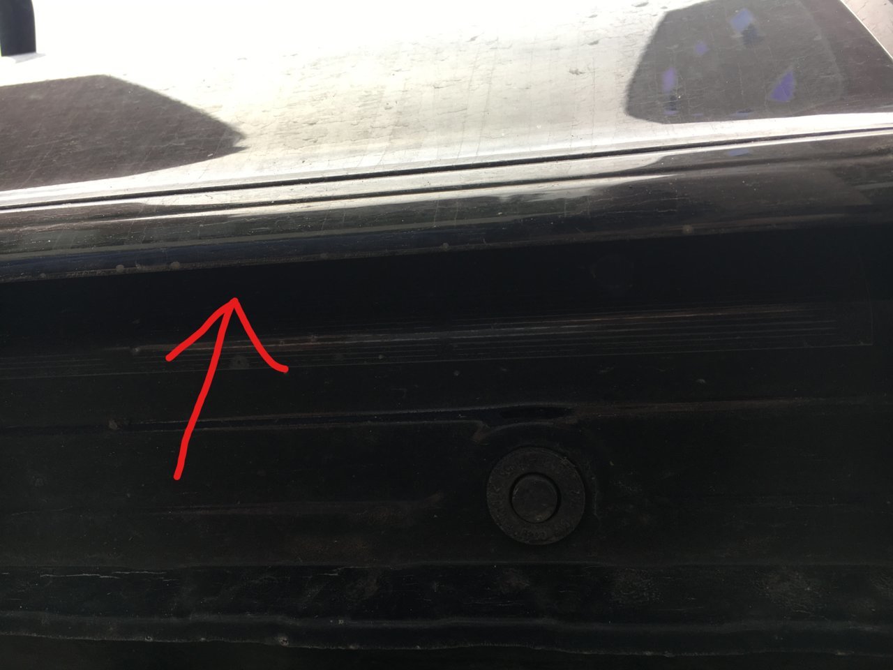

Not a great picture, but here you can see the gap that is now between that bottom trim piece and the rocker, where you can see my tape job. It's a pretty good gap, but like I said before, if you were to fill it with a chopped of portion of the running boards, water would still get behind the cut running board trim, and it would be harder to dry off.
full

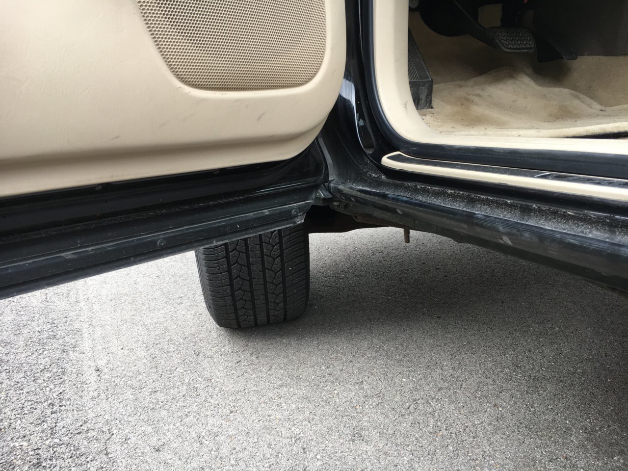

Shot from farther away.
full
