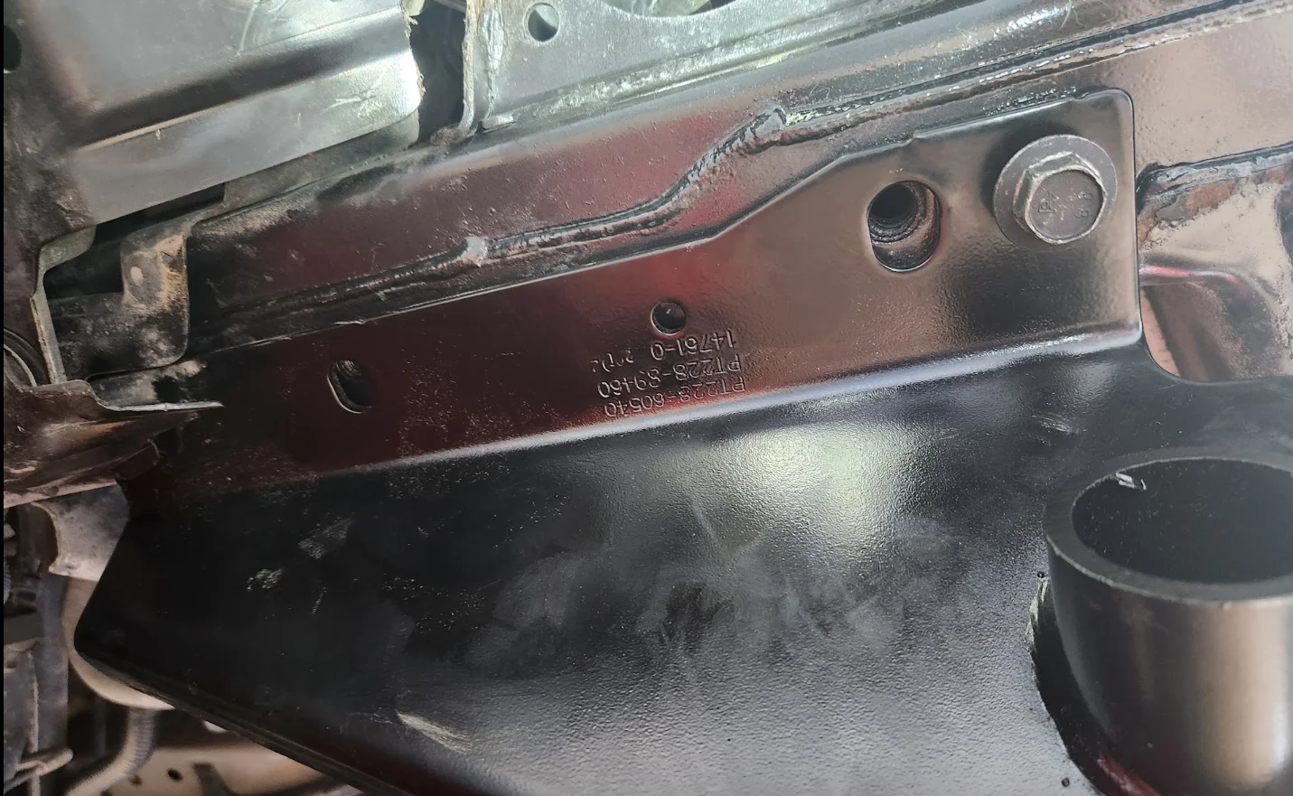

Having issues getting this receiver hitch installed. After researching more I learned there are two different style receivers as well as center mount support. I think what's going on is that I've got the newer style receiver but the older style center mount installed on vehicle
Part ordered - PT22860540
> I believe this is for the 04+ GX470 and will not fit my vehicle unless I adapt the different style center bracket (08925-35870)
Part needed for 03-early04
> PT22860440

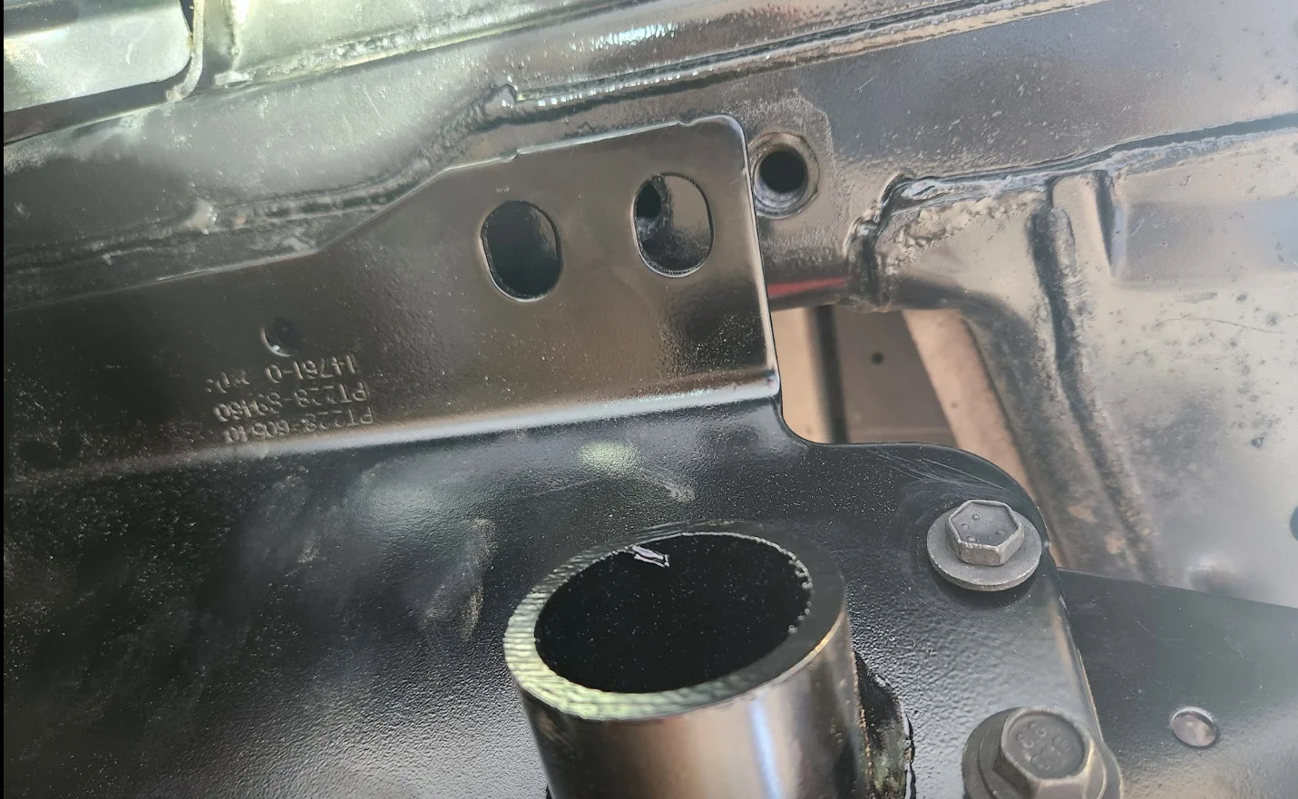

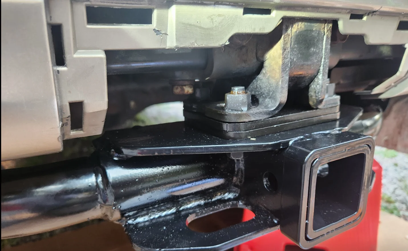

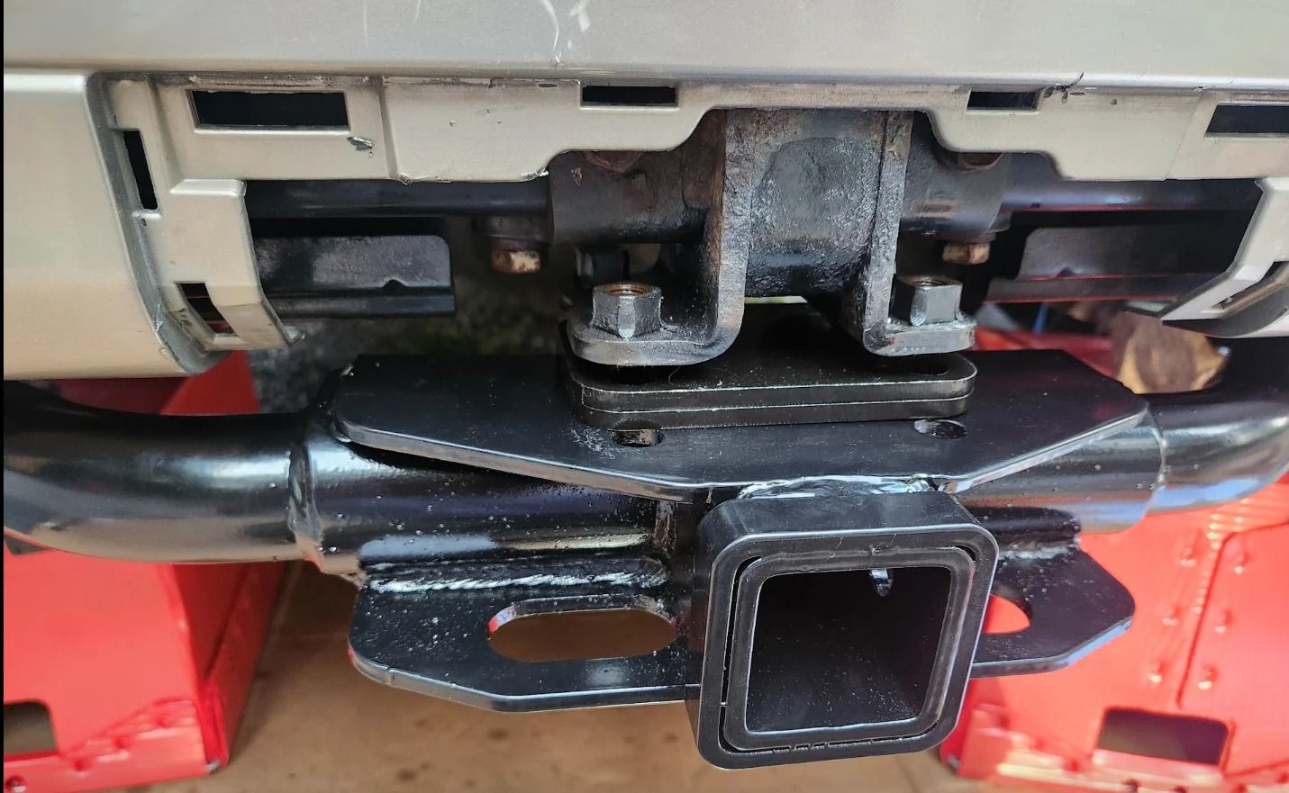

  • I secured the four center bolts, hand tight
  • When I do this, the side holes are off by like 1-2+ inches
  • For troubleshooting, I installed the side bolts to see where that puts me at center, and you can see how far off it is...
Here is the first attempt with the center bolts installed , but then you can see how far off the sides are
I removed the center bolts and secure tow side bolts for troubleshooting, and you can see how far off the center is. I'm starting to think there must be a different center mount plate ?
Hmmm so they either sent me the wrong hitch or I need to order a new center bracket. I don't think I should have to swap the center bracket, this is the proper one for this vehicle so I think they need to send me a different hitch.

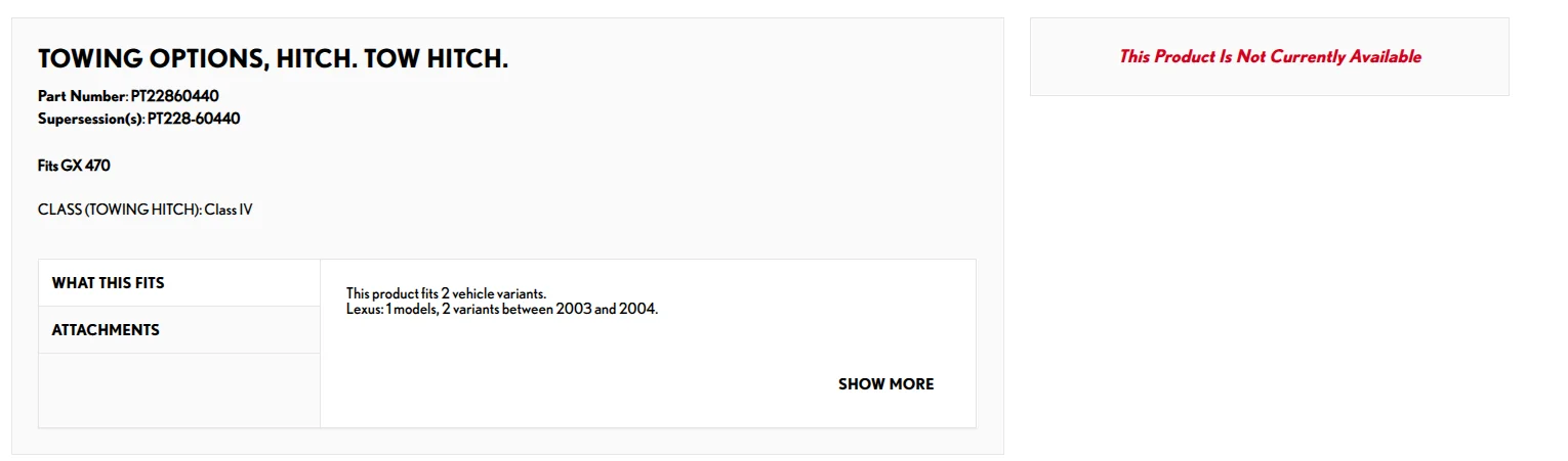

Quote below mentions the older style require hitch part number PT228-60440 but its looking like this isn't available anymore so I need to try and find the different center plate where the holes sit further back

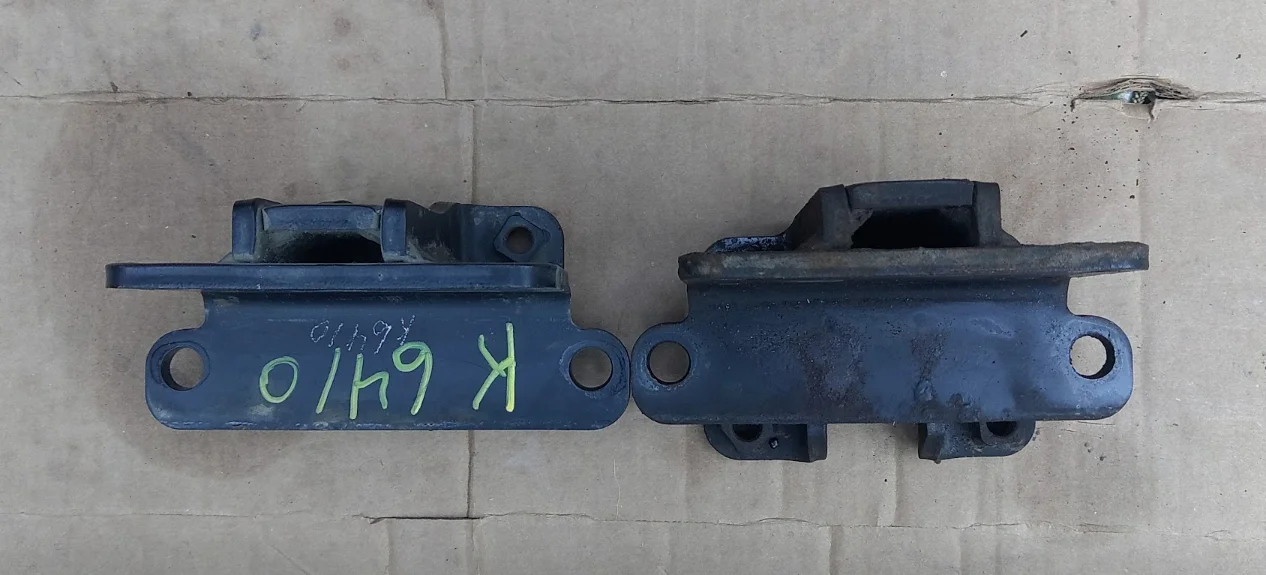

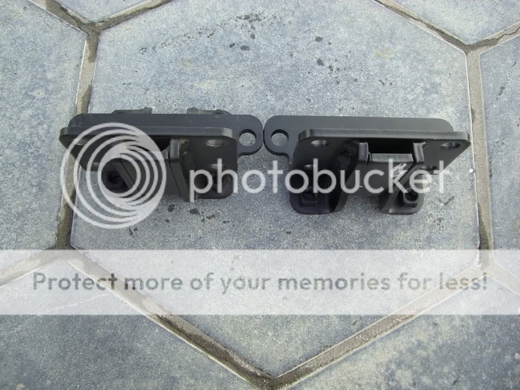

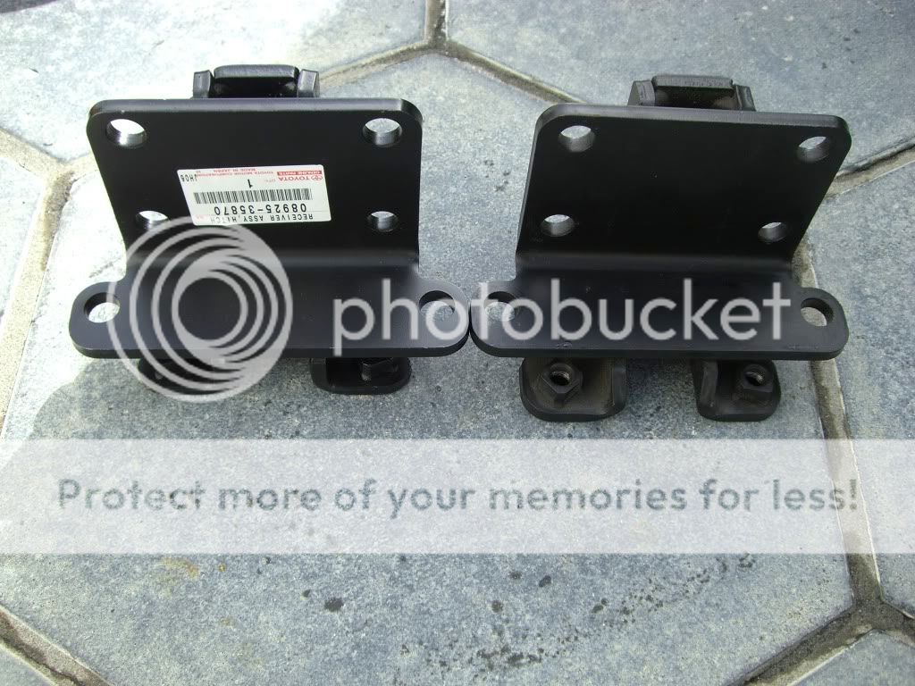

Now make sure you have the correct center support as there are two. The hitch (PT22860540) I ordered called for the 08925-35870 center support. Here are the two different ones side by side. I originally got the wrong one. I do not know the part number of the first one I got but I understand it is for the 20003 and early 04 GXs and the hitch part number PT228-60440.
As you can see the new one on the right shows the mounting holes located more to the rear of the vehicle.
The new one is now on the left showing the part number.
It looks like that older receiver is no longer available..same goes for the newer style center bracket that would fit this receiver I have (08925-35870)

It seems like the bracket must have changed between the 03-04 model runs and the 05-09 model runs. So in theory if you get a 05+ bracket, it should work. But, my GX is an 07 and I have not personally examined the back of a 03-04 GX to verify. The bolt holes certainly look the same though.
You may also be able to call a big out-of-state junkyard that has a 05+ GX or two and have them pull and ship this part. It's probably not very expensive and it would not be hard for them to remove one. I had actually gotten one for my GX (not realizing it was already on the rig) when I upgraded the hitch. I later eBay'd it (this was in 2021). Or, as you suggested, see if someone has one laying around.
Sweet, hopefully I can source one. I just did some searching on car-part and managed to find a handful of options. fingers crossed. thanks for the assist.
There is a difference. I put a hitch from a 2005 on my 2003. Had to use the 2005 bracket.

Great success. Junkyard center hitch mount was what I needed. Can't believe how close they are, maybe 1" different in the lower mounting holes
Pics below for reference. Thanks to all who chimed in with help, another big win for MUD and how helpful it is....

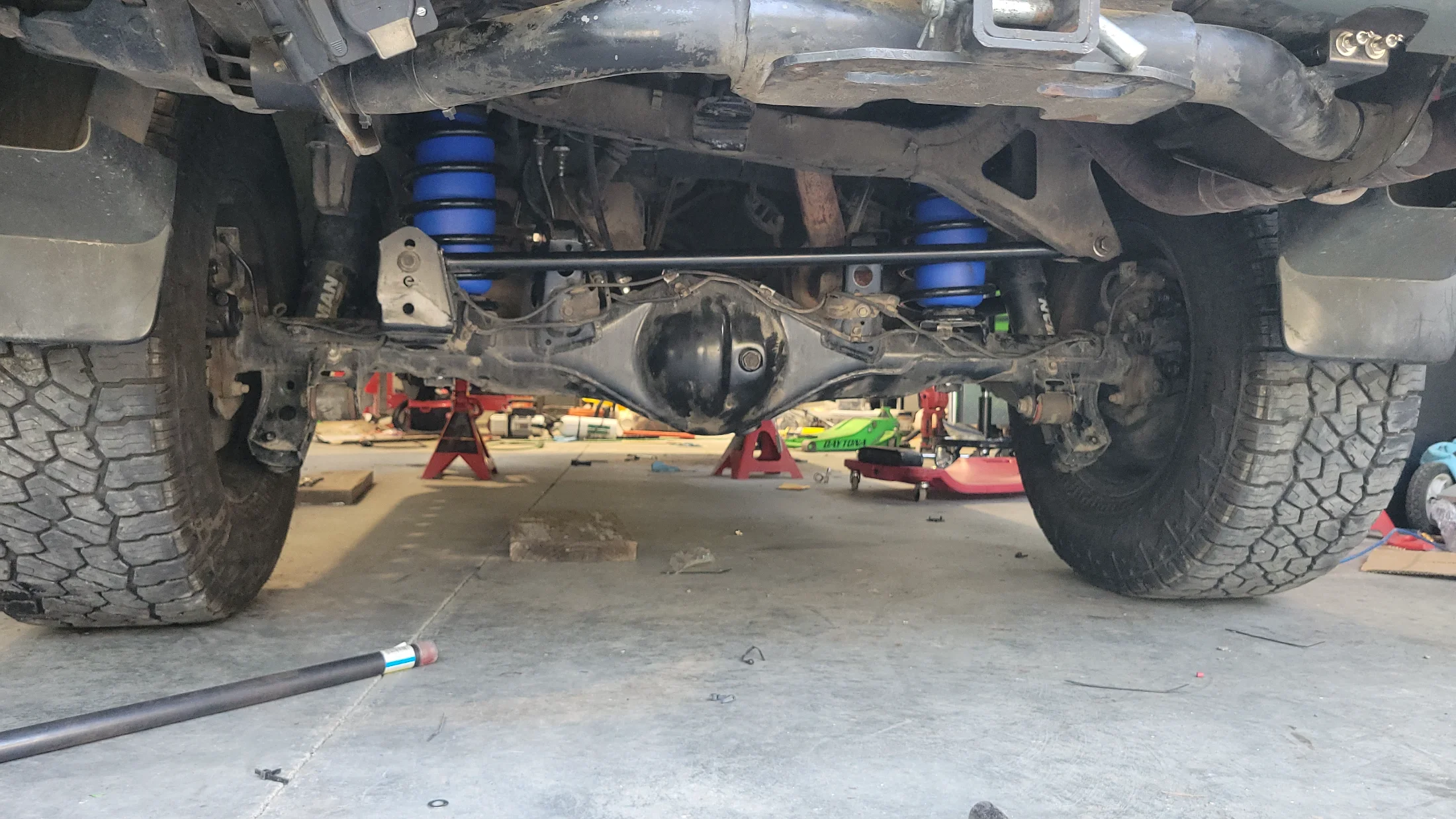

Alright I got a test drive in today with the 470 hooked up to the camper. The trailer is about 2500 lbs and 16 ft long.
Observations so far
  • The air ride system is really awesome and it did instantly adapt to the extra weight. As I lowered the weight onto the hitch the back end dropped about 2 inches then the compressor kicked on and leveled me back out. Its also nice being able to set it to low to help with removing the trailer and driving off.
  • That being said my paranoia levels have increased. I just can't see myself taking this thing on a long distance trip without fear of this system failing. Is that stupid ? I was all ready to pull it 3k miles on my next road trip but this morning decided we should just take my ol' reliable 100 series instead
  • Otherwise, it still rides really smooth and barely feels the weight back there. I suspect once I install the brake controller it will feel even better
  • I need to get a straight shank receiver, currently with a 2" drop the trailer is angled a bit downward
I'm hoping to take it on a few local shake down test to see if the compressor is running excessively or if any issues pop up.
So what does the MUD world think....Does the air system really fail that often? If yes is it bags that leak or do sensors fail? Maybe the compressor gets too hot and s***s out?
