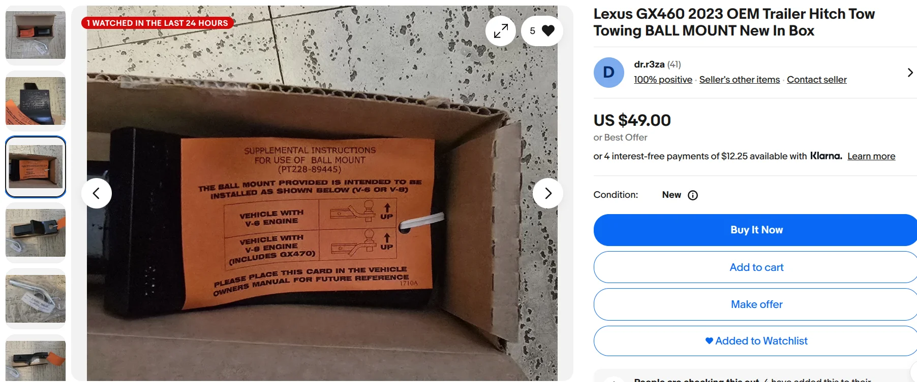

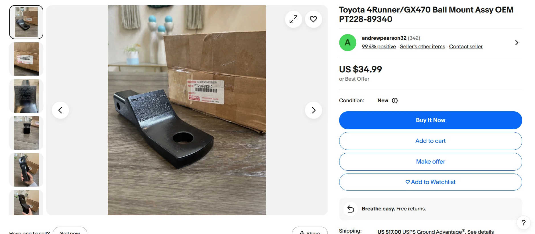

Anyone working with the OEM ball mount? Looks a bit stubby but cheaper than aftermarket.
I'm seeing a few part numbers floating around.... based on my year I see PT228-89340 but I think the newer style receiver I installed for 05+ calls for PT228-89445.. Can't imagine how they can be any different but who knows, maybe the hitch pin is in a different spot for the older style receivers
Image below shows GX470 on tag, think I might go for the 89445 option
2003-2004 used a short receiver so it didn’t hit the spare tire. 2003/2004 only came with the small hitch that bolts on to the rear cross member. 2005 and up had the full trailer hitch (6500lb) option. That’s where the center brackets are also different. I would buy the long/full size receiver now that you have a full size trailer hitch.

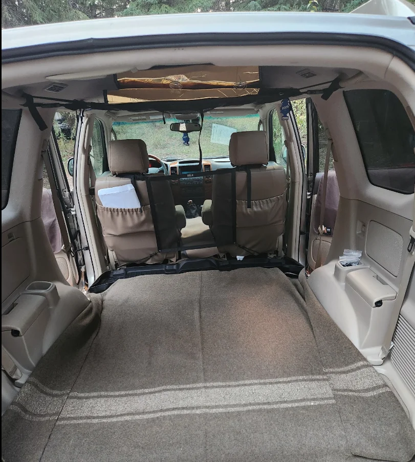

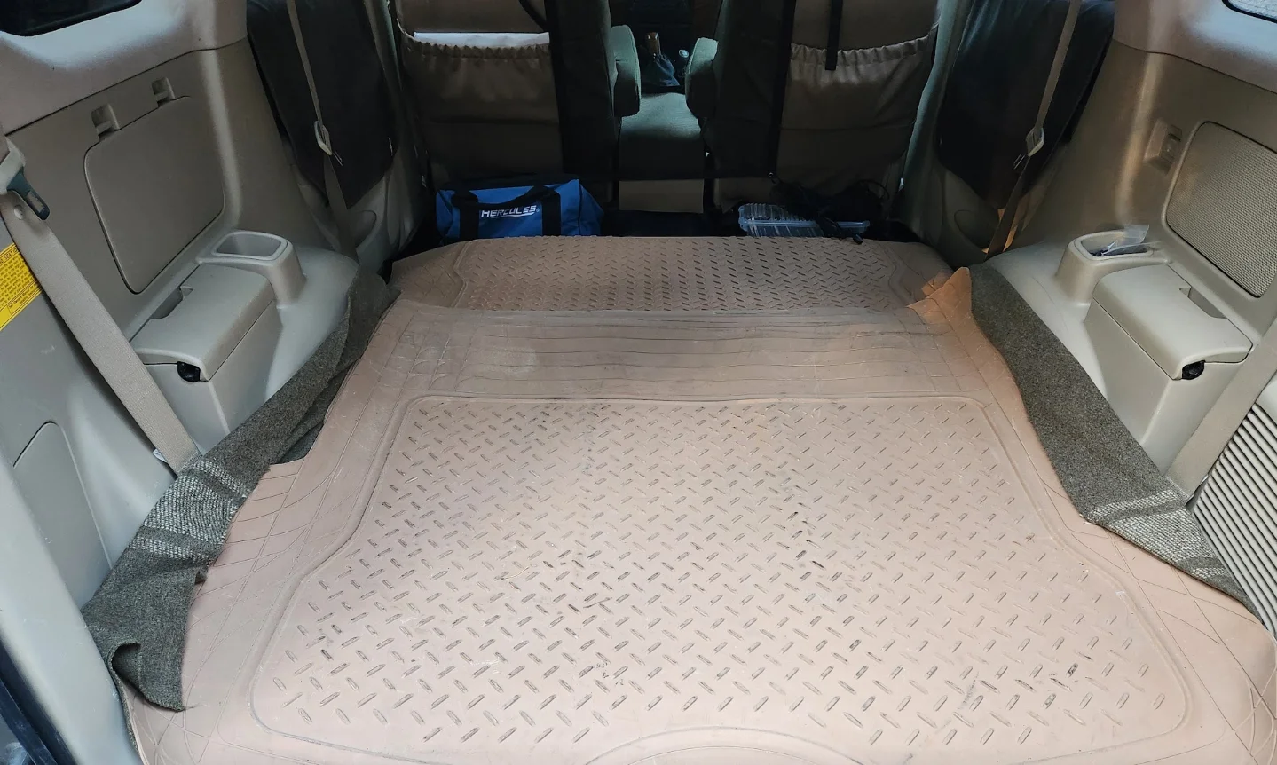

  • Removed rear seat, cleaned everything up, stuffed foam in the seat latch holes....laid down a wool blanket, then some rubber mats and a net between the front seats in an attempt to dog proof ...

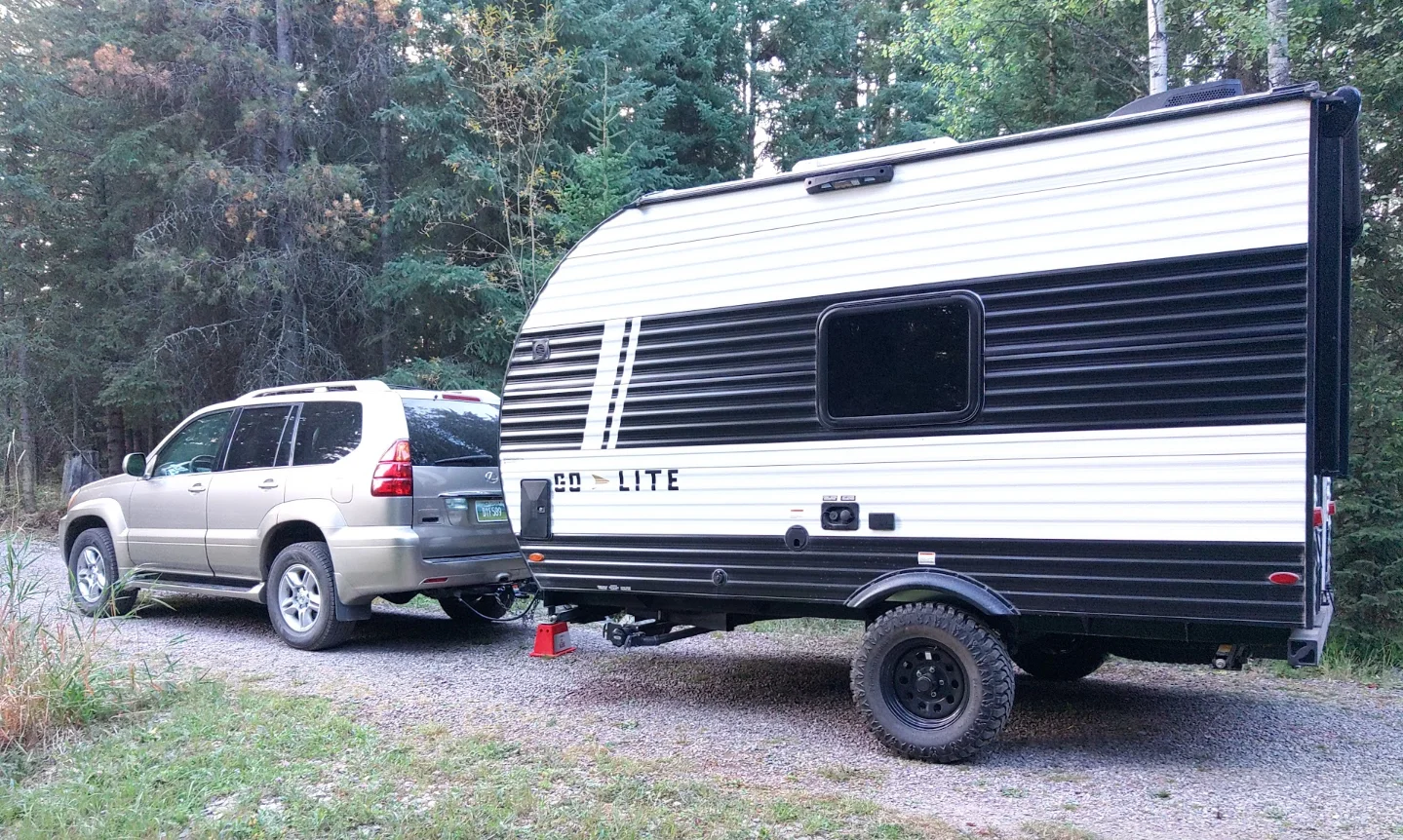

My previous ball mount had a 2" drop and the trailer sort of dipped down slightly, so I swapped to the hitch to the one posted above .....but now I sort of think it's angled up a bit?
I think the parking lot was pretty flat but I'm wondering if maybe I should go back to the 2" drop... I've got a 330 lb tongue weight so its got a bit of girth up there, so it should be OK but IDK
Flip the receiver upside down? Kinda looks like it's the wrong way up as is.
Yeah for sure, you could go either way with this ball mount......if I flip it its a 2" drop and the trailer dips down ever so slightly....Flipped up and it seems to be tipped slightly up. I need a straight shank to split the difference but I think I'll just ride this out for now and see how it feels

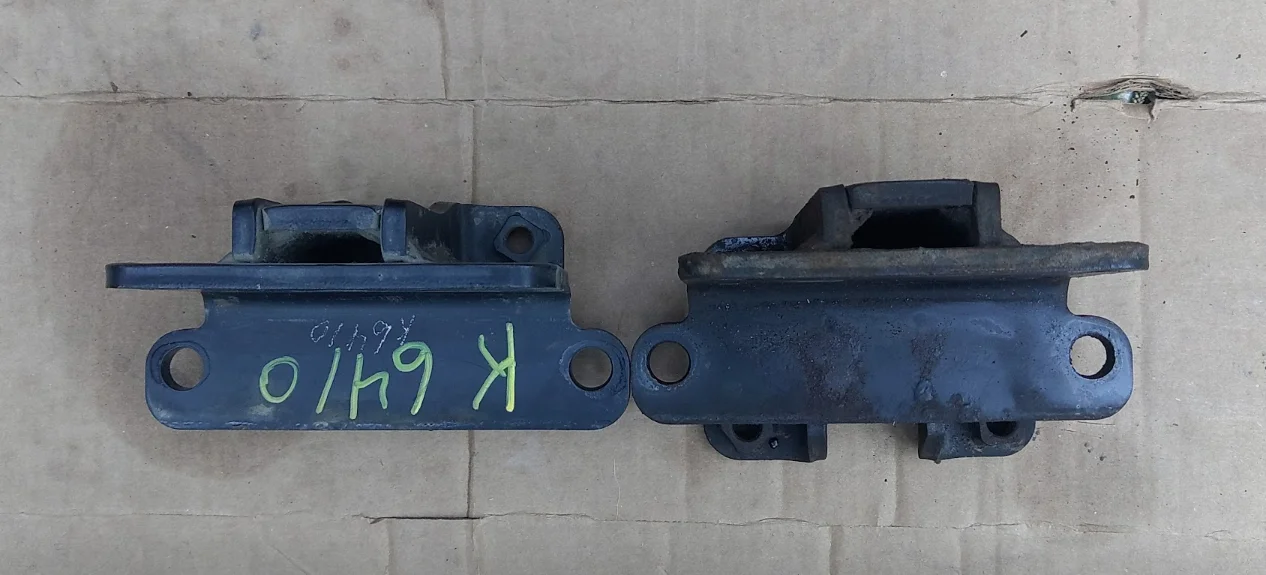

Great success. Junkyard center hitch mount was what I needed. Can't believe how close they are, maybe 1" different in the lower mounting holes
Pics below for reference. Thanks to all who chimed in with help, another big win for MUD and how helpful it is....

Question. I have a 2005 with the factory tow option and then bought a Class IV hitch off FB. My old center mount thing looks like it has the same differences as what you posted. I had removed all the hardware a while back during my project rebuild phase. When I went to reinstall, I could only find the center mount that came with the new hitch. And of course ran into the same issues you described. I've since found my OEM center mount. So what you're saying is I just need to install the original center mount for the rest of the bolts to line up?

Hey, yeah I think you are on the right track.
So you bought a hitch and a center mount, but it wasn't the correct fitment because of the wrong center mount..... But you mentioned you still have your OEM center mount?
Yeah so my understanding is that the 03 - half year 04 used a different style center mount, shown in my previous post on page 1.... That mount does not adapt to the newer / most common style receiver hitch that people buy.
Your 2005 should have the updated center mount with the lower holes in a different position
Do you have both center mounts on hand still ? Can you check them out side by side ?
- Old style on the right, you can see the lower holes would sit further towards the front of the vehicle
- New style on the left, holes positioned more towards the rear and will line up with Toyota receiver
