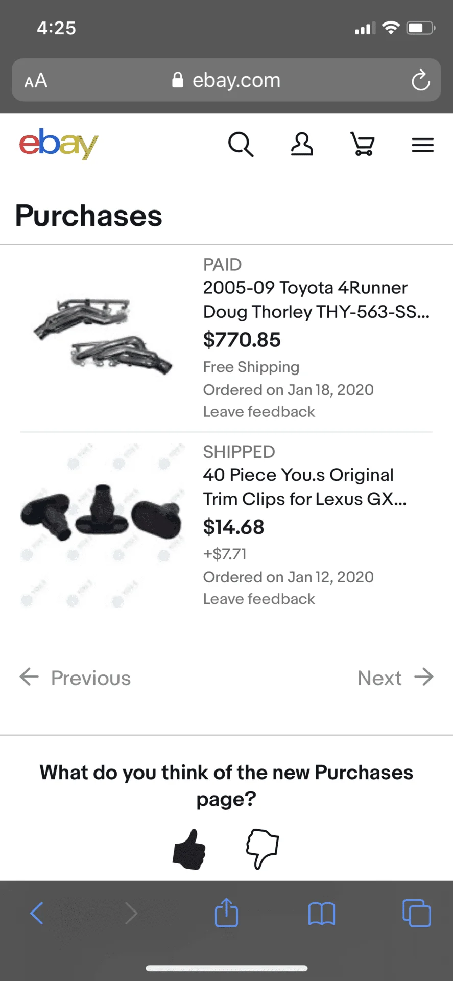

Found the OEM Lexus “like gold” skirt tabs from mail order in Germany on EBAY pkg #20 for $10! Unpainted black if silicone used on holes water resistant!

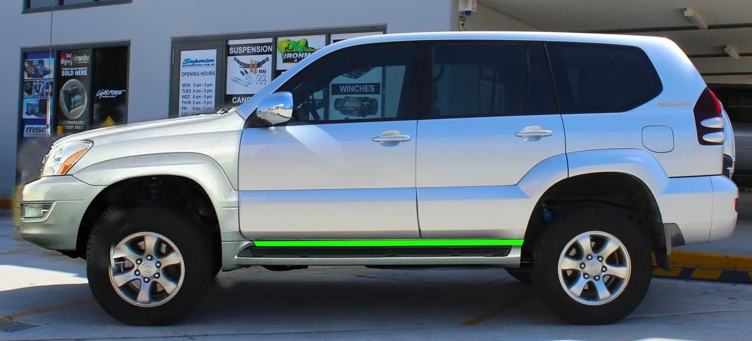

So I've been essentially converting my Prado to a GX. Already did the interior bits, and now have a GX hood, fenders, fender flares, and running boards. The door panels on the Prado are missing the line that the GX has but essentially looked the same so I didn't bother with them....but now after comparing everything I have, there is another major difference.
The GX door panels are essentially 1-2in taller than the Prado door panels. To fill in the gap on the Prado, there is an additional piece on top of the running boards which I highlighted in green. (not my prado, just an image I found for reference)
It's a bit hard to see but I can try and retain the piece in combination with the GX running boards....
...or fork over more $$$$ for the GX door panels and ditch the additional prado trim (just when I thought I had everything!!) Leaning to keeping the Prado piece in but I need to actually see how it all attaches to make sure it's as possible as it seems.
.....it isn't going to work so GX door panels are ordered.
