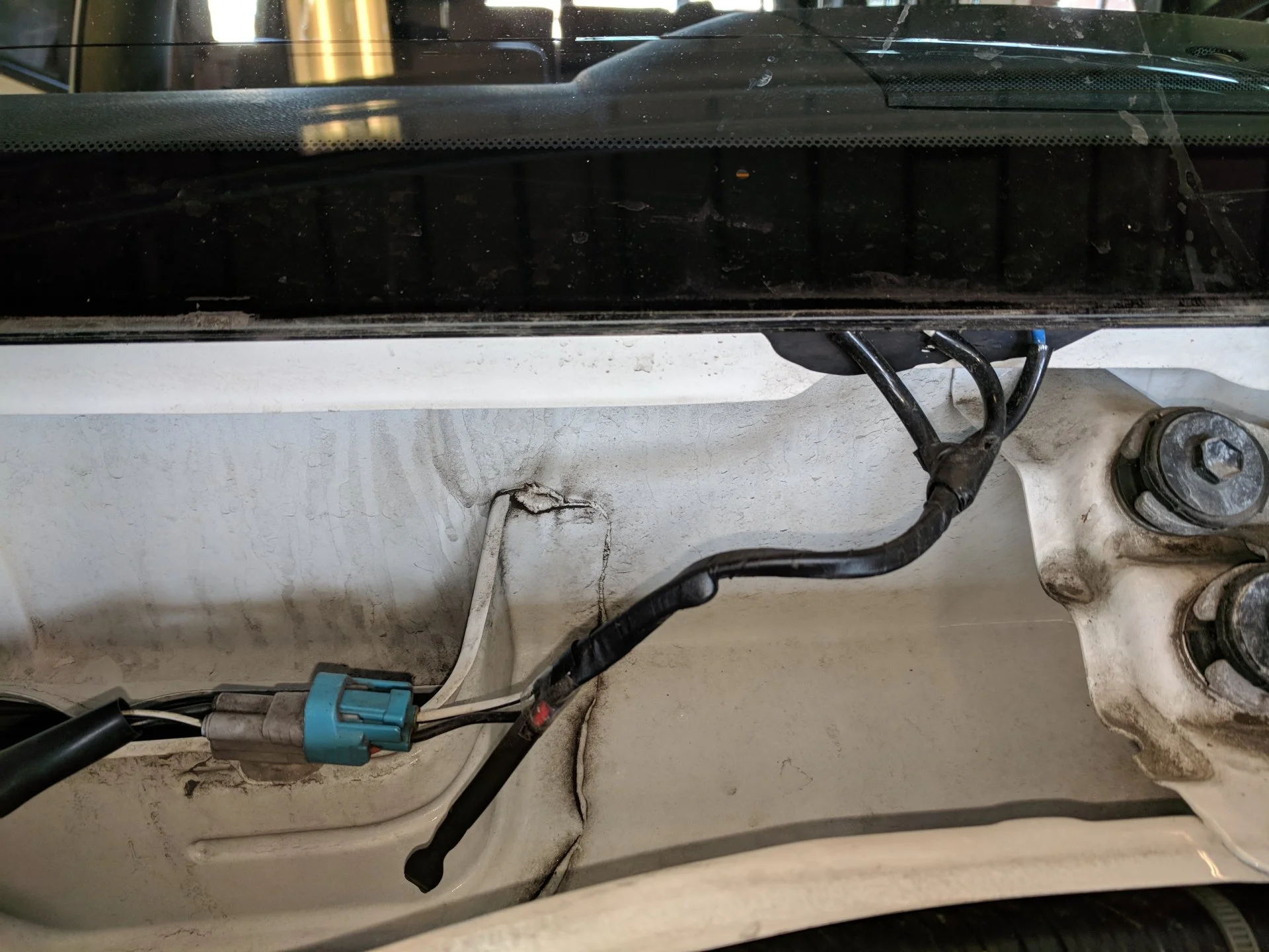

For those with a 2013-2015, the next time y'all pull off the cowl can you snap some photos of how the windshield de-icer plug is wired? Mine has never seemed to actually do anything.
Here ya go, this was in my previous 2011 but it's identical in my 2015. Honestly, I'm not impressed with the deicer, it doesn't work as well as I had hoped.

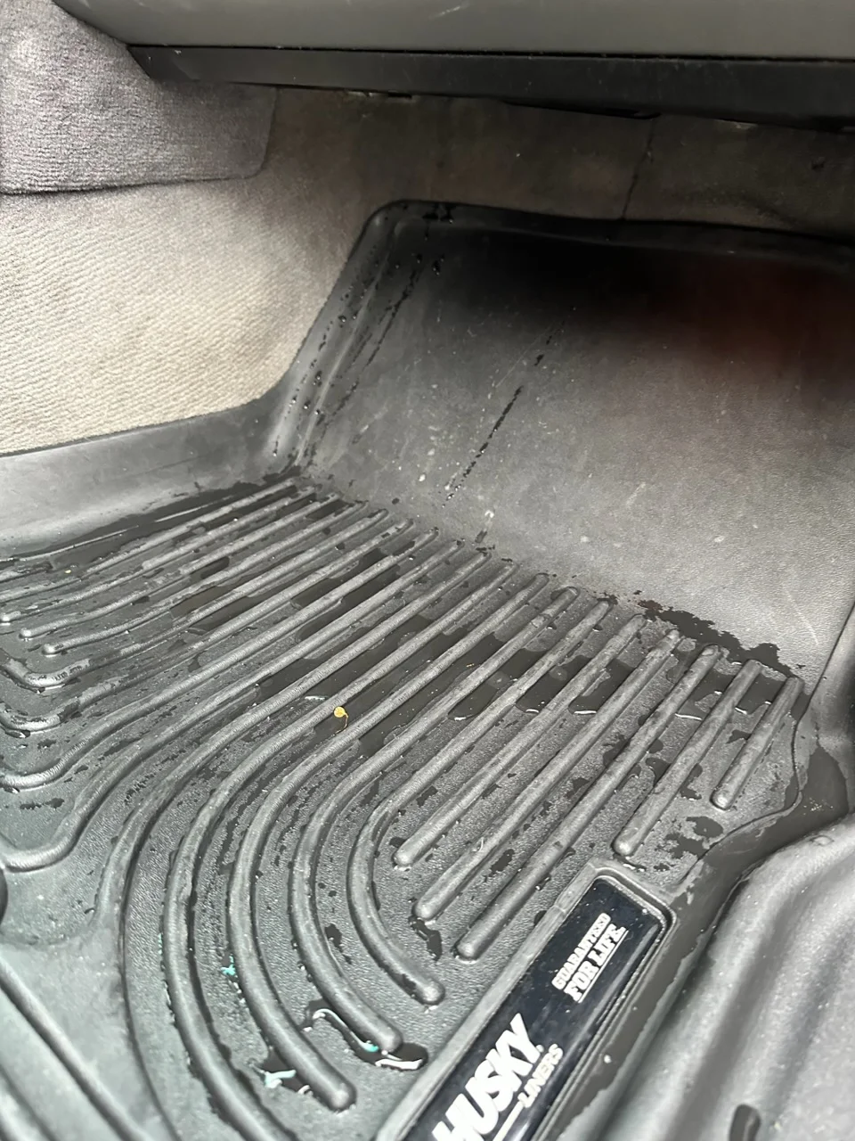

The water was absolutely coming in through the fresh air vent and dripping onto the floor mat. I can see where the water made trails in the road dust in that plenum, and before I fixed it, I could observe water dripping out of the white plastic HVAC surround behind the glovebox.

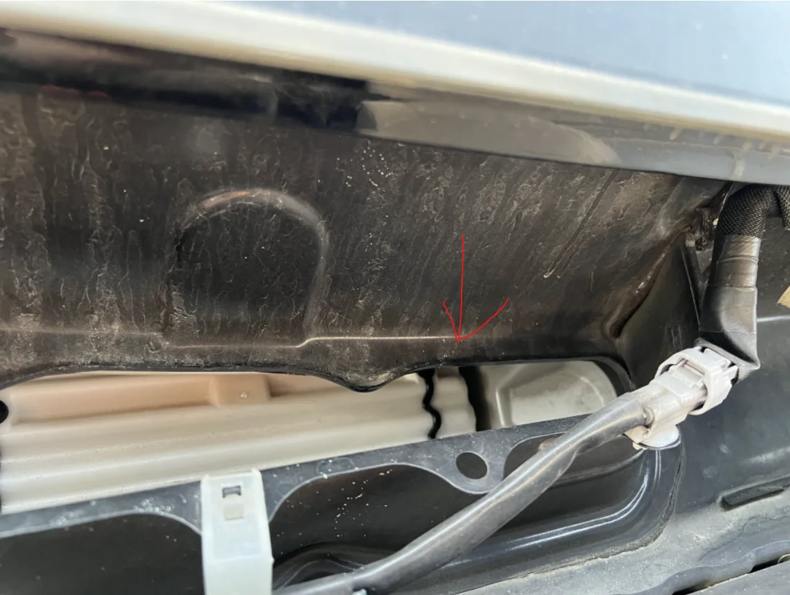

I resealed all of the places where the oem foam had compressed with new expansion type weather seal. I also added a larger 1" section of foam to the gap that appears to have a factory weather seal on the new version of that tray.
I also cleaned the rubber strip at the top and the windshield with alcohol (like you would with a windshield wiper blade). There was a lot of crud buildup that could have also impacted how well it sealed. Maybe sand too, since we just recently got back from a week in the outer banks.
An aftermarket windshield was installed by the PO, so that plastic cover had definitely been displaced at least once. I have a suspicion this is where the drip starts to rear its head for may people. A theory: once the foam is compressed and then removed and reinstalled, it doesn't re-expand, and leaves small gaps where water can get in.

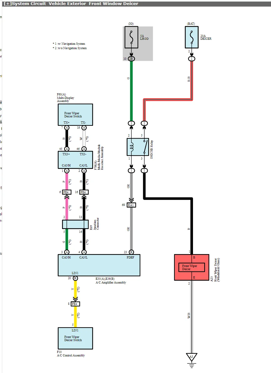

Thanks. So weird. I'm actually confused though why the windshield has 3 wires when only 2 get connected. I'm guessing one of the wires it hot for the lower deicer and one is hot for the driver's A-pillar de-icer and they are tied together into the single black hot wire...
My windshield seems cold, like the function literally does nothing. But the circuit is so simple. Fuse is good. I assume the relay works since the function in the nav display lights up and runs for ~20 minutes or whatever before turning off automatically. Maybe I'll break out the multi-meter at some point when I pop off my cowl and check for any signs of water intrusion under the foam (since my windshield is not original)

Also fwiw that wire and plug is for the deicer. Is your windshield OE or pilkington? My pilkington deicer was pathetic, but the new OE panel still only marginal. I did find that my passenger wiper was adjusted to sit a bit too high so it didn't park on the heated part.. fixing that was a chore.. had to take the knurls out of the wiper arm so it wouldn't just go back to the same spot again when tightened. The new position does seem to help.. but none of it is up to the task of serious snow/ice build-up.
