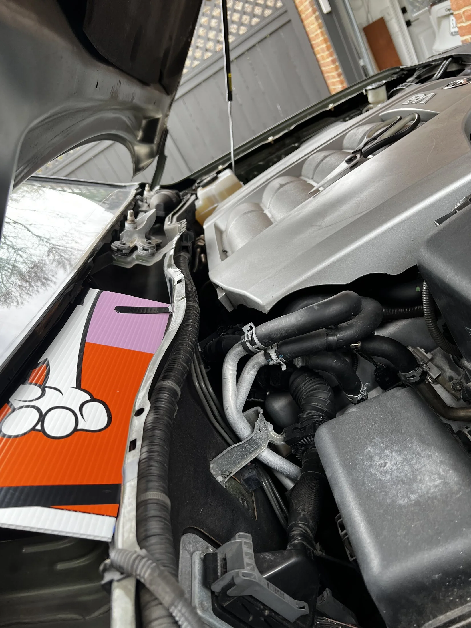

Got the passenger footwell leak after some haavy rain. Cleaned both sunroof drains, but the leak recurred. Planning to replace the cowl in the future, but for now decided to create a cover for the recirculating air hole using the method mentioned here. Used an old sign made from corrugated plastic. The weatherstripping on my cowl is very worn out and the plastic is getting discolored.

Followed @CharlieS lead with the old coroplast sign and CAD (cardboard added design). However, no foam. Hopefully, it’ll do the trick.

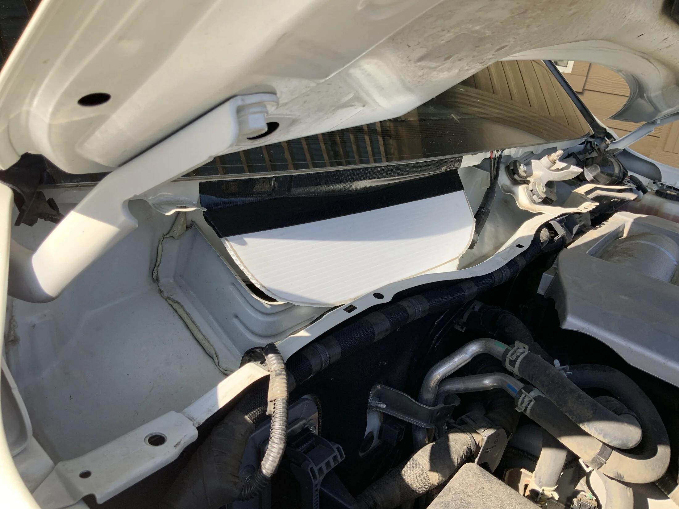

The water was absolutely coming in through the fresh air vent and dripping onto the floor mat. I can see where the water made trails in the road dust in that plenum, and before I fixed it, I could observe water dripping out of the white plastic HVAC surround behind the glovebox.
The mesh is also a really good idea, but I was in a hurry to get the vehicle back together, and am not eager to pull it apart again, so it'll have to wait until next time.

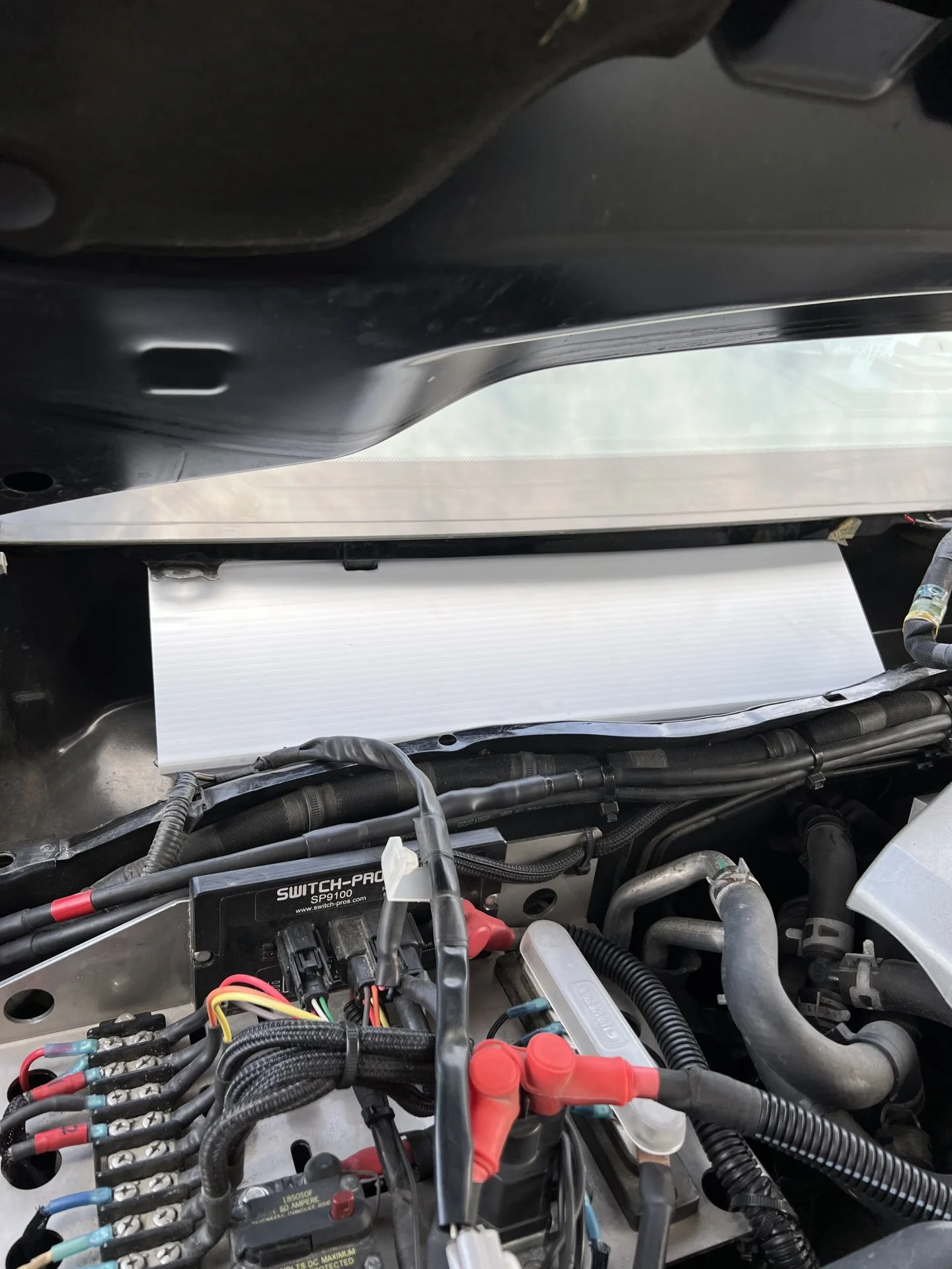

The coroplast "roof" I installed has plenty of airflow around it, all air handling works fine. No water is getting in. Lots of air is flowing around it. No reduction in cabin air flow or AC efficiency that I can observe. It is easily reversed, and nothing on the vehicle was harmed or modified to install it. It is really just one more layer of prevention - there are multiple levels of rubber seals, plastic channels, sealing foam, and metal ridges that collectively do a great job of diverting water. In my mind, this is just one more layer of prevention.

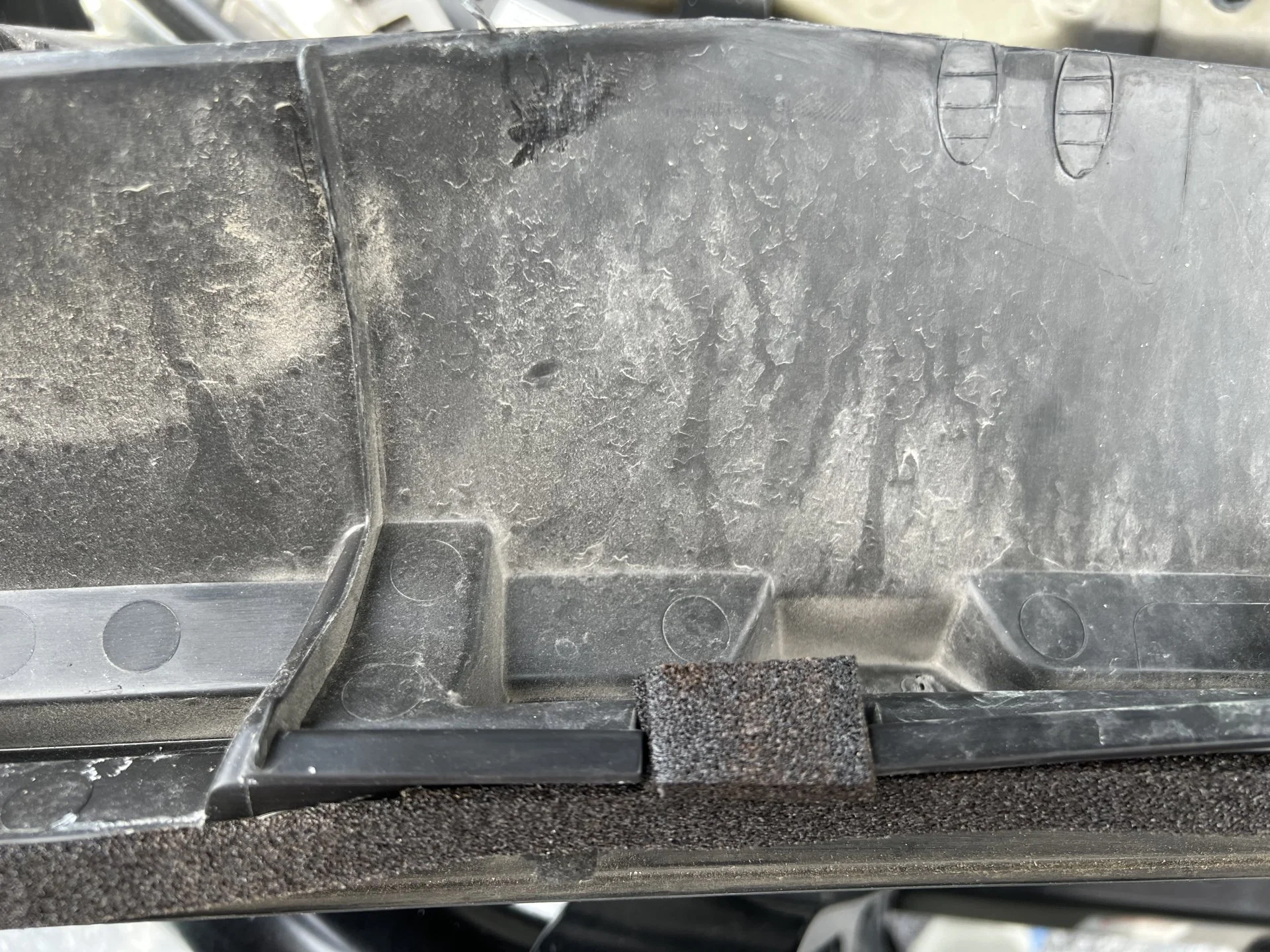

I resealed all of the places where the oem foam had compressed with new expansion type weather seal. I also added a larger 1" section of foam to the gap that appears to have a factory weather seal on the new version of that tray.
I also cleaned the rubber strip at the top and the windshield with alcohol (like you would with a windshield wiper blade). There was a lot of crud buildup that could have also impacted how well it sealed. Maybe sand too, since we just recently got back from a week in the outer banks.
An aftermarket windshield was installed by the PO, so that plastic cover had definitely been displaced at least once. I have a suspicion this is where the drip starts to rear its head for may people. A theory: once the foam is compressed and then removed and reinstalled, it doesn't re-expand, and leaves small gaps where water can get in.

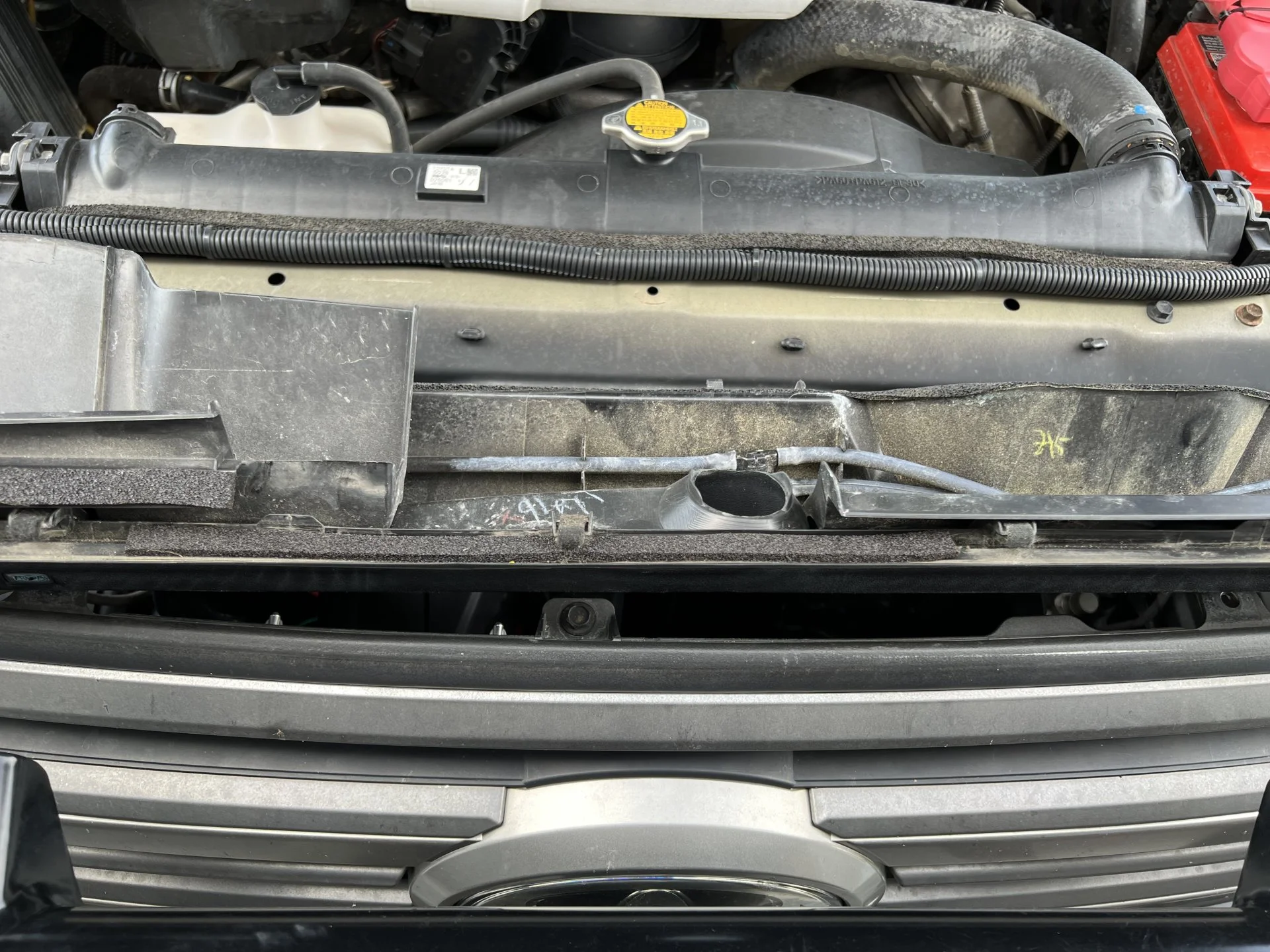

Was experiencing water in the footwell. Found this thread, so I pulled the cowl. On the way to get new weatherstrip.
BUT I noticed this
Replacement windshield… did the tech just remove these wires? What does this go to?
Either your replacement windshield didn't come with the provision for the wiper blade heaters or the tech ripped the harness for it off.
Wiper heaters (heats the glass beneath the wipers parked position).
I take it that that stayed with the old windshield and my man didn’t replace it (Safelite) or bother to inform me about the issue.
Is there anything I can do without having the windshield removed? Part number?
