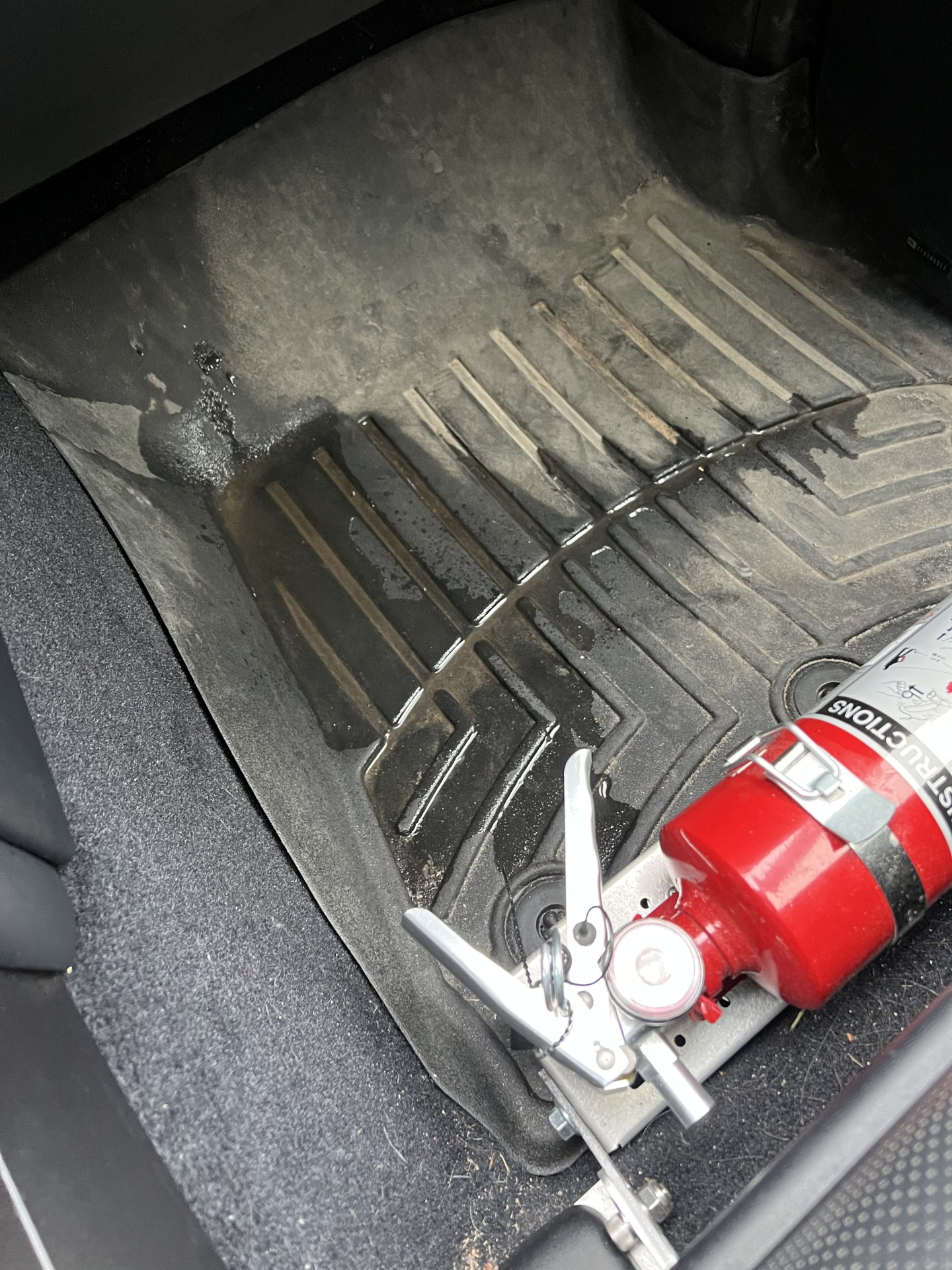

It is raining here, not a huge storm or anything, just a regular rain. I went out to pick my son up and found a puddle in the footwell. I usually park in the garage so have never noticed this (my bay is filled with camping gear that I need to put away). I tried to see where it is coming from and didn't have any luck. I tried to search, but don't have the right terms. Can anyone share typical sources that I can run down? I seem to recall the windshield cowl being one point of entry...

Thank you. I just ran a trimmer line down the front two. I poured a pitcher of water in the sunroof tray and it drained right out the drains. I figured I'd try the cowl area, and dumped a gallon or more there, and it also drained out (behind the front wheels). None of it landed on the floor mat area. Maybe the string line cleared whatever blockage there was?
Well, I ran a trimmer line doubled over a bit ago and unhooked the right side hose.
I was getting water down the A pillar. It pooled in the channel under the door trim.
I’d suspect windshield, but you’ve had the rig long enough to make that unlikely, right?
It was helpful for me to get a watering can and pour water in specific places to rule out rack feet and windshield as leak points.
It was the sunroof. . .

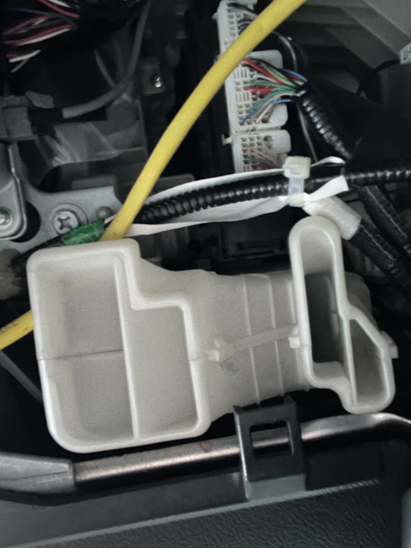

I'm tired of hearing about this and the electrical problems it causes. Is this officially a design issue?
Hopefully you've got it taken care of.
You hear about it because only the few with the issue post it on a forum. The bast majority of people do not have the issue.
Also - it can happen to any car.
Do other cars have the electronics in the same, exposed position as the 200 does? I like the tell-tale of the water on the floor, but I wish a stuck drain wouldn't put water in to the junction panels.

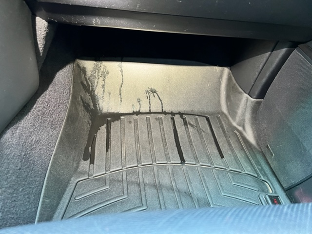

Charlie I immediately suspect the gasket under your cowl trim. Was the truck pointed nose-down? There have been a few people posting about a condition where when that is the case water enters the fresh air vent for the blower fan and ends up in the passenger floor liner.
Over the years I've come to assume if you get water in the liner, it's the cowl gasket, if it's in the rocker it is sunroof/roof rack/other issues.
Do some digging for the cowl cover aka panel and the foam rubber gasket. People have put on a new cover with gasket, or beefed up the gasket that was there, with good results. Sorry I can't think of the specific threads right now.
Your leak area is pretty much identical to mine, and I will share my solution (new cowl).

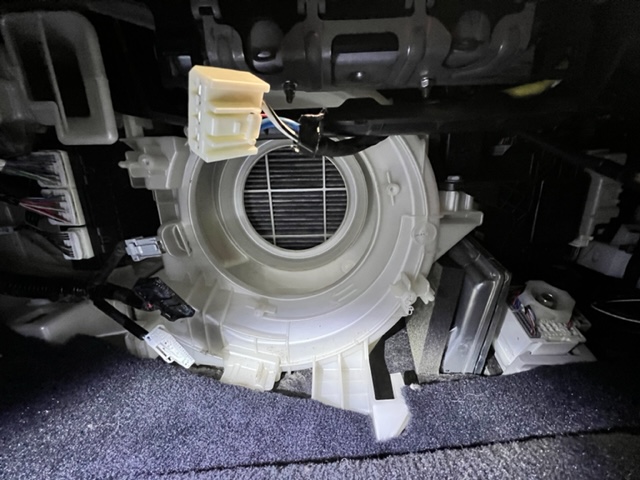

FYI, you really have to remove that plastic cover under the passenger compartment with carpet padding on it.
(That carpet padding will absorb the water that entered into the cabin and also reduce the actual leakage onto the floor & difficult to trace exact source)
I suggest you to actually cover up the HVAC inlet completely with a plastic tape or something to find out if it's indeed cowl related leak.
Go through the carwash and see any water coming down onto the passenger floor.
You might get away with a new gasket like others did... however, on my case, new Cowl from Toyota dealer fixed the issue completely.

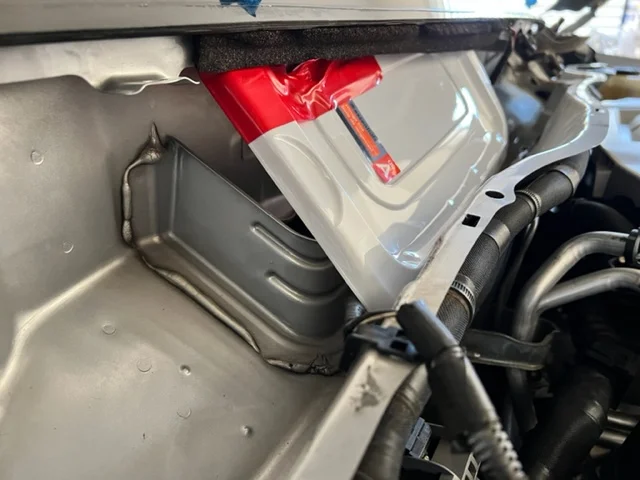

A few years ago I found my cabin air filter was wet. So I knew the water was coming in from that level and an enclosed system because just above that is a funnel like inlet leading to the filter which is viable with a flashlight looking down the vents by the wiper blades. I did not change out any parts, foam or plastic. I did make a cover for the cabin air inlet duct that would eliminate most stuff that gravity had an effect on. Fresh air just entered from the left or right of the new plastic cover. "kwelhand"'s fix looks like the the same kind of fix I did.
Why does our HVAC air inlet duct not have a cover?
On your picture here... Wouldn't be better to cap off the top and just take a hole saw and drill some holes on the side with some screen over the holes for critters.
I would think Side holes would provide enough air flow and not let in heavy rain?
