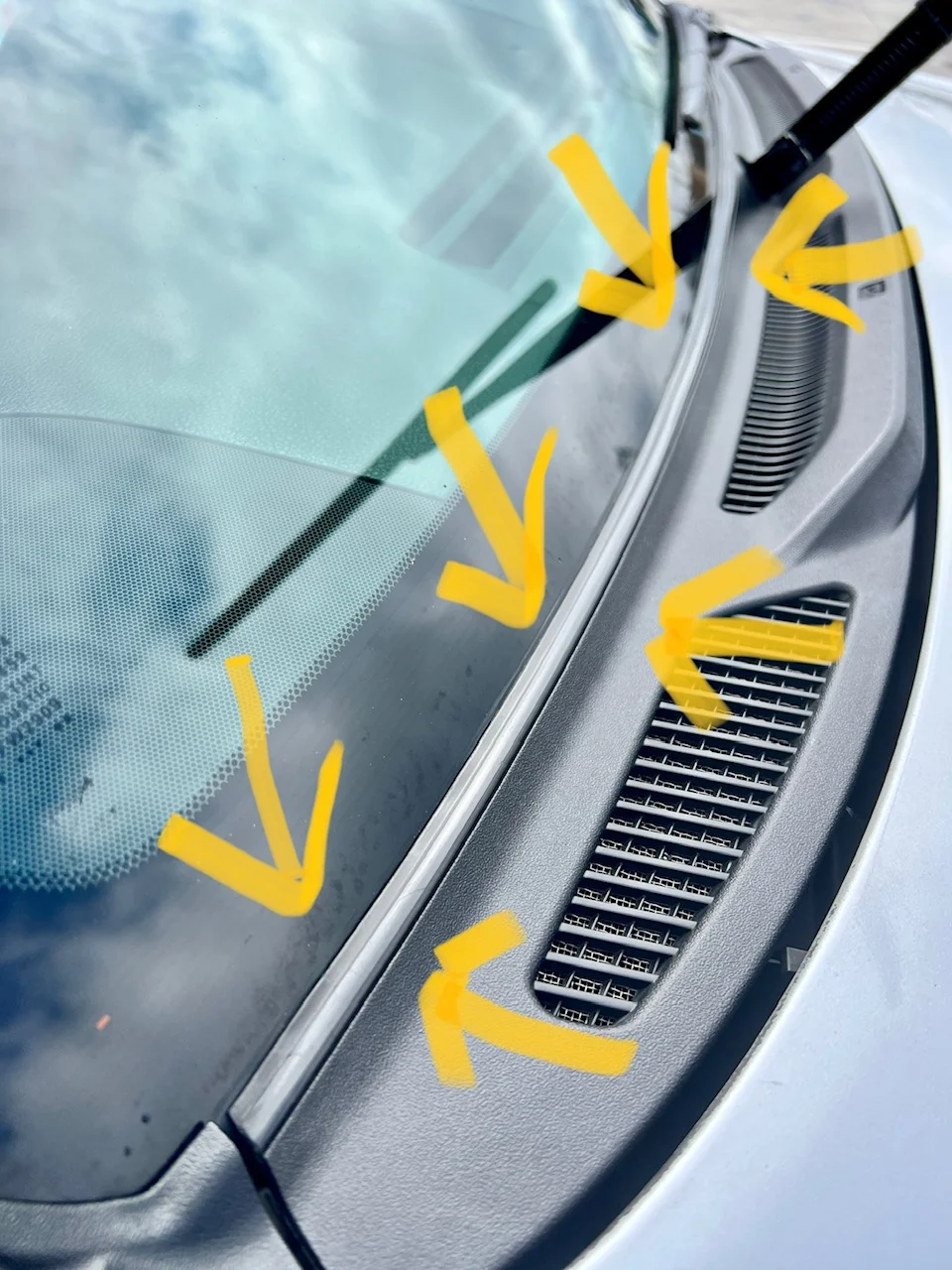

On your picture here... Wouldn't be better to cap off the top and just take a hole saw and drill some holes on the side with some screen over the holes for critters.
I would think Side holes would provide enough air flow and not let in heavy rain?
But I am curious why some get this and not others. I have had mine in several tropical storms and hurricane conditions and have not had that leak.
I wouldn’t want to lower the level of the highest point at all. A lot of water can get in that area, and the drains on the sides possibly clogged with leaves and things they get around the wiper arm holes. Or if the passenger drain is clogged, and parked tilted toward the right.
A shield to keep water from directly pouring in seems good.

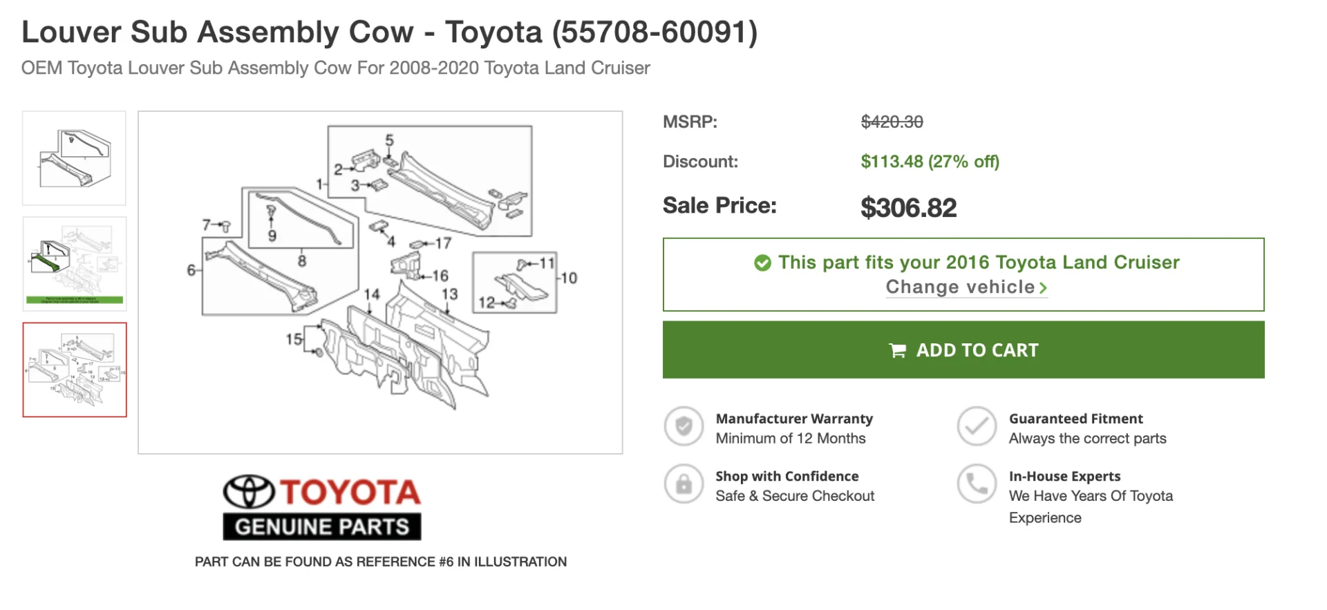

Does this seem like the right part:

Does this seem like the right part: View attachment 3001094
There is also a 55708-60101 for our trucks. The -60091 part has a "WITHOUT (COLD AREA SPEC)" footnote. No footnote on the -60101 number. Not sure whether that has to do with wiper heaters, or something else?
This is a case where talking to a parts counter and giving them your VIN may be beneficial.
Lastly, DO NOT try to cover up the HVAC opening w/ some sort of barrier.
I post a pic advising people not to cover up this area like I once experimented.
In my case, the air flaw greatly greatly reduced when using my HVAC fan (like 1/3 of air flow compare to before).
Also, the water soon find its way back into the HVAC inlet anyway.

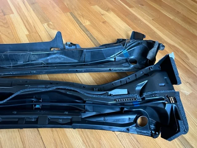

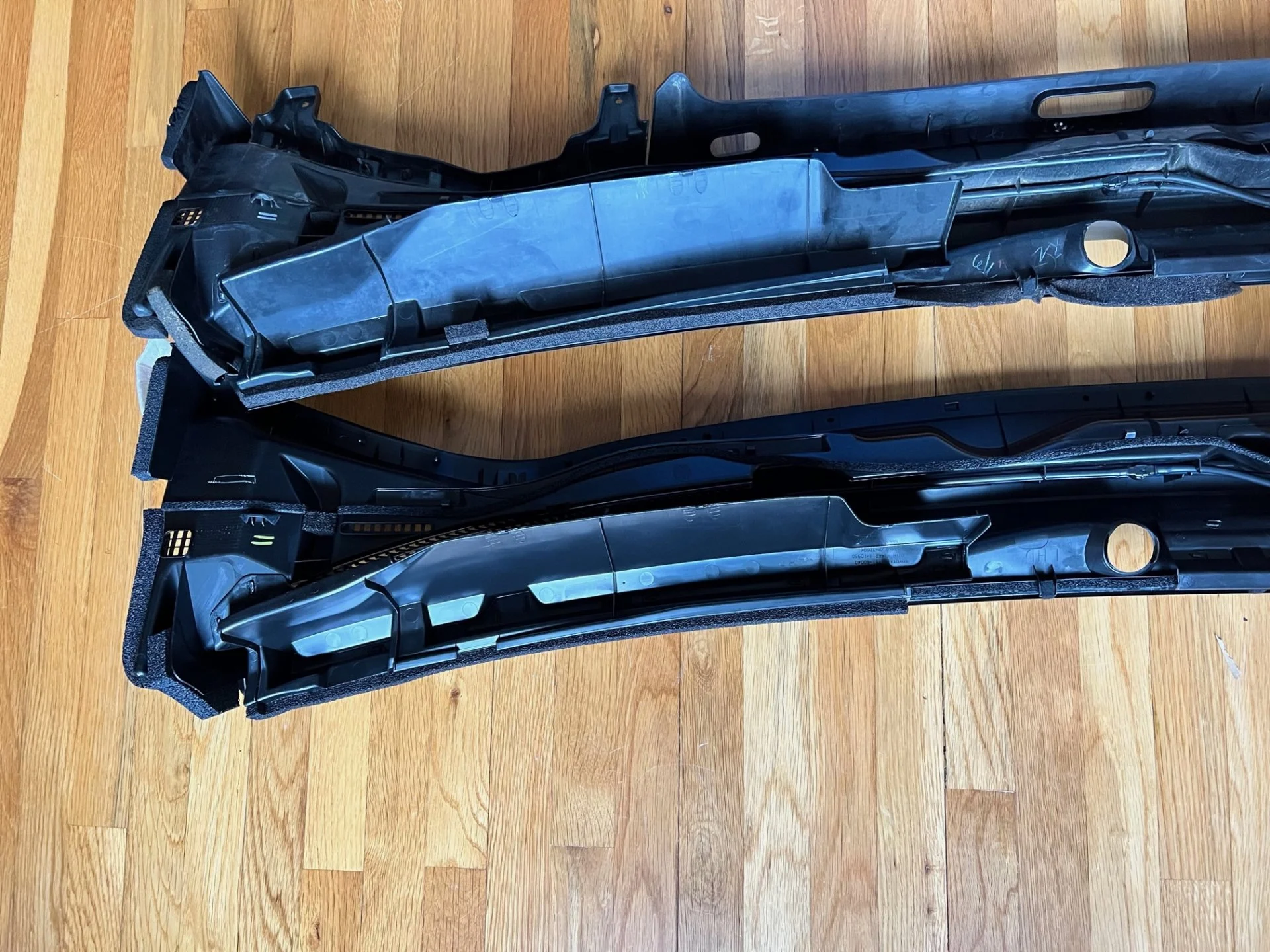

Replacing the entire plastic part when it's just some adhesive-lined foam rubber that is the issue seems unnecessary. We need someone with some industry experience in foam rubber types to help us source this stuff.
Charlie.. when you get your new cowl, can you take measurements on the foam that is there?appears to be a couple different dimension types. Or anyone that has a new one sitting around.
With that I'll go down the rabbit hole of trying to determine what Toyota used on this.

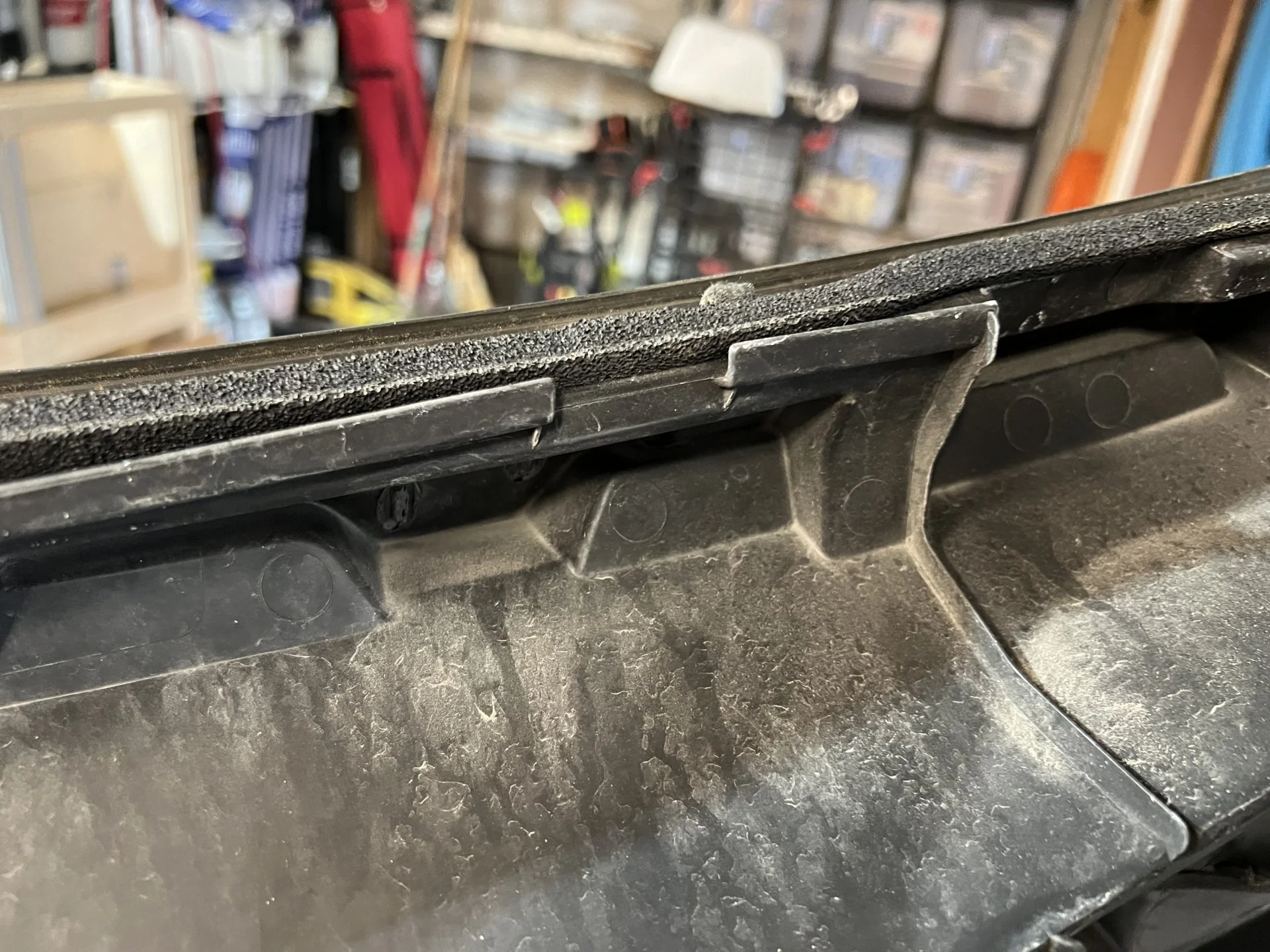

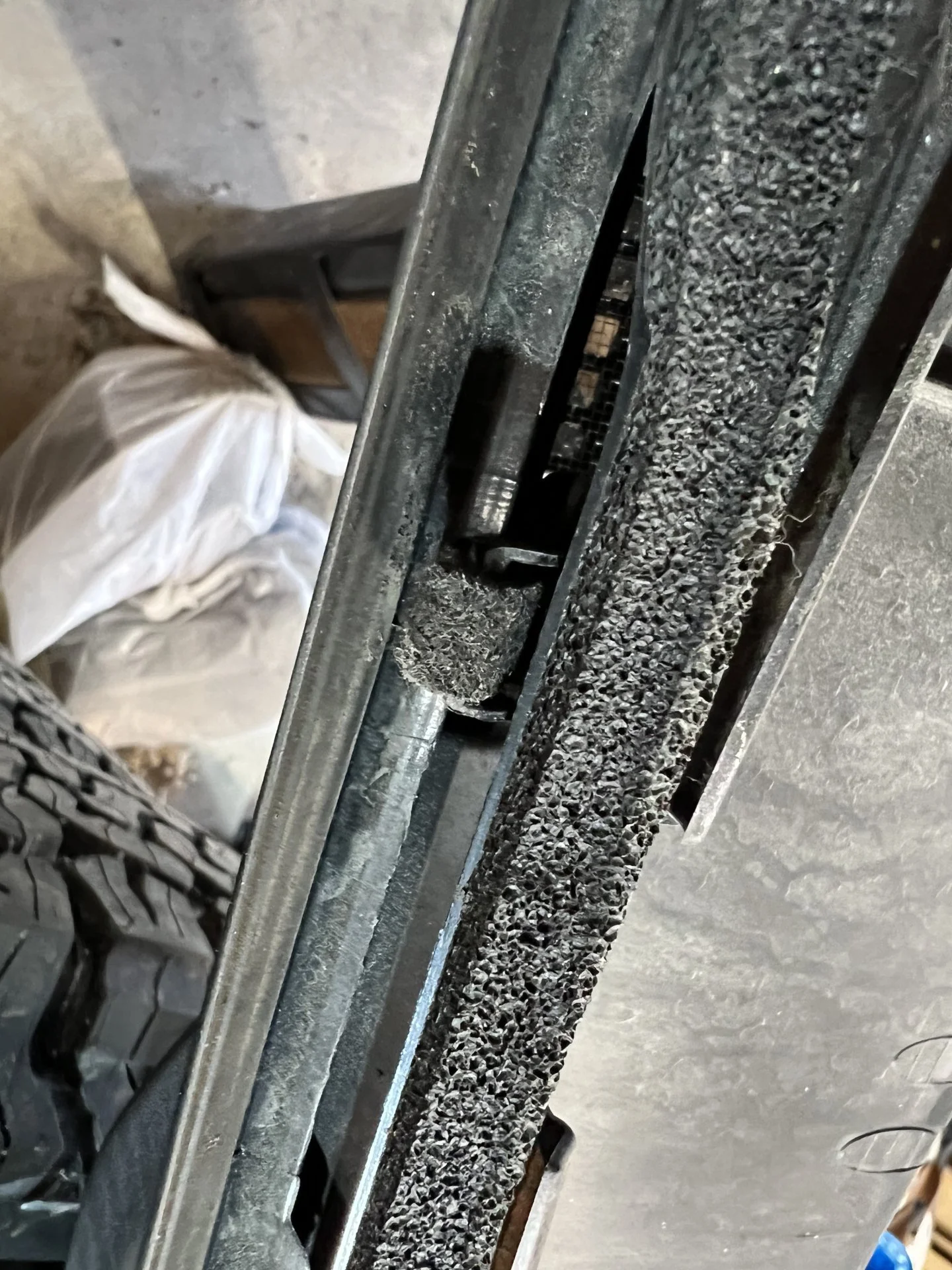

My biggest issue was the uneven rubber seal that press against the windshield.
At one point, I even used the automotive sealant, but it didn't work...

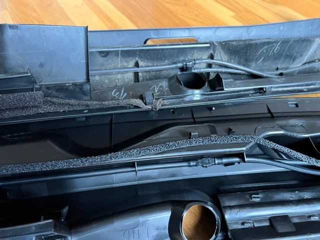

If memory serves me right, that entire area underneath the cowl can handle a lot of water because it just drains toward the wheel wells on either side. The only exception is directly above the fresh air intake. The part of the cowl that mates above that fresh air intake does have grooves to facilitate drainage except for that one to two inch gap.
In the photo @kwelhand posted of the old and new cowl, there is an additional foam piece underneath that same gap that I didn't have on mine. It's also the same place where I added additional foam.
I still have a habit of checking the passenger door well after some decent rain and so far it's held up.
Now I wonder if it was ever there originally or a new thing they added.

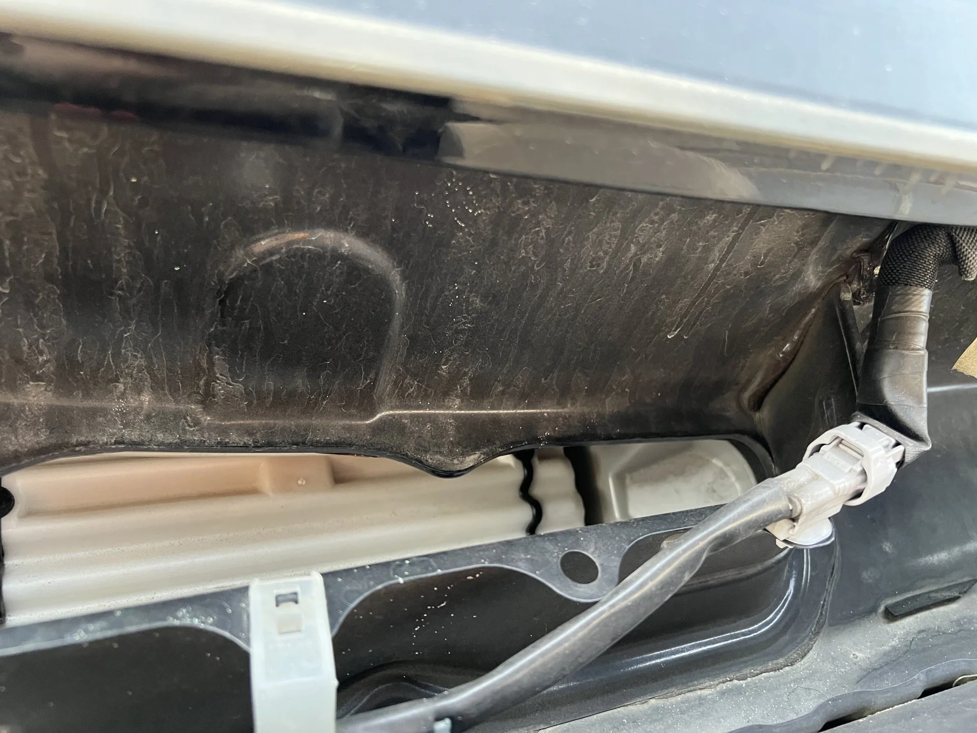

I finally found time to pull the cowl off, and it seems clear that the only way water is getting into the cabin in that area is through the top of that gaping hole into the hvac.
I definitely see areas above that opening where the foam is compressed, and can see the gap you all are talking about. The compressed foam is visible to the naked eye, but is hard to photograph.
I'm going to give the adhesive foam a try, and expect that I'll probably need a cowl eventually. Maybe next time mrT has a big sale. :)
Like others, I don't get why there isn't some sort of cover over that opening. Like maybe a chimney cap kind of arrangement where air can get around the sides...
