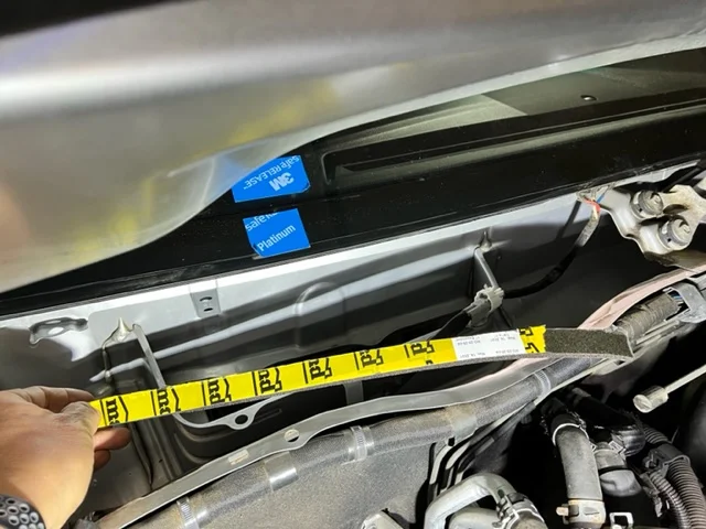

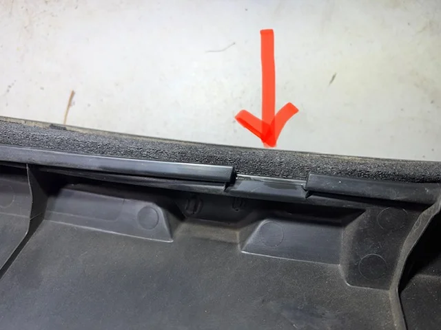

I think 99% of the issue is where the red arrow is, but I suspect the channel highlighted in green could get over run in a case where the seal is allowing too much water by.
Yes.

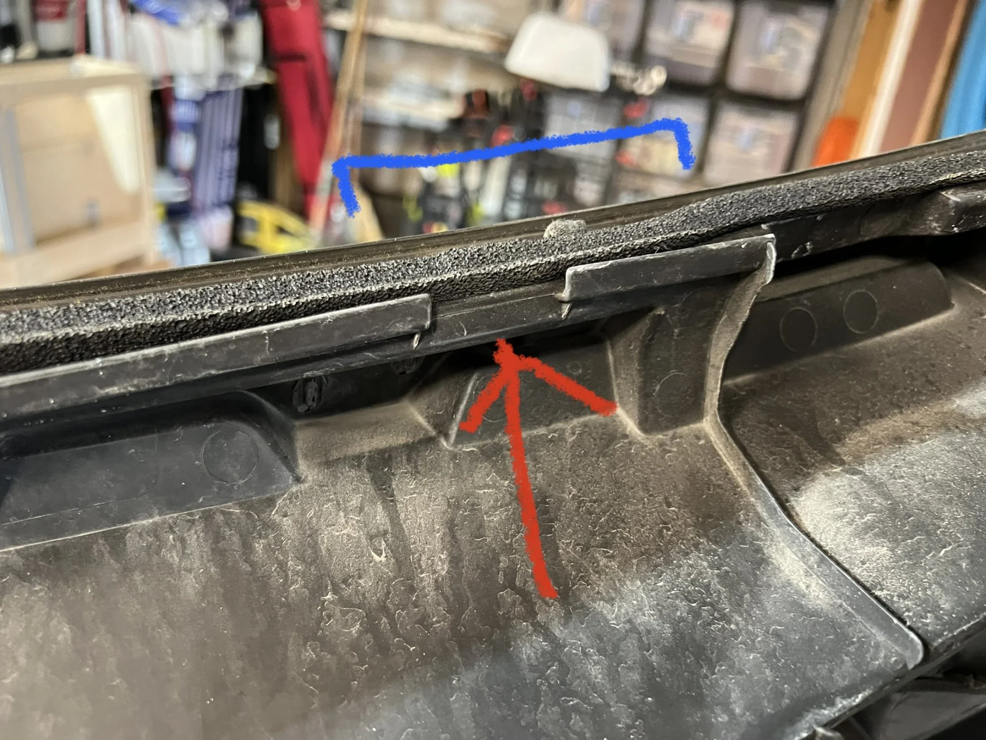

What is a little hard to see is that the seal above it, bracketed in blue in the picture, is compressed. It looks like water could get past that to the red arrow, where it goes right into the plenum.

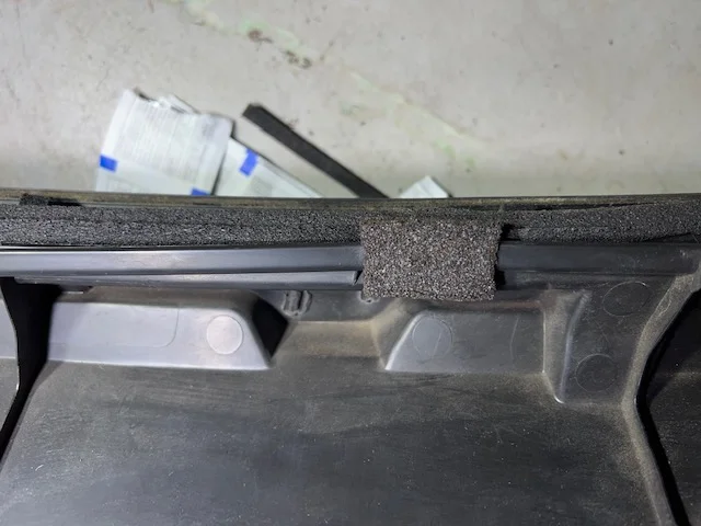

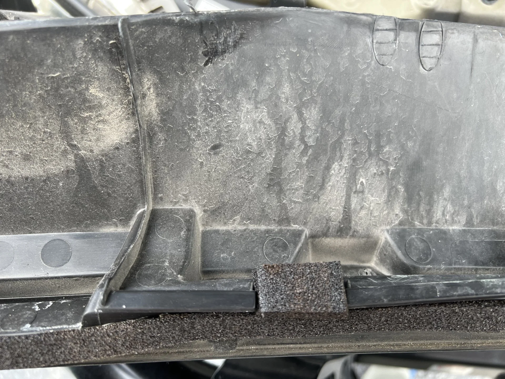

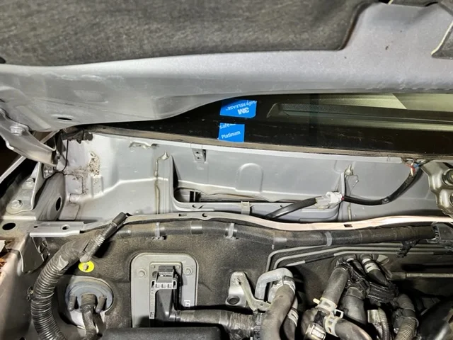

I finally found time to pull the cowl off, and it seems clear that the only way water is getting into the cabin in that area is through the top of that gaping hole into the hvac.
I definitely see areas above that opening where the foam is compressed, and can see the gap you all are talking about. The compressed foam is visible to the naked eye, but is hard to photograph.
I'm going to give the adhesive foam a try, and expect that I'll probably need a cowl eventually. Maybe next time mrT has a big sale. :)
Like others, I don't get why there isn't some sort of cover over that opening. Like maybe a chimney cap kind of arrangement where air can get around the sides...

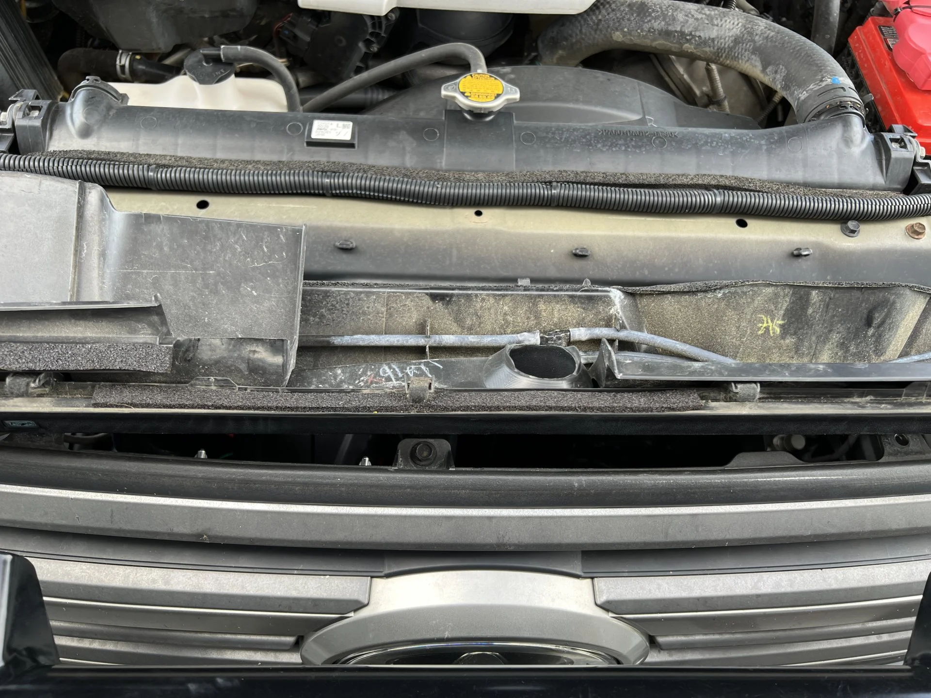

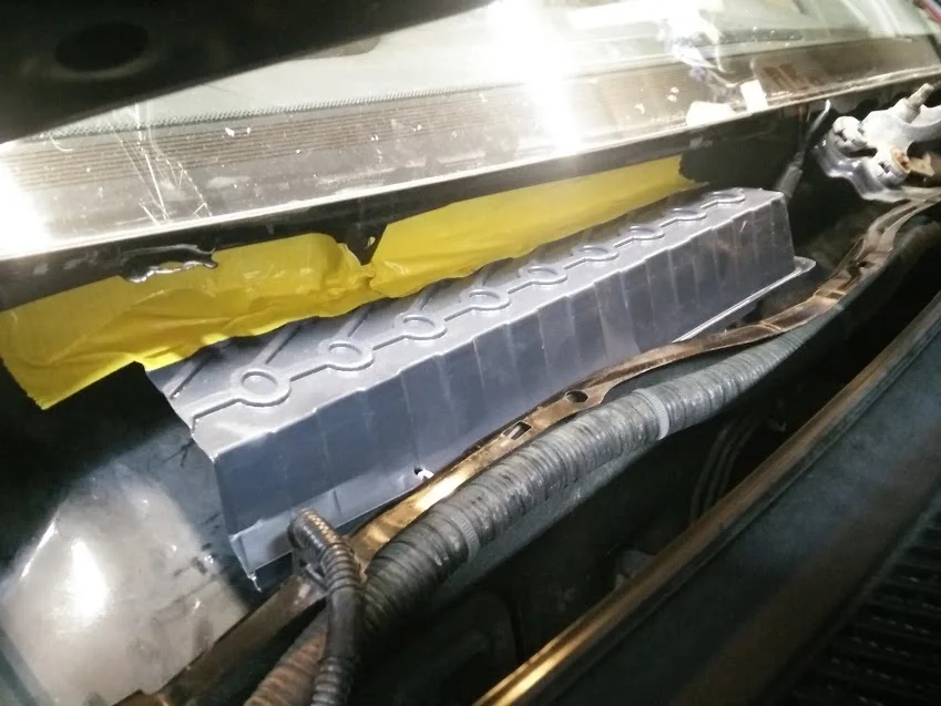

Here's my HVAC inlet area for comparison.
As you can see you have significant residue that shows how water went down into your fresh air opening.
Yes, I drove dirt road quite often but mine was clean... perhaps, I caught it during the very early stage?

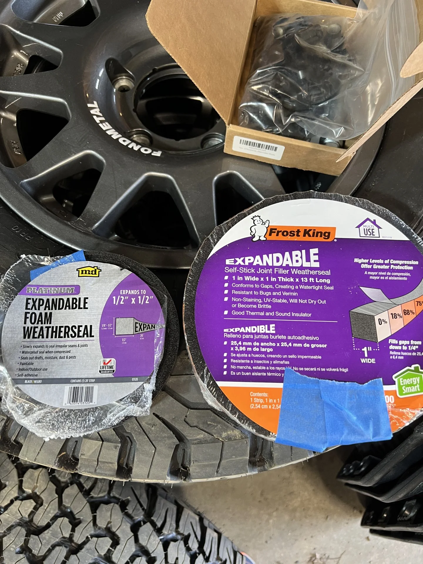

I reinforced the opening with a Lowes foam gasket and later on, around the cowl... reduced the water intrusion quite a bit.
Also, applied to the above fresh air opening and later onto the cowl.

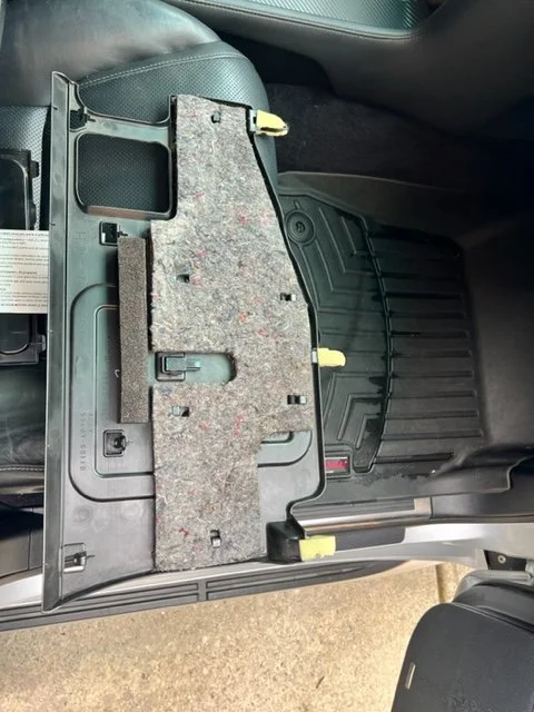

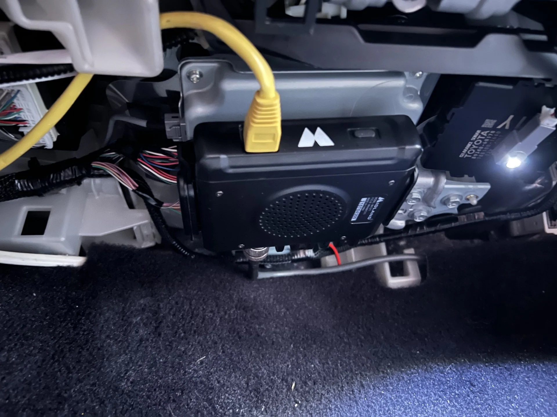

I agree, that pad will hide the issue for quite a while I think. If the seal is o my leaking a little, that pad can certainly hold a few tablespoons of water at least. I left that panel out for a few weeks when I was testing, that way any water would just go down to my rubber floor mat.
I do not have that pad or cover anymore. I removed it to put my GMRS radio there. Water has a straight shot to the floor.

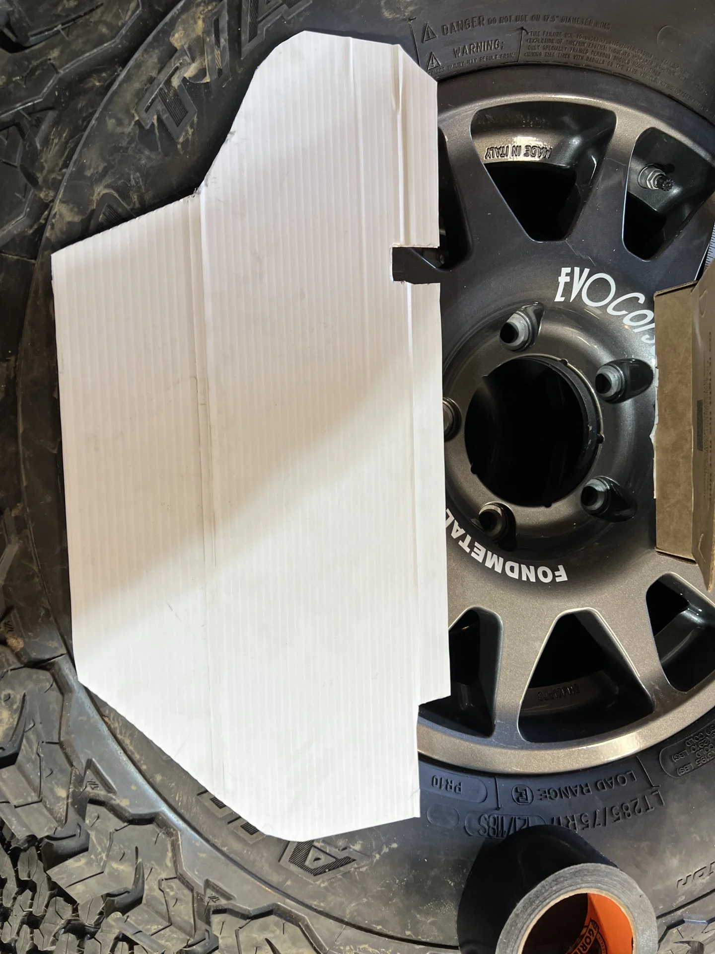

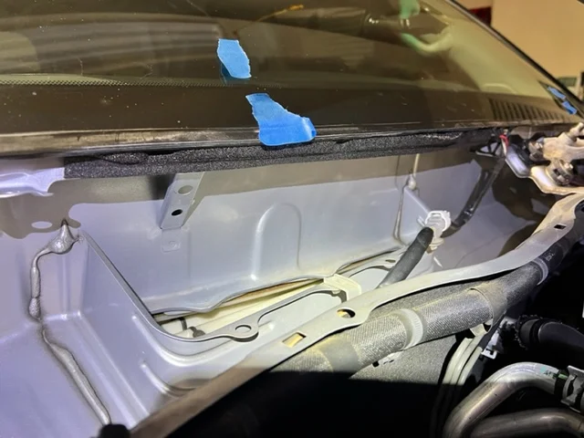

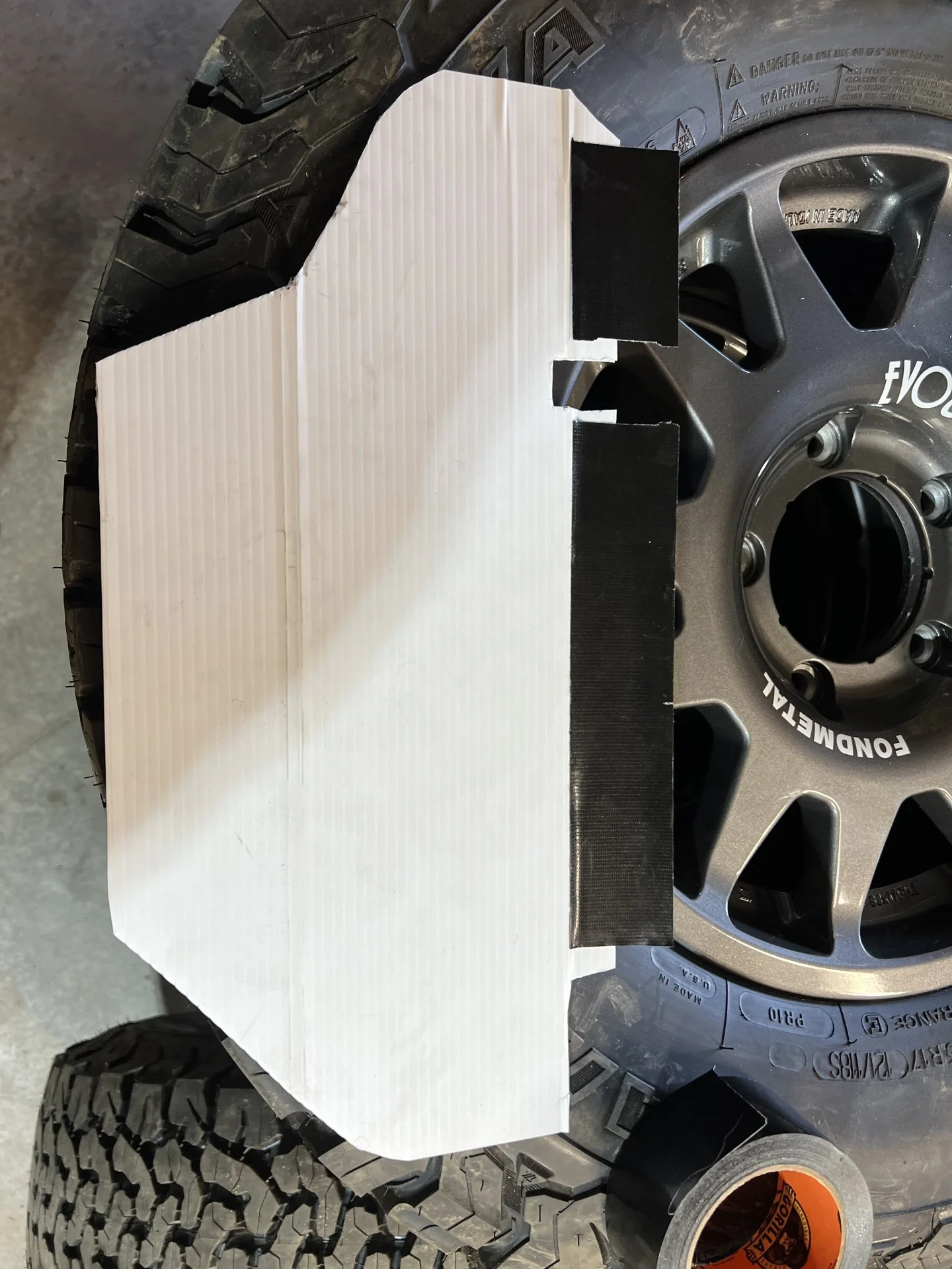

Prototype from an old coroplast sign...

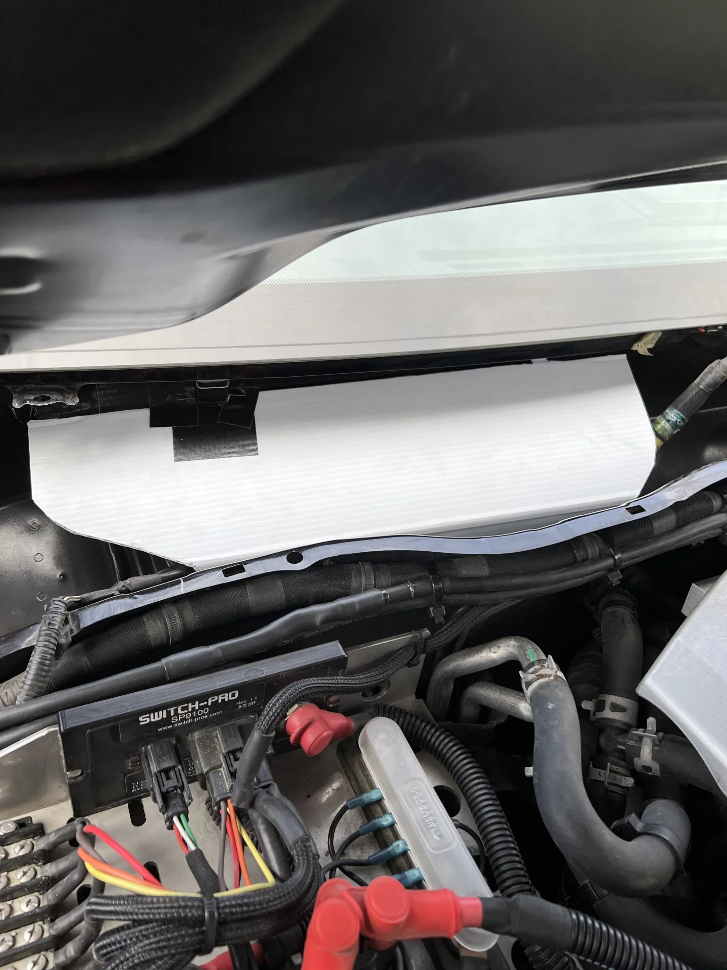

what I ended up with:
And some weatherseal:
Potential kydex or 3d printed product idea?
Not fancy, but it might just do the trick.
Free coroplast sign I had saved from years ago and some gorilla tape.
The curved area on the left side accomdates a large curved plastic shield that sticks down in front of the plenum. Probably an air or water deflecting shield.
Just got home from work to see CharlieS has had a great creative day under the hood. That looks great!
Thanks!
I'm going to call this fix a success. It poured for hours this weekend and not a single drop made it onto the passenger floor mat.
