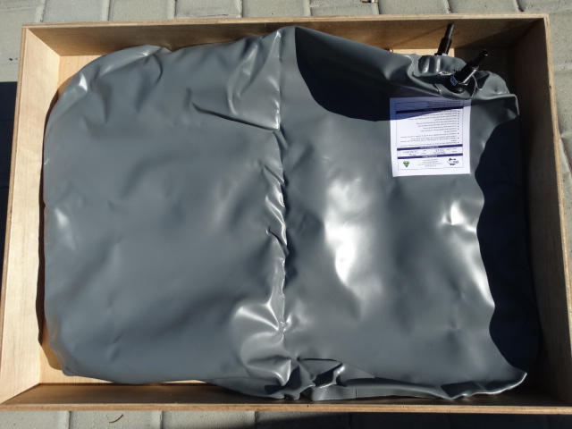

So, all I lost was 5" of vertical height which actually helps to raise everything up anyway. What I gained was a 70L water storage container that is 'built-in' and out of sight and safe and reasonably 'low' sitting the vehicle. The box bolts down to existing captured nuts (rear seats) so it is secure and not moving anywhere. I then strap the fridge down to the top of the box along with the other storage boxes. So, all nice and safe, nothing moves/rattles etc.

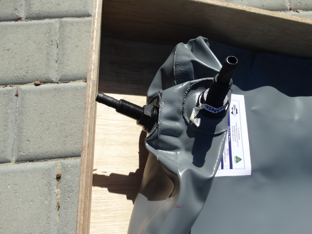

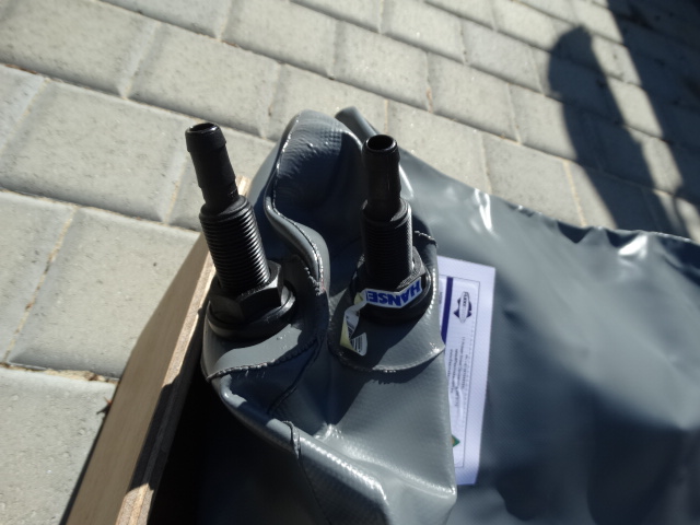

The bladder has an inlet fitting (on the top edge) and an outlet fitting (on the bottom edge). Hoses run in/out of the wood box and I have potable water hoses and valves connected. To make things 'safe', I can just clip the hoses higher than the bladder and nothing can leak even if there's a valve failure. Filling is just a matter of connecting a hose to the fill side or when bush using a 12V pump to transfer water through a filter from a water source. Dispensing is easy, just lower the outlet hose lower than the vehicle and open the valve - straight into a container or into the 1 gallon 'dispenser'.

But here's some pics of the bladder sitting in the box (upside down).
Custom bladder made to order:

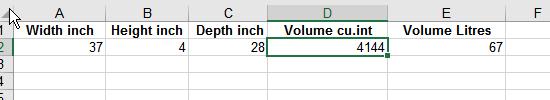

Bladder was made to the specs below. Essentially 67L if a 'box', the bladder is of capable of filling the available box space which is a little larger.
The pics above before a big mouse hole was cut in the box. There are two pipes one is essentially inlet/breather and the lower becomes the outlet, gravity operated to empty. I use a small submersible pump to push water into the bladder through a Sawyer filter. A few drops of bleach flushed through the bladder prior to a trip sterilizes any issues, but since the bladder is under a box and not in light there's not really an algae breeding ground issue.

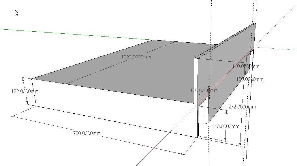

The box (metric since it was a mate in oz that made the box for me):
Again, this box was for my Patrol and designed to fit between the wheel arches and behind the driver/passenger front seats. My fridge then straps down to the box (the box in turn is bolted down to the floor via existing mounting holes). Tool boxes etc also strap down to the box. The strap downs are metal screw down swiveling brackets with captured nuts in the box plywood. Marine carpet lines the inside of the box to prevent and bladder rubbing issues. Captured nuts and bolts sit flush and don't protrude so no risk to the bladder.

Thanks george, it helps to visualize how much space 70 liters is. I'm about to take my last 2nd row seat out permanently and add onto the front of my storage so there's room for a few things like water. etc. I have my fridge accessed through my passenger rear door as this seat is already removed and I think I'll copy your design and place a bladder under it
That's the beauty of volume - it's the product of Height, Length and Width, so just 1" increase in height (notice I didn't say length...) makes a large difference in capacity. 5" tall will be 5/4" more capacity than 4" tall. So, with my above dimensions I'd go from 67L to 84L... Of course that means you've gone for 67 kg of water to 84 Kg... Though at least with a bladder the weight is nice and low (floor level). Just plan your placement so that filling is easy (from above, small 12V pump etc) and make the outlet at floor level and gravity operated. Worst case park on a little slope to get the last of the water out if you run that low. No having to strap water containers down or having to haul them in/out of the vehicle etc. Keep a small water container (say 1 gallon) for all your day to day water needs and then top up from the bladder as needed.

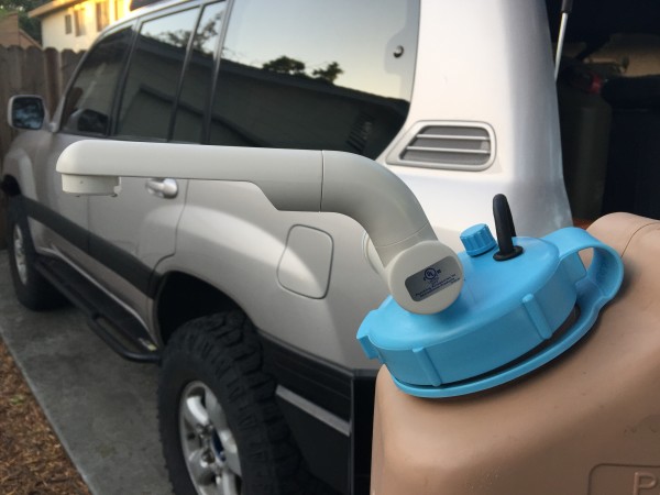

Here is something I'm using from Living Overland... I did a quick blog post and video.
Living Overland H2O System
SO I am considering making one of these but would like to be able to add a spray nozzle to wash my surf gear. Does the faucet head unscrew? Would it take a hose bib?
I have this faucet on the Kamparoo sink and it won't accommodate a spray nozzle nor does it detach. But, I bet such thing exists.
Correct - not detachable.
Remember the whole faucet assy is screwed on the Septre original pour cap so you could probably create something.
I've been looking but I haven't been able to find a faucet with an electric switch to operate a pump AND allow a hose to be attached
There are two style of faucet that looks like the one in the above picture. One style has a built in switch, that goes "click" when you turn the large dial from OFF to on. Second style has no switch so it relies on the pump to automatically sense that the head pressure is increasing and stops the pump. I'm guessing, you'll want to order the first style of faucet with built in switch. I have the second style in the Kamparoo.
