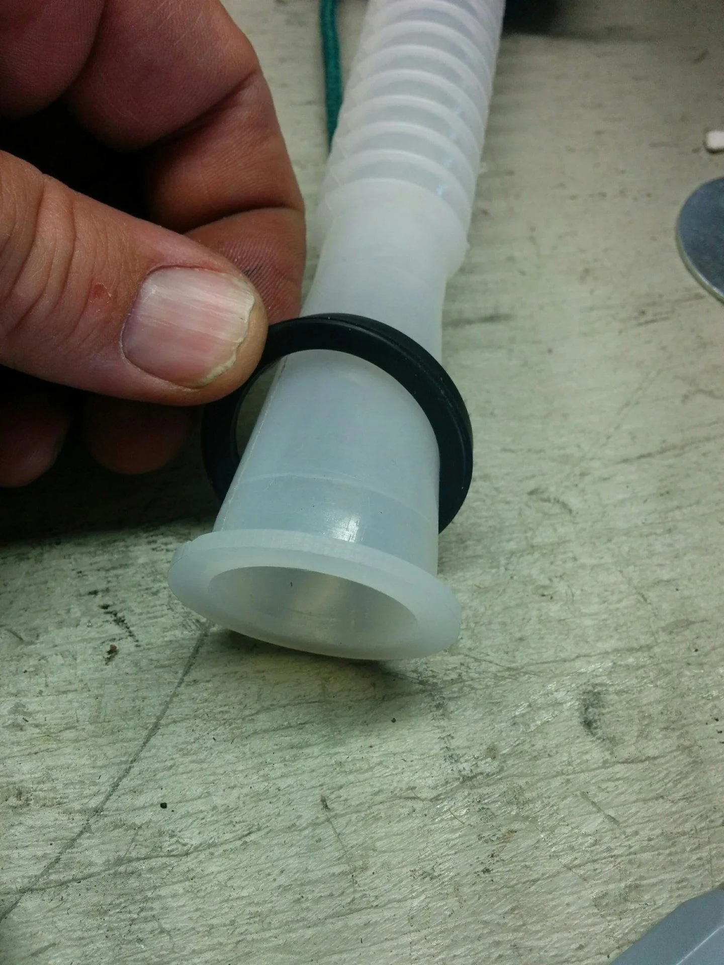

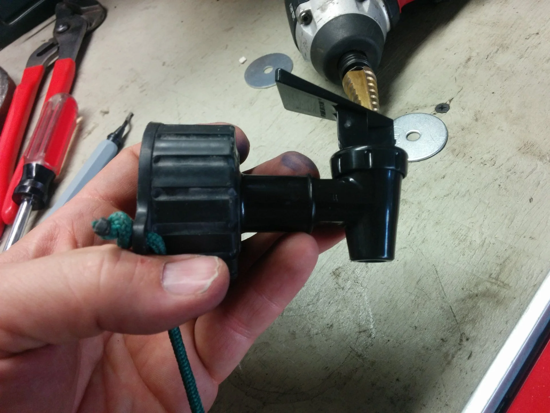

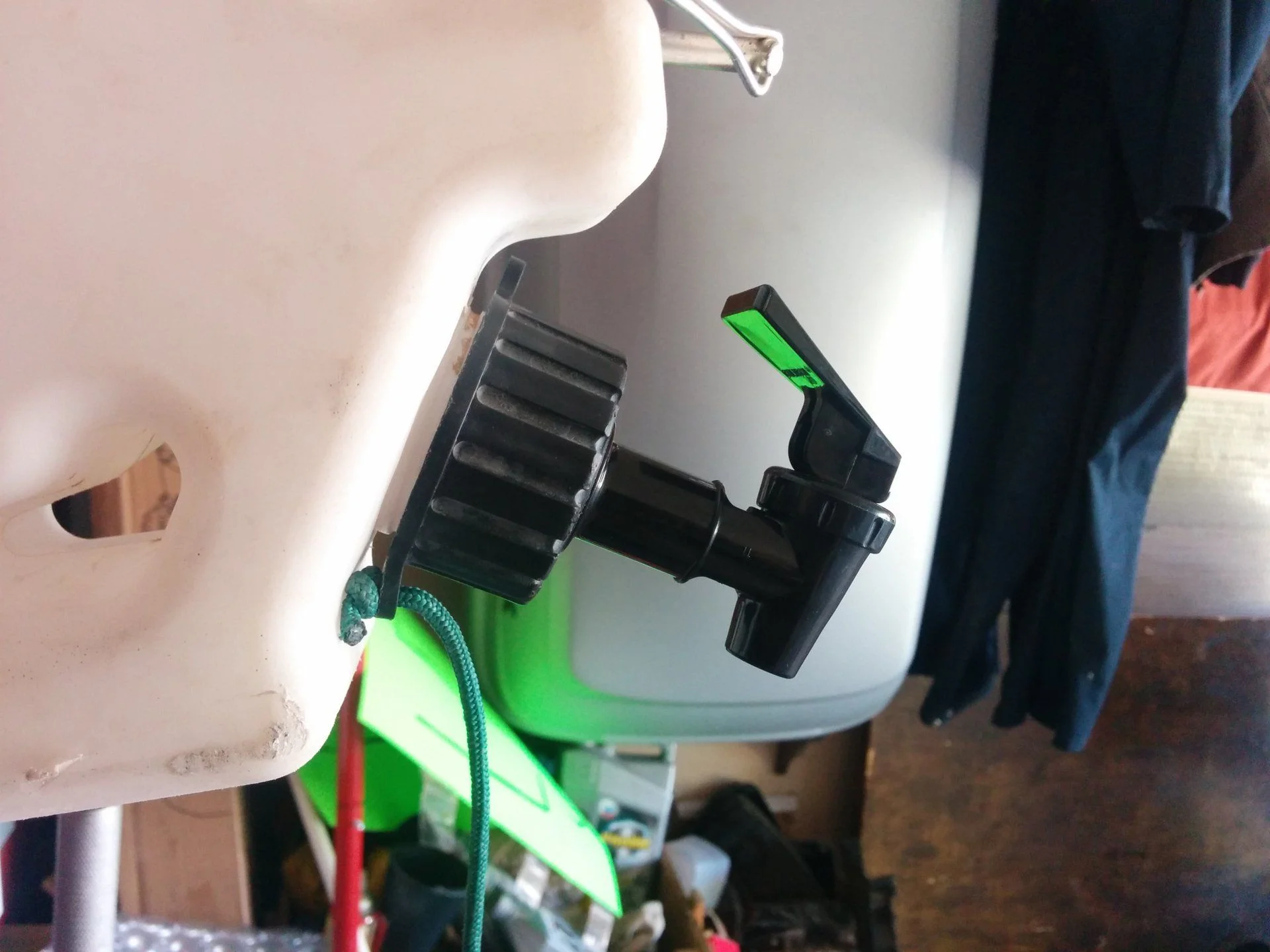

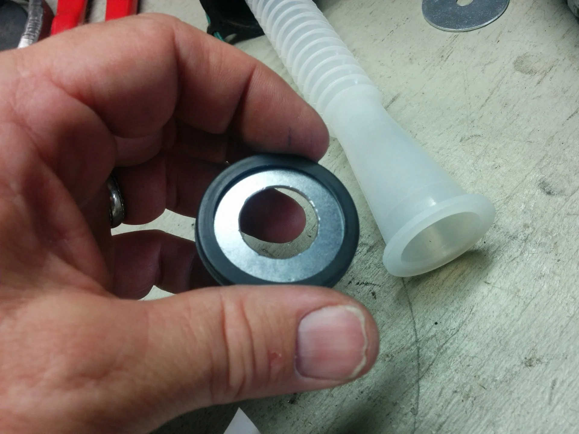

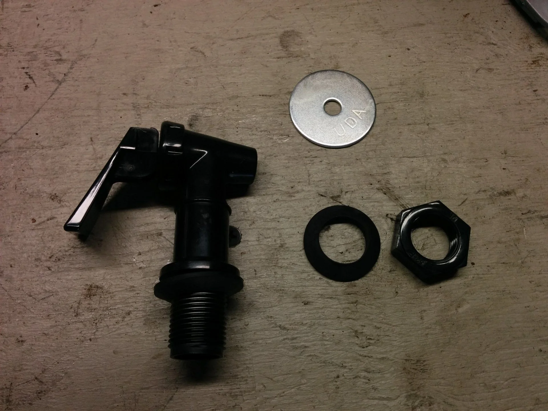

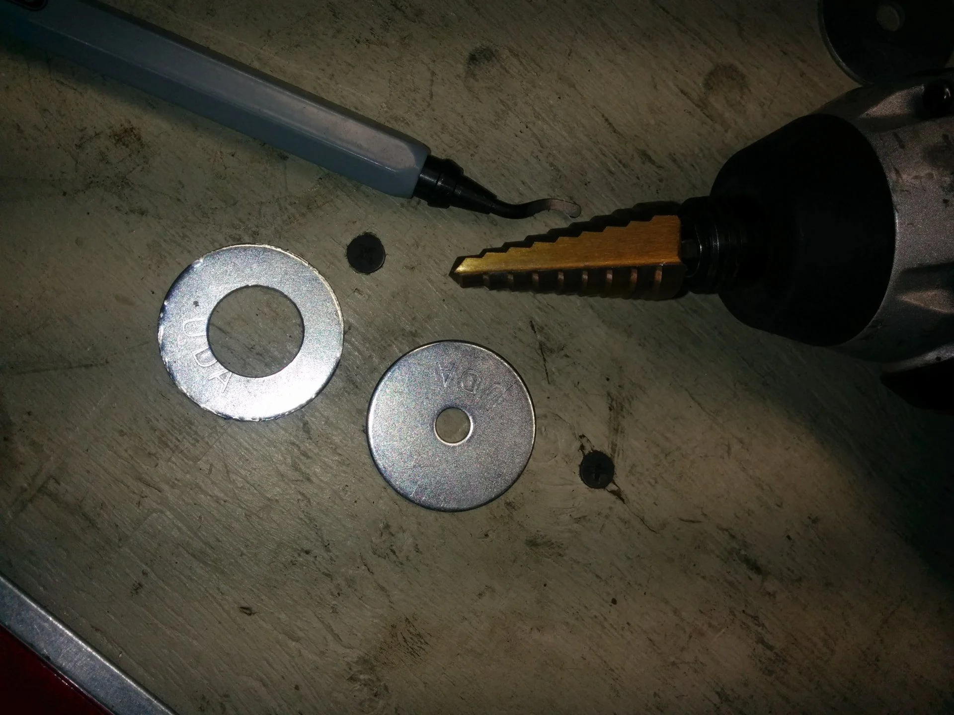

so, version 2.0:
$4 amazon spigot and $0.19 1.5" OD washer
open the hole to 3/4" and ream it smooth
reuse standard spout gasket on washer and assemble the spigot with the spout's cover.
works well, but spout is a scosh long for fully level storage (hence the rotopax bent adaptor, but that one is $illy expen$ive)

I'd be worried about messing up the threads on the can side if I was taking it apart all the time and with the ball valve itself torquing the cap all the time; that's some soft plastic. Keep us informed on the long term durability of your system.
Well 9 years later and it still works great, so I'm going to call it good. I keep the valve assembly in a heavy ziplock bag in my tailgate so I actually can find it when I need it.
