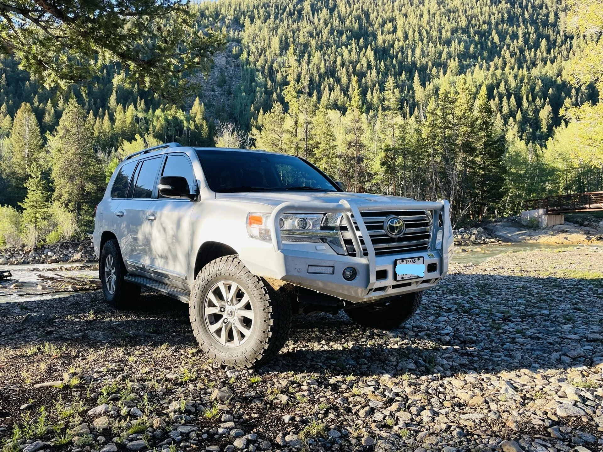

I spent a lot of time looking at soft ride options. Eibach is plushhhhh. Lower spring rate than Bilstein. Here it is on my truck. You can get a full 3" out of this kit despite what the website rates it at. Rear is puny 1" and I later added a 1" spacer to the rear to get slight rake.
Lift Kits, Lowering Springs, Race Springs, Shocks & Sway Bars - https://eibach.com/us/c-56-car-truck-suv.html
Truck looks great - any more pictures? What size meats are those?
