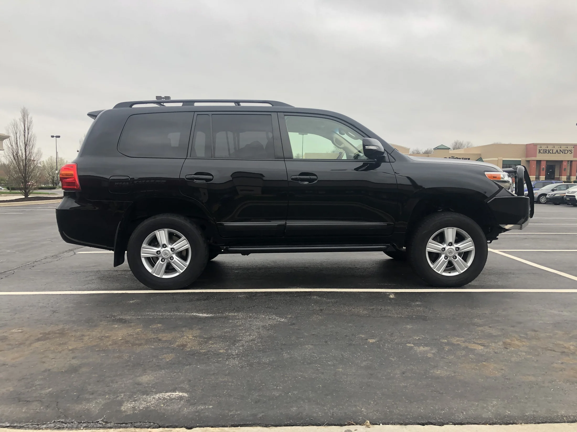

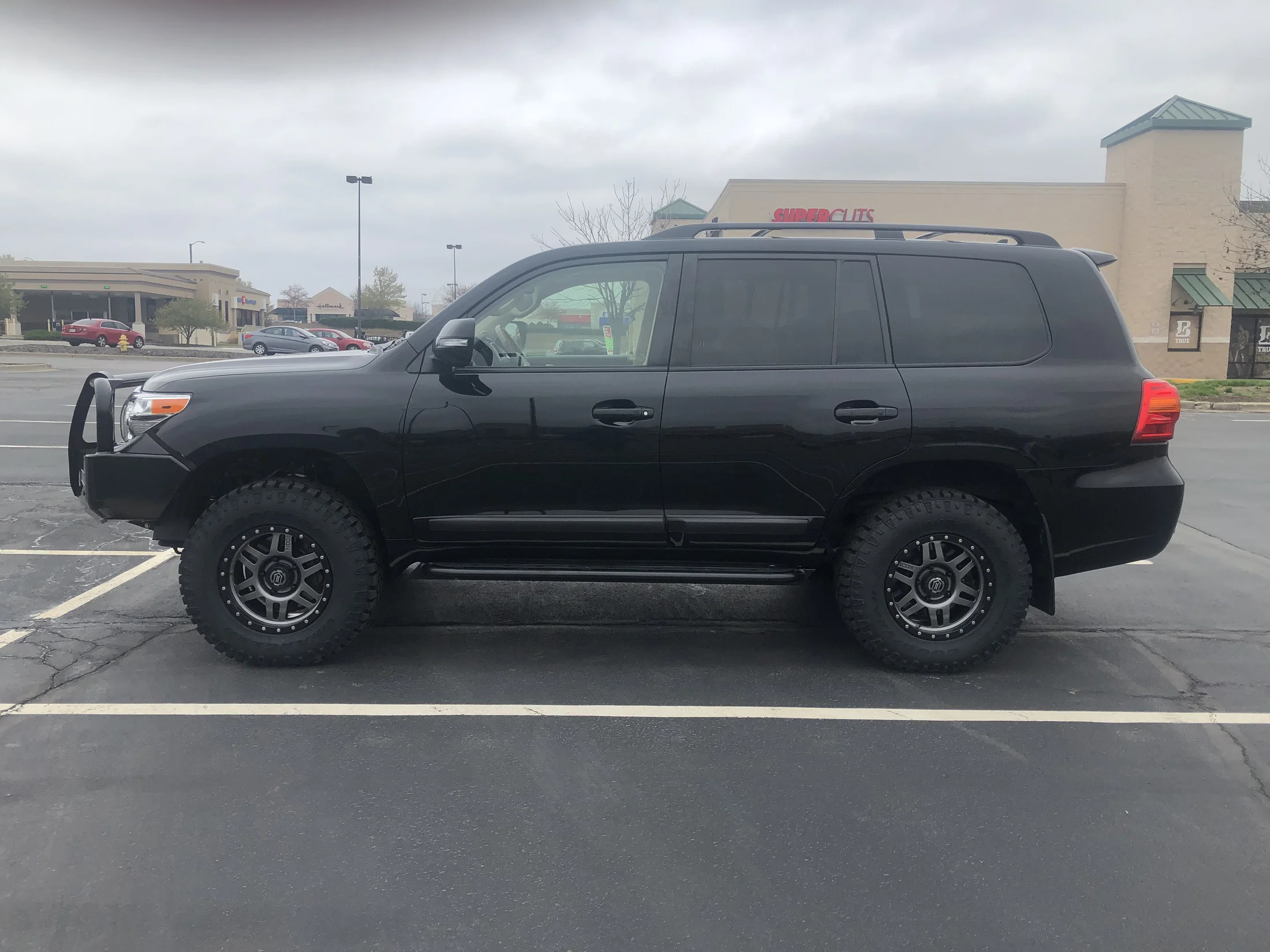

I originally went 2721s and ended up level w/o any cargo in the back. The preload on the front was set at max (should have been set lower) as I didn’t have a winch at that time. I ended up adding 30mm spacers to the rear to get a slight rake back when unloaded (I hated the Carolina Squat look when loaded up).
I’m not sure what the total lift ended up as I didn’t take measurements for reference before the suspension swap. Here are pics from before the spacer install.

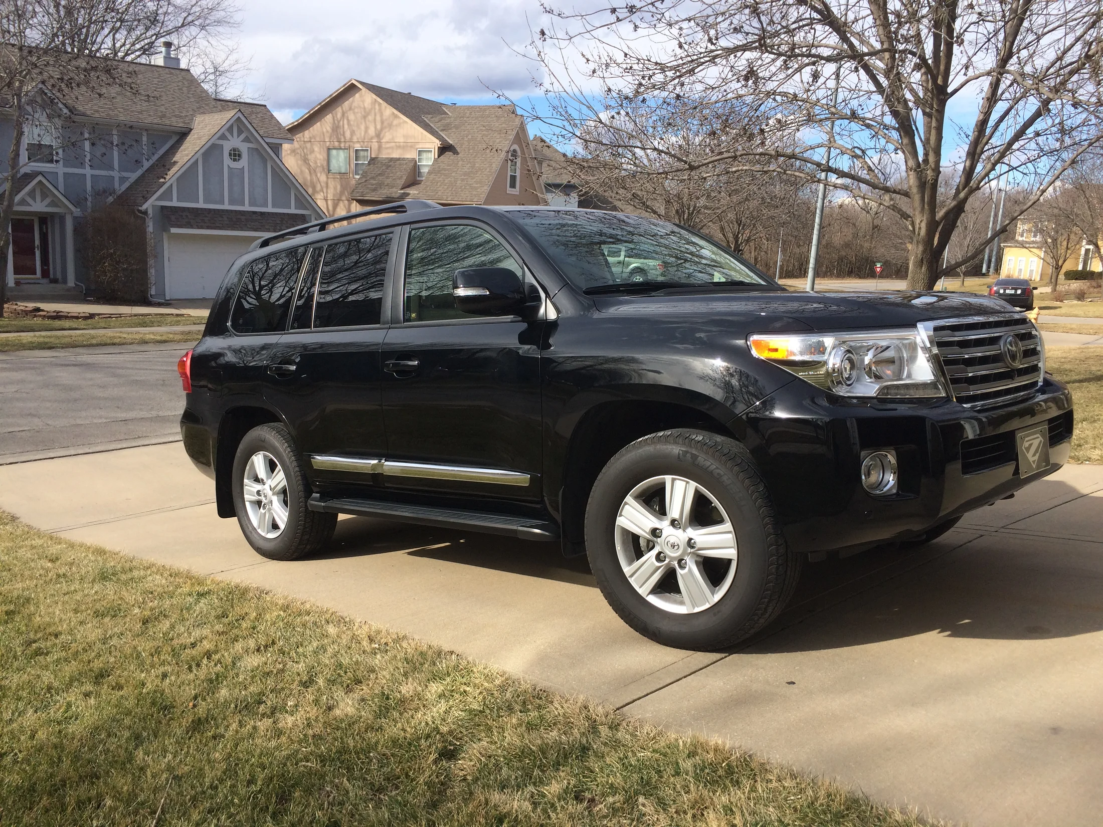

Here is a pic of the truck with stock everything. Couldn’t find on on level ground. I’d guess the lift was 1.5 to 2”.
