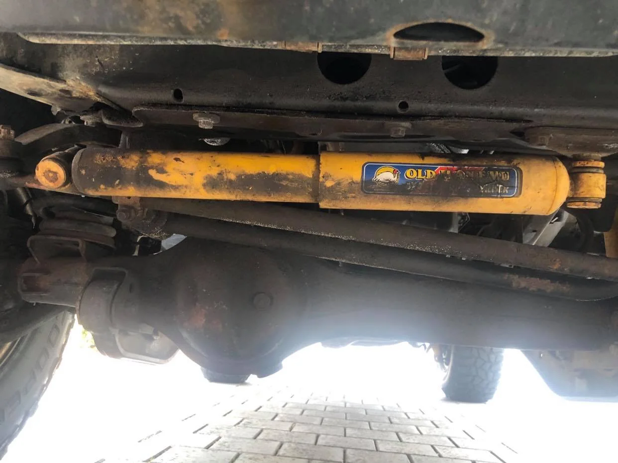

1998 LC 105 series with 2" (50mm) OME lift that was installed in 2000 by the looks. Rear and front springs and shocks. (not nitro) Steering dampener which may be the issue.
Bought it in 2019 with this issue, had 33 inch tyres 305/70/16s then however, I have recently put 35s on it 315/75/16. No change in problem.
Problem:
Slight, only little, controllable with little effort, wandering steering problem since I bought it (2019). Wanders when going over bumps on roads, right or left depending on contour of the road. . I would like to fix it. I do not seem to have any play in steering at all, it's all quite tight. So I am thinking perhaps not steering gear box relate, but maybe Steering Dampener related to lift and large tyres. Perhaps a new heavy duty Steering Dampener required perhaps a Tough Dog RTC.
Wondering if any one has experienced this issue. Any suggestions appreciated. Pics of dampener below.

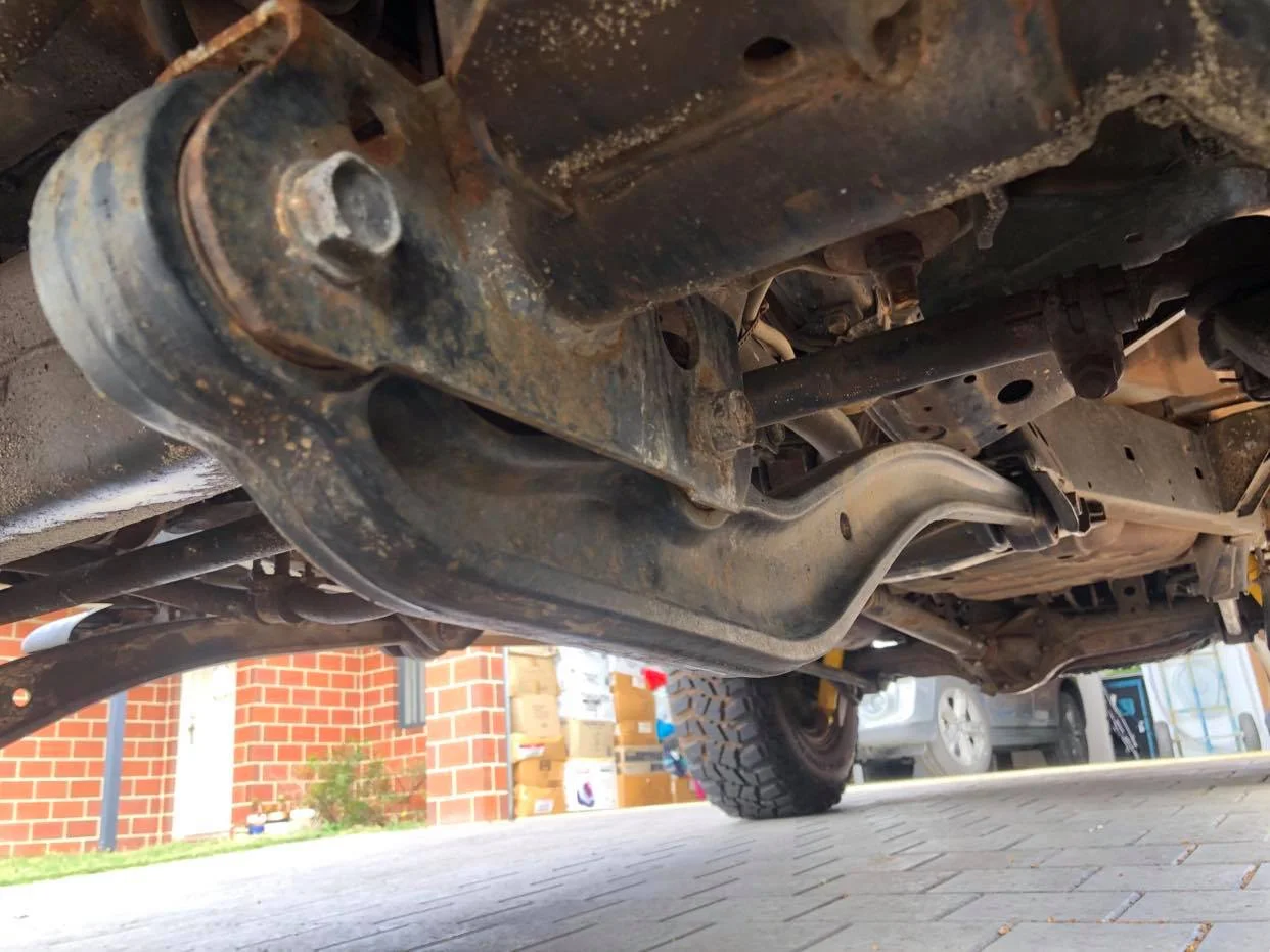

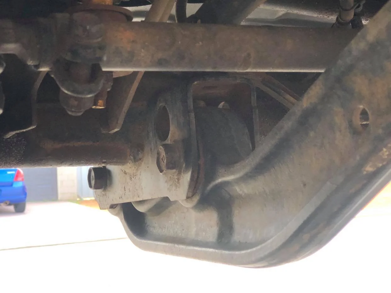

Does not look like you have caster bushings.
Would recommend caster plates and OEM bushings if the bushings are shot.
Going to larger tires (tyres) will exacerbate the problem.
Thanks for the info @BILT4ME

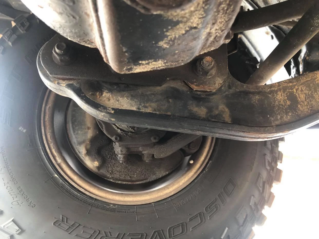

So just gunna quiz you on why you think there are no caster correction bushings, I have left a clear picture of the caster.
Am I correct on thinking that if there were caster correction bushings in that picture, the caster would be on a noticable angle bolted in?
Is there anything else that could explain why they did not put in caster correction stuff, i.e. done in 2000, lasts without it for 100,000kms before it screws the OEM (original) caster bushings. etc. Its def a front and back lift of around 2". Doesn't make much sense if it was, according to the previous owner, done by ARB.

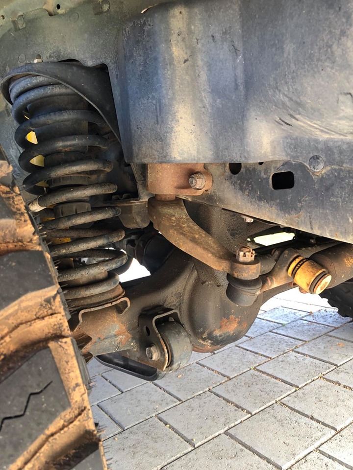

Just one more pic to show lift effecting angle of diff., OME suspension included. It does appear to be tilted forward as it should with that size lift I would think.
Just find it strange ARB would not put those offset bushings in if it has this amount of wander while driving

There are not any caster correction bushings in there.
1) The bolt is centered on the casting on the arm on both front and rear bushings.
2) There are no rear arm drop brackets.
3) OME caster correction bushings are yellow. Those are black.
5) A stock caster limit can be still within spec on a truck with a 2" lift.
Driveability varies by truck and what some people tolerate. I installed an OME 2.5" heavies lift in mine and did not install caster plates or bushings. I have driven it for 30K miles. I have tolerated it. I don't like the way it drives without caster correction. I need to take it into an alignment shop to get it checked so I can determine how much correction I need, then I will order plates to match.
I will also get new tires after I do that. I am also looking at the Delta rear control rod correction bracket to bring my rear axle back under the truck correctly.
If in doubt, take it an alignment shop, have it checked and post your sheet with numbers and let the masses decide. You can read in the FSM the acceptable range of faster. Some trucks are more forgiving than others.
