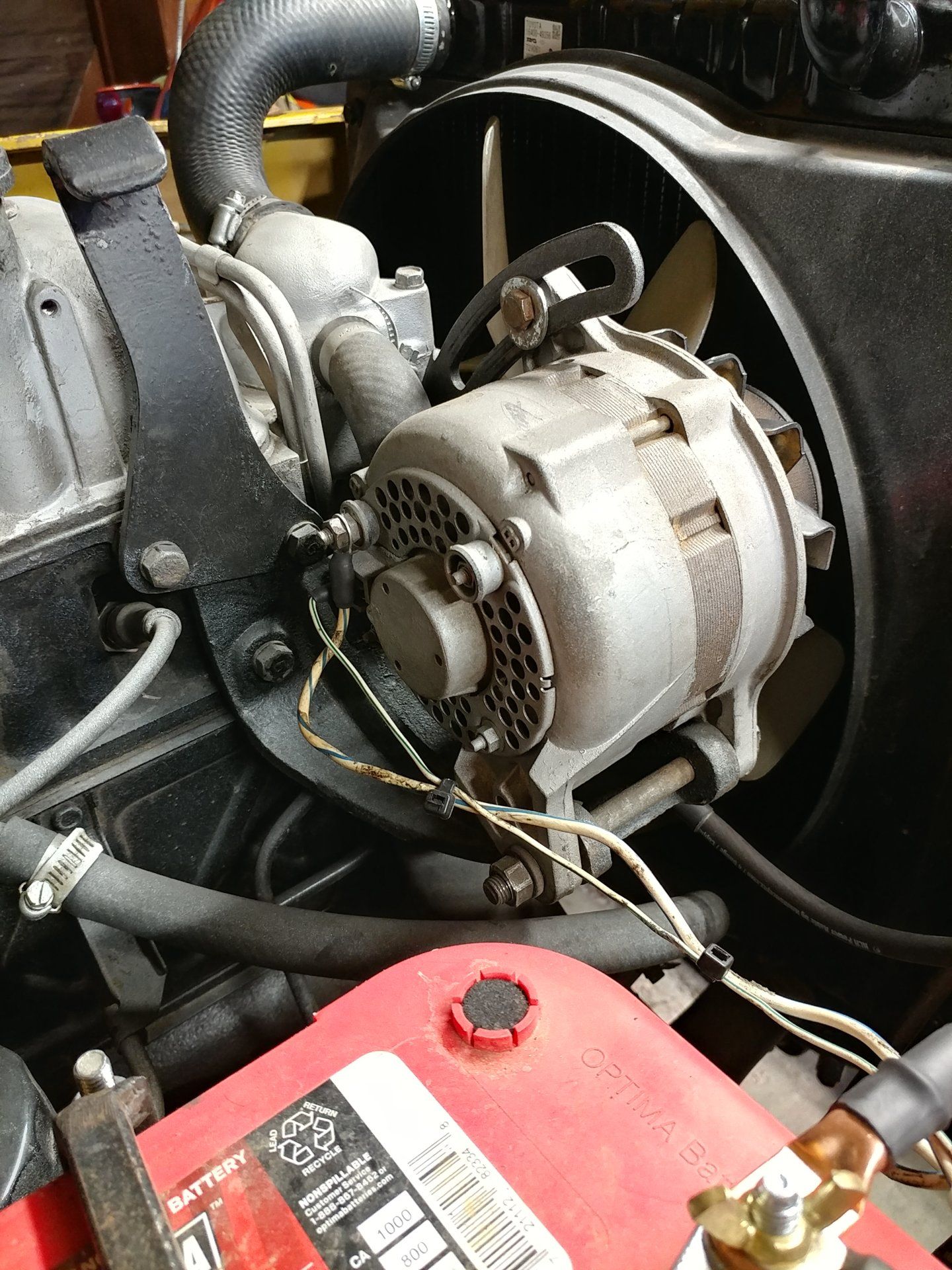

@Steamer that helps a lot. I noticed when I took a pic of the alternator there is only one wire going to where the 3-prong connector should be.
I did replace the connector at the end of that wire and maybe I plugged it onto the wrong one.
@JohnnyC it's pretty crusty looking?
The terminals on the alternator should be marked.

the VR ground wire is shot... might as well get a new one.... while they are still available
fix wire... ground the case well on firewall... test it out if ok keep it as a just in case spare.... get a new one
Didn't even notice the cut in the ground. I actually just picked up a new regulator so i'll get the wiring fixed to the alt and try it.

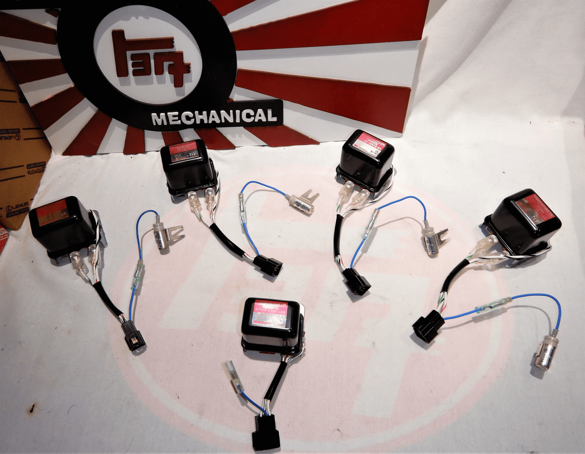

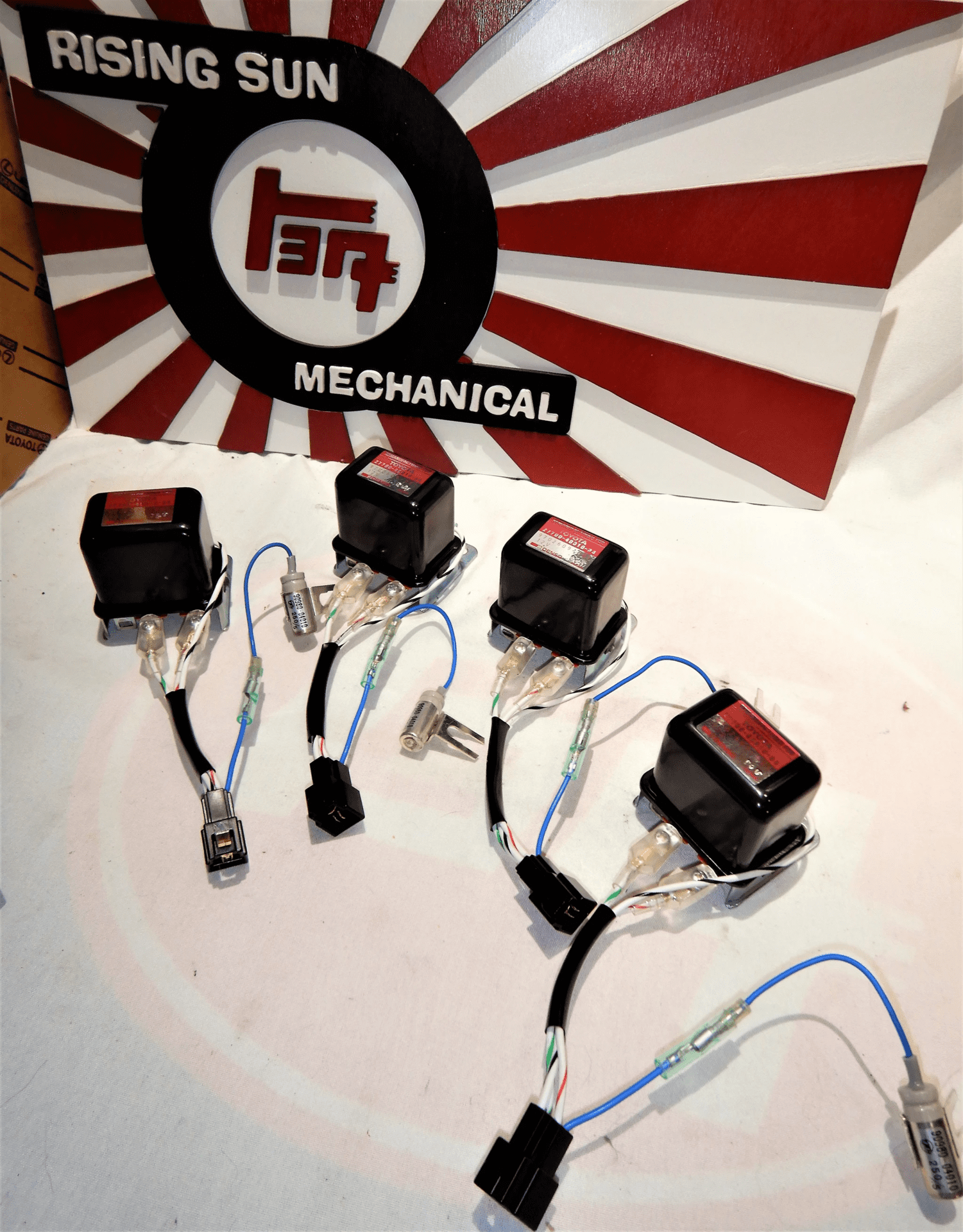

below are some Tech. photos of what you can expect , such a case arise , like what happen to @bhsdriller . im just glad my fellow
MUD members are NOT
forced to shop for such a critical Needed part from ROCK AUTO , where the parts box that arrives at there shop door , says
" made In Bangladesh...........
" or worse " China " :mad:
i want to personally thank Sam , for allowing me the few extra days needed , to
get this unique needed parts solution job scope to the end user plug and play
level it needed and needs to be .........
Thanks Buddy ! :cool:
27700-60080-84-RR
9/72-9/76 40 & 55 series
note : a NOS original 27700-60080-84 and Reproduction 27700-60080-84-RR
below for cross caparison side by side Technical analysis
and as always , please feel free to PM me with any questions ..
