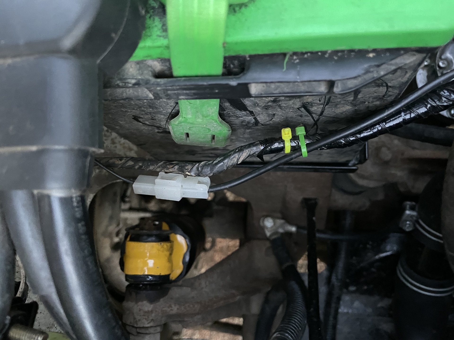

'75 FJ40, USA harness, points with igniter. I'm trying to correct the radio interference when I'm spinning the 2F at highway rpm.
How do I hook this up? Did it ever come new with the 40? NOS OEM Toyota RADIO Noise Filters & Condensers Voltage Regulator,Fender Mounted Igniter 90980-04010 / 90980-05055 a true set of must have's.. - VintageTEqParts.com - https://vintageteqparts.com/collections/electrical/products/nos-oem-toyota-radio-noise-filters-condensers-voltage-regulator-fender-mounted-igniter-90980-04010-90980-05055-a-true-set-of-must-haves

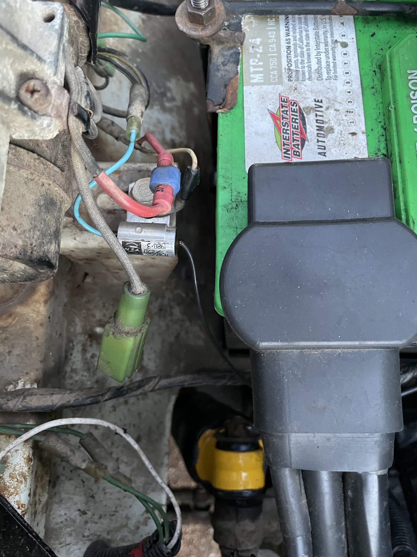

There is a loose wire connecting to the negative side of the coil terminating with a bullet connector. My guess is plug it in there, ground it on the screw holding the coil to the inner side of the fender. But, then what is the spade connector (above) for?

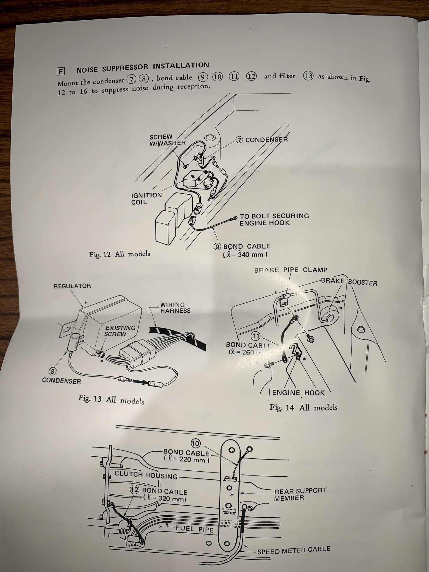

Hey mate don't know if this helps but this Toyota bulletin was stapled into my fsm when I bought the car.
Go to post number 10 on my build thread.

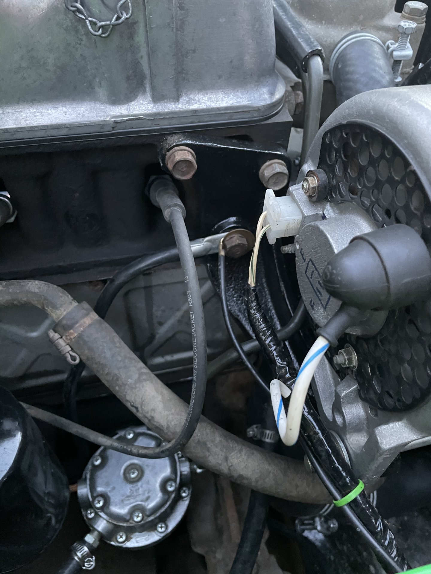

This is the best that I can gather from the mouse nest on the side of the coil. Let's see what the jury thinks. One legibility issue is the red wire from the harness is also understood as the black wire to the distributor points. Also, the two diagrams in the Haynes manual appear simplified, so it is hard to confirm what I observe, such as the white ceramic piece on the battery side of the coil.
Aside from that, there probably is an ignition wire (ring terminal) from the fender harness, and a points wire (spade terminal) from the fender harness, hook them up. Unless you have a remanufactured starter with the by-pass wire on the starter solenoid, then the ignition wire simply goes to the coil positive. Then you have the black wire from the igniter to the coil negative.

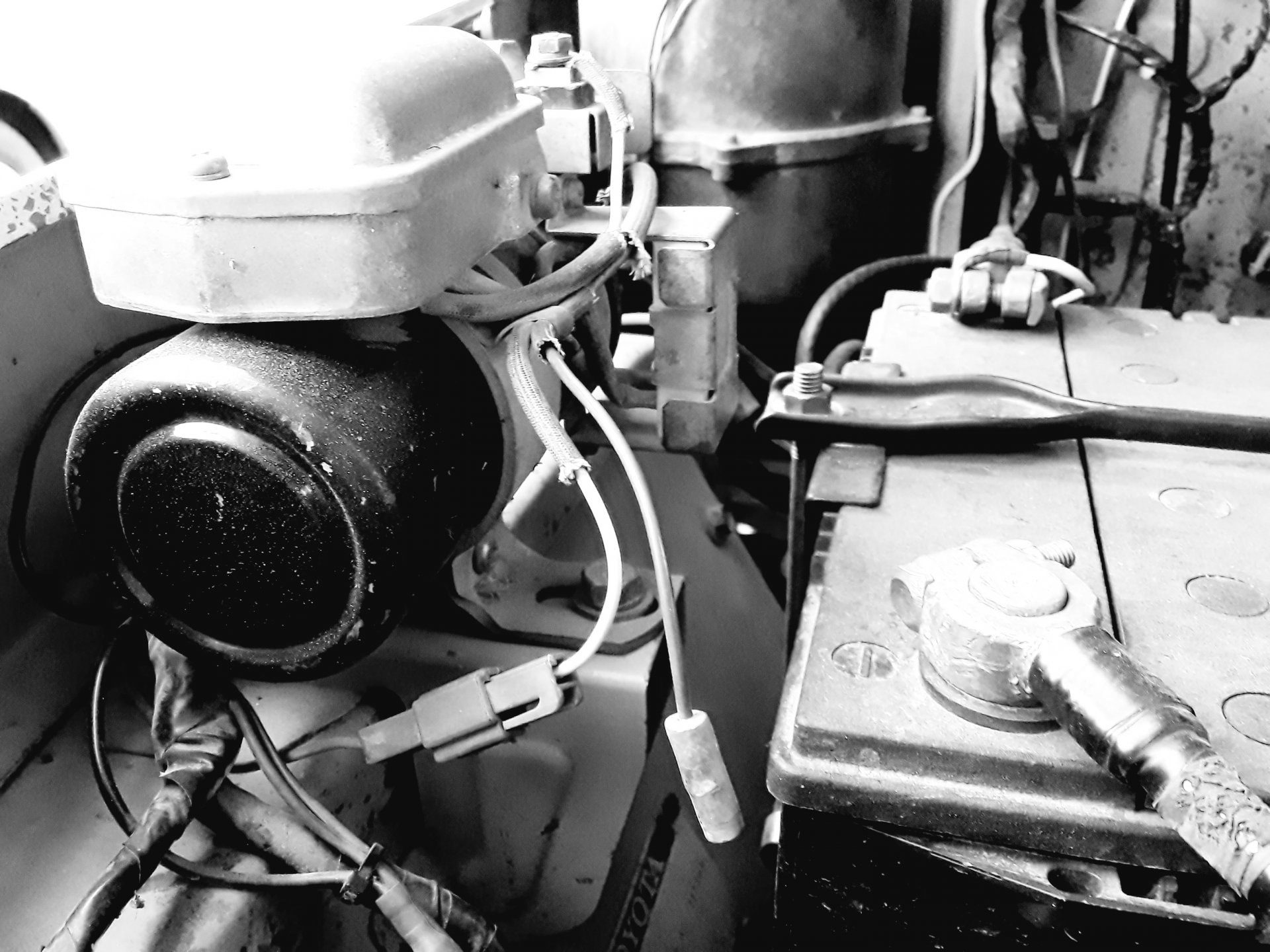

On my igniter, the spade (green?) connector is a red wire. However, it appears bleached to white on my rig that sat in the NM sun without the hood. On the other side of my harness, it is black, and so is the wire on the new distributor. Go figure. However, it all appears to be the distributor/points side of things.

Btw, the capacitor would be disconnected inside the distributor, when using an igniter.

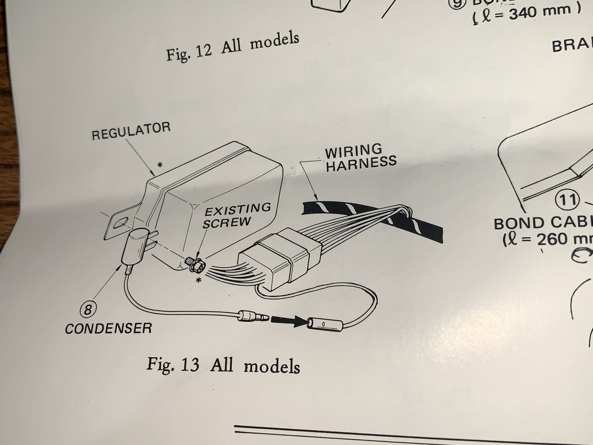

Please let me know if these Diagrams answer your install questions ?
Thanks

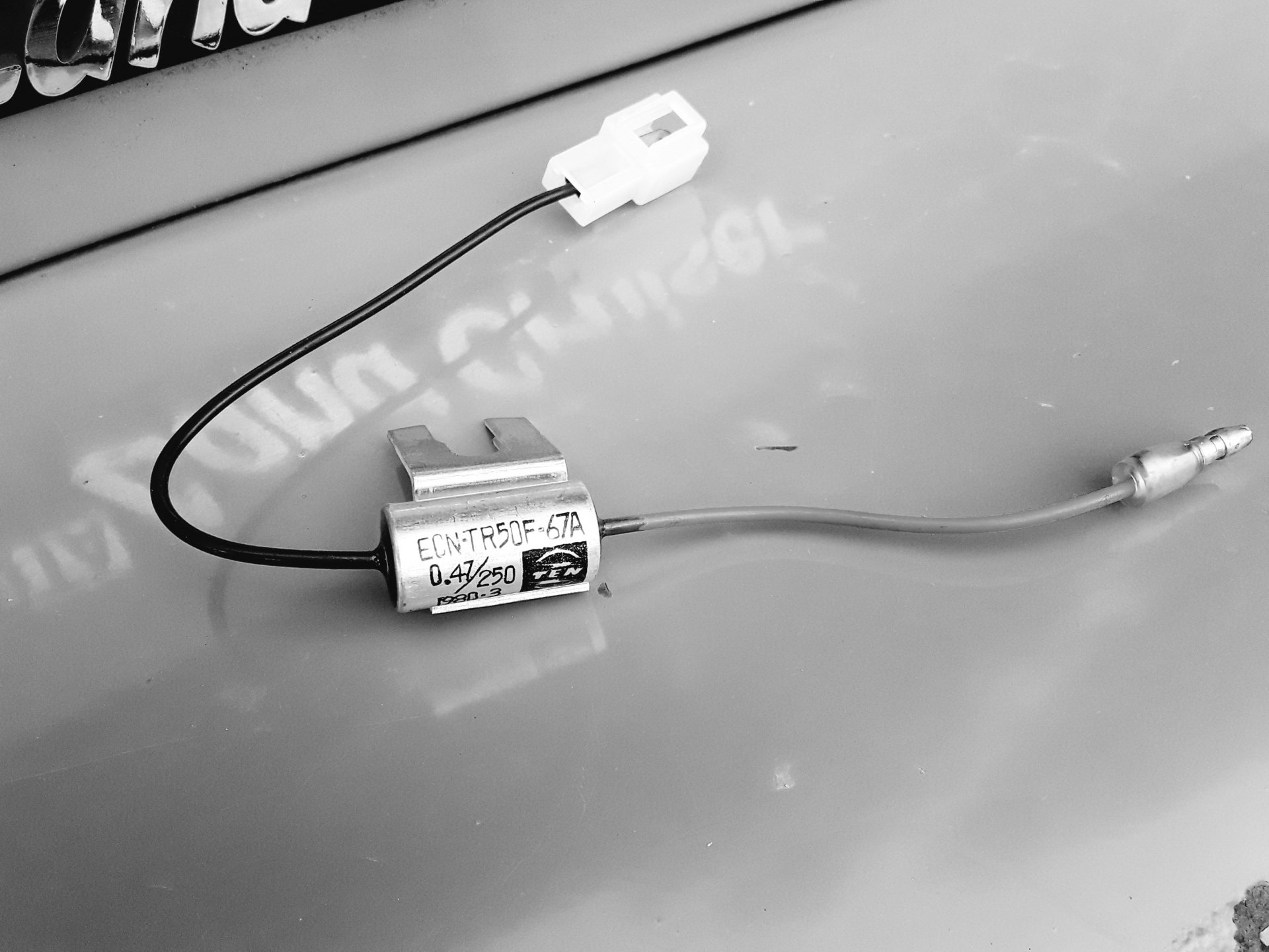

YES indeed both filters came on USA spec. FJ40,s
Wide range year span applications. On these little rascals
To be clear, it's to black/yellow that the filter connects to? Then on to the engine block?
